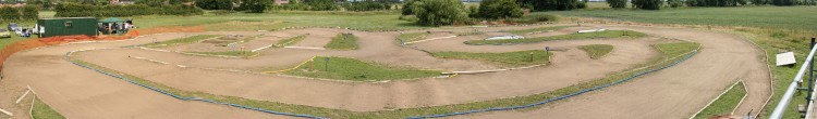

Hi
I run on a very bumpy track and use this as my set-up
http://www.teamxray.com/xforum/xform...=173&setup=xb8
The buggy feels really planted and lap times have improved no end.
