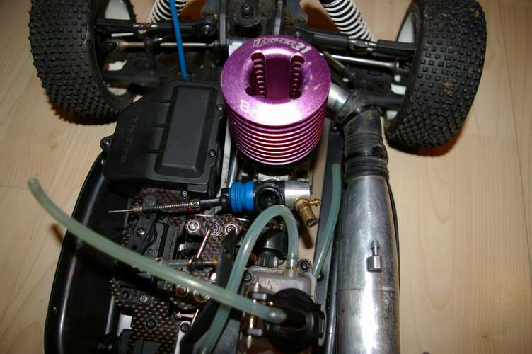

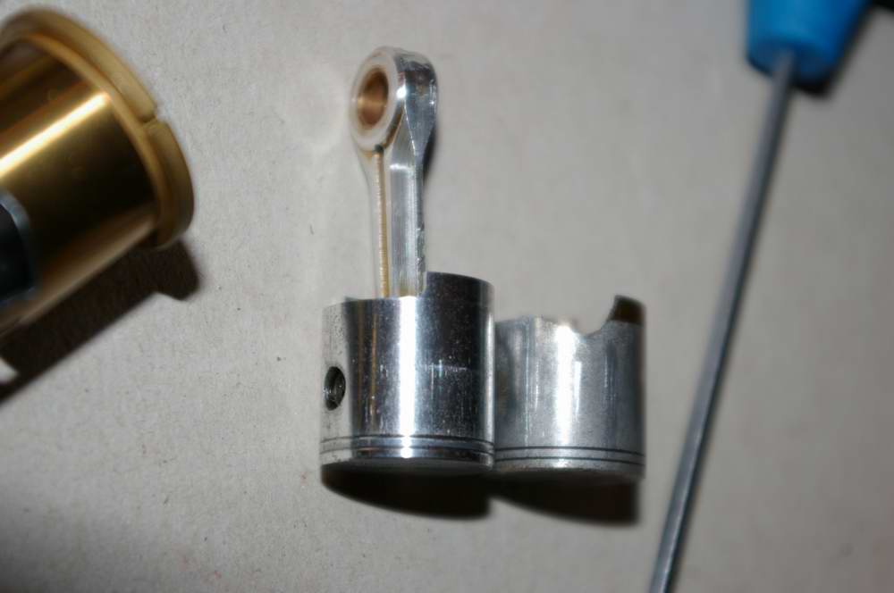

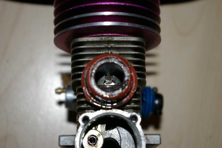

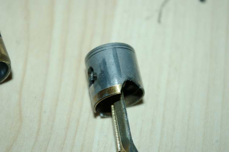

I got time to disassemble my engine.
Everything was VERY hard to remove especially the piston and the sleve. Below you will see what is the outcome.
My guestion is... do I rebuild or buy a new engine or go brushless???
If new one... which engine do you recommend, bearing in mind that I do not race??

Old 03-08-2010 | 08:08 PM
  #1758
46u's Avatar
46u
Joined: Jan 2005
Posts: 22,095
From: Macon, GA
Default RE: Official Hyper 8 Thread
Sorry to see that but as far as what to do that is all up to you.
Old 03-09-2010 | 06:07 AM
  #1759
Joined: Apr 2009
Posts: 70
From: corby, UNITED KINGDOM
Hi there,
Where can I get the piston and sleve parts???
I checked endless sites and nothing except one that was quoting me $100 for both.
If I can't get those parts or are to expensive which engine would you recommend???
Dont have to be racing one as I do not race. More torque would be prefferable option.
Old 03-09-2010 | 09:44 AM
  #1760
46u's Avatar
46u
Joined: Jan 2005
Posts: 22,095
From: Macon, GA
There is a lot of good engines out there what is available in you area?

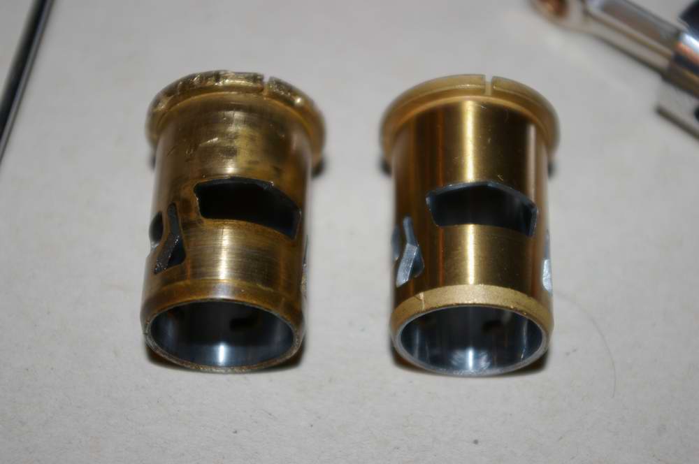

Old 03-18-2010 | 03:19 PM
  #1765
Joined: Apr 2009
Posts: 70
I put my engine together. Looks sweet. NOW....
which type of breakin in the engine would you recommend?? I haven't got a temp gun.
ps. Some photos of the postons and sleaves.
ps. hardly enybody here - no conversations - bring them on show off!!

Old 03-18-2010 | 03:42 PM
  #1766
46u's Avatar
46u
Joined: Jan 2005
Posts: 22,095
From: Macon, GA
If you do not have a temperature gun you will not be able to do like I do. I recommend you get one.
