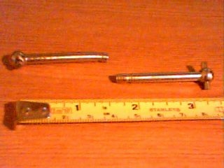

well i dont think i need to worry about tuning it for now, think i have bigger issues to sort first. just been out in a parking lot with it. it was just starting to get dark and i failed to see a curb! FULL PELT HEAD ON INTO IT!!!! i thinks its dead!i found a two little metal rods by the crash site, which i think used to be 1 long rod, i've no idea where it has come from. i ll post a pic, im sure someone will know what it was. think this could just be the start of my problems though. the controls are just dead, nothing responds to the controls. i havent had chance to have a good look at the extent of the damage yet, i ll have to wait for some daylight, but ive got a horrible feeling it could be a write-off

You have snapped a dogbone, most probably the drive to one of your wheels. You should be able to buy a new one no problem.
As for the loss of control take some pics, but you may have puklled a wire from the electrics with the impact.

darn thats a nasty hit to snap a dogbone in half! im willing to bet the chasis is tweaked as well

right ,i just had a good look at it and the only word i think i could use to describe it would probably get me banned from the website. firstly theres the snapped dogbone thing that i photoed yesterday, which i feel is the least of my problems. the battery holders shattered, hence the loss of controls. the chassis is shaped like the bottom of a rocking chair and the engine is completly jammed. im thinking its not gonna be worth repairing
