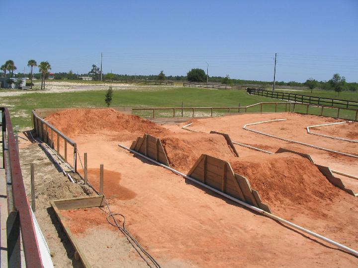

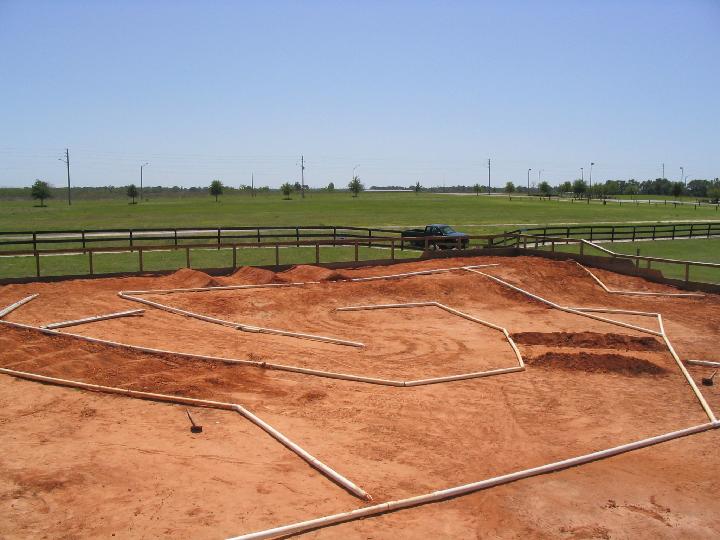

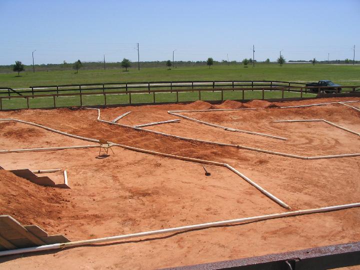

My Hyper 7 TQ will be hear soon and this is some pics of the track I will be running at. Was hoping you guys could give me a ball park setting with diff oils and shock oils to start off with. Im new to buggies and racing so just something to get me started until I learn how to set up myself. Not sure how these pics will look, I copied them off the internet. Its a hard packed clay that they wet down before they race. They change it often, still has that one big jump and a bunch of little ones with alot of tight turns, really only one maybe 100ft straight. Thanks for any advice . Maybe a tire also, was thinking bowties,but what do I know I think these are pics of when they were changing the layout in the past. Its really hard packed now.

I run 5-7-2 at my track with no front sway bar, 40 shocks all around with mugen grey springs in the front and softer blue springs in the back, I will adjust preload spacers as necessary. We have a huge jump like that in your pic except for the HORRIBLE wooden sides, dont screw up and misalign your jump or say good bye to your A arms. You may want to stiffen up your sway bars because those little chicanes are going to be tough if your pushing on power. Looks like a lot of those little triples and doubles are quite steep, so you may want to mess with your shock fluids and stiffen them up a little. I like my buggy real soft, you may be different. I like crimefighters but if they are running wet then bowties may be a good choice to keep the clay from globbing on and making slicks.

Thanks MorganSS, I was going to get the bowties but tried a cheap bid on ebay for the panther chameleons, set of 4 brand new in the bag. I cant beleive I won them for $16.00. A set of 2 on towers is like almost $20.00. I will use these for starters. That big jump in the pic has the clay built up even with the side boards now, I think that was a pic of when they were changing the layout,all the triples and doubles are rounded at the top and not as steep. I ordered all the fluids Sunday that I stated above, so glad to see Im in the ball park with the tips you gave me. Thanks again.

from the looks of the dirt clay/sand mix. i'd go with a bowtie or crimefighter in a m2 or m3
