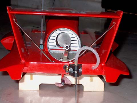

The first tanks of fuel
Even though the plastic fuel tank lid looks like a good idea it really isn't very easy to use. I found myself fighting with the tank just to get the lid on and off. I use a large 32 Oz. Airplane fuel tank as my "fuel bottle" for the boat. I inserted a piece of plastic tube between the tank and the carburetor line and just connect it to the tank. Squeeze the flexible airplane tank and presto!
Both tank lines are connected to each other to prevent the fuel from attracting moisture in the engine
The lines are disconnected and the fuel is fed in through the pink line.
With the tank full we re-connect the line to the carb. The boat is now ready for action.
I have used 10%, 15% and 50% nitro fuel and the boat works well with all of them. The needles have to be tweaked when you change nitro contents to keep the engine happy. I suggest that whatever fuel you decide to go with it should have a minimum of 18% lubricants. More oil will translate into an easier to tune boat and more successful launches, plus the engine will last longer. I suggest you do the evaporation test with a graduated measuring cup to really see how much oil your fuel has. You might be surprised! Just remember oil is more expensive than methanol...
All of the engine break-in tanks where done on the shore with the boat on the stand. It was not hard to keep the temps below 200F with simple needle adjustments. After the 4 or 5th tank the engine started to wake up and respond well to throttle changes. The engine started up well and did not act up while in the break-in stages. Back to top

The boat was not able to finish a tank. It looked like it was sucking plenty of water -but I could not find the point of entry. Apart from water pushed up the prop-shaft I could not think of anything else. Back to top
Engine trouble-shooting
The engine quits before you get the cowl installed...
Note: All the following scenarios are to be followed with the boat safely sitting on a boat stand.
Scenario #1
The engine is probably loading up on fuel and flooding. I would first try to increase the throttle trim to get the engine to idle at bit faster. If this still does not work I would look at what the boat does as you give it throttle with the prop out of the water. The engine should sound "fat" (meaning with plenty of fuel) when you jab the throttle. If the engine smokes and stumbles transitioning from low to high speed then I would look at leaning out the low-speed needle.
Scenario #2
If the engine takes a long time to pick up RPM and there is plenty of smoke coming out the tuned pipe (indicating a rich setting) Then I would look into leaning out the high speed needle.
Scenario #3
If the engine's RPM's are going up and it quits while idling then the low-speed needle is probably too lean.
Scenario #4
If the engine revs up aggressively and follows the throttle servo with no lag it probably means you are running too lean. If after a run there are signs of overheating like: Steam coming from engine, lower portion of glow element is dark brown (like it's burnt) or if the glow plug platinum element has a powdery gray finish then you are probably running the engine too lean.
On the water engine problems...
If the boat seems to loose power then the engine is probably overheating.
If the boat is running too rich or if you have too much water cooling then you will see the boat run slower but will still see smoke coming from the pipe and there will be no evidence of overheating. If the boat is easy to re-start shortly after you bring it to shore then you know it's not overheating. You can make a coil with annealed copper tubing and wrap it around the tuned pipe coupler to pre-heat the water before it gets to the engine head. The water cooling on the Miss-Bud is not a super-pressurized water jet like on other boats so I don't think that you would be over-cooling the engine head.

The boat sucks water…
Before I installed the Auto-bailer I could not even finish a tank of gas with the boat on full plane. After installing the Auto-bailer I could easily run the mill + do 6 laps and had fuel to spare at the end of a race-heat..
My pit-buddy also noticed this when he picked up the hull after a run, it was not 5 lbs. heavier than when he launched it like it did the weekend before. The Auto bailer is installed in the lower left rear sponson. The bottom of the auto-bailer is almost flush with the bottom of the ski.
