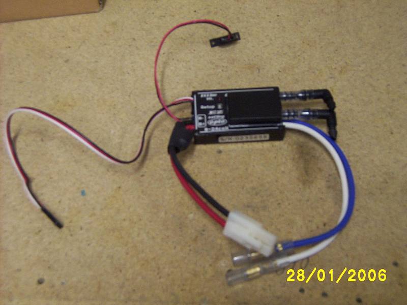

I just spent a few minutes searching for what you have and didnt find much, this site, looks to sell controllers similar to what you have, as I got a few hits from the search engine for it. Take a look at this link and see if you recognize the controller. http://www.ripmax.com/7index.asp?Ite...tegory=060-050
Also, you mentioned that this controller is rated for "8-24 cells" (which equals 9.6v - 28.8v) ..... if you only have a 6 volt battery set-up, then the controller could be going into a failsafe mode, as it "sees" less voltage than what it is designed to operate, or a dead battery condition. Most speed controllers have this feature built in and is set from the factory, although you can change it after you program it (if you knew how)
If you could post a close up picture of the controller, it may help us to atleast identify it and point you in the right direction.

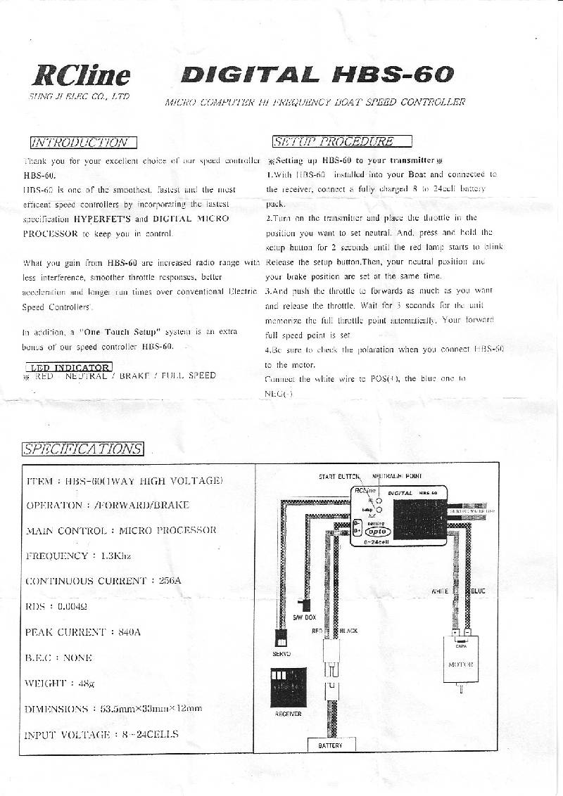

Here you go alias_neo ,
Let me know if you need any more help with the controller.
One thing I found is that the cooling housing can seperate from the main controller unit, I had to re-silicone it back on.
PM me your email address and I will rescan it in higher resolution and send it to you.

Hey there, thanks for that. Please tell me Macleod does this controller have a reverse function? It doesn't seem it does from the setup guide. Yes, the one you pictured there is the same one and does it make a lot of difference that the battery we have is only a 6V? I'll PM my e-mail for the higher res scan. Thanks again
Joined: Mar 2004
Posts: 432
From: Perth W.AW.A, AUSTRALIA
No it has no reverse, only forward and brake functions. No good for me with the rigger to go backwards.
As for the voltage , I've only run 9.6V (8 cells) to 12V (10 cells) through it, with water through the cooling unit. No idea how it will run with 6V but you can give it a try, but watch the temp....if you not running water.
Sent you email with better scan of instructions.
Enjoy
