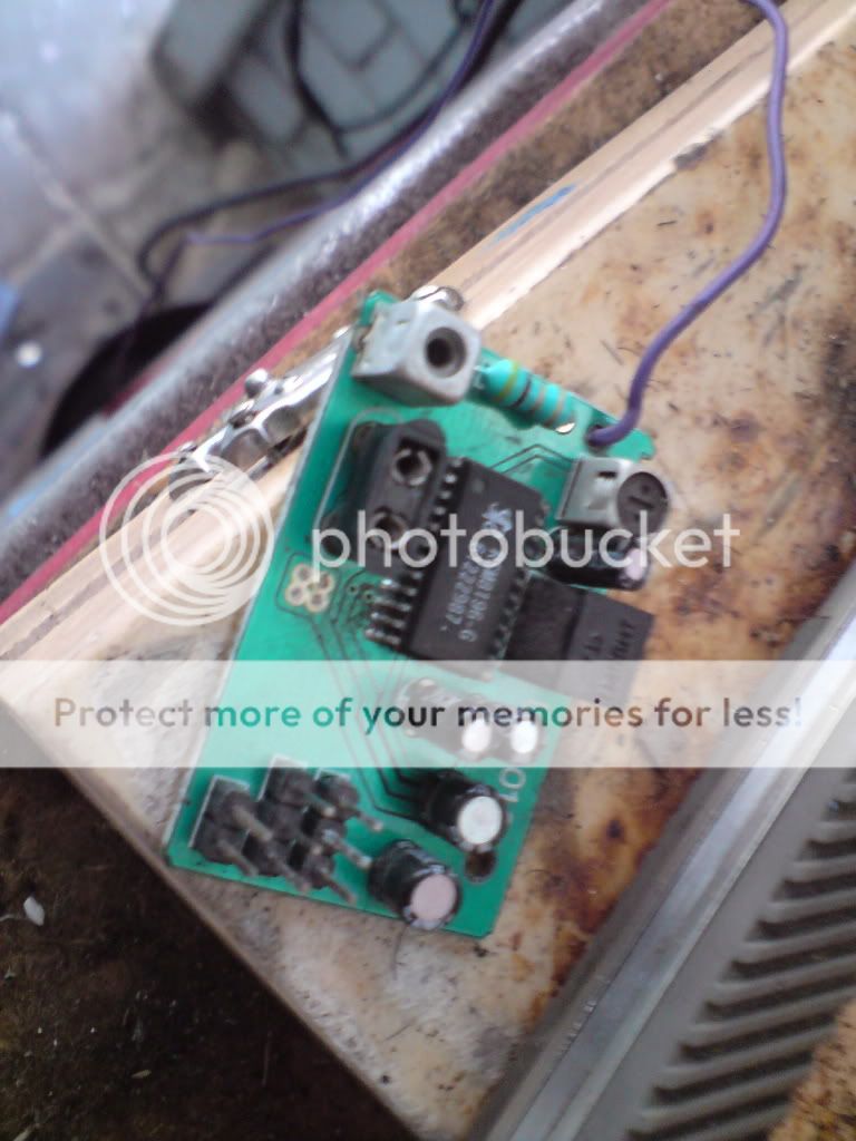

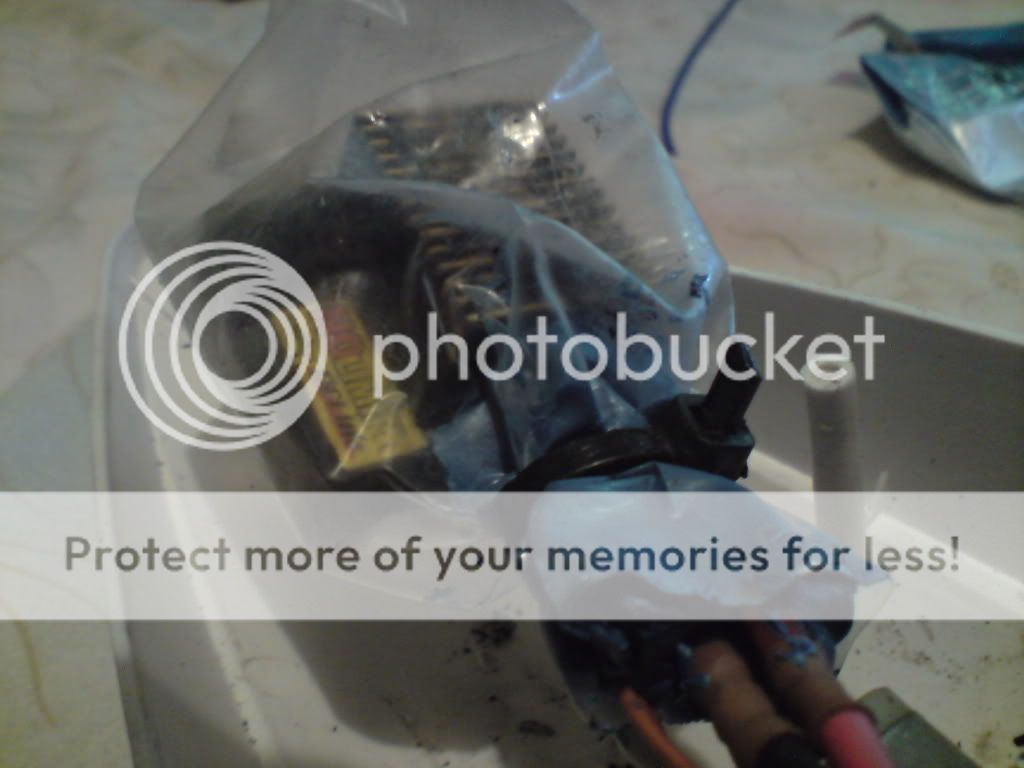

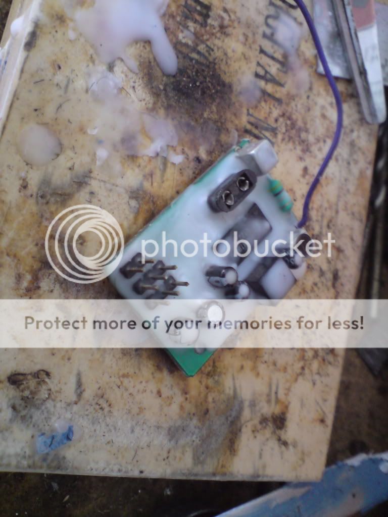

ok well no ones really biting on this. seeing as the hull was filling up
with water and the esc and reciever were not working when wet, i
waterproofed it. the esc is in a plastic bag ziptied, and the reciever
i pulled out of its case and melted wax all over it. here are some pics.
i tested it in my bath.it runs on 3 cells now inside the hull,not on top.
Under heavy throttle she goes straight.[8D]runs completely submerged.
it only stops when water bridges the 2 contacts of the crystal. pull
the crystal out,blow, keep going.this boat has still cost me pretty much
nothing.now runs completly under water.
reciever before:
reciever after:
esc:
