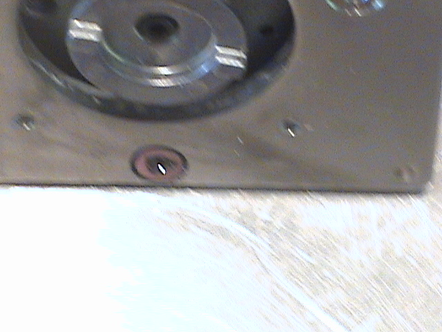

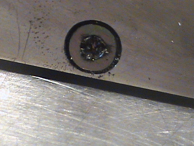

Hey thanks guys! Chief, I believe you are right. The big square mount needs to come off to make the starter touch the engine. I do believe they are lock tited... I heated one then used a drill and got it out... (after I tried a philips head screw driver) The other 2 are miserably stripped... nothing could make them budge.. I believe my new problem is getting the stripped screws out. There is no was I can reuse them now so I just need to get them out. They are stripped extremely bad.. I'm stupid and tried the drill after they were stripped which tore them up. I can not get any traction now.

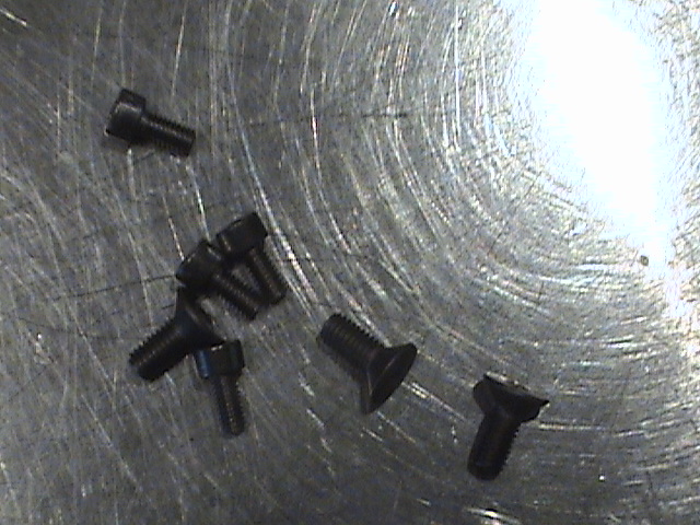

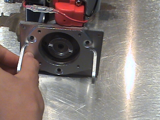

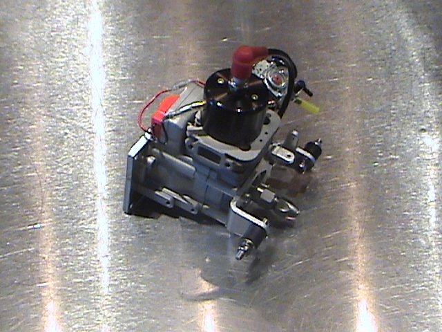

Hey guys here are pics... i think that square mount should come off. You can see how bad the screws are stripped and wats going on now. Also, does anyone know what those silver screws pictured are? They are not to hold the starter on or the mount because Ihave those...
Thanks in advance
Stacked
btw black around screws is where I heated with lighter

on the smaller mount, the linkage arm goes in front of the mount, not behind it
get rid of the square mount, the regular mount will do/take its place

You're right, that rectangular piece comes off then you bolt the bracket on in it's place. If all else fails, you can get mounting brackets that will bolt onto the plate.
Seeing how the bolts are already shot, you can try something else. Get out the Dremel with a cut-off wheel and cut slots in the bolts so that you might be able to remove them with a screwdriver.

Here's a simple way to get those screws out in future.
- Use the screwdriver/sparkplug spanner that came with the engine
- Place the engine firmly between your legs with the plate facing upwards
- Put the screwdriver into one of the screw slots & give it a good WACK with a hammer - this cracks the thread lock & seats the screwdriver into the screw.
- Unscew the screw from the back plate.
I used to have all sorts of issues getting those plates off until I was told this trick by an engine modder. It has wroked every time since.

OK dude lets tackle the biggest problem...you said you nicked the cord on the dremel and soon after it quit???is that right??? ok you gotta have a dremel to build a boat..so lets fix it safe to say the wires was cut enough that it lasted a bit and then let loose. sooo use a sharp knife and cut through the black insulation on the cord MAKE SURE ITS UNPLUGGED..cut an inch above the nick and an inch behind it. carefull not to nick the wires when doing this..remove the black insulation then you can see the wire that got cut..strip a half an inch off each piece and twist the metal wire back together tightly..wrap that with black electrical tape and then wrap the entire area with electrical tape..then plug it in and I bet it runs fine....
Now take the repaired dremel and put in the cutting wheel and cut a slot into the head of the 2 screws on the plate cut as deep as you can if you nick that plate its ok it gets disposed of....now do like Dicko said and put it between your legs put the slot screwdriver into the cut you made and smack it good with a hammer then turn the screw out it should come right out the heat from the dremel work will loosen up the loctight real well.....
those extra bolts are to fasten the new motor mount on with... the flat heads will replace the screws you stripped....
