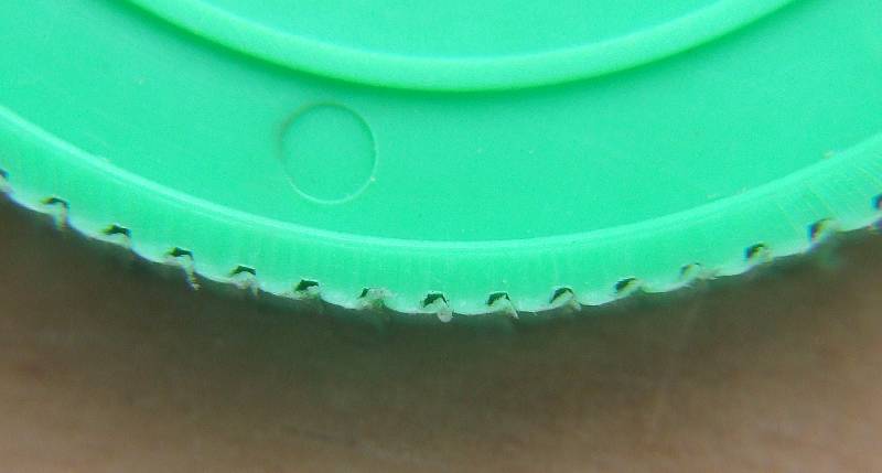

Fresh out of my Losi Desert Truck - slipper was loose too
Hopefully the kevlar one will hold up better, I think I have too much motor for this poor transmission
EDIT: Always a good excuse to take a picture though [&:]

Gah just ate the Kevlar one too, but now I figured it out. This time the slipper was too loose, got too hot, melted a bit, and therefore the spur was able to go off center and THEN it stripped.

Yeah, its not the mesh (this time at least [&:])
The plastic spur died because of too much motor and some nasty driving, and the kevlar due to a loose slipper that melted up and took the center of the gear out with it. When I get new parts for the slipper I'll run it with another kevlar gear but tighter. Ideally I'd find a steel gear for this thing but they don't seem to exist :/

try a new pinion too with the new gear

i chewed up 3 spurs in my vxl before i found the right slipper clutch setting.

right. thats because you have your slipper clutch adjusted properly. the OP did not. so it's not strange at all.
