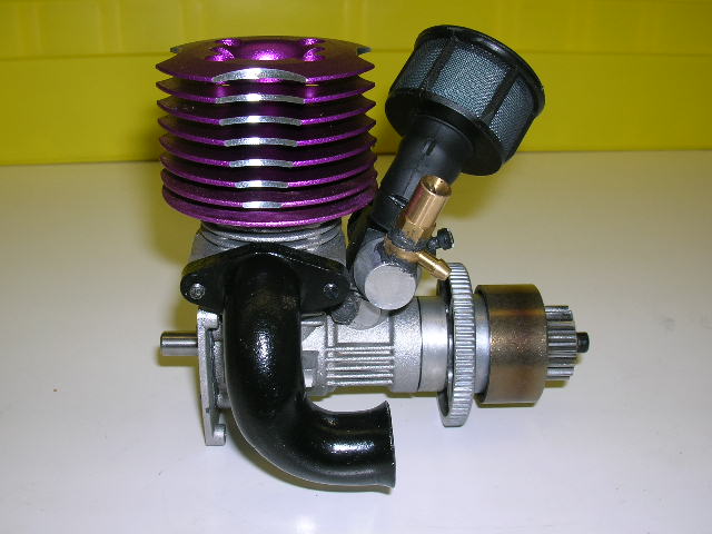

Weeze....
I own a Viper.....
I have done just about every Mod you can think of....
My Truck is Much Faster than the Stock version....
In addition to all the aforementioned Mods, I would recommend THIS air Filter. http://www3.towerhobbies.com/cgi-bin/wti0001p?&I=LXDAP2
The combo of Air Filter, Header and Pipe will Dramatically increase your Performance!!!!
Here are a few Pics of MY setup....

Weeze....
Those pictures I posted are some Old Stock Tires/rims I use for running on Pavement and grass....
When I want to Bash in the Dirt, I install all four shocks, (those are shocks from a T Maxx) and some Proline Masher Tires with some HPI rims.
