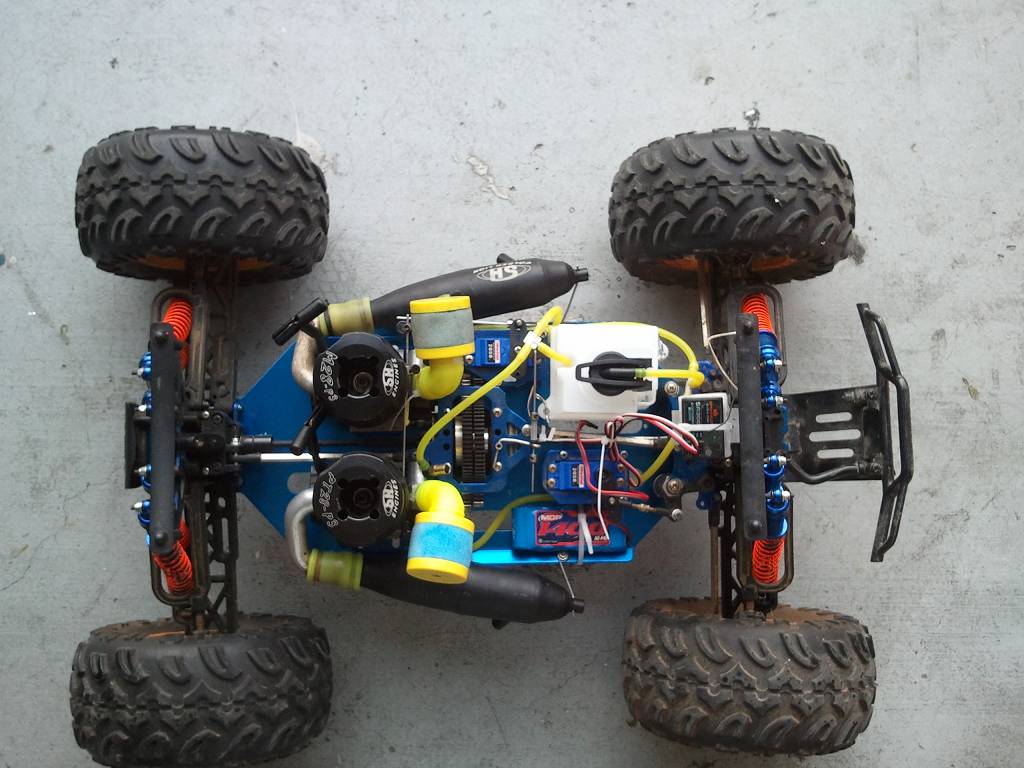

Old 03-18-2011 | 03:46 PM
Joined: Oct 2009
Posts: 277
From: las vegas, NV
Default RE: dual engine nitro
heres a pic of my twin
Old 03-18-2011 | 04:58 PM
Joined: Apr 2010
Posts: 1,048
From: Traverse City, MI
<span style="font-size: xx-large">VIDEO!!!!<span style="font-size: smaller"></span><span style="font-size: small">That is an awesome looking RC and I want to see and hear it run.</span></span>

Old 03-18-2011 | 05:46 PM
Joined: Apr 2010
Posts: 1,048
How do you start that thing? Can you start 1 engine at a time or do you have to start them simultaneously?
Old 03-18-2011 | 05:48 PM
378's Avatar
378
Joined: Jan 2004
Posts: 2,862
From: Lebanon, TN
Most likely one at a time.
Old 03-18-2011 | 05:53 PM
Joined: Oct 2009
Posts: 277
From: las vegas, NV
one at a time
Old 03-18-2011 | 06:45 PM
Joined: Oct 2009
Posts: 277
From: las vegas, NV
ok so im 3 tanks in to the break in process and am starting to have a problem. any advice would be appreciated the motor on the right runs good with good smoke trail the motor on the left has thicker smoke trail and gets much hotter than the other one. on another note the right motor cuts out sometimes thanks in advance
Old 03-18-2011 | 06:54 PM
378's Avatar
378
Joined: Jan 2004
Posts: 2,862
From: Lebanon, TN
Left engine: Thicker smoke trail AND hotter? Well...that's a new one to me. I'd guesstimate either bad fuel, an exhaust leak somewhere(This would cause piss-poor fuel pressure in that engine's tank, which would cause it to run funny), a pinhole leak in the fuel line, cracked tank or perhaps an air leak on the engine itself.
Right engine: Check the plug and make sure that is good. Break in is notorious for munching plugs, and usually when an engine cuts out and it's not an air or fuel issue it's a bad plug. Could also be bad fuel, I'm assuming you're running the same stuff through both engines.
Old 03-18-2011 | 07:11 PM
Joined: Oct 2009
Posts: 277
From: las vegas, NV
