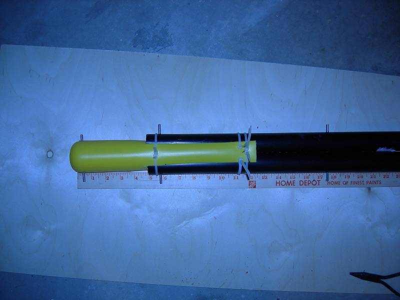

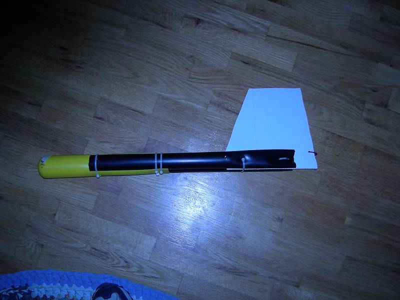

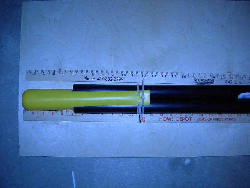

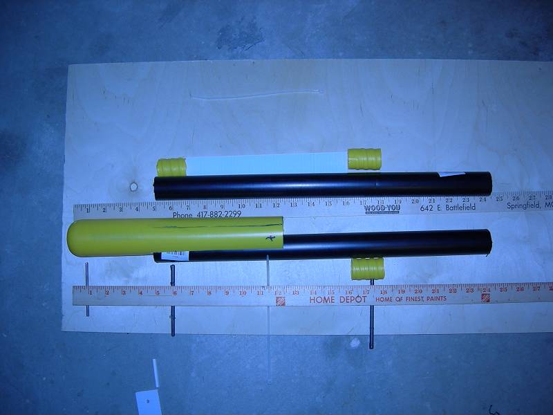

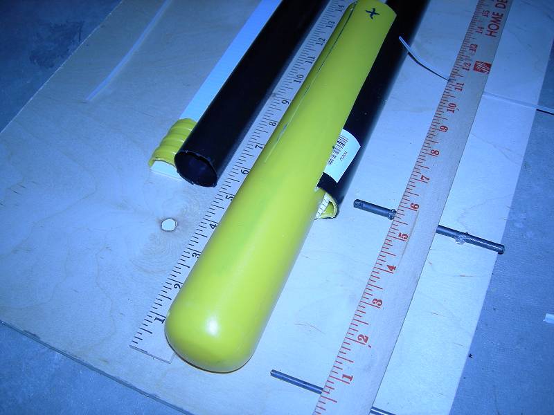

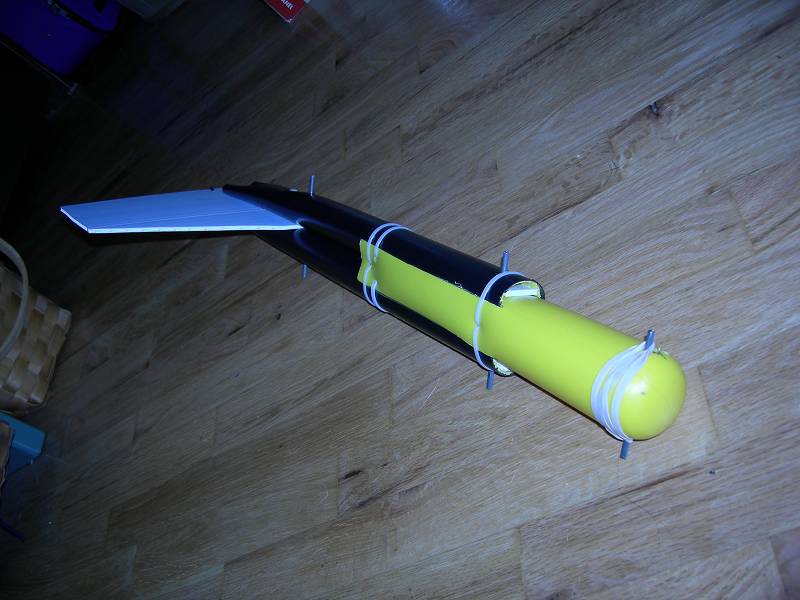

here is the first fuse for an SSC plane i'm trying out. very cheap and solid yet should have enough give to take a few hits.
parts are: $ store bat, and two golf club protectors, zip-ties and music wire. tail not shown will be 4 mil coro. it will have a motor mount on top of the bat that fastens on with rubber bands, but could be fixed solid if ya wanna. 7.30 ounces at this stage. cost so far $4.00 built in an hour or so. once one is good to go 1 hour to build would be resonable. battery and rx will be in the nose, throttle servo on the motor mount, elevons servos in the wing. the coro shown is just for spacing. the pieces from the handle act as reinforcers where the music wire goes through. tail coro will zip-tie in between the tubes. there will not be an elevator, ruder could be an option but not planned on at this time.

yup, tired of dead 15s too, so thats why the motor mount will be rubber banded on to the top of the bat ...hence the forward music wire
the mount is still in the researh and development stage. [sm=72_72.gif]

this fuse is generic as it will work for many sized planes. it seems that it would be a good sub for any of the spad alum rail fuses. a coro horizontal stab/elevator could be fastened under the aft tubes quite easily.[:-]

i think i forgot to mention that this is based on the .15 simitar SLOW MOTION plans from AMA. i am simply using combat construction methods but not really changing any part of the design aerodynamically. any one who has done any combat will recognize the building methods. ive been slow to build much this season do to some problems with my neck but will get that fixed soon so keep checking. hope to fly some combat this fall.
