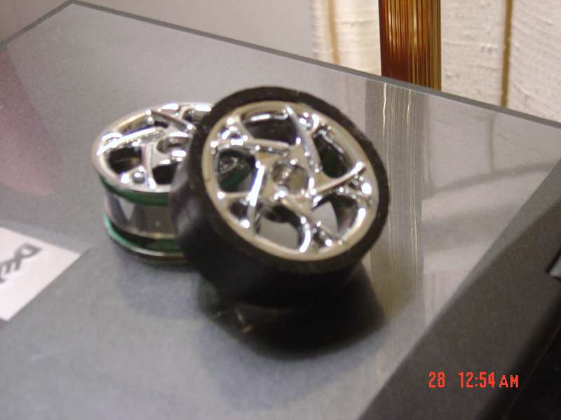

For me atleast, the tires and rims both did not fit into the PVC, so I just used the rims, and used Pactra paint to paint the edge of the PVC black so it looks like a tire. It works great, even without the tires, so dont worry if it doesnt fit. I just used my rims inside the PVC. Here is an example:

Old 06-06-2004 | 10:17 PM
Joined: May 2004
Posts: 12
From: Fort Wayne, IN
Default RE: PVC Pipe Problem
Thanks for the reply.
Alright, well how did you get the rim to stick to the PVC?
And does it stay black after you run it a few times? I would think it would wear the paint right off the bottom.
Oh, and do you know where I could pick up another set of rims cheap so that I can switch between sets of tires?

I just took the rim into the hardware shop, and fit it into several pipes, until I found one with a snug fit.
