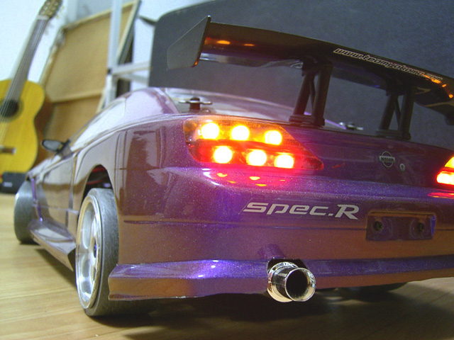

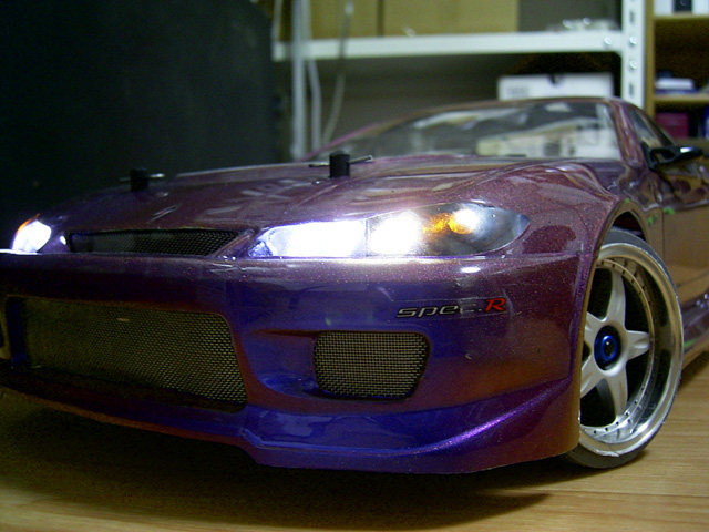

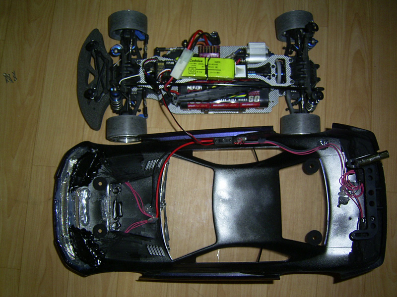

had to add 2 more pics. These LEDs thow out some seriouse light. the lights are on in the room this entire time, and at night they are mint!!! they shine on the ground and everything. too Slow
You did a really good job on those lights, they look good.

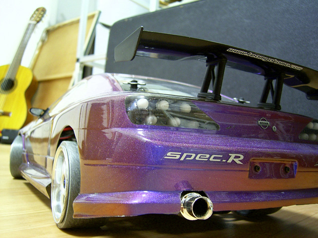

How did you make the surrounds behind the front lens that the LED's mount into? What is it made out of?

It's a distributed weight of about 2 oz just LEDs and Wire. the battery is the chunker. NO DO NOT TRY TO RUN LEDs OFF YOUR 7.2v car batt. it's a 6v 600mAh reciever battery. I use resistors to make sure the voltages are right (probably should have gone with a transformer. less draw on the circut = less heat, but more weight) and I'm working on a circut to brighten the Red Tail lights when i hit the brakes. also use the chanel 3 on my radio and reciever to turn on and off the high beams. I tried to make the projector high beams look right so i went searching in some of the electronics stores here in Japan for the right looking part. it's a simple chrome housing that you can buy in radio shak, i just swaped out the red LEd for my White one. as for the regular headlights, those are 10mm white LEDs with a curved piece of plastic painted silver as the reflector. the black housing that the yellow marker light is in is another radio shak housing part. really simple stuff but it looks good.

I think that's like 14 LED's I see there? About how long does that last battery wise? Usually the white LED's run at a higher voltage than the colored tail lights so you would need to use multiple resistors to wire up a system like that.
Personally I'd run a system like that off a 9V battery using separate resistors for each different LED type all out of one junction box. You can calculate the resistor size yourself or use an online calculator such as the one [link=http://www.luxeonstar.com/resistor-calculator.php]here[/link]. You could alternatively run the LEDs off the main batteries but I'm not sure if this would have a noticeable affect on performance of the car. Just substitute 6V in place of 9V to get the resistors to use based on that type of setup.
My only problem now is finding a way to mount the LED's in the body. I was thinking about drilling and cutting scraps of lexan to fit. Then spray the backside with silver for a mirrored finish and put the LEDs through. Then just glue the whole thing into the back of the body, it would be a bit tricky to get a good fit but I'm sure it could work. If anyone has any other suggestions or what you built yours out of do post them in here. I built a setup for some of my monster trucks but the bodies are quite a bit smaller on these touring cars.

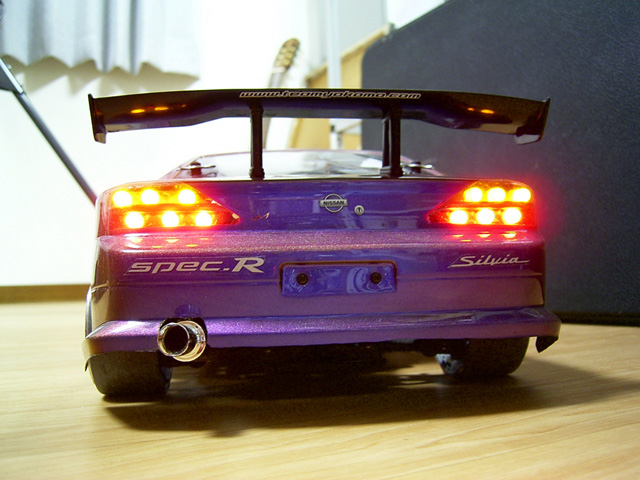

18 LEDs on the car. 6 red (tailights), 8 yellow, 6 on rear 2 on front, 2 10mm whites (main headlights), 2 5mm whites (projector High Beams). I did not wire all these in series because if/when one does burn they all wont die. like christmas lights, if they are wired in series then one goes, they all go. if they are individual then one can go and the rest are fine.
I did use separate resistors on each light, but not from a junction box. I put the resistor right on the lead to the LED so the whole circut is 6v it just steps down to running voltage of the particular LED just before the power gets to the LED.
The resistors probably weren't a good idea because they create alot of heat. heat = power loss. so i'm burning lots of power and not getting any light from it. with a transformer you're running a closed 6v circut - going through a transformer - then running a closed...3.6v circut. then you can resist that voltage down to run the others 2.7 for the yellows and 1.9 for the reds. oops i just spilled the beans on the peak operating voltagefor different color LEDs.

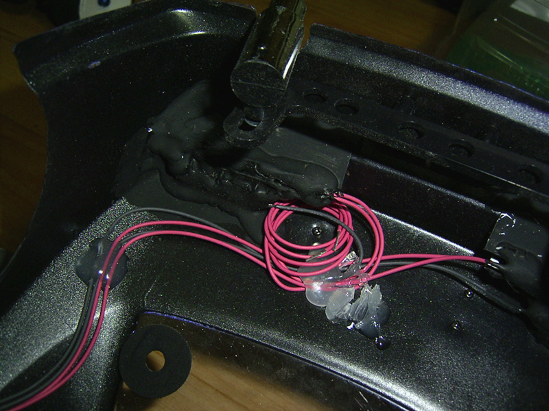

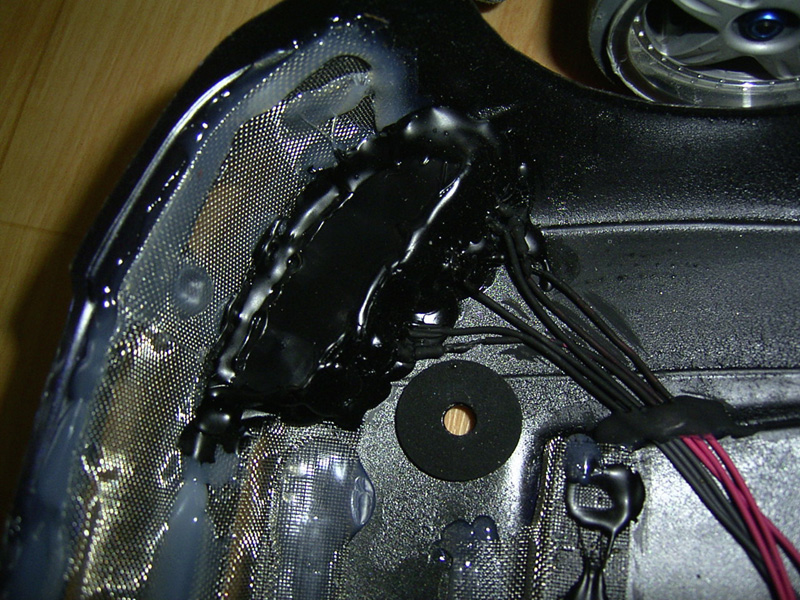

My mounting sistem is hard into the body. it's not as pretty from the inside but it works. i created some plastic pieces and painted them various colors. ie Silver and flat black. then potted the LEDs in Hot melt right to the body. soldered my resistors and leads on then painted it all flat black.
I'll post inside pics in like 10 min.

With the type of light I use you only need 2 max. The light I use is so bright it can blind you if you stare into it.

I use so many lights so i can duplicate the real car. 2 headlights, 2 projector/high beams, 2 markers and an array for the tail lights. also, because I can. that's why. and yes mine are very bright too but no LED can be bright enough to blind you. without some lense refinement and overdriving the LED.

see I told you the Inside doesn't look pretty.

I'm working on the brake lights. ( if you look at the 3rd pic of the inside you'll see the coiled up red leads) those lead to a lower Ohm resistor allowing more current to flow thus making the light brighter. still working on the circut for motor input from my esc to run through a FET system to actualte the brace lights.
Same Deal with the high beams. i still use the 6v batt to power them but given the voltage from my chan 3 off the reciever it turns the headlights on or off. i really don't want to say more than that as someone would probably Pirate my circut and sell it on their website fro exorbidant amounts of money.... yes you.

the Fets are in that glob of hot Melt. and I unplugged the rest of the circut from the switch box on the body to the reciever so nobody would see it. sorry bro.
Alright man, that's okay. I can understand someone wanting to protect their invention so I wont pry.
