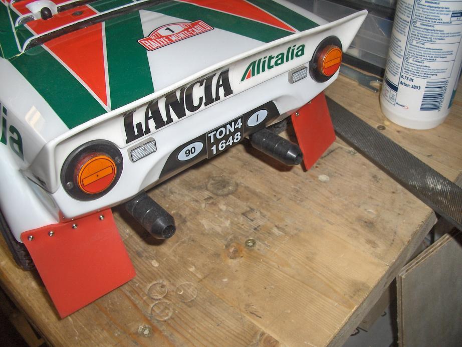

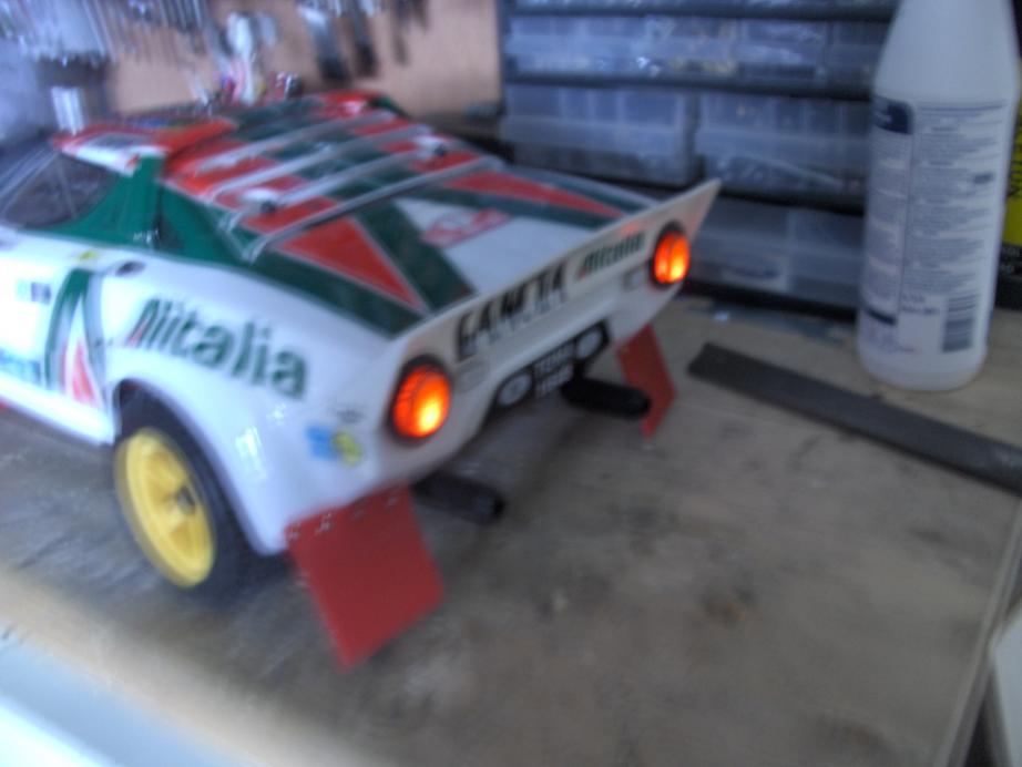

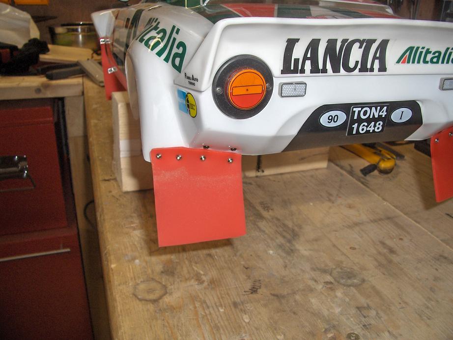

And here they are. Maybe a tad too thick, but if they were any thinner they would end up difficult to work with, and too flimsy. I like them just as they are now

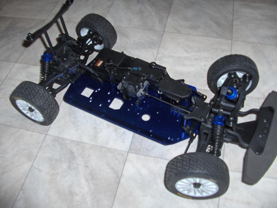

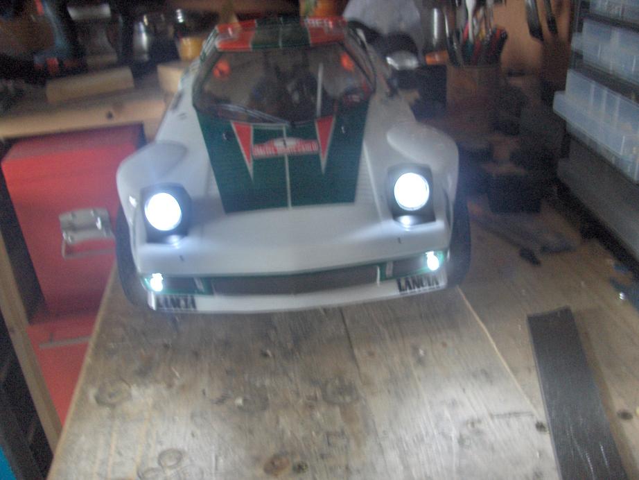

Finally got my car! I thought until the day i got it that the headlights was stickers, but they are not, and they are LED-ready So i will put some lights in these soon, and also in the rear lights.
The guy in my hobby shop was so nice that he was willing to trade the nitro engine for a 1/8th brushless combo, so i will go down to the shop again tomorrow so he get the nitro engine in return after i have taken it out of the chassi. If that wasn't enough, he also gave me almost 50% off on the rims, tires and foams! So i will soon start the conversion now, and also to make some 17 mm adapters for the Landmax-wheels.

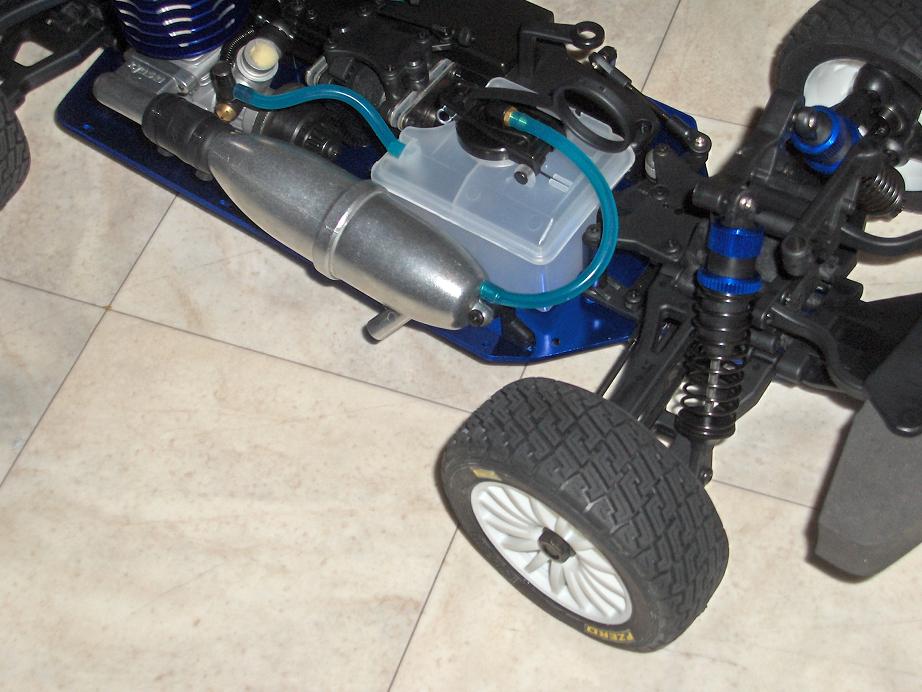

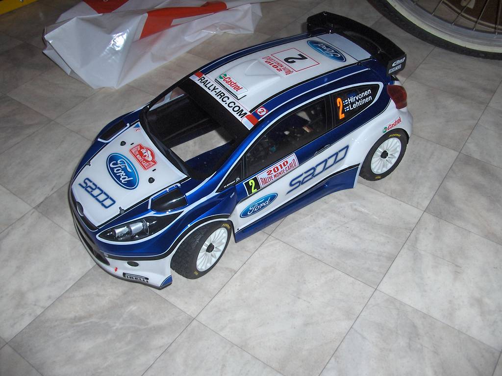

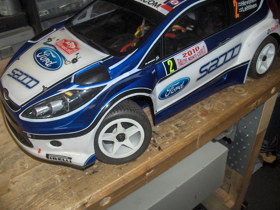

Nice project. I have one of the 1/8 scale Landmax's with the Lancia body. Also has the two-speed. Definitely one of the coolest looking rally cars around.

That should be no problem. The stock tires for the DRX fits right on the Landmax rims, so if you get in contact with a Kyosho dealer i am sure they will get a set of rims for you, just as my hobbyshop did.
I have been admiring your Stratos a bit for a while, i think it looks very cool in blue

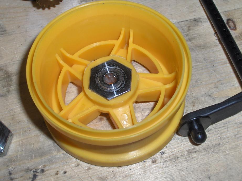

Made some 19 mm (all the time i thought it was 17 mm) wheel adapters yesterday. They might not be beautiful, but i guess they are functional Some pics of the chopped up and modified radiobox aswell.

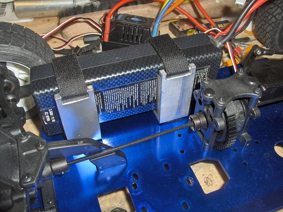

Had to make some battery holders, so here is what i came up with I am pretty satisfied with them. Bought some velcro strips to keep them in place nice and firm, and added some self adhesive window seals from rubber to make it a bit softer for the battery, and also to keep them in place so they don't slide back and forth.

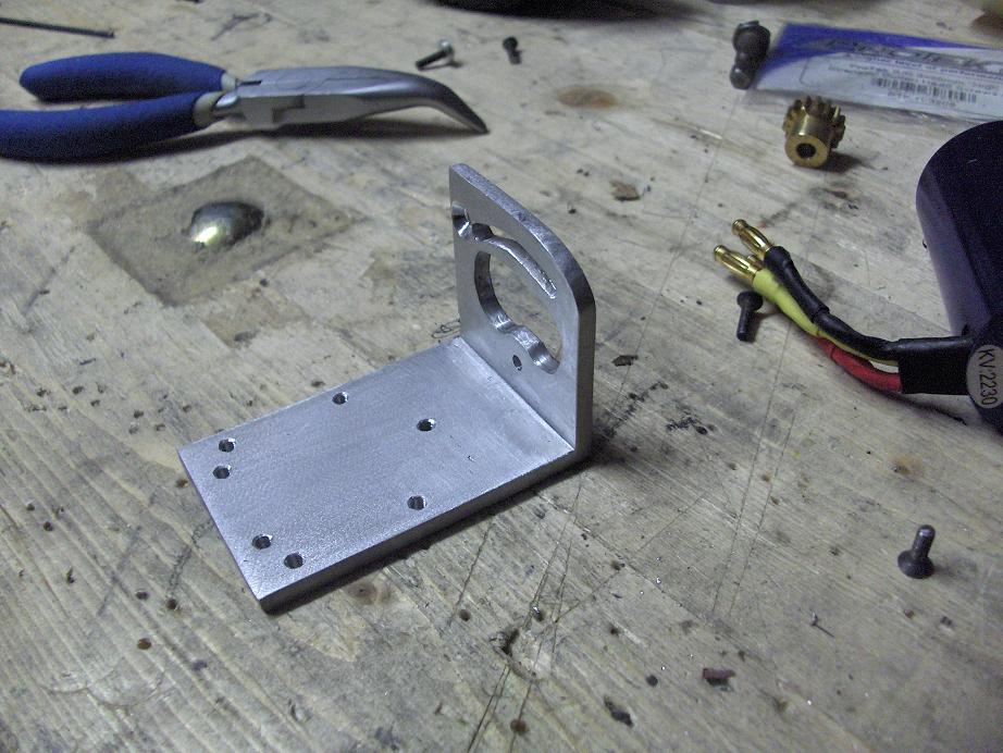

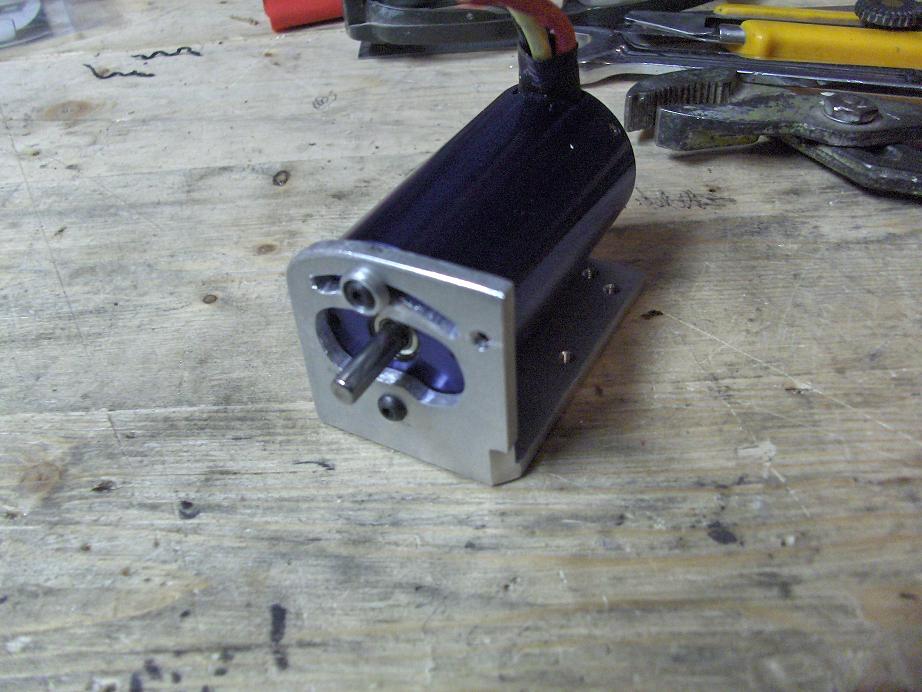

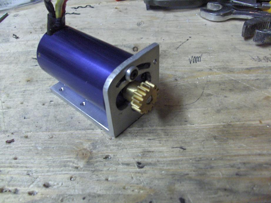

Finally after some cutting, drilling, tapping, filing, "dremeling", sanding and many other words i don't know, i got the motor mount done! I am pretty pleased with it, and the way i solved the challenge of making it adjustable for different sized pinions in an easy way. Maybe not a beauty, but will still do what it is designed for.
The little slot i have filed out on the bottom is to get it close to the diff mount marked with a red arrow in the chassi picture. This allows me to put a screw through the mount (the countersunk hole) to secure it to the diff mount and into the hole where the brake pads used to be.

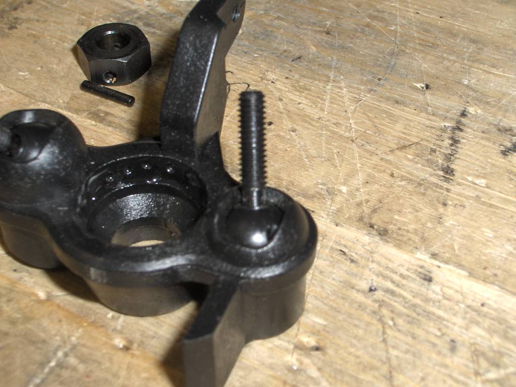

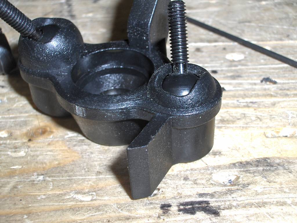

It was an impressive slop in the steering and the wheel hubs, so this had to be fixed. Which would be totally unneccessary if Kyosho had made the parts with the right tolerances at first! There is no excuse making this sloppy parts for an rc-car nowadays. Sometimes i wonder how Kyosho has won so many championships, but i guess they didn't won them with sloppy parts.
That aside, here is what i did; i took off the hubs, finding the bore in the hub for the large inner bearing to be the sloppy part. I then took a centrepunch and worked my way around the boring for the bearing, making the plastic expand. Then i filled it with glue, which when harden will fill the gap between the bearing and the hub. Installed the bearing, and away and gone was all the slop.

So here is how i fixed the steering and its exessive play, i simply replaced it all with Traxxas ball links. Now it is totally free of slop and play, and very nice and tight. The stock links that followed the car isn't even worth keeping. Too bad.
[link=http://s753.photobucket.com/albums/xx171/Heimelaga/?action=view&current=HPIM2763.mp4]Link[/link] to after-video.
ID:	1737696   Click image for larger version
ID:	1737697   Click image for larger version

And the modifications continues... Have got a new radiobox which originally is for DBX VE, but fits nice on the DRX too. I think it got a bit cleaner with this one. It also strucked my mind that i should have had some exhaust pipes, so i made some in my lathe out of nylon bolt.
I was lucky to get 6 more wheels aswell, i tried to order directly from Kyosho America where i found them but they wouldn't ship abroad. So i got my dear cousin who is studying in the states to order them and ship them to me. Thank you, Børge The 4 wheels i have left i am thinking of getiing some Road Rage-tires for as they are a bit smaller and made more for asphalt than gravel. I think they will look good.
ID:	1763182   Click image for larger version
ID:	1763183   Click image for larger version
ID:	1763184   Click image for larger version
ID:	1763185   Click image for larger version
ID:	1763186   Click image for larger version
ID:	1763187   Click image for larger version
ID:	1763188   Click image for larger version
ID:	1763190   Click image for larger version
ID:	1763191   Click image for larger version
ID:	1763192   Click image for larger version

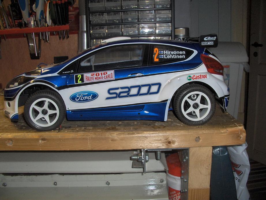

Got some new tires for it (the Fiesta, Pro Line Road Rage) which i intended to use with the yellow rims on the Stratos. They wouldn't fit on those rims, but they fit well on the rims made for the DRX just for your info. So there i was without any rims to put them on, i wanted to try the HPI 100868-rims and they fit very well! They build 2 mm more outward to the wheel arc than the stock ones, so they fill the arches very nicely. The diameter of the wheels are a bit smaller than on the stock ones, but they don't look too lumpy as i think the stock one does.
ID:	1797054   Click image for larger version
ID:	1797055   Click image for larger version
ID:	1797056   Click image for larger version
ID:	1797057   Click image for larger version
