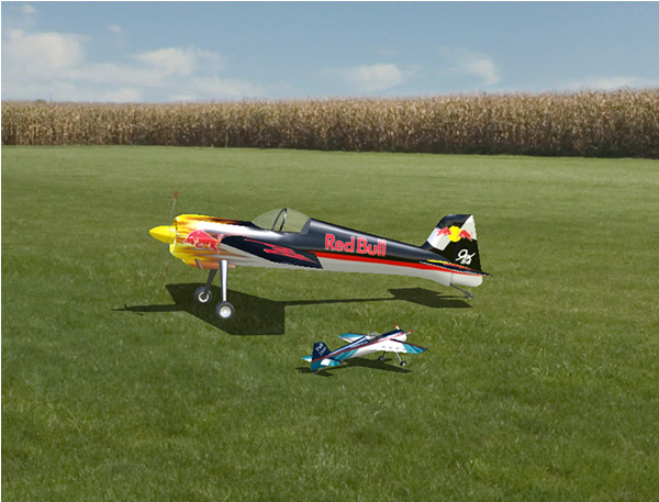

He did it again. Does anyone else feel like it's Christmas every day?
The Yak-55 SP Mini.

If anyone wants the Mini Yak just email me. There are a couple of updates needed before posting it, but I can email you the file and the parameter changes.
[email protected]
D
Old 01-17-2005 | 04:24 PM
  #32
My Feedback: (21)
Joined: Mar 2003
Posts: 9,227
From: Manhattan, NY
Default RE: Mini Giles rocks!
OK ... the mini Yak is up at aeroflypro.com/download (3D Forum)
Enjoy! Thanks Rodeo .... again.
