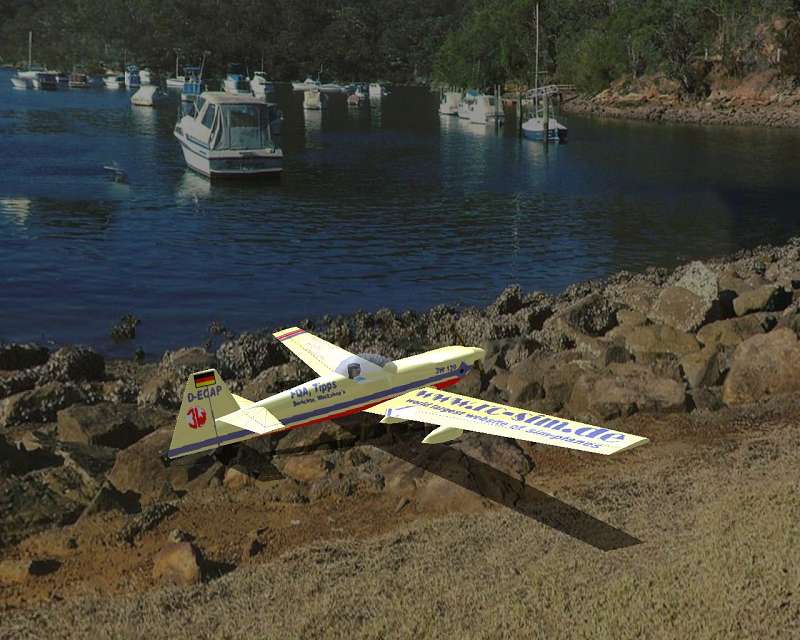

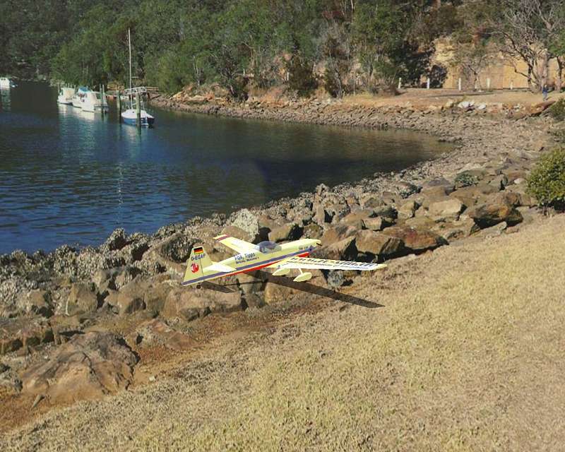

2 screen shots of apple tree bay, the 2nd shot is with LIGHT_AMBIANT set at 0 0.55 0.55 0.55
and the 1st shot set at 0 0.85 0.85 0.85 this is my adustment to the lighting. your tool exept for the 3 scens named above works great very pleased with it. Looking forwards to the reflex tool, many thanks again.
Regards Dave
Regards Dave

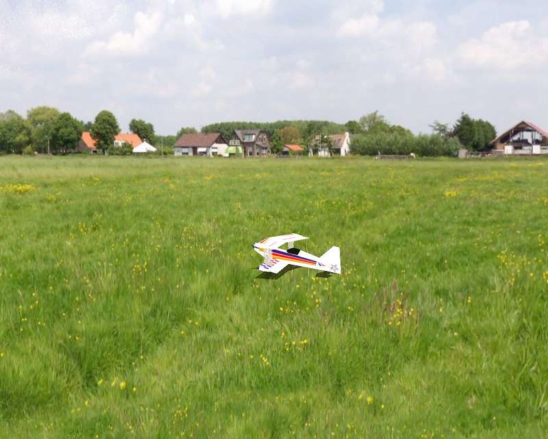

i have my AFPD sim for 2 days all thing is all right.[8D]
1:but a can not convert reflex scene..
2: and second there are 2 scenery( DELFGAULWUCHT GRASS & WOUDASFALT (bmp files)AFP or AFPD( the second with air mill)...... at this time i can not see nothing..... all is black except planes)
and the object file ( open by note pad) there are not like the others scenery who works.
below is the file before and after change i made : no difference
