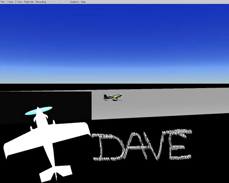

HI CODEY
Problem now is when converted and i open the senery up in the sim
and its only on a couple of scens, i get top half of screen sky blue bottom half black with the plane in and a white shadow of the plane been in the geo played around with it and the screen goes black or it comes back to the above.
These i finally got working (MBC Markt Schwaben im Oktober), Also this one is now working (Heli IG-Amt im Schnee). in AFPD
DONT ASK HOW CAUSE I CANT REMEMBER HE HE HE
This happens on (Plankstad_mittags) even the new AFPD down load wont work. from AFP & AFPD scen from rc-sim . see screen shot below.
and also (Mammendorf) from reflex scens from rc-sim. converter wont read at all m8.
Ive toyed around with 2 scens above and still the same codey hope you have better luck latter.
Appart from these most of the others run ok.
by the WAY AMAZING BRILIANT TOOL M8

Old 02-26-2005 | 12:29 PM
Joined: Jan 2004
Posts: 129
From: Sammamish, WA
Default RE: Get the Reflex and AFP conversion tool for AFPD here
dafid: Ok, I'll take a look at those. I'm thinking it might be something to do with spaces in the filenames. I won't be able to look at it until Monday. WHat happens if you rename the source folder so there are no spaces and the panoramic image (although it's probably something like S1.jpg so it's fine).
