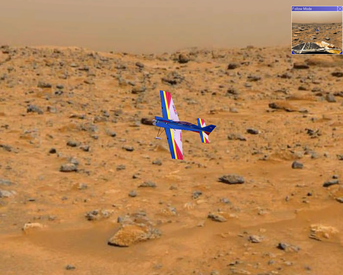

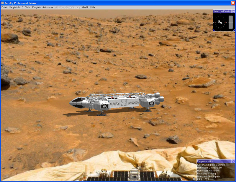

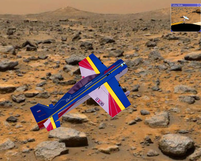

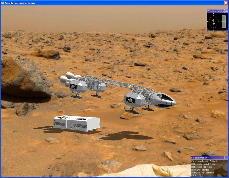

Rodeo, please believe me I'm not trying to say that posting the Reflex images is not the right thing to do. However I was just explaining that it is possible. Especially since Reflex did not copy protect the images and made them available to download for free in their demo.
So to sum it up if you want to use the Reflex scenes for your own personal use just dload the demo and use them however you like. Just please do not pass or post them without permission from Reflex.
Also if you do a Google for "Panorama" or "Panaramic" you'll find some great ones out there. Just look for ones that have the proportions to fit close to 8192 x 4096 (which is 2w:1h). Like this one I found of Mars (see pics). Anything over 4000 x 2000 is good to use. Anything less will be pretty pixelated.
There are also some GREAT VR images out there that can be stiched together real nicely using screen capture and stitching software. Since these VR images are already pre-shot with great cameras and lighting the images are going to be really nice. Here is a link to some great VR images. http://www.panoramas.dk/ use the dropdown top right corner to see them.

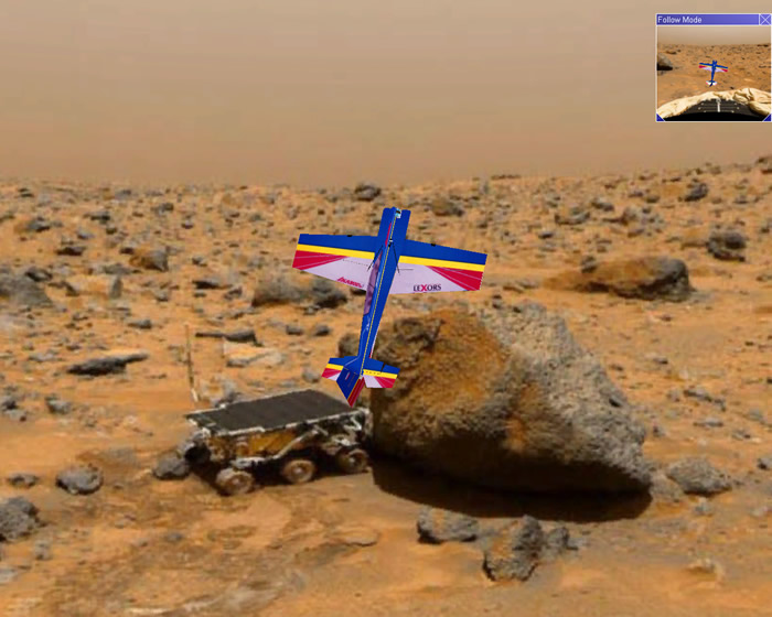

Right mouse click and save [link=http://www.aeroflypro.com/mars2.jpg]here to get the Mars image for AFPD[/link]. Public domain image, feel free to use it however you like. Couresty of JPL, NASA and the American taxpayers. You can install it using the fabulous AFPD Installer.

But Mars surface looks rather unfriendly for our models [&o].
We better stay at our terran airfields

What you guys don't hand launch and hand catch models in Germany?
Also I want to be the first person to hover a foamy on Mars or even the moon ... of course on Mars it will melt in the daylight and freeze like a rock at nite. But hey, there has to be at least 1 minute of the Martian day where it's 70 degrees for at least a couple seconds.
I hope one day IPACS works that into the program where you can reach out and lanch or catch your plane. Now that would be nice.
