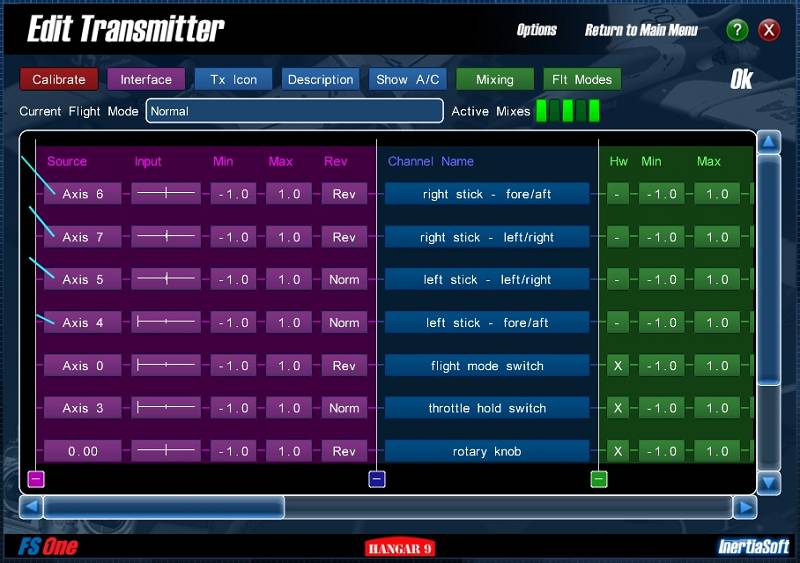

Hi Guys,
I got the axis switch, Trial and error, took me about 6 attempts to figure out how the sequence. Still it would be nice to know if I can make this text visible, even though my system is under minimums.
As an aside, in the options pane I set the window to windowed 800 x 600 and when I'm flying around in the Decatur Club site I'm getting 200+ frame rate. I knew no one would believe me, so here are two screen shots.
Scott
Scott

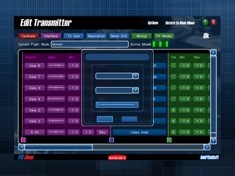

#1005
ORIGINAL: sctholson
Terrific Michael;
I'll check out the revised FAQ. One concern that I don't really need to address now but is on my mind, is that; I was under the impression that if I wanted to I could actually use the mixes in my Spektrum transmitter instead of FSOne software. This latest "reset as if it is an airplane transmitter" issue sort of makes me think that the original idea is not an available option anymore. Is that now a correct assumption? If it is not it sounds like the result would make a good future FAQ.
Now for my other comment, since I cannot see the text fields in the transmitter editor I'm just going to try out different selections on this channel, maybe I'll get lucky!
Scott
<snip>
Terrific Michael;
Scott
<snip>

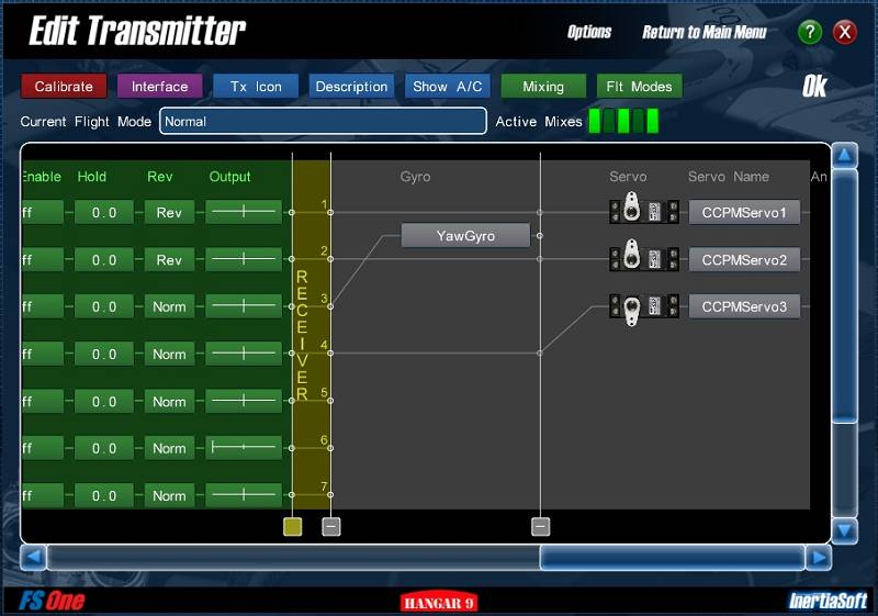

I've not set-up a heli for this, but I can outline the basic concepts. The first image below shows the Blade CP heli FSOne Tx (the one you're using, referenced above). I used the slider to move the panel to the right. On the right, this is the stuff inside the heli. The stuff is grey because in this window it's the Tx Editor and not the Heli Editor. So to avoid confusion you cannot edit the heli here. That's also good - you don't want to edit the heli. The heli has all the Rx and gyro and servo gear the way it needs to be (like the real Blade CP).
To use your own DX6 Tx set in Heli mode, you need to start w/ this baseline Tx (the one you're using) and delete all the mixing stuff that the FS One software radio is doing. Click on the mixing button and delete the mixes (second image). You're going to use your own Tx Mixes. Click on the flight mode button and delete the flight modes. You're going to use your own Tx Flight Modes.
Now in the third image, the four channels from the Tx are shown on the left. Assign your axes from your real radio accordingly (according to the labels which are consistent w/ how they are hooked up to the servos).
Doing this will be difficult (impossible?) if your buttons are not displayed properly. I asked Brian about this button issue, and he recalls it happened once before w/ another user and it was related to computer graphics driver issues. It was resolved ... probably w/ installing new drivers (which is not so easy on a laptop when some times you need to use the specific ones that came w/ the laptop). You're mileage here may vary .... Let me know how you get along here.
Postscript: Does the DX6 let you set your own pitch curves for mixing?
Caveat/Disclaimer: Did I say before I'm no heli guy.
Michael
#1006
Joined: Jan 2007
Posts: 297
From: Woodstock, VT
Michael,
Your too modest. Seems like your ready to take the heli plunge!
I'll have a go at this process.
1) I did replace the graphics drivers today, I'll hunt around for an alternative set and see if this makes any difference. If it does I'll report my findings.
2) I'll need to reset my transmitter to heli mode, correct?
Scott

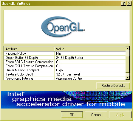

#1011
Joined: Jan 2007
Posts: 297
From: Woodstock, VT
Hi Brian,
I totally understand about the minimum requirements and really appreciate your interest in helping anyway. No worries,
Here are several screen shots, along with one from the Intel software (I think they must be trying to emulate Open GL compliance? Just a guess on my part)
Scott
Scott

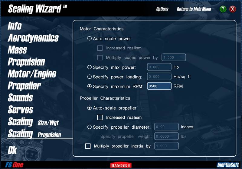

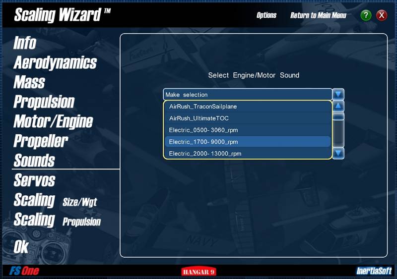

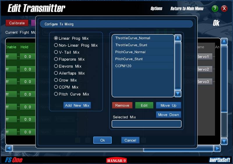

#1024
The scaling thing is definitely a new concept w/ sims (well only FS One has it). It evolved out of the sim as we worked on various things.
Basically, anything that is set prior to the Scaling tabs defines the airplane ... that can then be scaled. The scaling can be simple, like 'grow/autoscale the plane by 2x, 200%' and let the chips fall where they may, or scale the plane up and then selectively over-ride items to add extra definition.
I find it easiest to go in this order:
- set the wing span
- let the weight autoscale, or set it to what I know it should be for the larger/smaller plane
- autoscale the power, or set the HP or set the prop speed to what I want
- autoscale the prop, or set the diameter to what I want (leaving the weight at zero to autoscale the weight)
- then go back and pick a different sound. In the menu, the sound files indicate the range overwhich they give proper sound. So the sound file RPM range does not define the prop speed. It just has sound in case it's needed for that RPM.
- then sometimes I go back and set the control throws
- I don't often swap from gas to electric, but that step is easy as shown in the screen grabs above (taking the gas Ultimate to electric).
So the steps are pretty simple and it seems to work 99.99% of the time. It's amazing when it comes to the amount of scaling. If a plane goes from say a 3 inch span up to 30 ft or 300 ft, the power can change by many many orders of magnitude. I would have no idea how to guess numbers like this ... It blows my mind that it all works. I think I've said that before in these forums.
Michael
