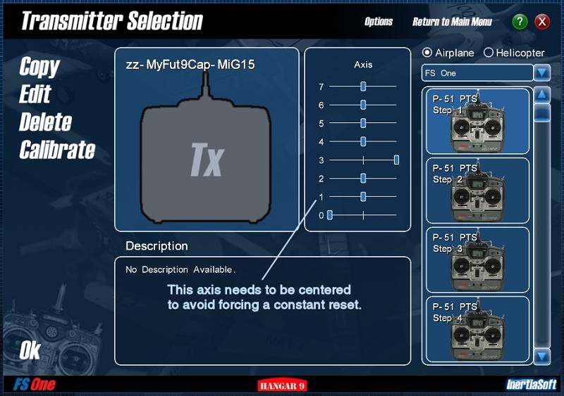

If it might help these are screen shots of the xmitter editor. I was incorrect in my last post when I said the throttle has no effect on the plane in the " Show AC " inset. It behaves in the same was that it does " At the Field "
I deleted the setup, recreated it and recalibrated. Same result.
Pic 1, 2 and 3 are with the stick centered. Pic 4 and 5 are throttle stick up and down.
Thanks again.

The solution is to center the dial or switch that's connected to Axis 1. Axis 1 should be centered like shown in the image below.
Does that fix it?
Michael

That makes sense. It does appear to be in a constant reset when you go to the field. The messages appear and reappear in the top left corner.
That particlar axis is on my trainer switch and is spring loaded. Axis 1 is not on the edit screen.

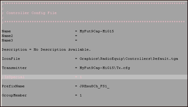

One is to take your radio and move that channel from the two-position
trainer switch to a three-position switch or dial so that you can set
it in the neutral position (InstantUp/Reset not active).
The other solution is to edit the Tx file in windows. The file is
located here (using the name in the FAQ example):
C\:Program Files\FS One\RadioEquip\Controllers\MyFut9CAP-MiG15.cfg
Comment out the line with the "IsSpecial = 1" by placing a semicolon
at the beginning of the line like shown below. When this is done, it
will turn off the InstantUp/Reset functionality for that radio. Then
use the keyboard (spacebar or 'u' key) for resetting the airplane.
(ps, Yes, Axis 1 is not in the edit window.)
