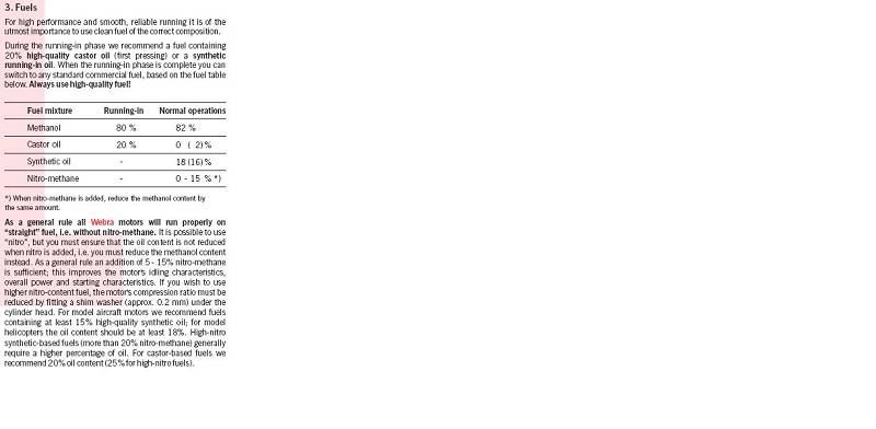

While brousing Rotory Modeler Magezines' website, I copied this article to my clipboard a long time ago.
HIGH PERFORMANCE HELICOPTER FUELS
Nitromethane: can truly be deemed "Liquid Horsepower" for model helicopters. For additional power and generally smoother running, our flying machines can't really afford to live without it!
If the engine performance of your R/C helicopter is proving to be a bit of a problem for a whole tank of fuel, and you suffer from overheating as the tank empties during hover, or the idle is difficult to get "just right", it may be that a dose of good old fashioned "nitro" is what the engine doctor would order.
Nitromethane is a liquid that has been around for a long time and is used to contribute towards smoother running and increasing power in varying amounts of many model fuels. In addition to altering the power output of an engine, it also contributes towards cooler, cleaner running, smoother idling, and easier starting. Of course, the positive affects of nitro must be weighed against the cost of the magic liquid, which can add from $2 to $4 per gallon per 5% of nitro.
Other than the plain fact that nitro is probably the easiest way to increase the power output, or smoothen the run of a model aircraft engine, the whys and wherefore's of nitro are not well understood by most modelers (or anyone for that matter, based on the trouble I had finding information on the subject) so what follows will attempt to shed light on the mystery and help heli flyers decide whether they need use it, and if so, how much.
Nitro is manufactured in production volumes by mixing nitric acid and natural gas (or other hydrocarbon base) under high temperature and pressure. It can be made in the laboratory by some complicated mixing and distilling of acetic acid, sodium carbonate, and sodium nitrate which is rather hazardous.
The element that is most important is the oxygen which "disassociates" from the liquid at high temperatures. While Methanol has almost the same amount of oxygen (50%) by weight, it is the overall "mix" that contributes to the unique nature of nitro, allowing a much higher fuel flow and the typically inert nitrogen which can serve to "soften" the shock of the combustion process and inhibit pre-ignition (this is not to say using nitro prevents pre-ignition).
All fuels, whether gasoline, methanol or nitro (which incidentally can be burnt at 100% mix like most fuels) have a "stoichiometric" (I brought this word in in a wheelbarrow!) or chemically correct air to fuel ratio, at which they theoretically (as calculated by chemists on paper) burn the most efficiently in air. With gasoline it is 14.9:1 (air to fuel) with best power at 12.7 and best fuel consumption at 15-16:1. Gas puts out 2.78 kilo Joules of energy per kg. Stoichiometric methanol burns best at 6.5:1 or twice the liquid (by volume) for the same amount of air as gas and produces 2.67 kJ per kg, slightly less than petrol, but typically produces 10% more power due to the temperature drop of the mixture as it vaporizes, which produces a more dense mixture (higher density = more power). Methanol burns twice as much liquid as gasoline because it carries its own oxygen supply along with it (50% by weight).

RE: Do we really need Nitro???
I'm preparing to break in a Webra ABC engine, and the instructions call for a run-in mix of (true) FAI at a needle setting just breaking into two cycle, and a total break in time of 30 minutes, with varying speeds.
After break in, I can add synthetic and nitro. This is going against the grain of many here but thought it would be interesting to point it out. Webra seems to have a pretty good reputation in motors, and I guess trust them with what an ABC should experience.
I included the fuel table and reference notes from their website.
One question that I was searching for when I chose this thread is what is the best oil mix (or no oil mix) to use if you want to have the longest life out of a motor, ignoring the "high-performance aspects of nitro" and just sticking with the best oil mix and good old methanol.
Is it safe to say by just running Grade AA Castor is number one, and only goes downhill from there when you start adding synthetics?
Is there a thread started on this somewhere? I looked through the entire FAI threads and only found this comming close to the wear issue. I guess this is more of an oil question than anything.
I want to keep my motor going as long as possible, as it is now long outdated but still new and has turned into one of my gems, and get a good handle on what to put through it for fuel to keep it safe and happy. It is a large enough displacement for my application to where the power of nitro would be considered excessive, and the engine is designed around FAI fuel.
ORIGINAL: fancman
Canadianjosh.
If you run a brand new ABC engine very rich you will indeed run the risk of ruining it. Ask any mfg who makes them.
Canadianjosh.
Actually all of the Mfg. instructions I have read says to run them very rich. I don't see any saying to run lean or even slightly rich, usually as rich as possible without four stroking. Which is very rich since most do not easily four stroke.
ORIGINAL: jetpack
Actually I've never yet come across an engine that won't 4 stroke quite easily, in fact I fly my Rossi 45 in a 4 stroke in level flight so when it goes into a manoeuvre or steepish climb it leans out into a nice 2 stroke.
