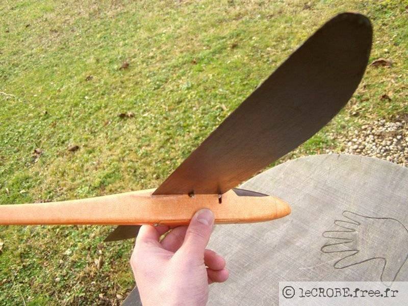

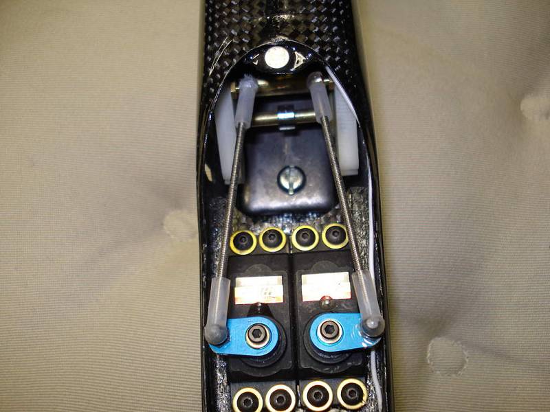

CBM Racing you are correct. A pitcheron pivots each wing panel in opposition to each other for roll control then in tandem for pitch control. A wingeron only uses the wings for roll and the stab for pitch.
All linkages are internal.

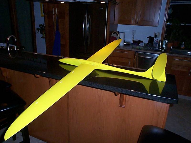

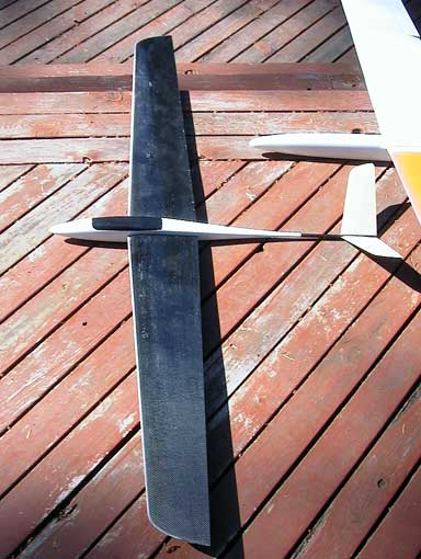

HaHA! I think I got it now... Maybe... Ok the first is the VERY elusive Kestrel... only 12 were produced I believe and the last one that changed hands went for 1200.00 supposedly. The next is a VMax then Shrike and the Blingeron. The mechanism for such creature are relatively simple but there a gentlman out there that puts his sweet into machining these works of art specifically for TWFs. OOOOOOOOO! AAAAAAAAAH! Fabulous.

Very nice indeed. Love the pivoting mechanism, brilliant!

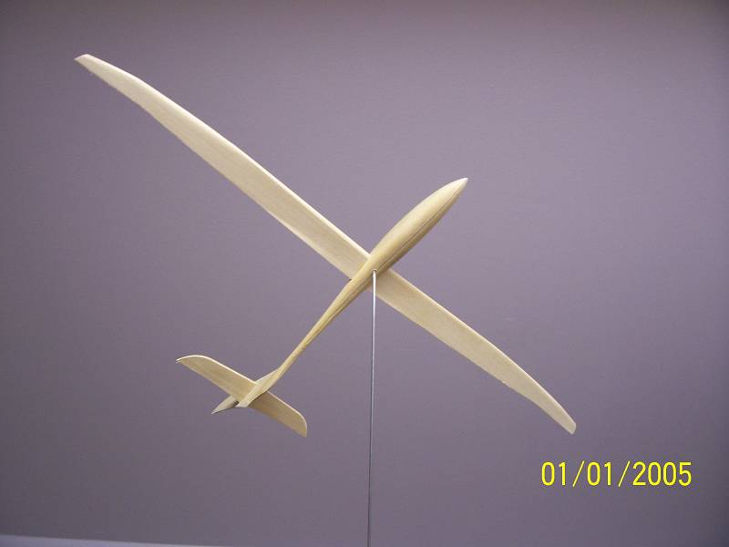

Ok couple of pics, I'll post some more later tonight. Tell me what you guys think. ALL comments and suggestions welcome. Wait til you hear the story of what this design was inspired by.

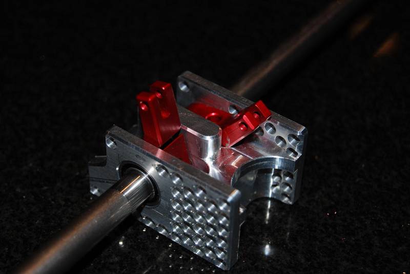

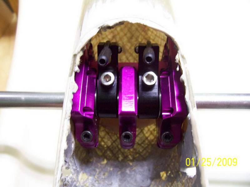

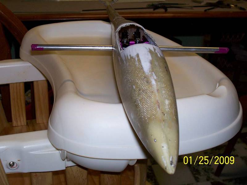

Heres a couple of pics of my much battered and abused VMax with her new monoblock bling sitting in her.
I actually buried her up to the leading edge in the mountainside once and I literally had to grab the "boom" end and push/pull it back and forth a few times to loosen her enough to pull her out. That day she was sporting her 48"ws with the throws at max, read 30' up and 30' down! I She rolls about 5 to 6 a sec this way and as usual I thought I was right side up whe I pulled away from the face.... you know what REALLY happened.
Her original wings were 72"ws with actual spyderfoam cores. I'd like to get my hands on a big block of spyderfoam.....strong wings!!!

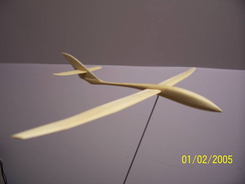

Here's a few more pics of the FluidX as it flies through various rooms upstairs(blowing wind, whistling wings and other sound effects where not over looked).

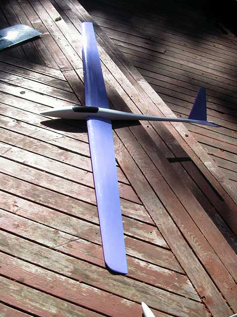

Just some more pics.

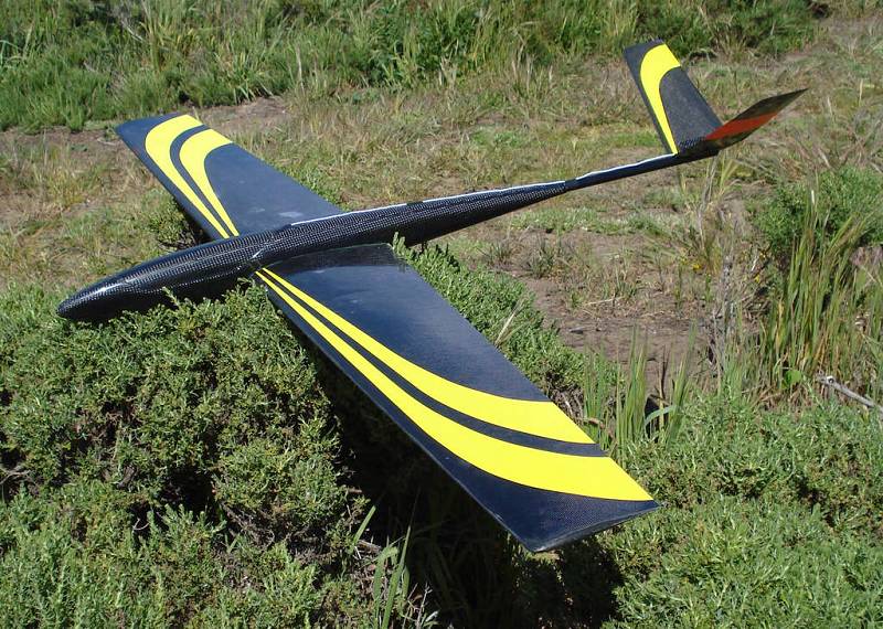

ORIGINAL: Mtntop
Mtntop: What is the yellow one w/ red/blue tips? It looks like one of the old VS planes - Xingu or Rotor maybe?
Tim
Old 04-15-2009 | 06:49 PM
Joined: Feb 2009
Posts: 41
From: Osburn, ID
Default RE: TWF Lovers
You're right that is a VS Sailplanes Rotor. The gentleman who owns that ship fashioned the hatch to opperate as a speed brake. He is also the artisan who machines the Blingeron which is the monoblock mechanism shown earlier.
