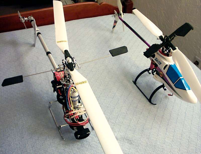

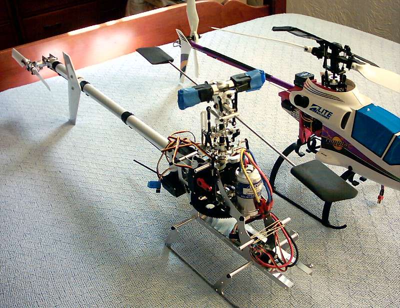

I really enjoyed building it. the only problem that I had was with the servos. The directions stated that any sport servo would do...not true!!! The tail rotor servo was standard size,but the three swashplate servos are mini servos (between micro and reg).Anyway, a great build IMHO...from the reference of going from Corona electric to Quick electric...just waiting for the battery packs (I can then get a reference for drilling the mounting holes in the canopy). I took a picture for another forum wher someone was looking for the size difference between Corona and Quick...I'll try to attach it here ...I've heard on other forums that the EP 10 flies great...cannot say yet first hand!
Old 10-13-2003 | 11:39 PM
Joined: Jun 2003
Posts: 12
From: Woburn, MA
Default RE: Quick - EP 10
I think I got the hang of it

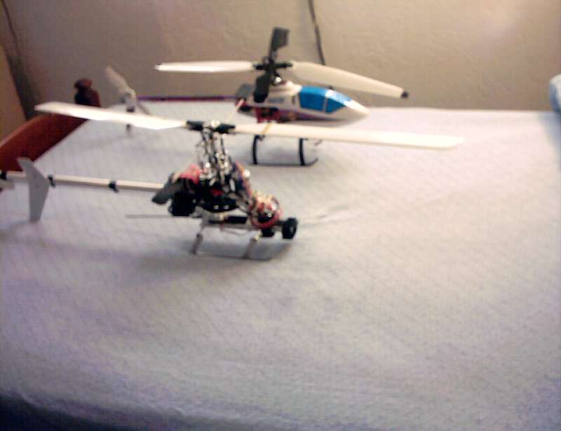

one more

The pictures that I posted (of the heli without the canopy) are of an EP 10 that was purchased from a Japanese vendor (note: the instructional cd was in Japanese). I used the website instructions as a guide. In the pictures,the frames are aluminum. If you go to the website, I believe a carbon fiber kit or uprgrade is available. I am not sure whether they are still shipping the aluminum frame as standard or G10(I don't know what material G10 is, but I believe it to be some sort of plastic composition). The basic kit does not include blades, motor,controller,servos,etc. If this is your first heli, with the radio equipment you also need a good heli transmitter that will let you use the collective feature. Some people are not fans of aluminum frames. I find it to be strong and lightweight. The motor,battery pack and blades are the heavy features of the heli. Lipo batteries would be lighter, but at this time I have opted for the nimh packs....good luck...
Jim
