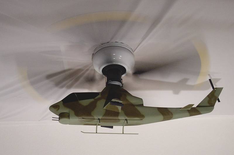

One project that I have wanted to do for a while was inspired by a ceiling fan that I first saw years ago. I am sure that you have seen the fans that look like the nose of a WW II fighter plane. From the moment that I saw that fan, I thought that it would be cool to have a helicopter body that would hang from the underside of the ceiling fan making the fan blades look like rotor blades. Of course the helicopter would have to be a classic – I chose the UH-1 from the Vietnam era.

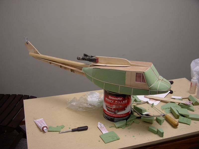

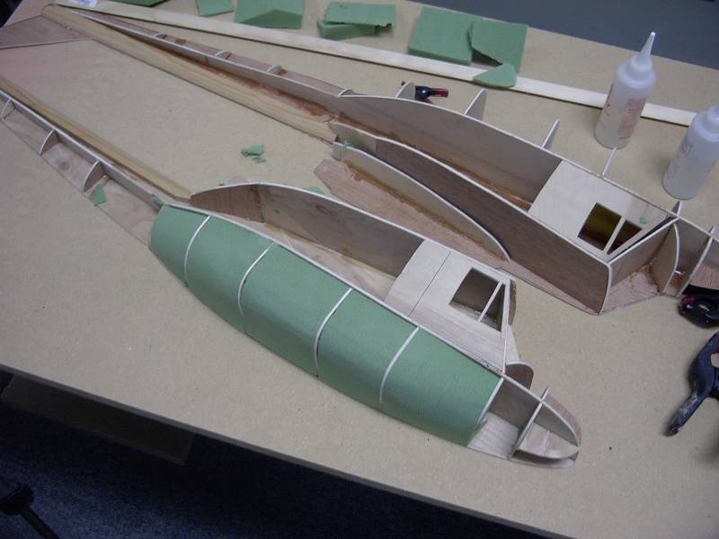

Thus the project begins. The first thing I like to do when I am building something like this is to go to the hobby store and pick up a model of the helicopter that I want to build. I use this model as a three dimensional reference. While 3D references are not always available, I do like to use them when possible. For this project, I selected a 1/35 scale UH-1. Using this model, I can get a good idea of the size that the fuselage has to be relative to the diameter of the fan blades in order to maintain a scale appearance.
I began to build the fuselage of the model and began to analyze the proportions, angles and curves of the copter. See the photo of the fuselage below.
>>>>>>>>>>>>&g t;>>>>>>>>>>>> >>>>>>>>>>>>&g t;>>>>>>>>>>>> >>>>>

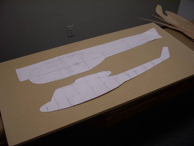

At this point, I can begin to produce profile drawings of the copter. I definitely need to start with a view from the top and a view from the side.
Some of this is accomplished through artistic ability and some of it is cheating. The model that I bought had these views in the painting instructions. Based on the diameter of the fan blades, I figured that the fuselage should be about 40 inches from nose to tail. I simply used my copier to blow these views up to the size that I need. Then I drew in some details that were lost in the enlarging process. See the photos below.

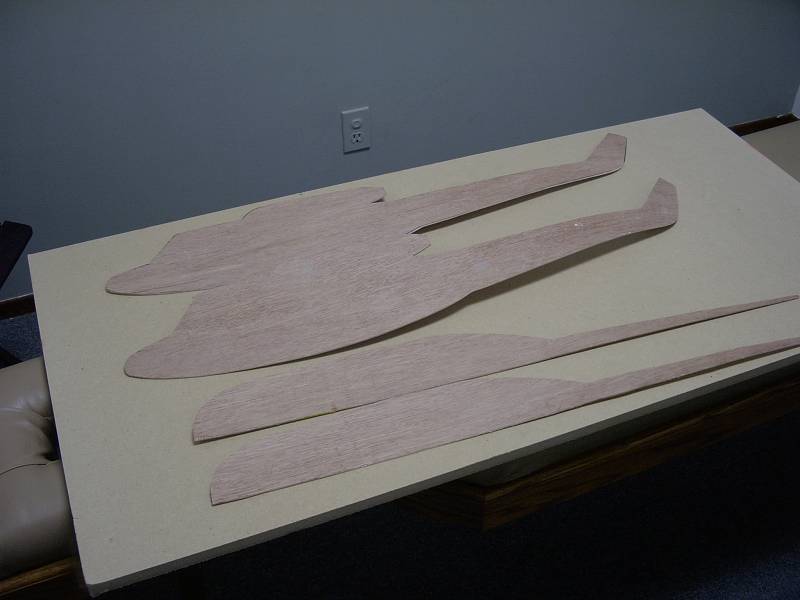

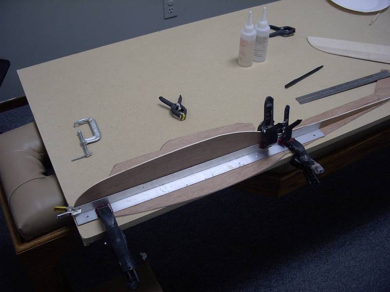

The next step for me was to trace these profiles onto a base that I can use to build a plug. I like to use 1/8 inch mahogany door skin for this. I like mahogany because I can buy it at home depot for cheap and one sheet is more than enough material for a project like this. In the photos below you can see the cut outs that I did in the door skin.
You can see that they warp a little. This warping is no big deal since I will easily straighten the pieces out during assembly of the frame. Next, I want to decide along which line to epoxy the primary horizontal shape to the vertical shape. Having access to my plastic model makes this decision easy. In the photos below you can see how I glue two pieces like these. Angle aluminum stock is easy to clamp the pieces to and assures reasonable alignment of the parts.
In addition to angle aluminum making alignment of not so straight pieces easier, it also gives a pretty good 90 degree alignment of one piece to the other.

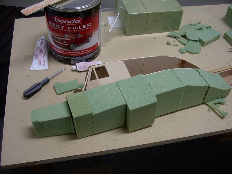

Here is some more on this tutorial, sorry it took me longer than I thought - pre holiday hang-ups. Sanding will make short work of this foam. I like to use a sixty grit paper on a block. One quick sanding session and this thing is really starting to look like a helicopter. I will continue placing foam in the voids until everything is filled and shaped. Continue filling with foam and sanding.

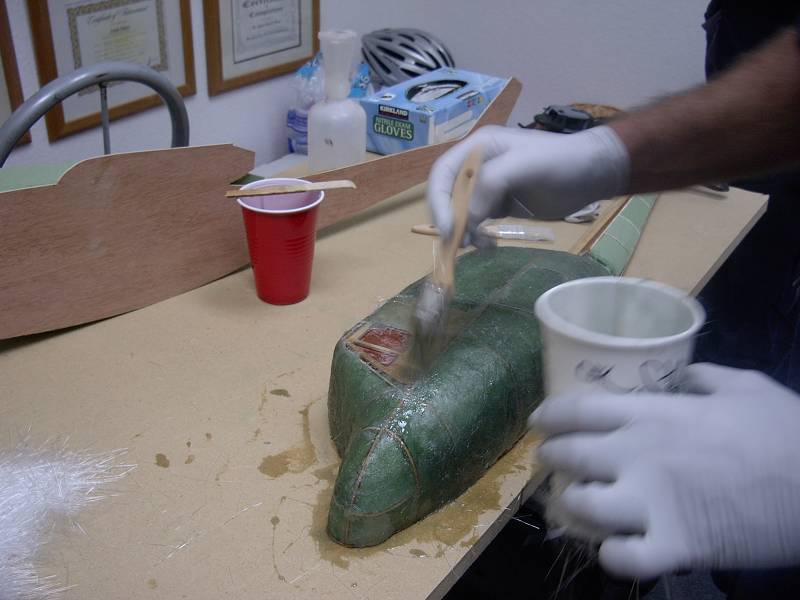

At this point, I will start to fiberglass over the foam. I have decided to hold off on forming in the turbine housing and the top of the tail section. My thoughts are that I would like to have something to place clamps on so I can check the alignment of the body halves during this next phase of the plug build.
I begin the fiberglassing process by using a brush (a cheap disposable brush is best) to cover the foam with catalyzed resin. I have decided that initially I will only do the main part of the fuselage and I will do the tail later. Once the foam has been soaked with a coat of resin (see picture below) I can start applying chopped mat over the foam.
I work the mat onto the surface of the fuselage. It must lay as flat as you can get it. I have spent a bit of time forming this fuselage. I don’t want to get sloppy at this point. Laying fiberglass mat over the foam will provide a nice hard surface for the next step of this build which will be the bondo application. Once the fiberglass has been laid, the only thing to do is let it cure. Time to put the chemicals away, clean up and let the resin cure.

Nice update. I love the picture where you are actually painting on the resin. Noticed the degrees/diplomas framed in the background. Almost looks as if that may be a kitchen table of sorts. I was thinking that I would be toast if "she" came home and the kitchen reeked of curing fiberglass.
Smells good if you ask me

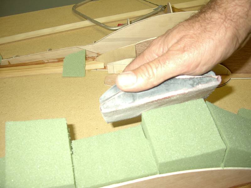

Really shaping up though, how are you getting the contour on the foam? Just eyeballing it for how it should look?

Sorry about that, I approved the last post before answering the question. The foam is shaped mostly by sanding it level with the wooden guides. There is also some "eyeballing". Remember, I am trying to get the shape close at this point, it doesn't have to be perfect. That being said, the better I do now, the less bondo I will need later.

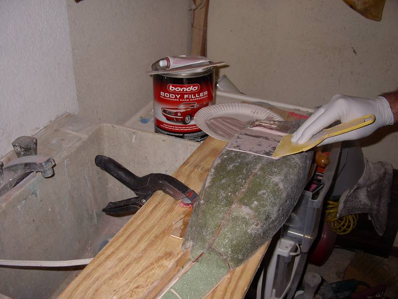

Here is another installment in this project.

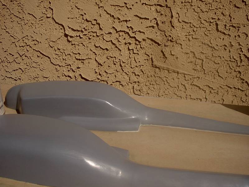

After the resin cures, the surface can be rough sanded to knock down any loose fibers.
Once the surface of the plug has been cleaned up with coarse sandpaper, I can examine the pieces and decide where to go with this plug from this point. I began this plug imagining depressions with well defined edges where the windows should be. At this point, it seems that following this course will make this plug much more difficult to complete. This being the case, I have decided that the next phase of this plug build will see the side windows smoothed flush. Flush windows will make building the mold and pulling parts from the mold much easier.
After the rough sanding is complete, I can apply bondo to smooth out the surface of the helicopter. I only mix enough bondo that I can use in a few minutes. By mixing a little less bondo than I can comfortably work with, I am able to be much more efficient from a number of perspectives. First of all, I have time to work the bondo on the surface since I am not rushed by the thought of unused bondo curing on my mixing surface. Secondly, when I mix too much bondo, I end up just piling it on only to have to remove most of it later on because of sloppy application.

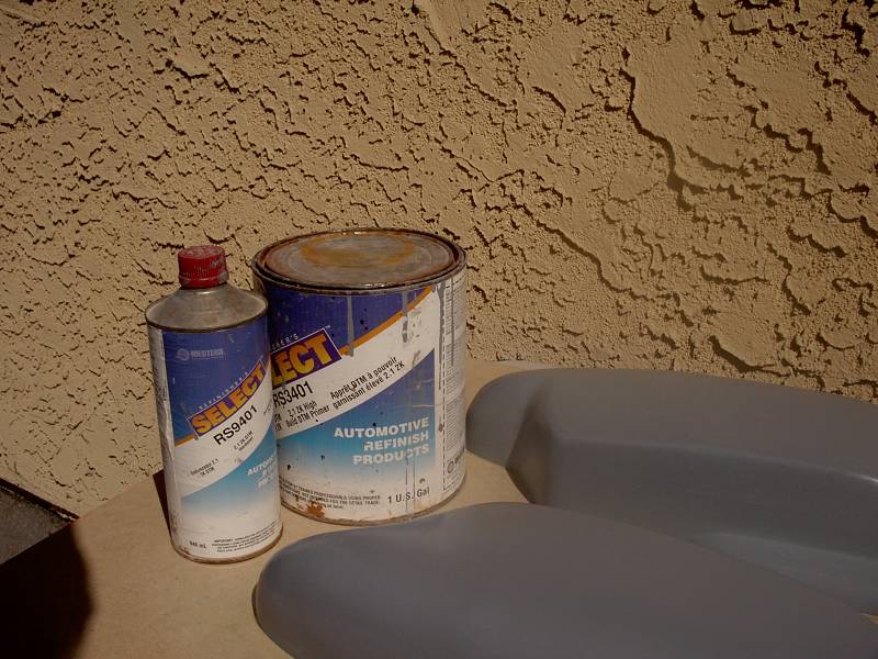

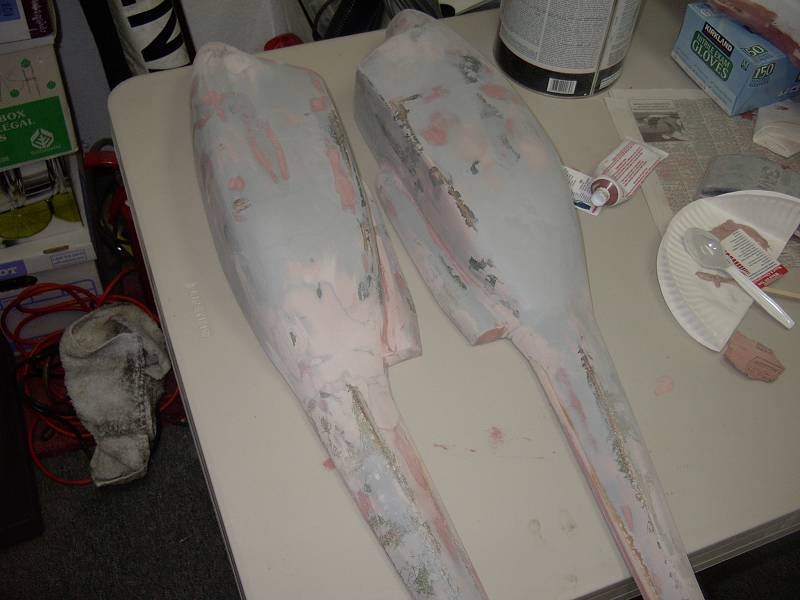

At this stage of the build, the project gets a little tedious. Sand, prime and fill – sand, prime and fill. This process is repeated over and over until the surface is smooth and the two halves join in the center.
Spending time at this stage pays off in the end. Remember that every flaw that you are too lazy to work out of the plug at this point will have to be worked out on every piece you ever make with the final mold. In other words, you can fix a flaw once here, or you can fix it on every piece you ever make, maybe 100 times. Do yourself a favor – Fix It Now!
It is at this time of a plug build that I like to apply a nice thick coat of heavy fill automotive primer from my air gun. This primer will fill all of the remaining imperfections and it can be fine sanded, polished and prepared for the actual molding of the plug.
At this point, I believe that I am done with the helicopter plug. Now is the last time to stare at it and make sure it is right before molding. As you can see in the picture, the two halves of the plug are clamped together so that I can check the alignment. I have already painstakingly aligned the two halves but now I am reaching the point of no return. I spend a good bit of time looking at the alignment of the two halves and at the plug itself.

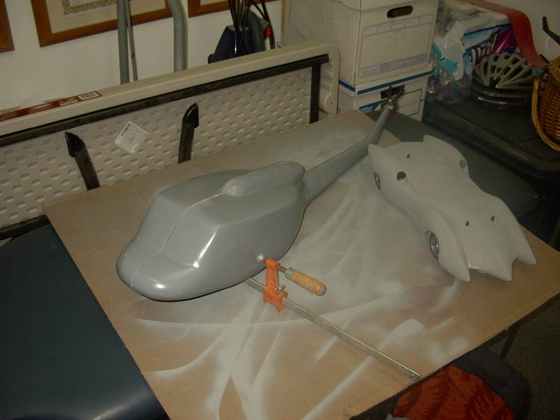

I spend a good bit of time looking at the alignment of the two halves and at the plug itself to make sure that it meets my expectations. I notice obvious departures from my reference model and need to decide if I can live with the variations. Remember what I said about my expectations of model building at the beginning of this manual – I like my projects to look like what they are supposed to look like but I don’t expect them to be completely scale. Keeping that concept in mind, I can easily identify this as a Huey UH-1 so I am good with what I have in this plug.
Preparing the plug is the next stage of this build. I begin by mounting the two halves of the plug to a piece of inch thick MDF board. I attach the plugs by using screws from the back side of the MDF. Some people glue or epoxy their plugs to the parting plane. I prefer to use screws because I can remove the plug from the MDF after the mold is finished with out destroying it.
Once I have the plugs securely attached to the parting plane, I need to go around the base of the plugs looking for gaps between the board and the plugs. Any gaps are filled with clay. This is just a matter of forcing the clay into the gaps in order to prevent resin from getting under the plug. When the gaps are filled and all excess clay is removed, I can apply mold release wax to the plugs and the MDF parting plane. I like both McGuire’s and Part-All mold release waxes. It is important to apply at least five coats to the plugs in order to ensure adequate coverage. The plugs should be polished to a shiny smooth finish.
Moving on to the tutorial...

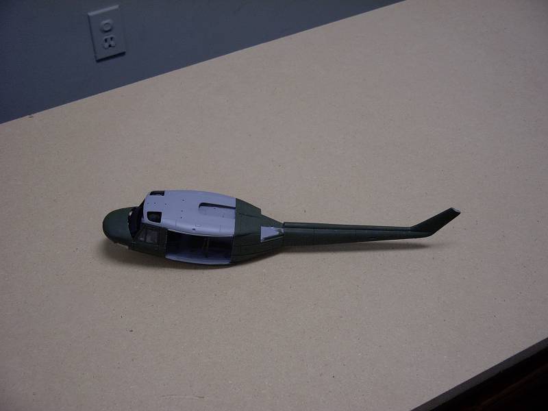

With this post, this project is done. I apologize for the long delays between these last few posts. Good luck with your fiberglass projects. This project ended up consuming alot more of my time than I expected. I now have two helicopter ceiling fan models with a JetRanger on the way. Turns out it is a popular item. I have sold many on eBay and quite a few to folks who see them hanging in my office. It is always nice to make a few extra bucks with your hobby

you have to be carefull not to go too fast as the mold will warp as the heat from the resin/catalyst reaction isnt dissapated slow enough...... (does that make sense?)
the most important thing in beginning the mold is to MAKE SURE the plug is waxed and PVA'D, or the tooling gel will, or can bond, permanantly with the plug..... then it will never release.
also, splits in the mold must be determined before the initial layup as to facilitate the pulling of parts from the finished mold, you cant pull from a negative draft.
