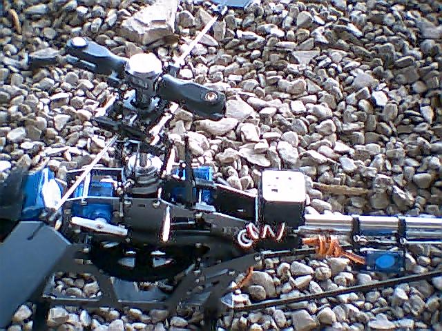

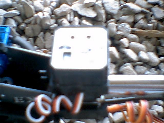

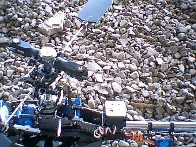

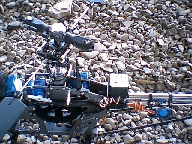

Iuse one also Deal extreme gyro 22.88 I filled inside case with GE silicone to help support
thethree tiny pc boards inside ,,some of these gyros quit working in short time and i think it
is from the boards joins coming loose other words a little pm

dude - This is a great tip. I'll do the same.
Thanks!!!

JOJO make sure eg silicone is fully cured before power up unit
watch someone will chine in and say the EG silicone will ad too
much weight to heli tail lol
