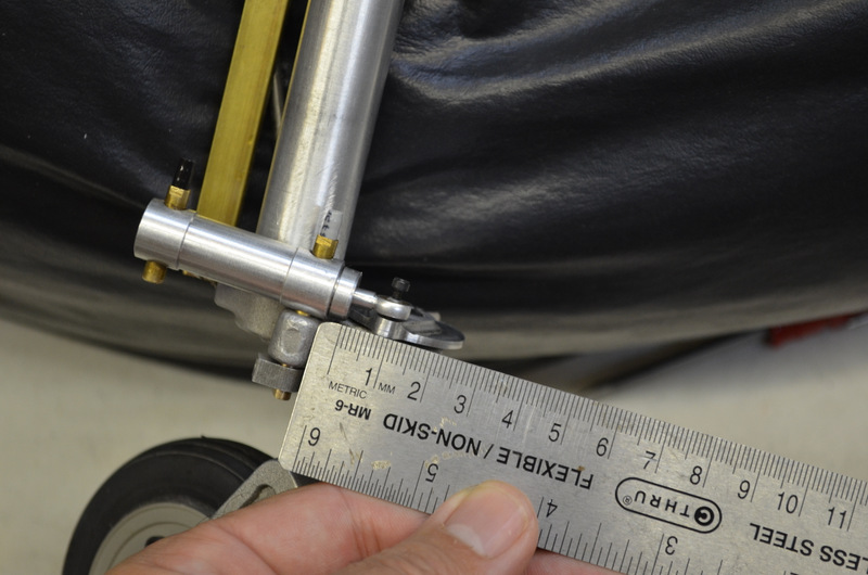

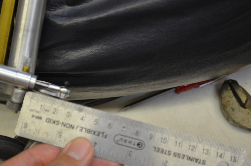

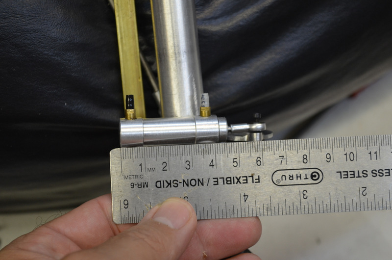

Out of curiosity, how much of a stroke do you need for the actual steering cylinder, and how much room do you have to work with?.. 1''?
#181
ORIGINAL: invertmast
Andy,
How much room is available between the cylinder now and the strut? I have a few links on small linear actuators, but im not sure if they are small enough
Andy,

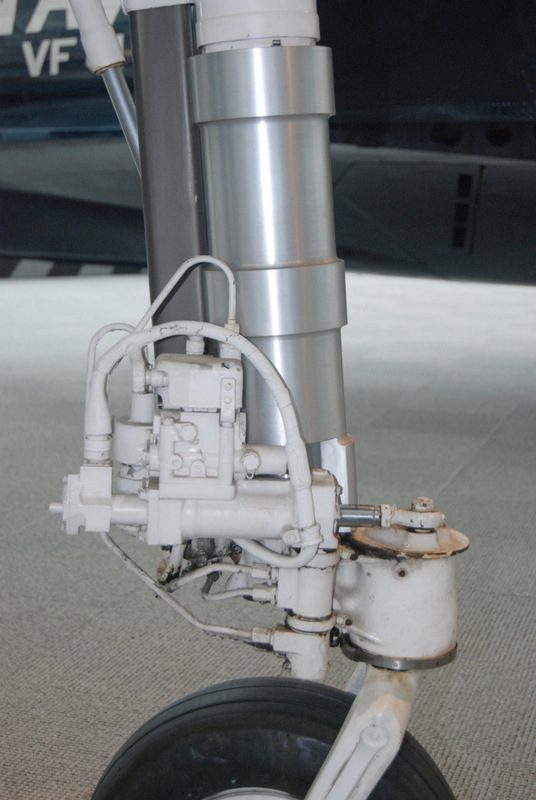

ORIGINAL: Scale Specialties
and if memory serves his accident led to the removal of all the nose steering units on A4's.
I later flew A-4E and F models as an adversary pilot. The 'E' had no nosewheel steering at all (diff brakes), but the 'F' model had nws.

ORIGINAL: VF84sluggo
Not so. I flew TA-4F and J models in the Naval Air Training Command in 1980-81. All the jets had operable nose-wheel steering. On the flight deck of the carrier, we did NOT engage nws, instead were 'steered' on the deck by a sailor with a steering bar hooked into the nosewheel assembly. We had to definitely make sure we did not taxi faster than a man could walk!

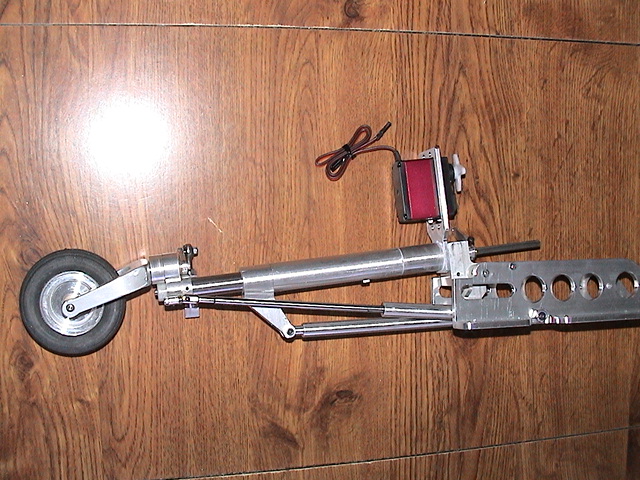

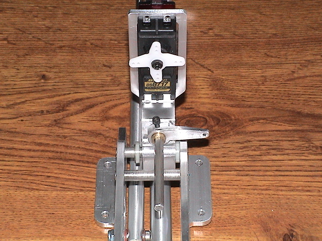

I'm very interested in your posts of your A-4 problems, especially of the nose steering problems. I'm having similar problems with my A-4 project (Skymaster). Skymaster, Laiki, BVM, et.al. will not answer my emails requesting parts for the A-4 landing gear. I have dammaged the pistons in the left and right main gear units trying to operate them hydraulically. But that's another story!
Correct me if i'm wrong but i believe that the CARF as well as the Skymaster nose gear steering operate hydraulically. On the surface, this method has good promise of being friction free and very positive with "0" slop. It should operate like any common Automotive/motorcycle hydraulic clutch system. But a little bit of air in the system is a "deal breaker". I have spent literally hours on my system trying to remove every last air bubble but somehow air always seems to creep back in. I noticed on one of your photos what looks like a fairley large air bubble in the line. I have found that a bubble this big in my system renders the steering very sloppy and unresponsive ,especially with weight on the wheel. Since air is easilly compressed, the servo/master cylinder uses quite a bit of travel just compressing the bubble. Ball bearings are not the answer, when the airplane is not moving the increased friction is not in the system but skidding between tire and ground. Like trying to steer your car with the engine off. The servo mounted on the wheel end of the strut looks goofey. I think we can solve this problem ourselves if we can find a way of keeping air out of the system. When my system is air free it is very solid and responsive - it just won't stay that way for very long.

Hey CaptainBob, do you use single or dual "master cylinders" inside the plane?
A couple of other points, someone said side loads on the cylinder causes leaks, they are right!
Second, I found some very hard 4 mm line that I am sure will swell less than most line, especially at 100-125 PSI, but I can't find the link....it was "something "95A" which I assumed was like a Shore rating on elastomers. Rigid line would help too but it is fiddly to bend up.
Seems like if you get a bulletproof way of bleeding it and then it does not leak (letting in air) it would work much better.

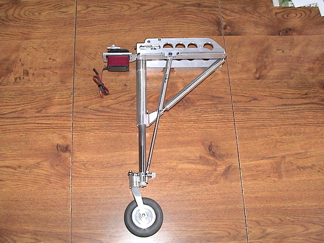

I worked on a large A4 Gear some years ago for DCU Models. I pulled out an old prof of concept prototype from storage and made some updates to it last week. As you can see its is a simple torque rod arrangement that allows the rod to slide so the shrink link can do its thing. I just tested this for stiffness and it is very positive even with the nylon arm I used. Any production set would have all aluminum components to make it even stiffer.
The good news is this will work just fine the bad news is, the Comp Art retract is not a compatible configuration for the torque rod.
I would need to look at the Comp Arf gear to be able to see if it could be saved or changed in some way. Just PM me if anyone is interested in working on this with Matrix.
