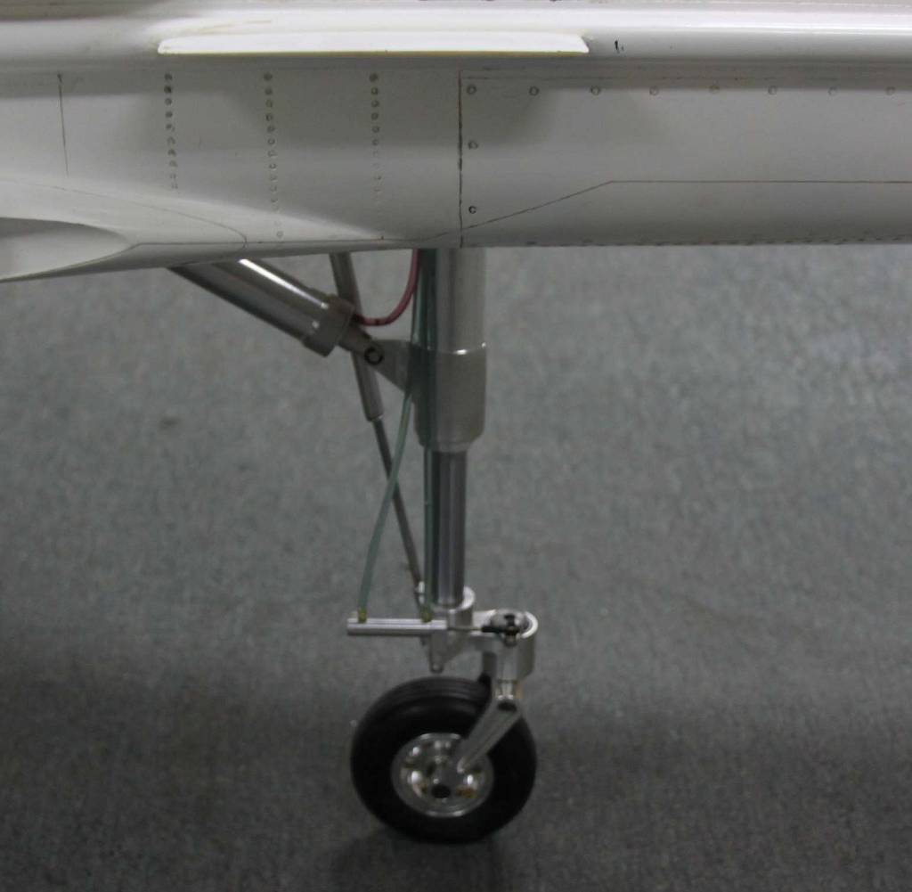

What about those miniature hydraulic units they used to sell a few years ago, I think it was also used on the Fiberclassics Mig 29, could they be incorporated into this mess?

I've only seen the one detailed photo of the strut at the beginning of this thread and it doesn't show the steering cylinder very closely. It does look like something non-standard though, so I'd begin by figuring out some way to replace it with a standard BVM or like cylinder. Also, does the steerable part of the nose gear itself use ball bearings? If it doesn't, then weight on the nose is going to really increase the pressure needed to move it due to friction. That would have to be fixed too...
The Skymaster strut looks pretty simple, but Likai is a landing gear guru. I don't know who did the one for Comp-ARF...
Note below on the Skymaster one below the simple, standard cylinder and the ball-bearing supported steering yoke...
This gear is essentially the same except for a bit more scale appearing cylinder. The question is what does SkyMaster have on the other end in the fuse that works?

Actually, they may be "air cylinders," but they are filled with fluid and the entire system must be filled with fluid or it won't work.
David, I believe that the other side of the system is another cylinder that is connected to a servo - just like I presume that the Comp-ARF one is. Is the steering fork supported on ball bearings?
Do you have a picture of your setup on the drive side?

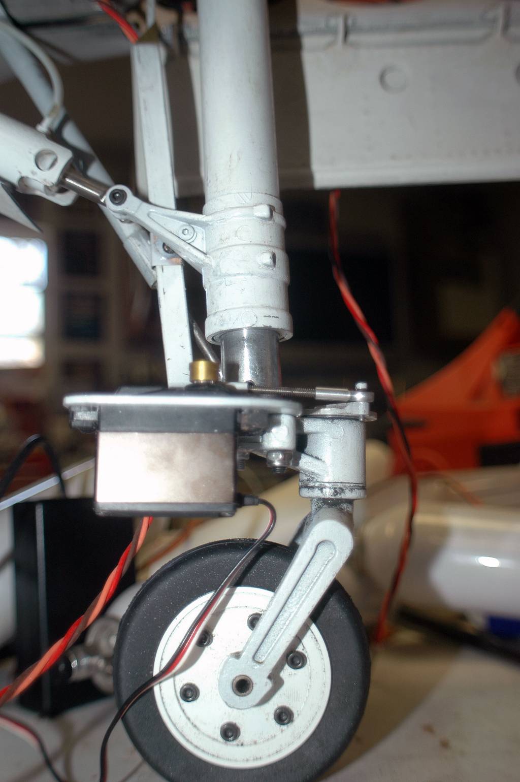

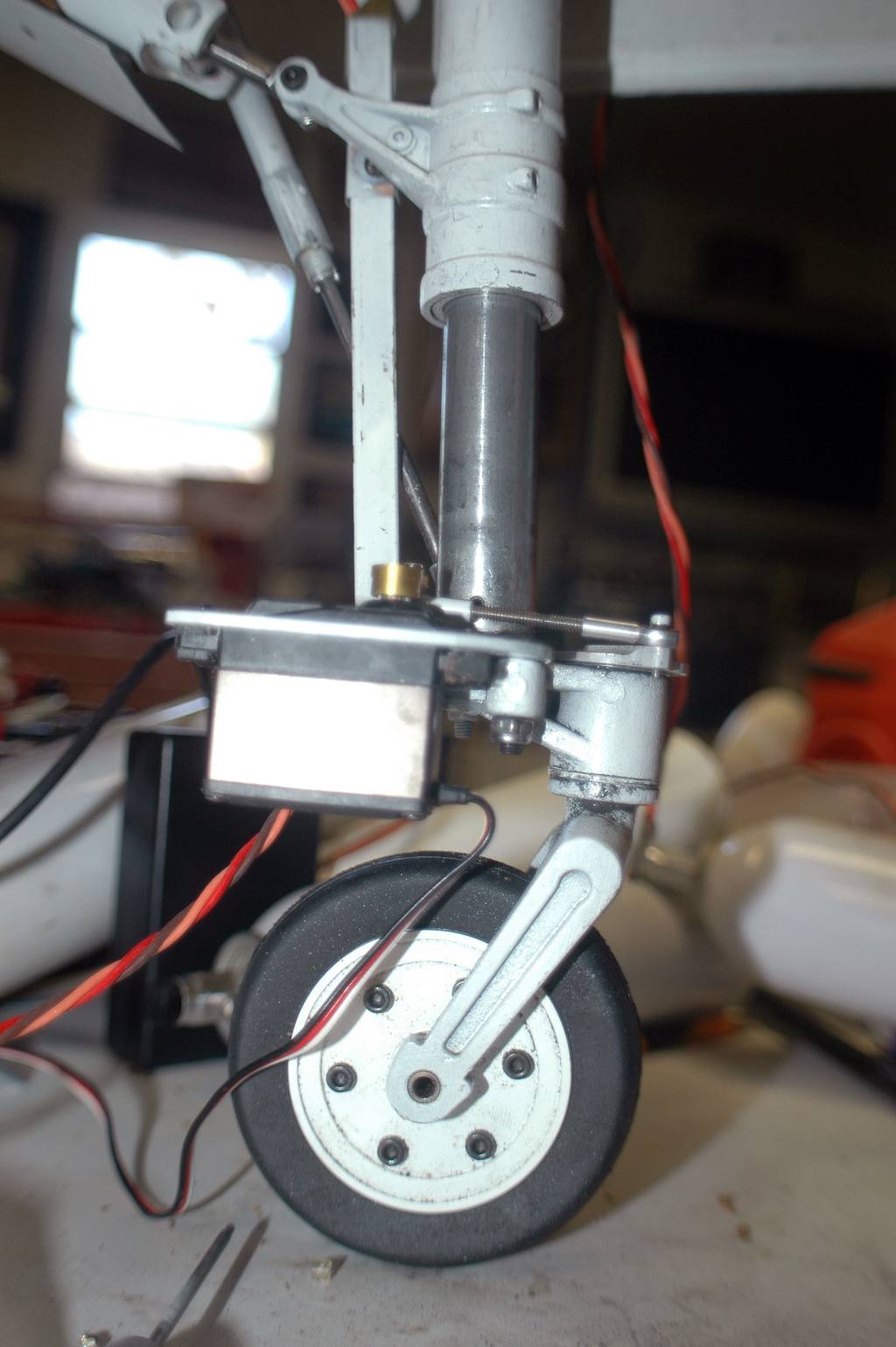

Yes, I know it's not scale.[] Yes, I know, looks ugly as hell.[:'(] But, I think it's going to work! A few more adjustments/additions to stabilize the mount and control rod & I think this beast will be RTF for BITW!
David S

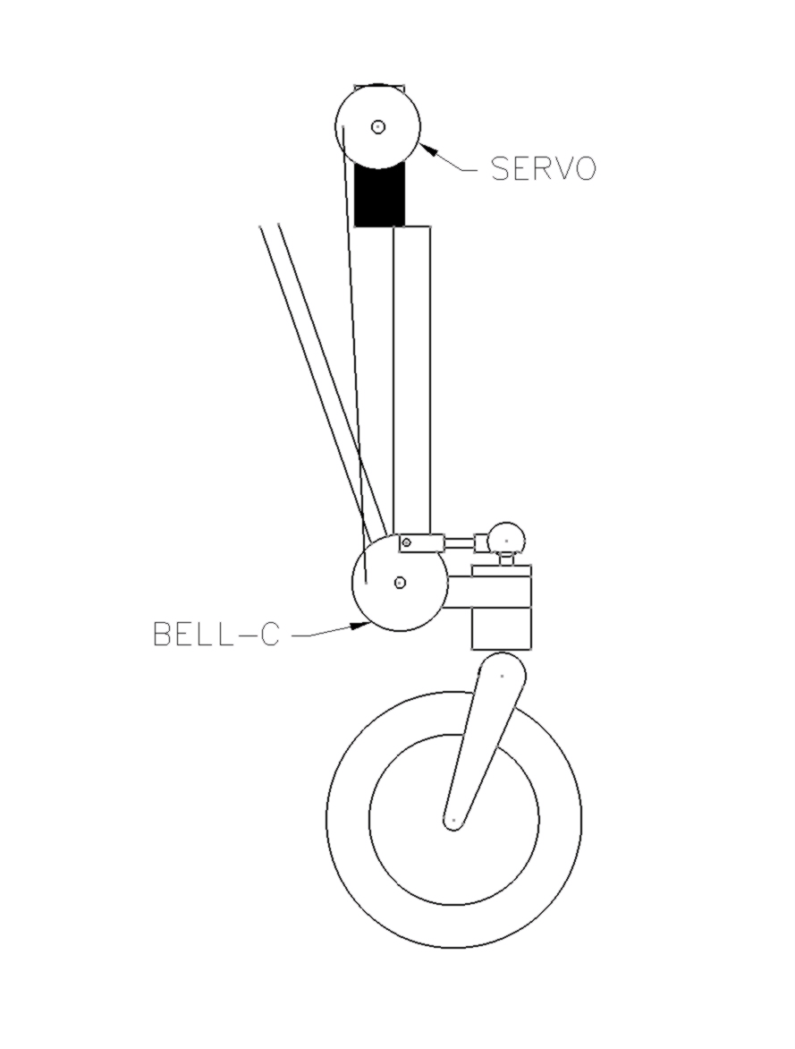

Dave, for the next step you could probably install a bellcrank next to the steering arm, and keep the servo away at the top, keep only a linkeage visible.
Just a thought.

deeyyyaaammmm that is Ugly!!!! but F'it if it works....paint it white and go fly.

I had thought of it as well, but you will need a really strong servo to counter all that weight and it not be too big! hope it will work for BITW.
Scott

OK Scott, I'm following your advice!
The 9156 is a Digital Hi Torque servo with 340 oz in at 6v. Should be plenty strong.
David S
