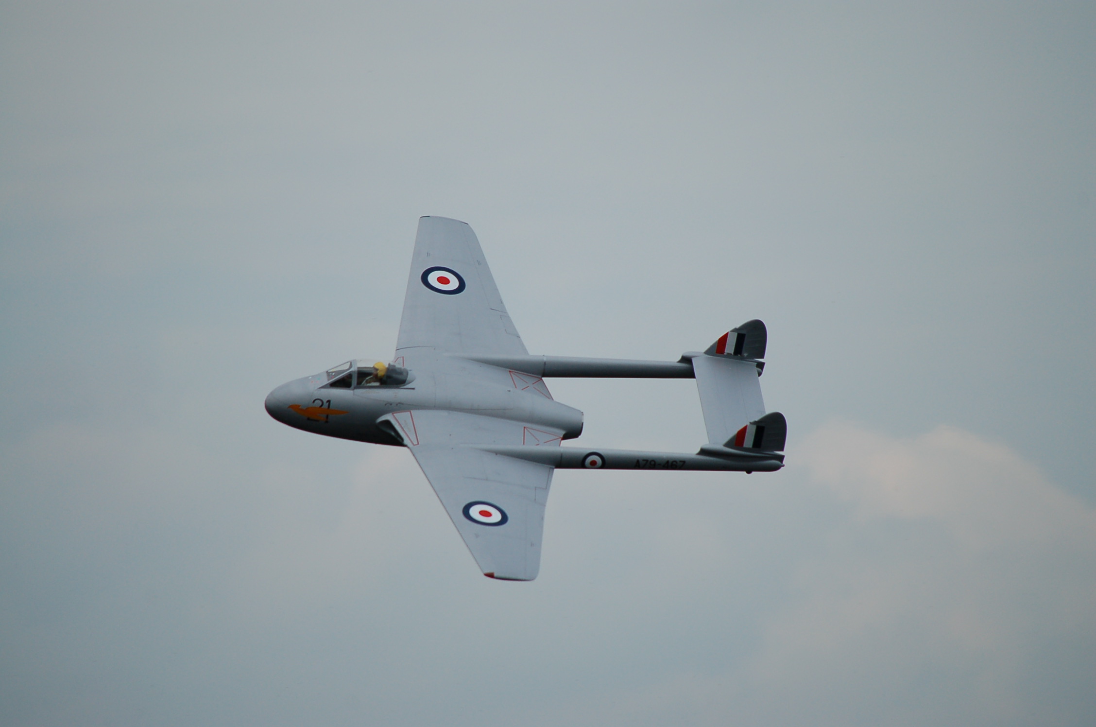

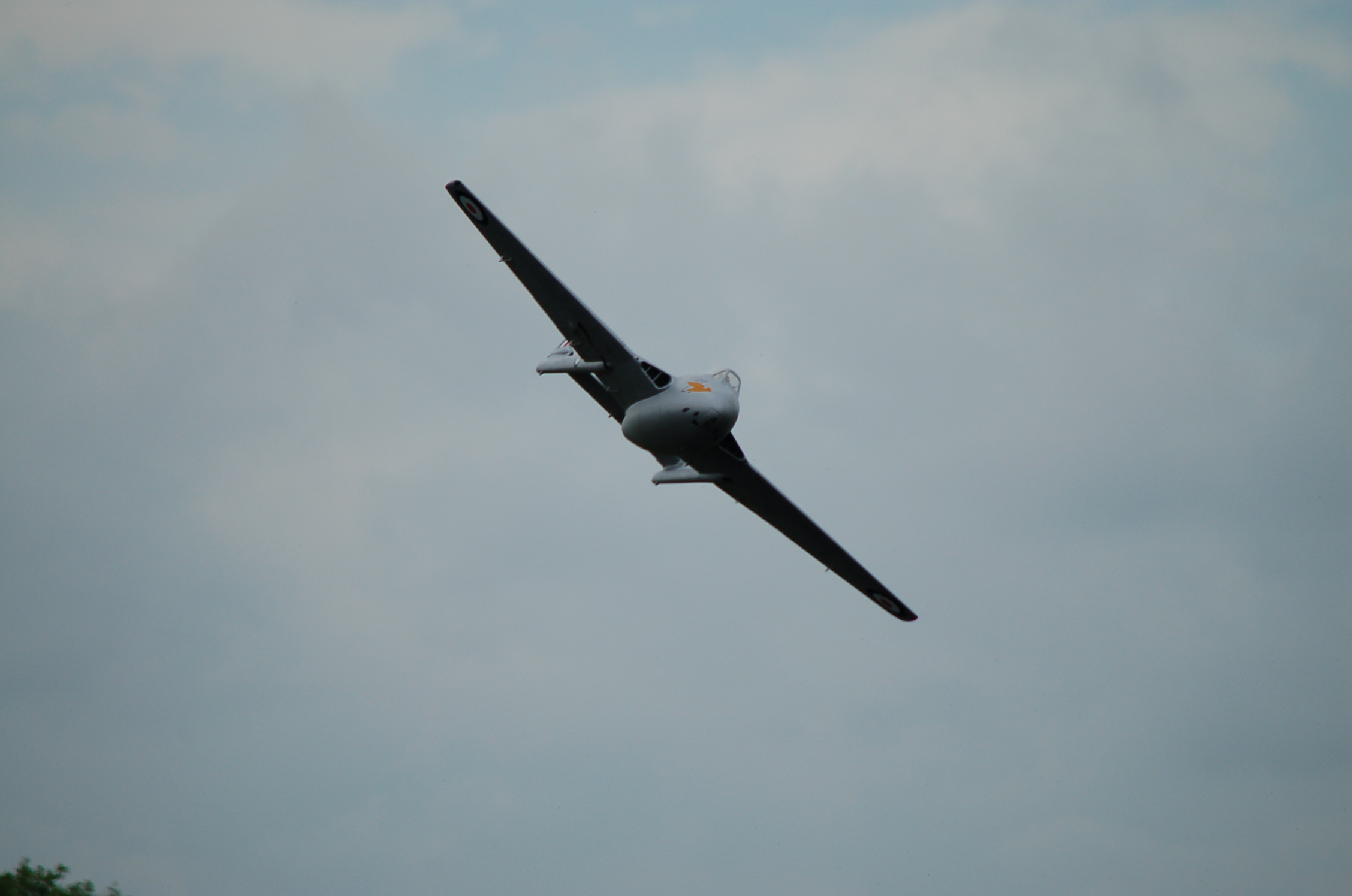

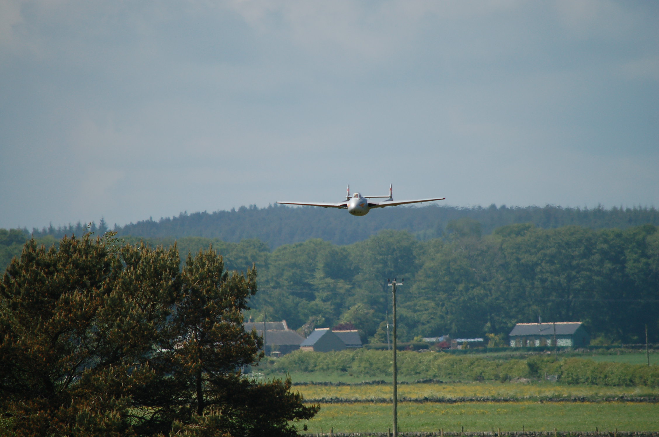

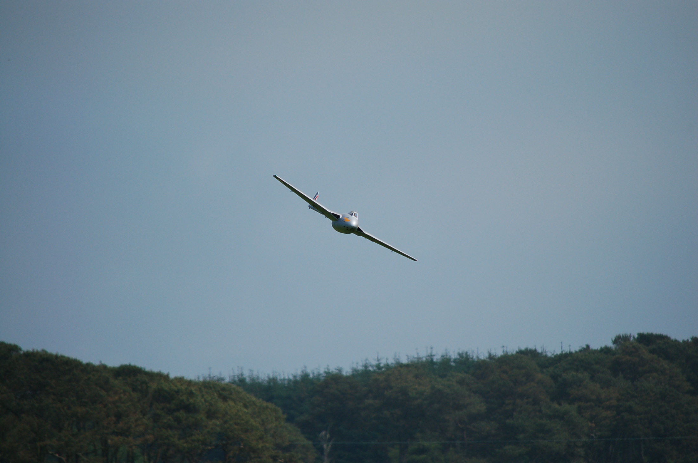

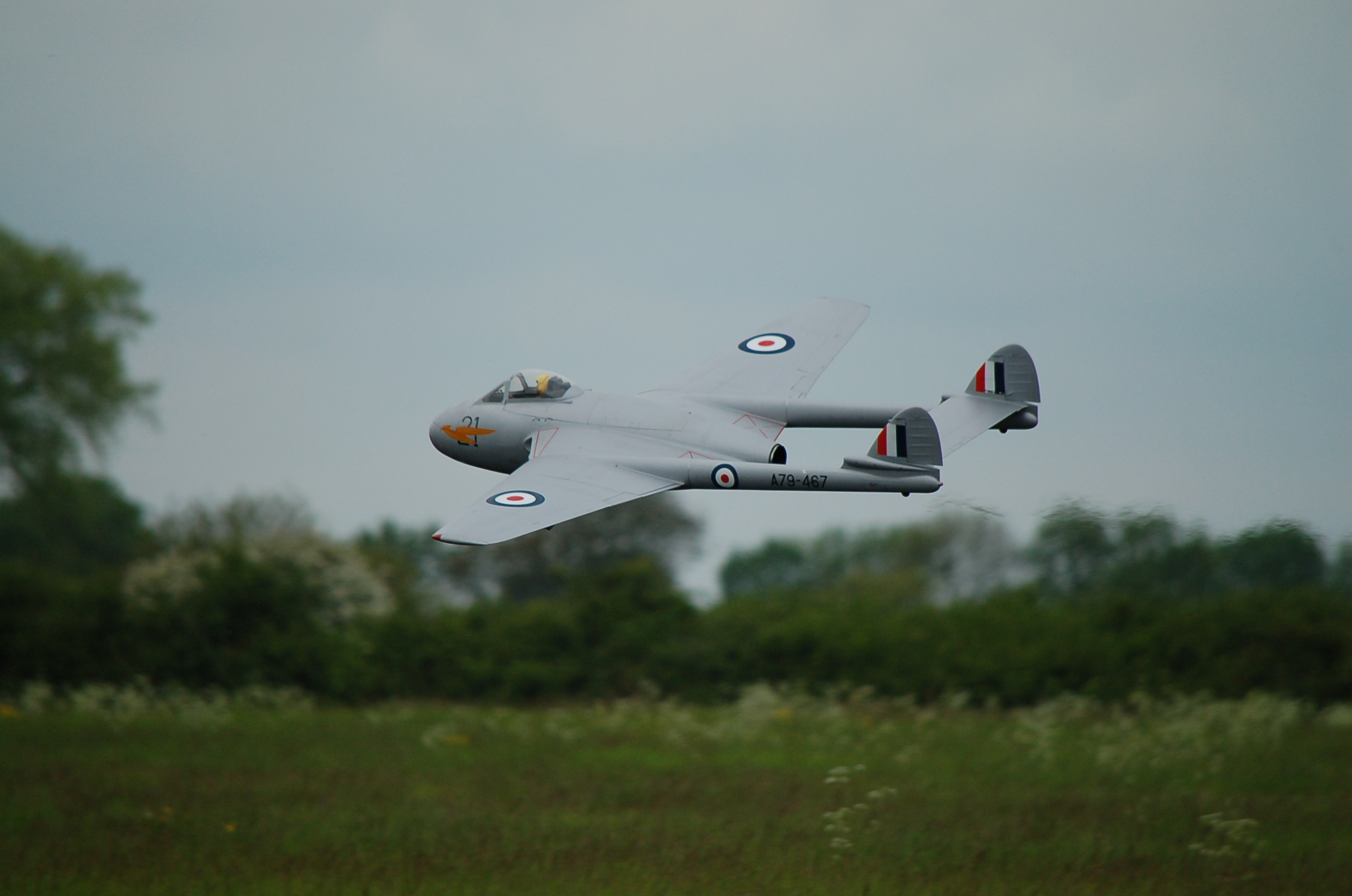

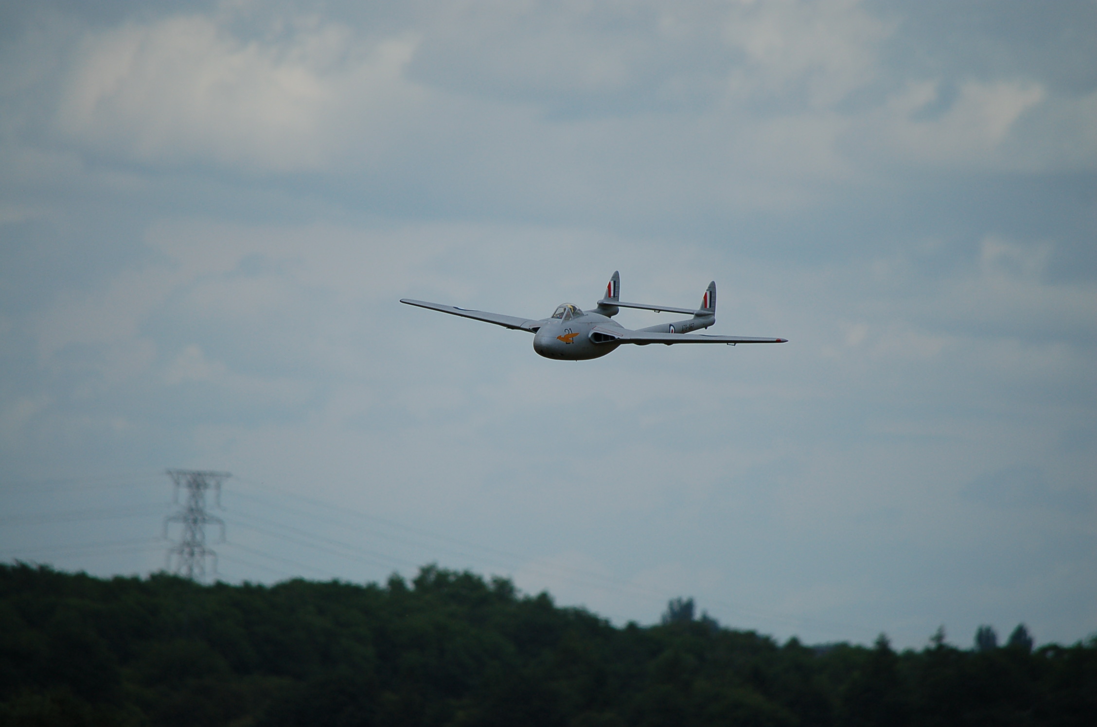

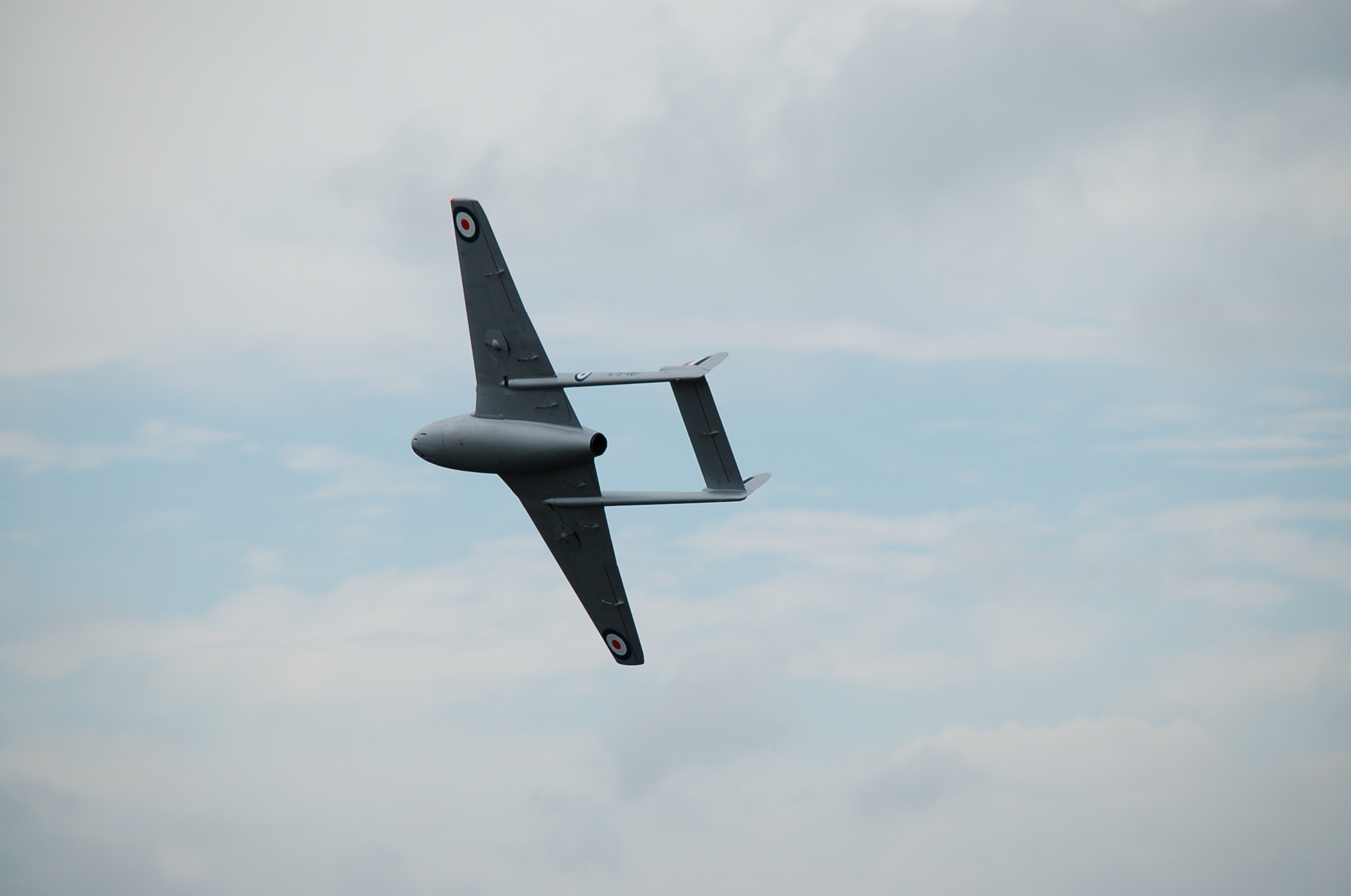

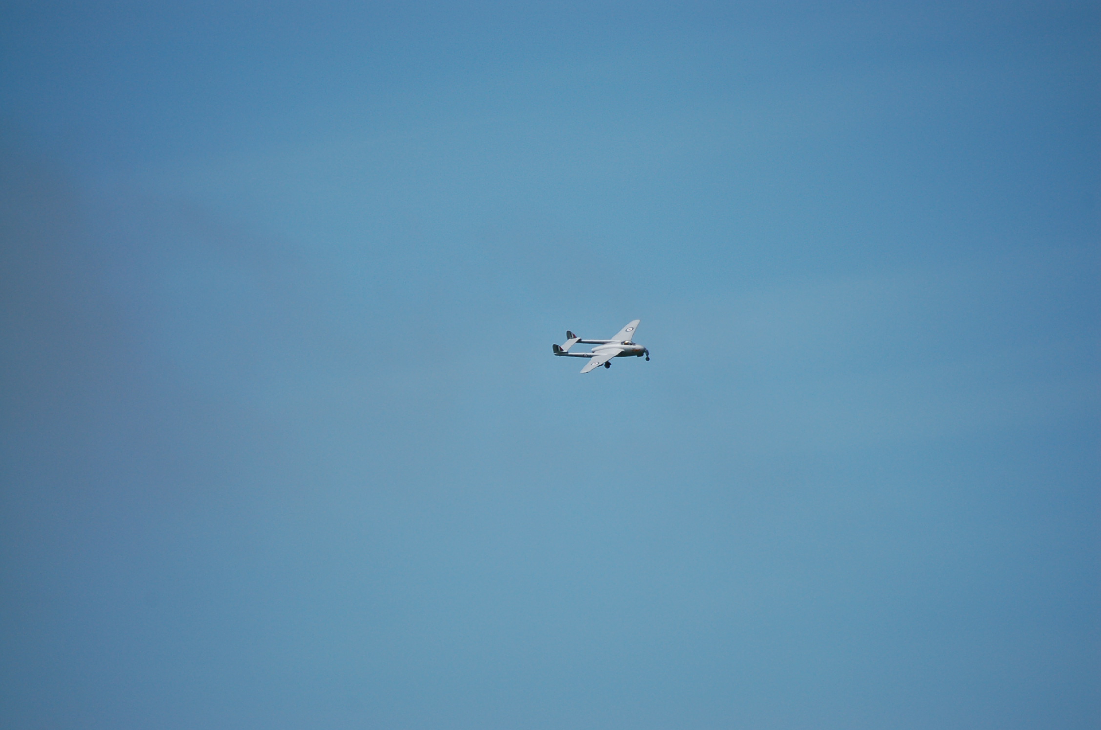

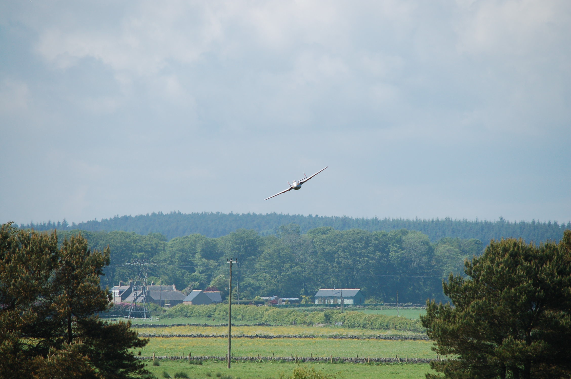

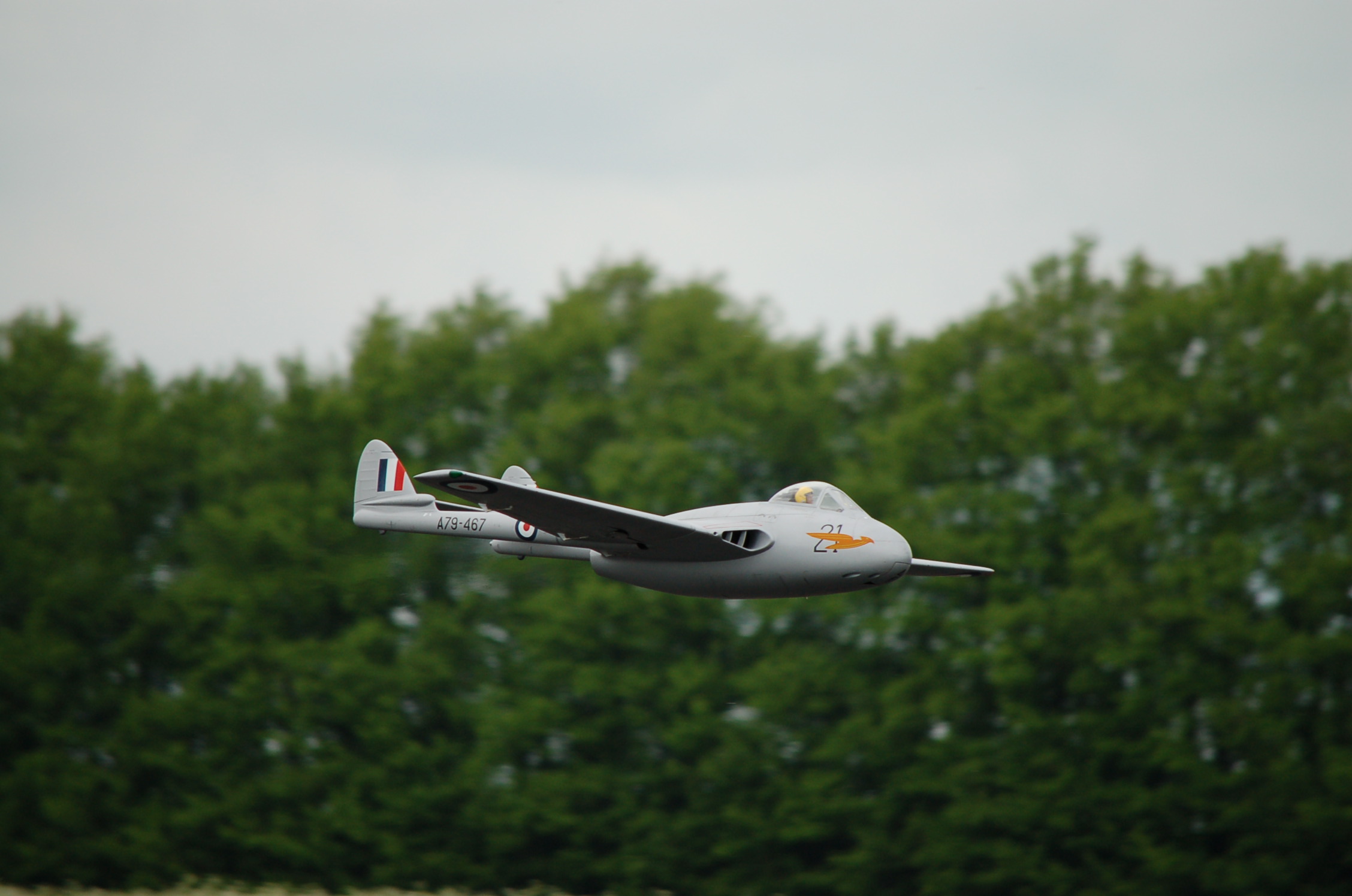

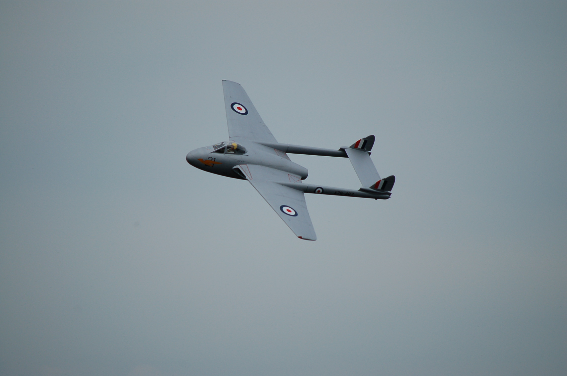

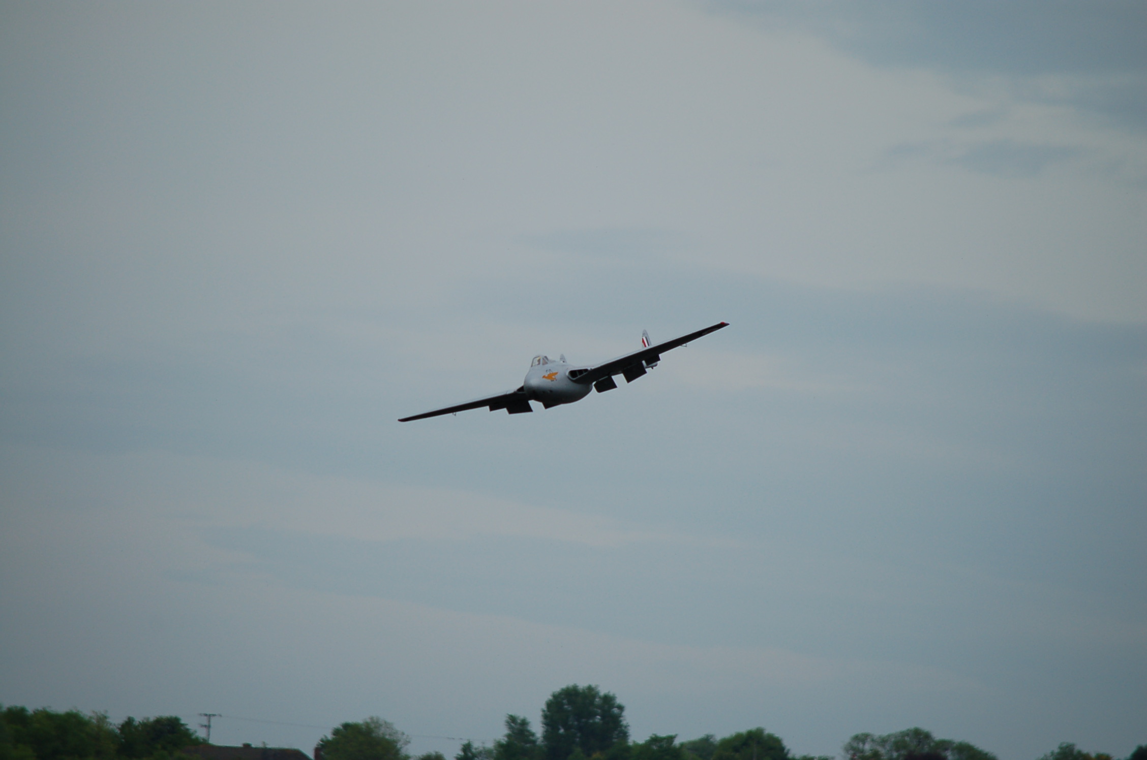

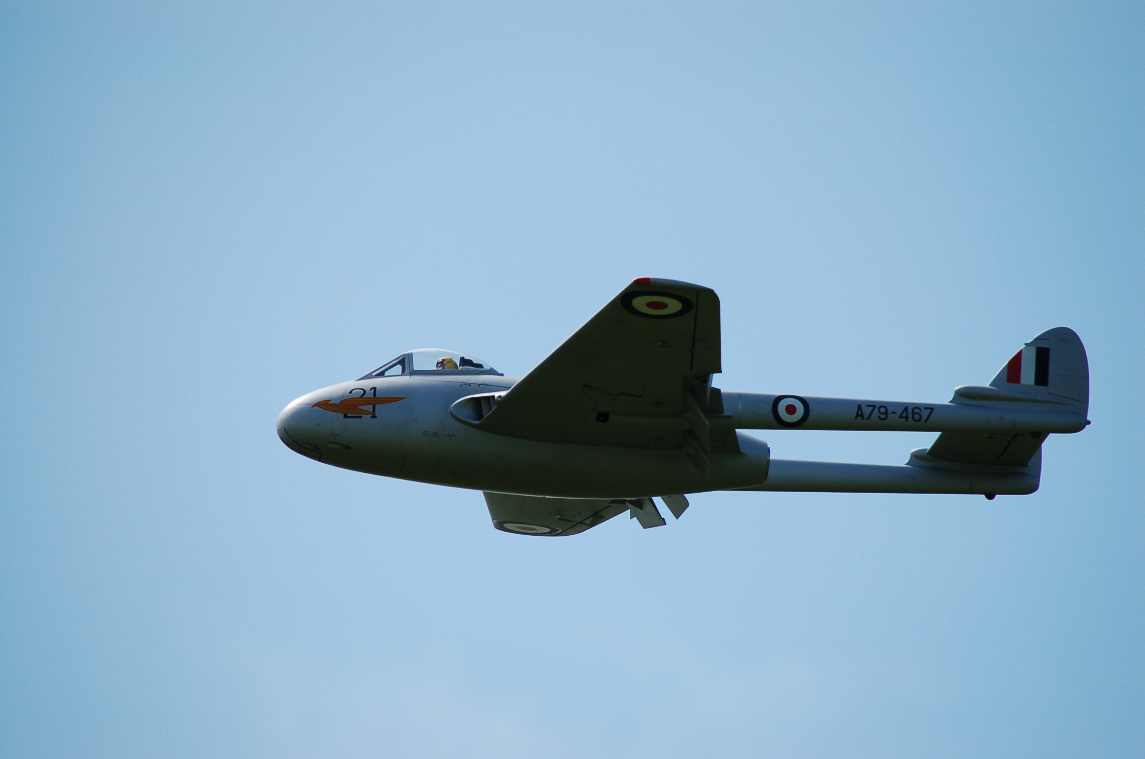

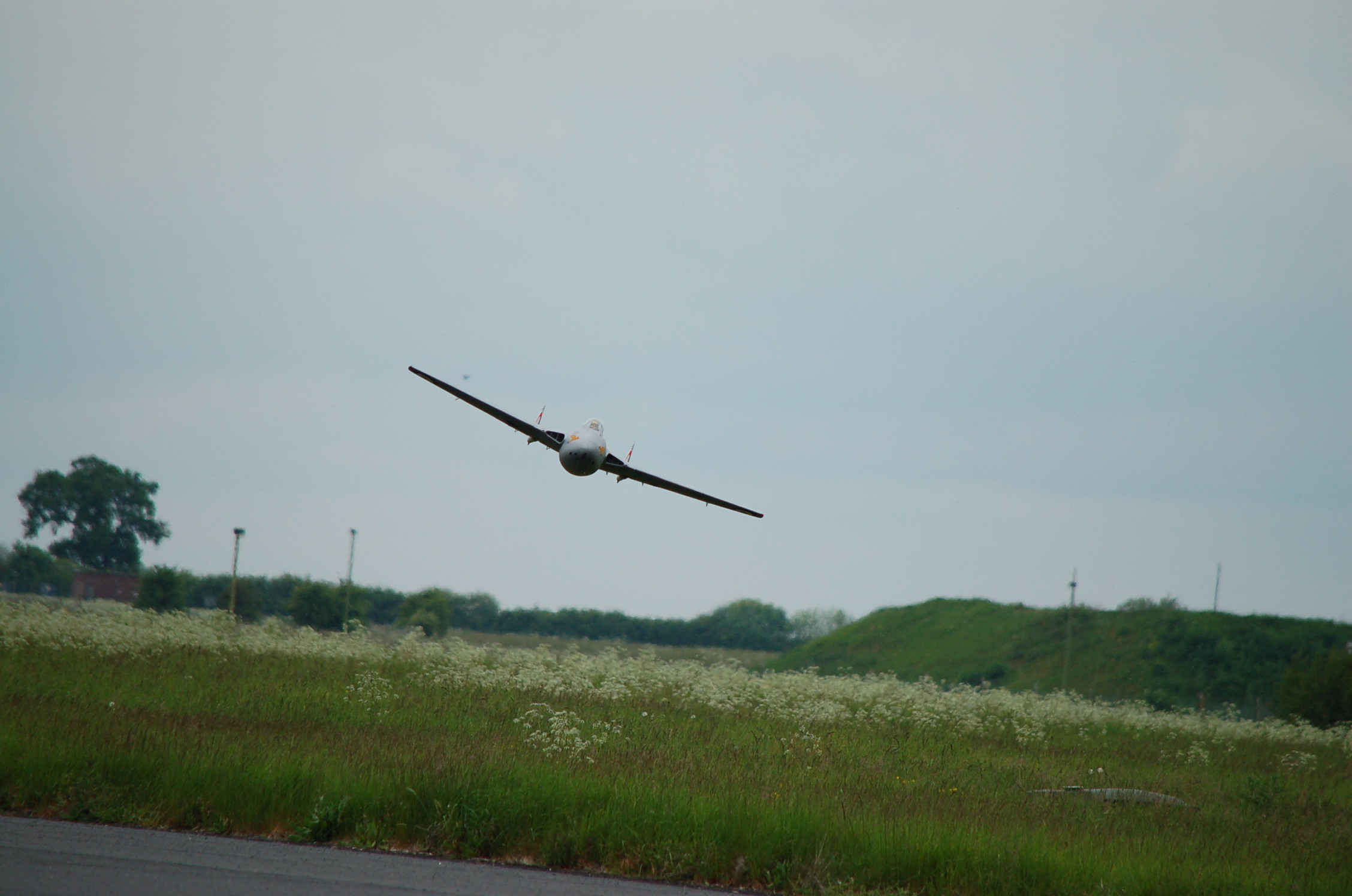

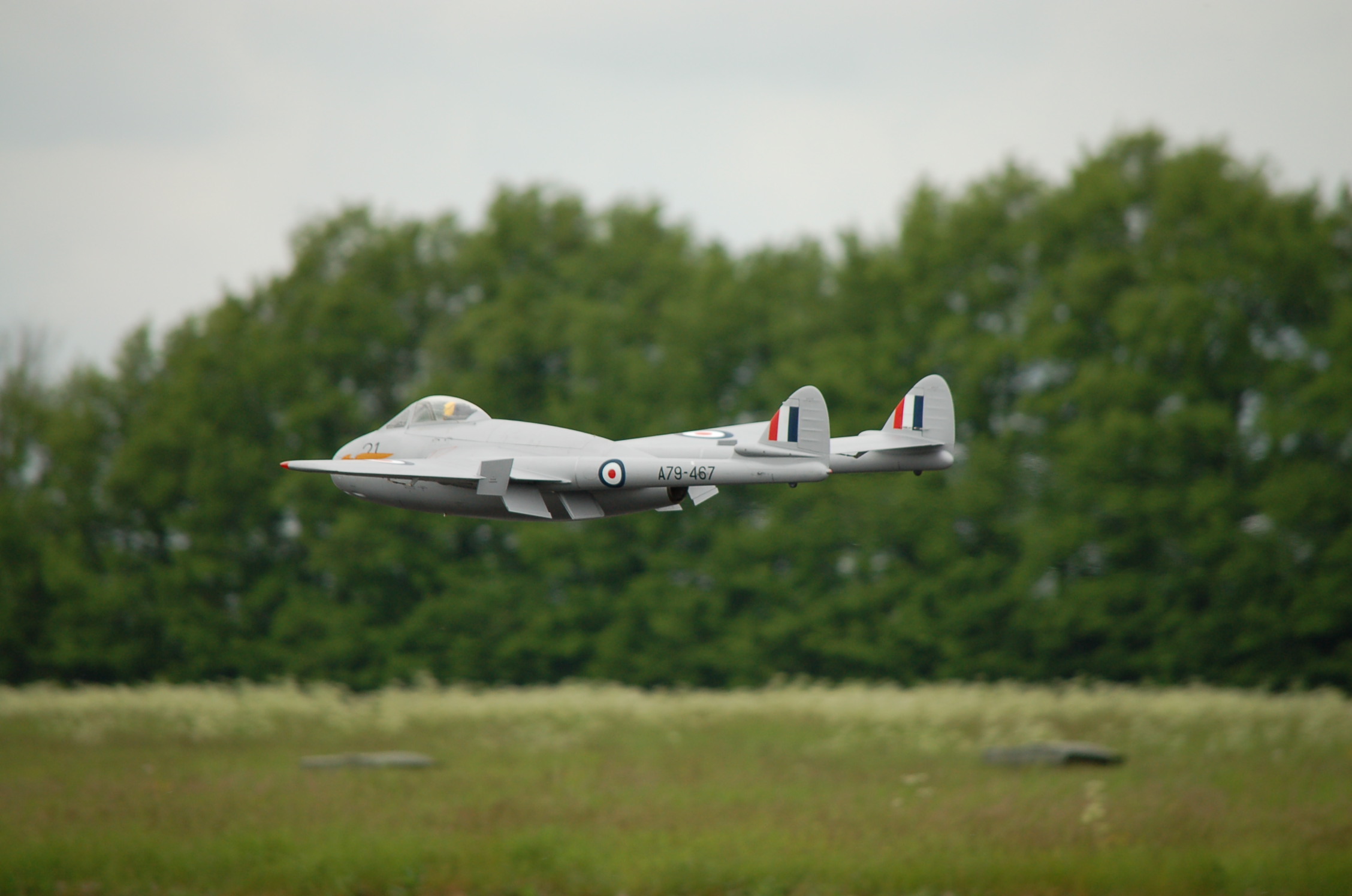

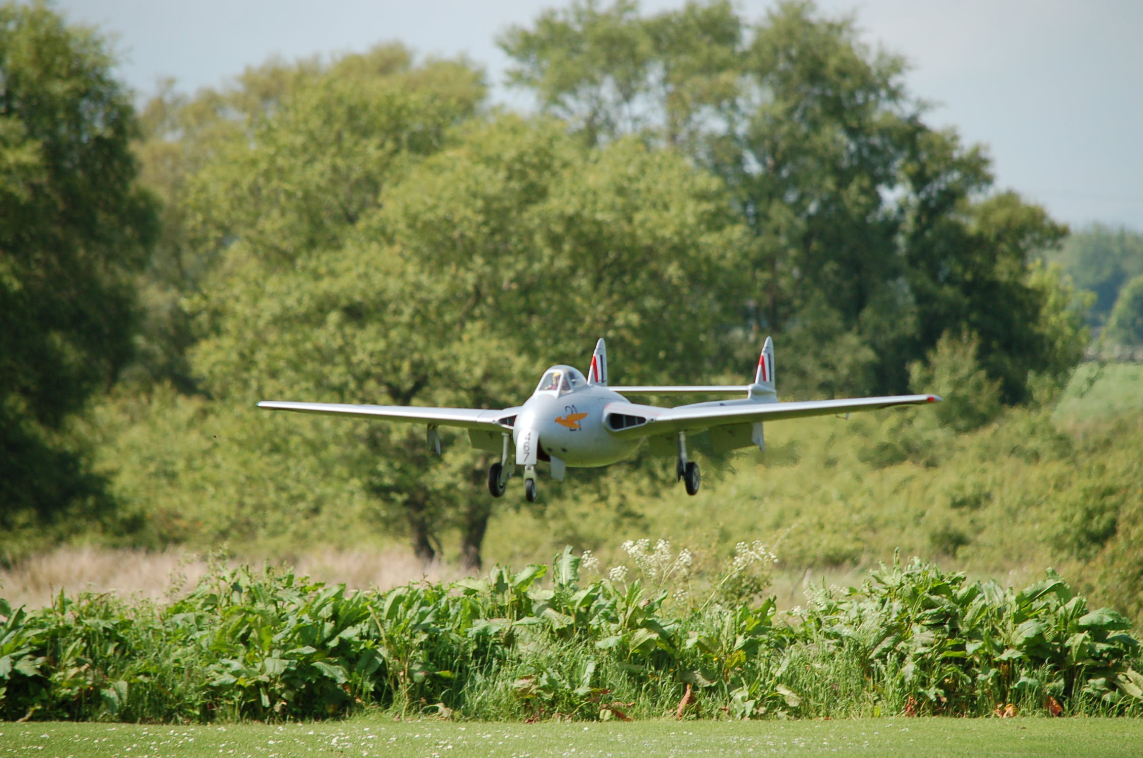

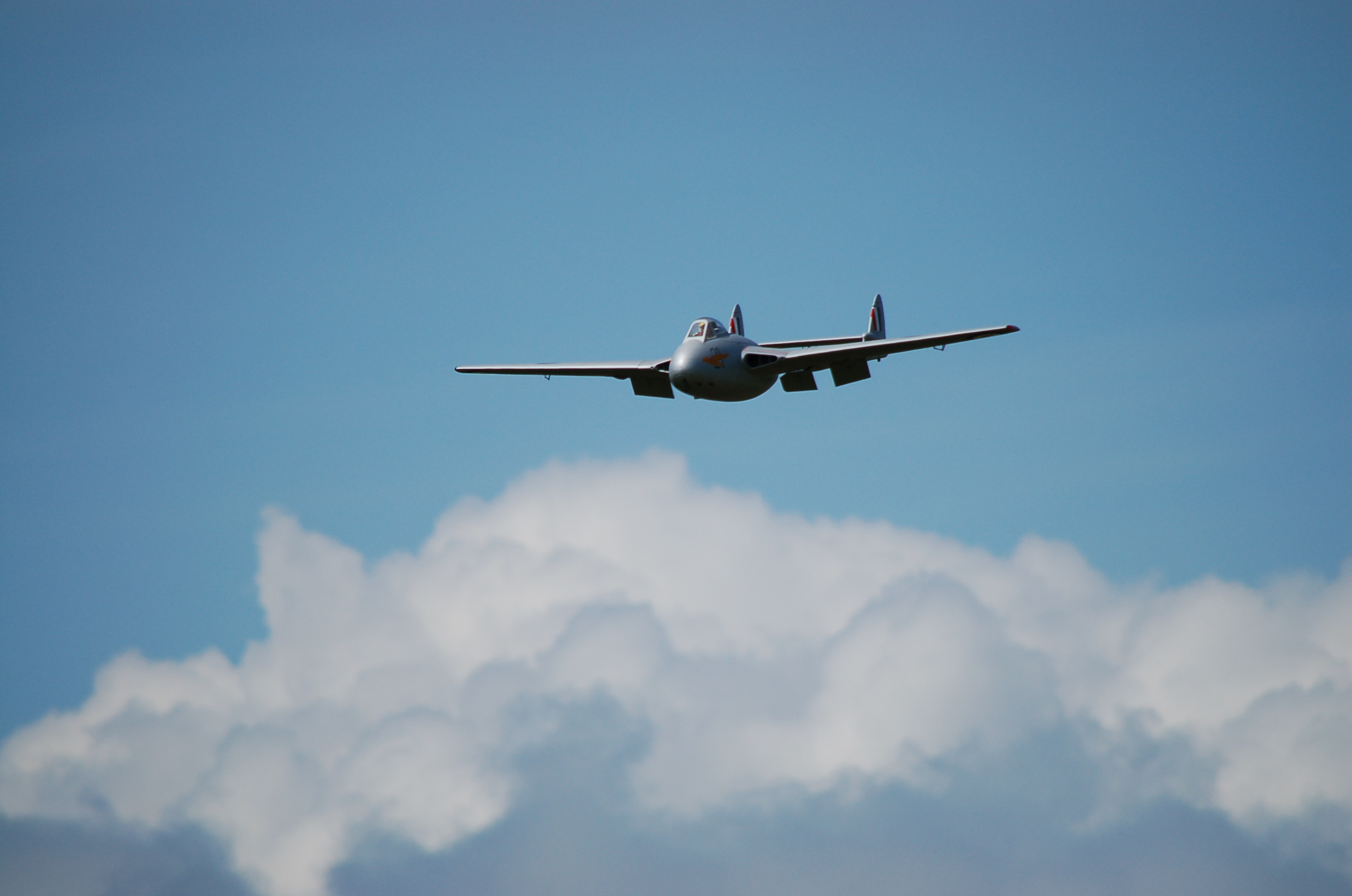

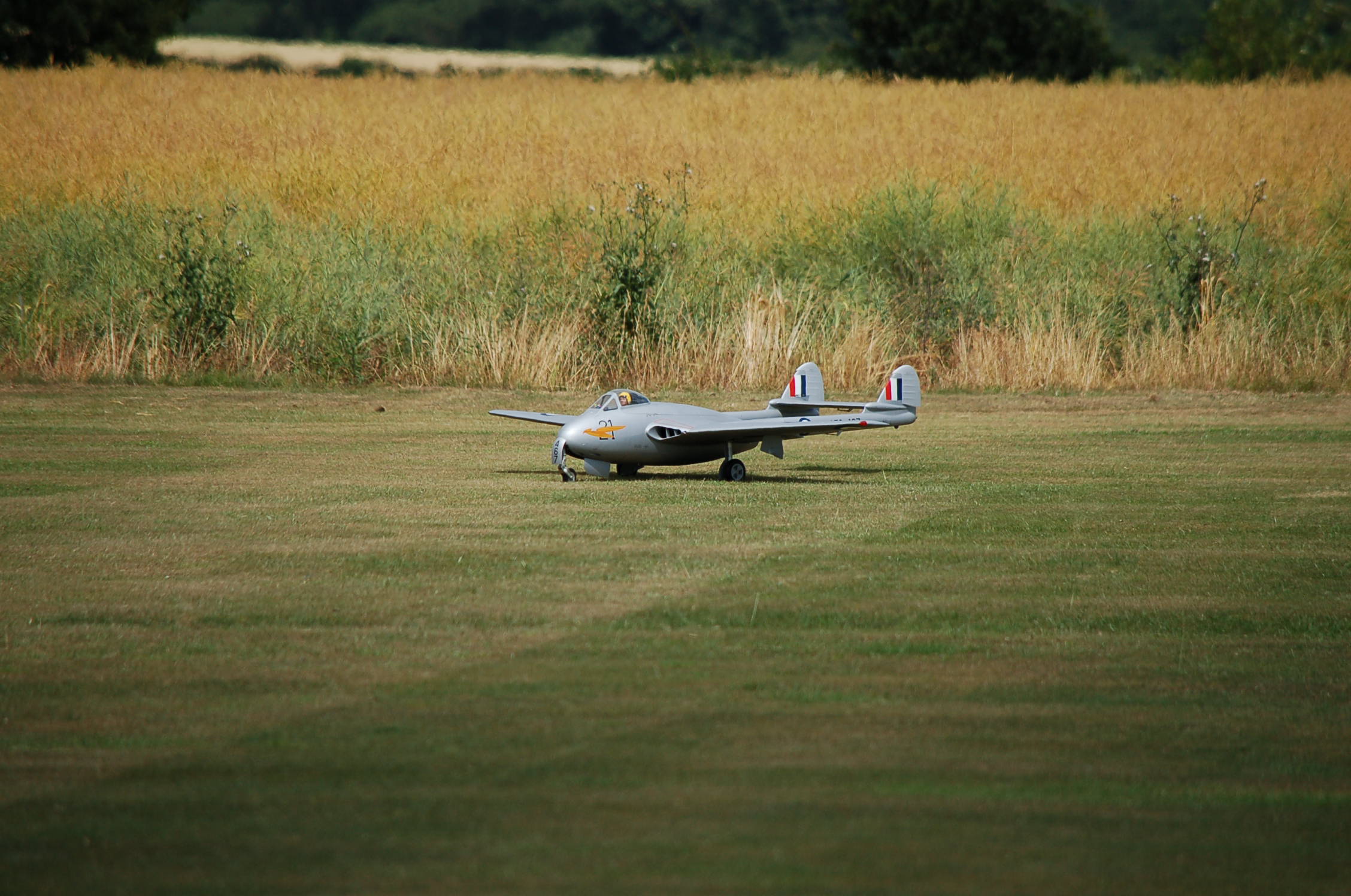

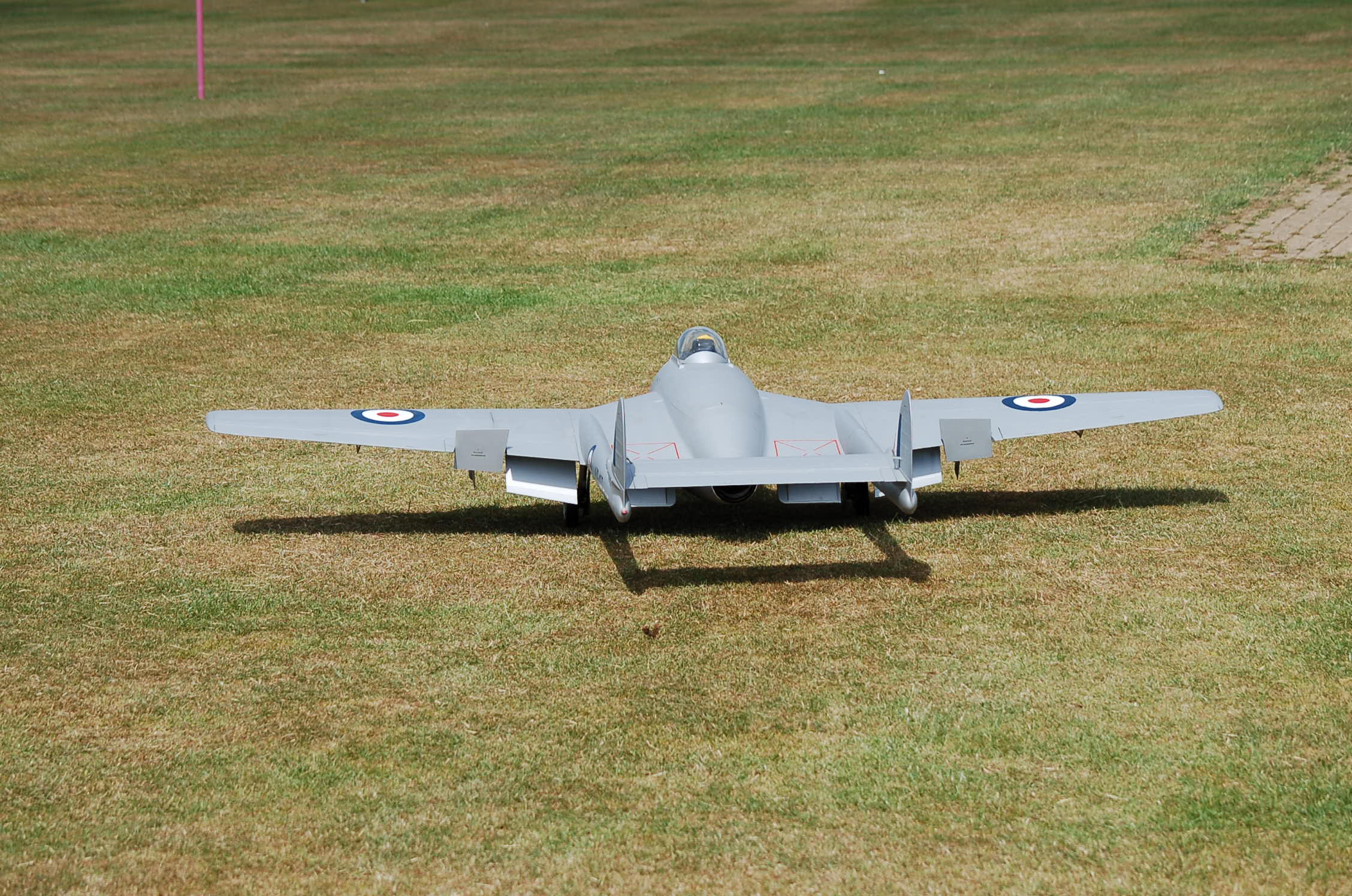

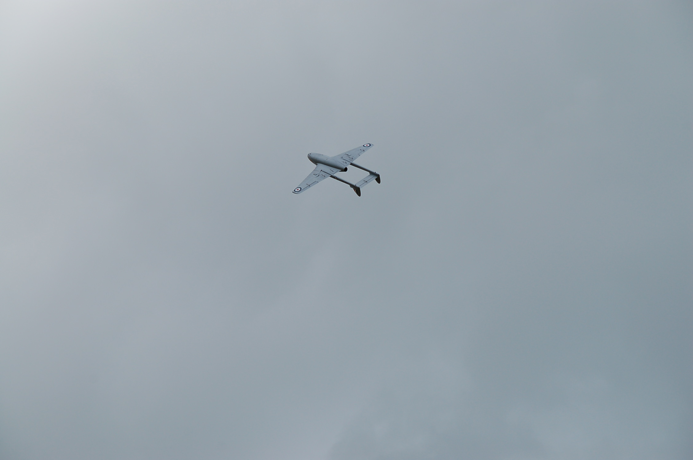

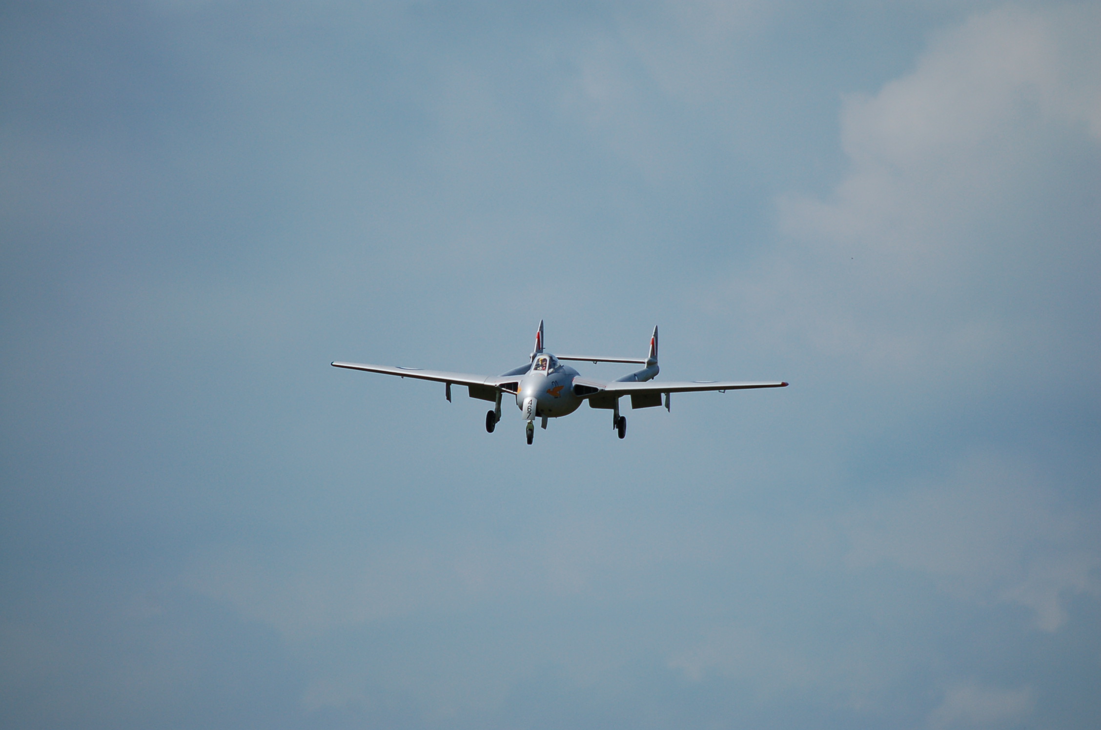

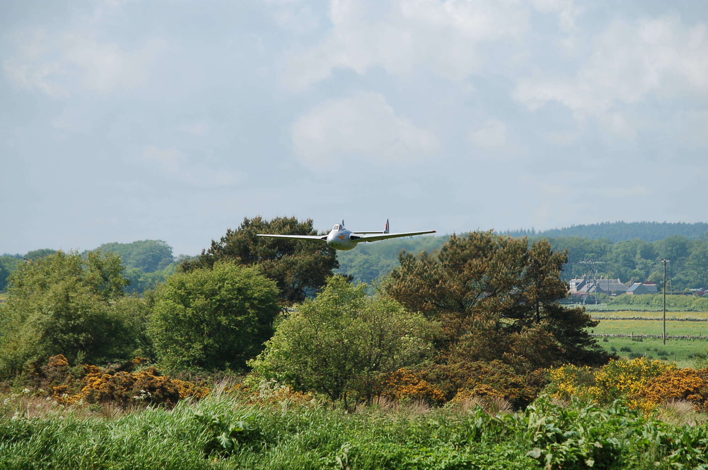

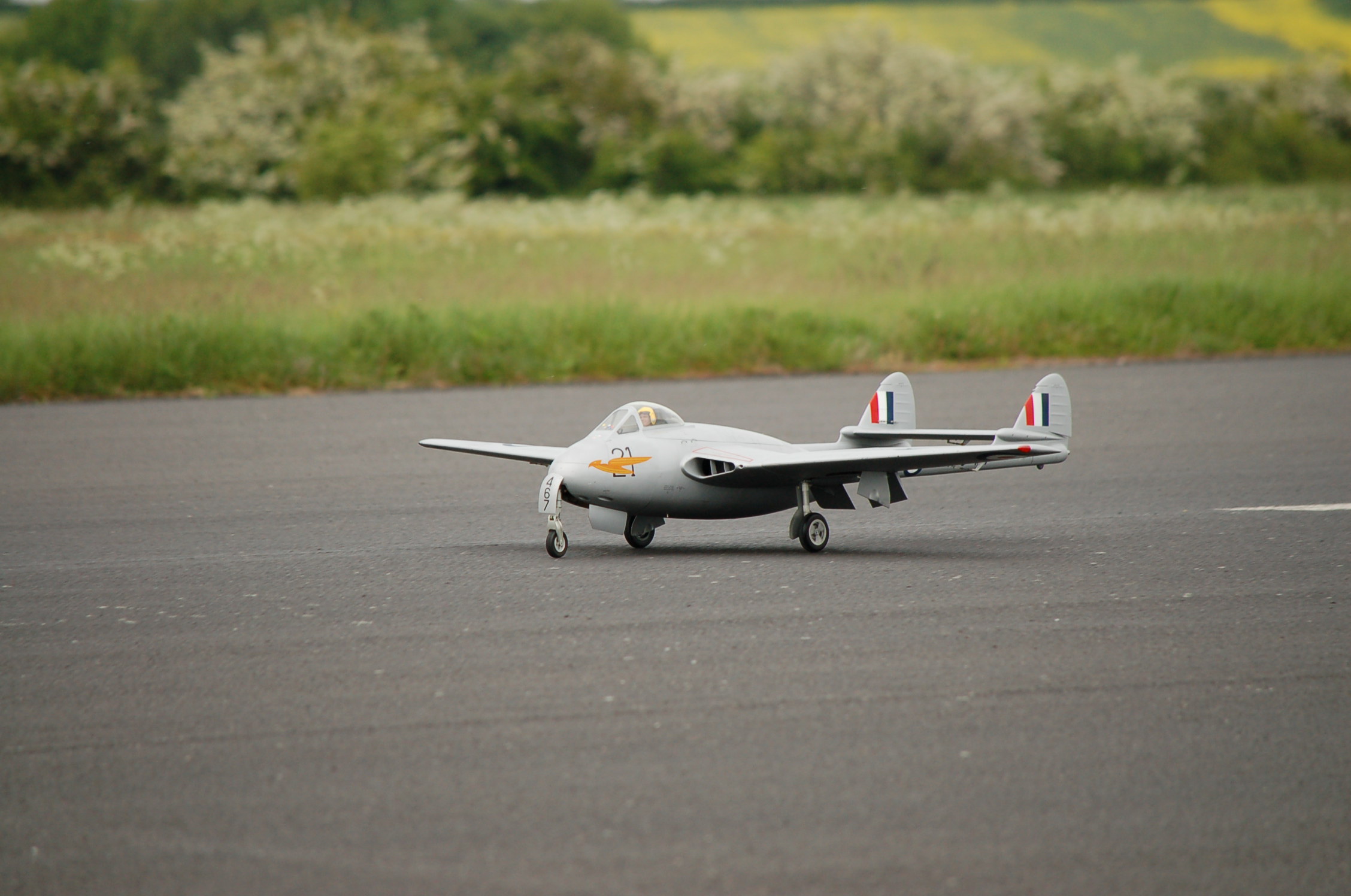

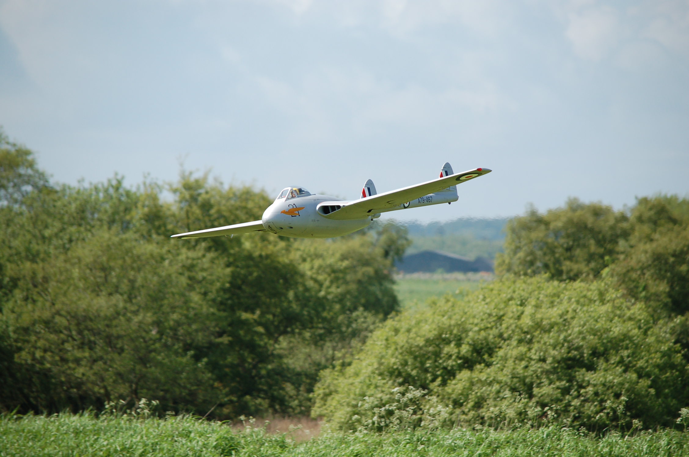

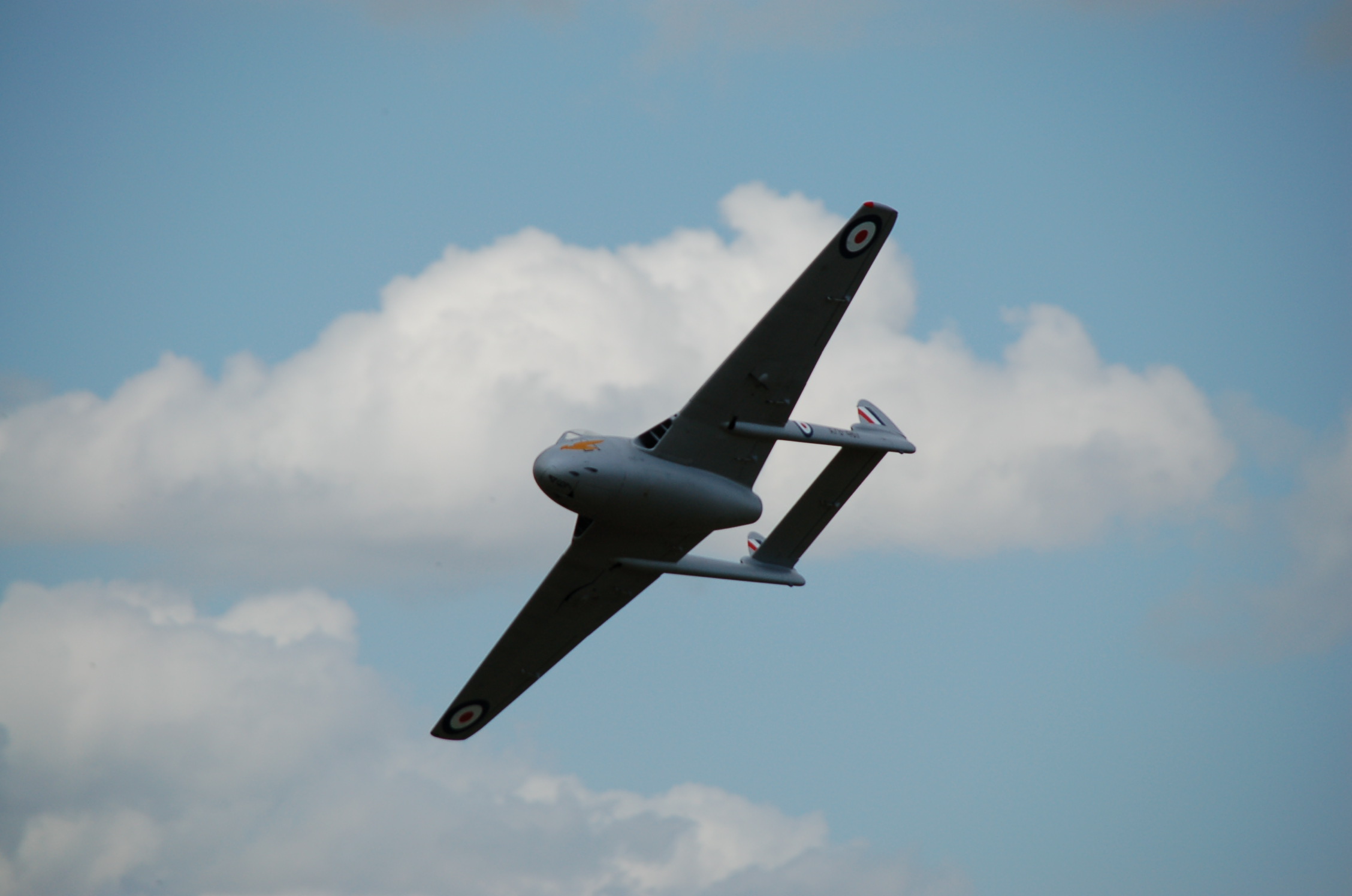

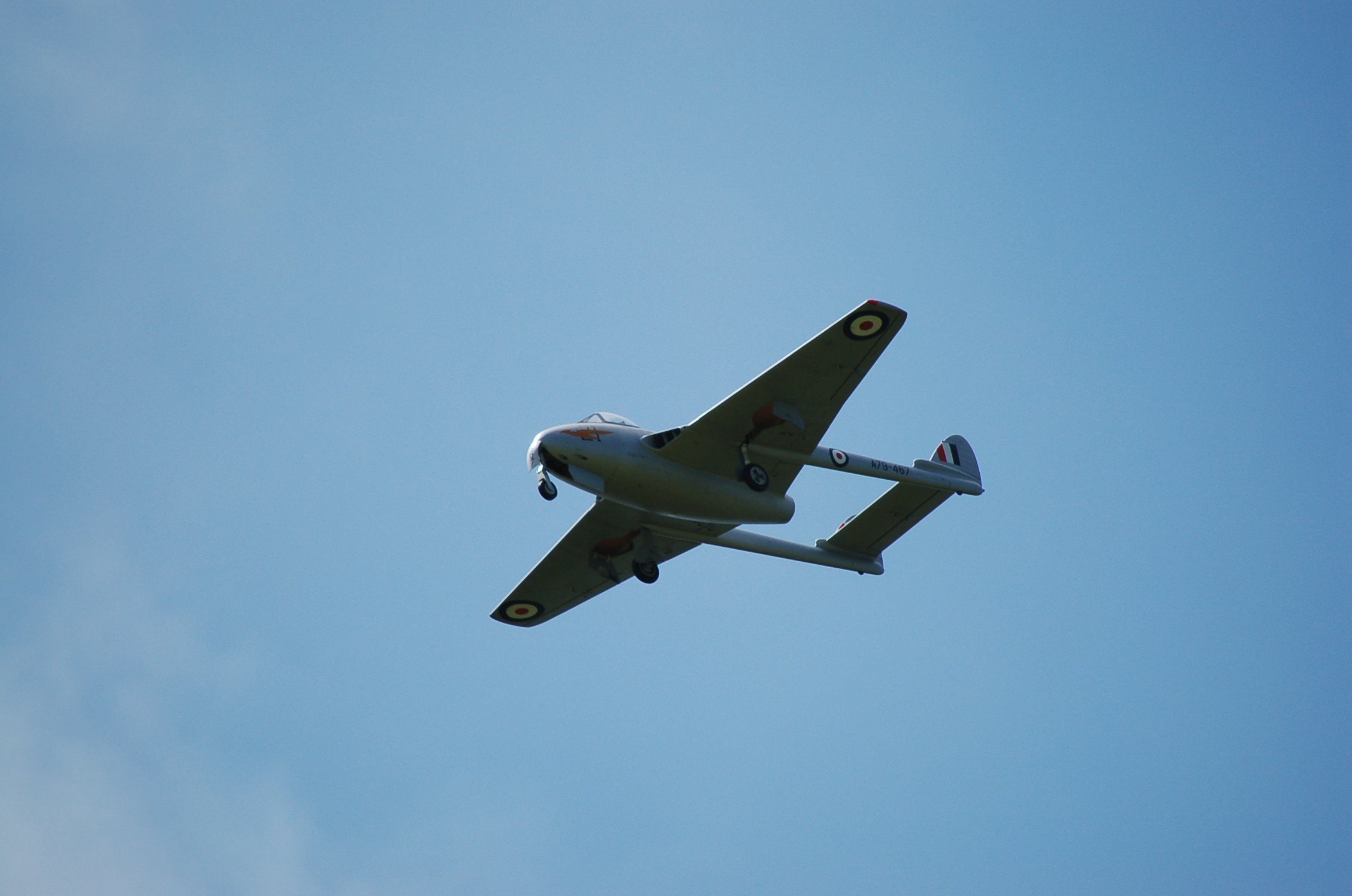

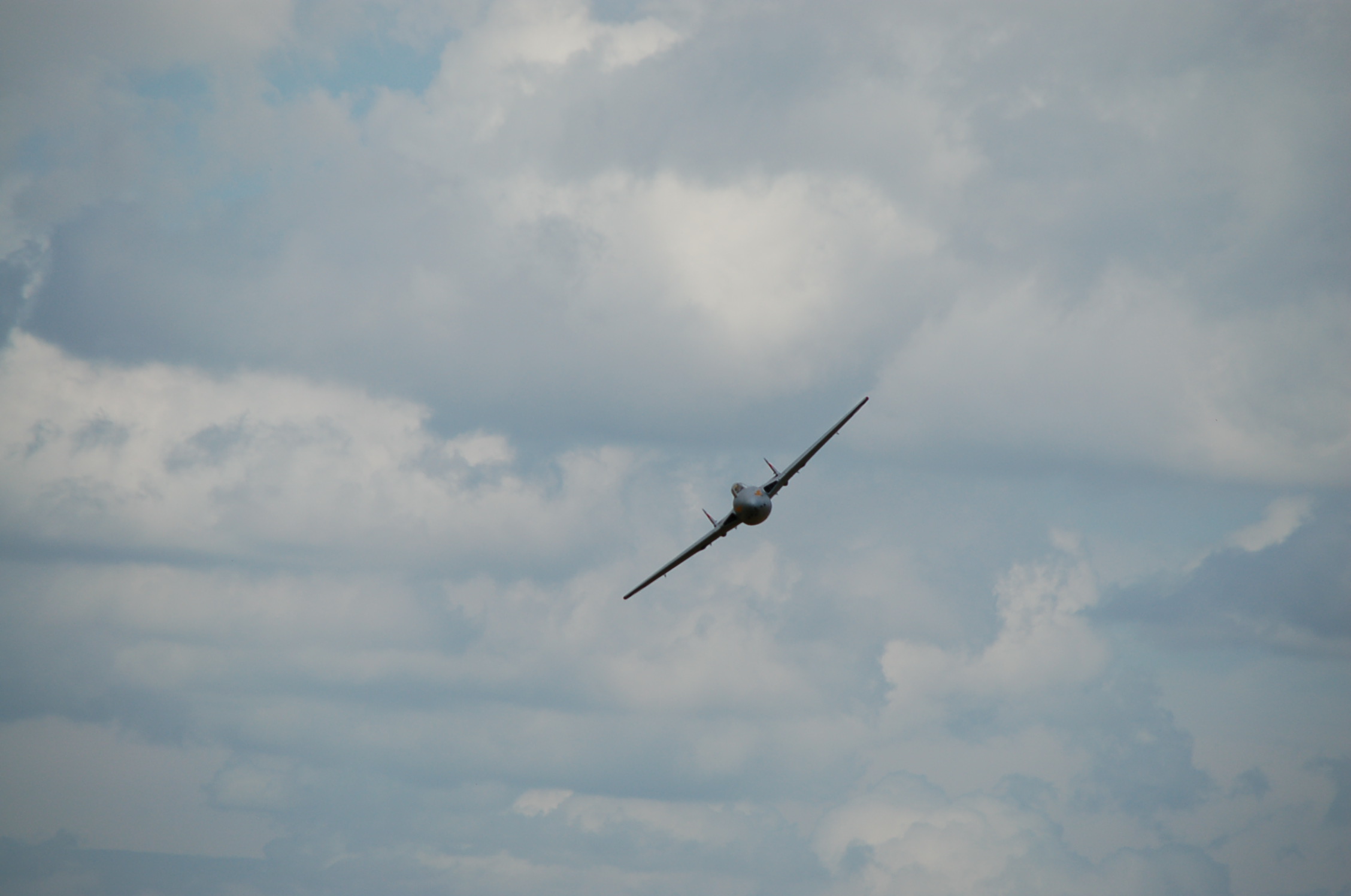

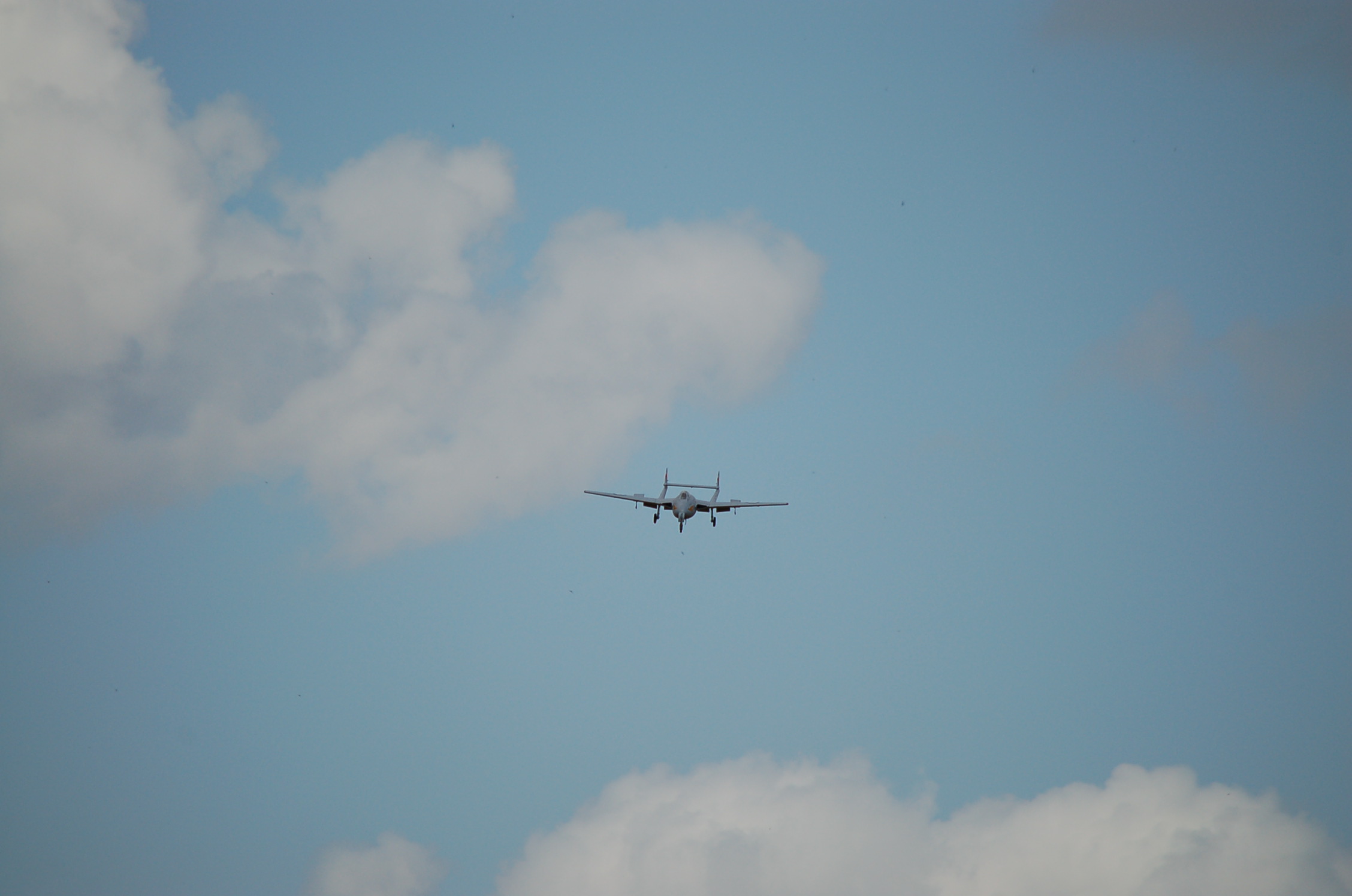

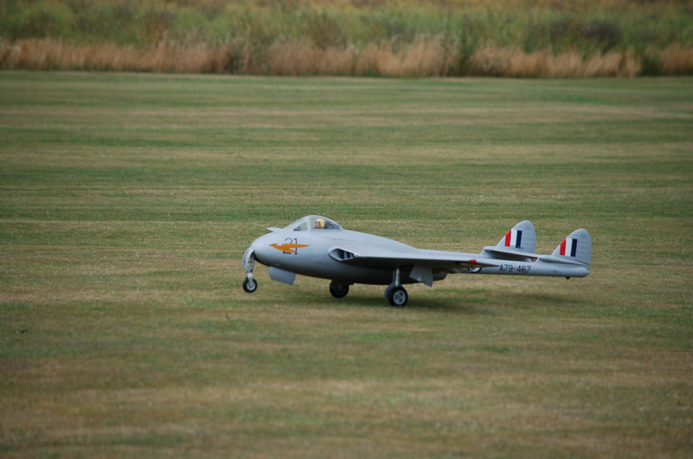

Took the Vampire to Scotland last weekend, not the friendliest site to operate jets, but the guys had done such a good job on the strip I decided it was a good time to show her off to our northern most friends. Looked great in and out of the trees :-)

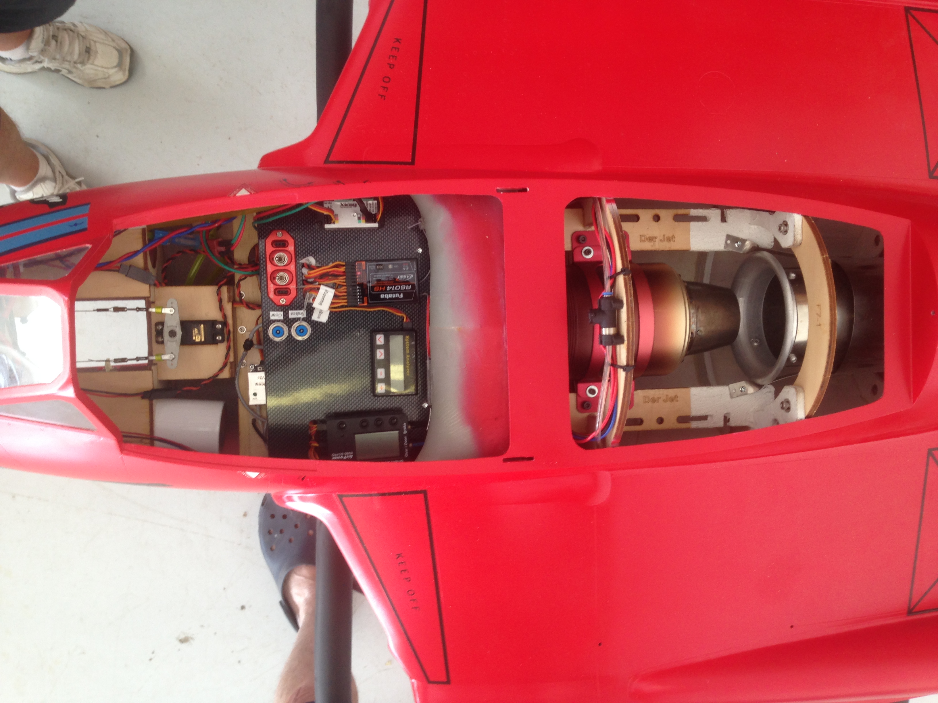

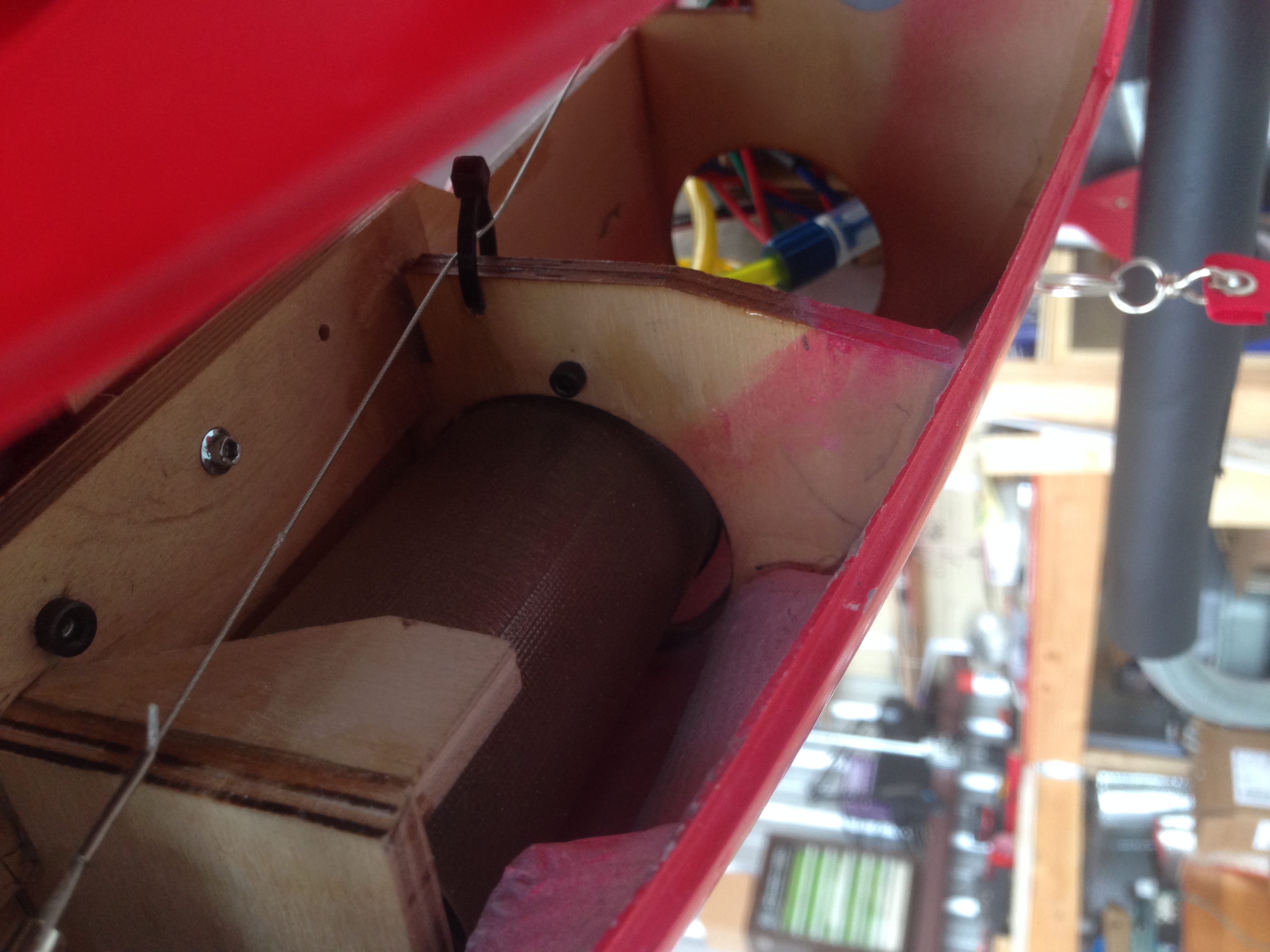

Default I used Less Lead
I fell in love with the Vampire after seeing it at the Kentucky Jets event last summer. There I met Jim Hiller and Eric Clapp of Jet Central/Der Jet. The rest is credit card history.
John Cunningham and I just finished building the Vampire and I wanted to share a way to save on nose weight. From the picture on the left you can see the area next to the nose gear where the UAT is placed. It is supported by the partial box and the gun port in front. In the back it is locked in with a forked wood support that has a blind nut, screw etc. The picture is looking from the bottom up.
I followed Jim Hiller's balance suggestion and placed the CG 15 mm behind the leading spar blade edge. The total of 35 oz of lead was used or 2.18 kg. All components are in front of the duct work as you can see in photo number 2.
Perhaps someone will like what I have done here as the UAT represents close to 8 oz of usable weight instead of lead. The turbine is a Kingtech 100, the flight batteries are 2-3800 LIFE packs, and the turbine battery is a 3800 9.9V Life as well. I have completed taxi tests, braking tests and will perhaps fly it this weekend.
By the way I hope everyone is enjoying the latest RC Jet International Magazine, our Monster Energy Jet Jam is featured in this issue. I am president of the club and want to extend an invitation to everyone here to come out and fly Jets with us.
Here is our clubs web site. www.cvrcclub.com Go to the video page and enjoy the Jets flying in our clear desert skies. We have videos from past jet events there.
Perhaps these suggestions help someone out.

Dan, Good luck with the test flight, you know I enjoy flying my Vampire. Be careful with the elevator control throws, follow the recommended travel from the manual, and and expect elevator trim center end up a bit, may 1/16" or so. Enjoy flying her.
Jim

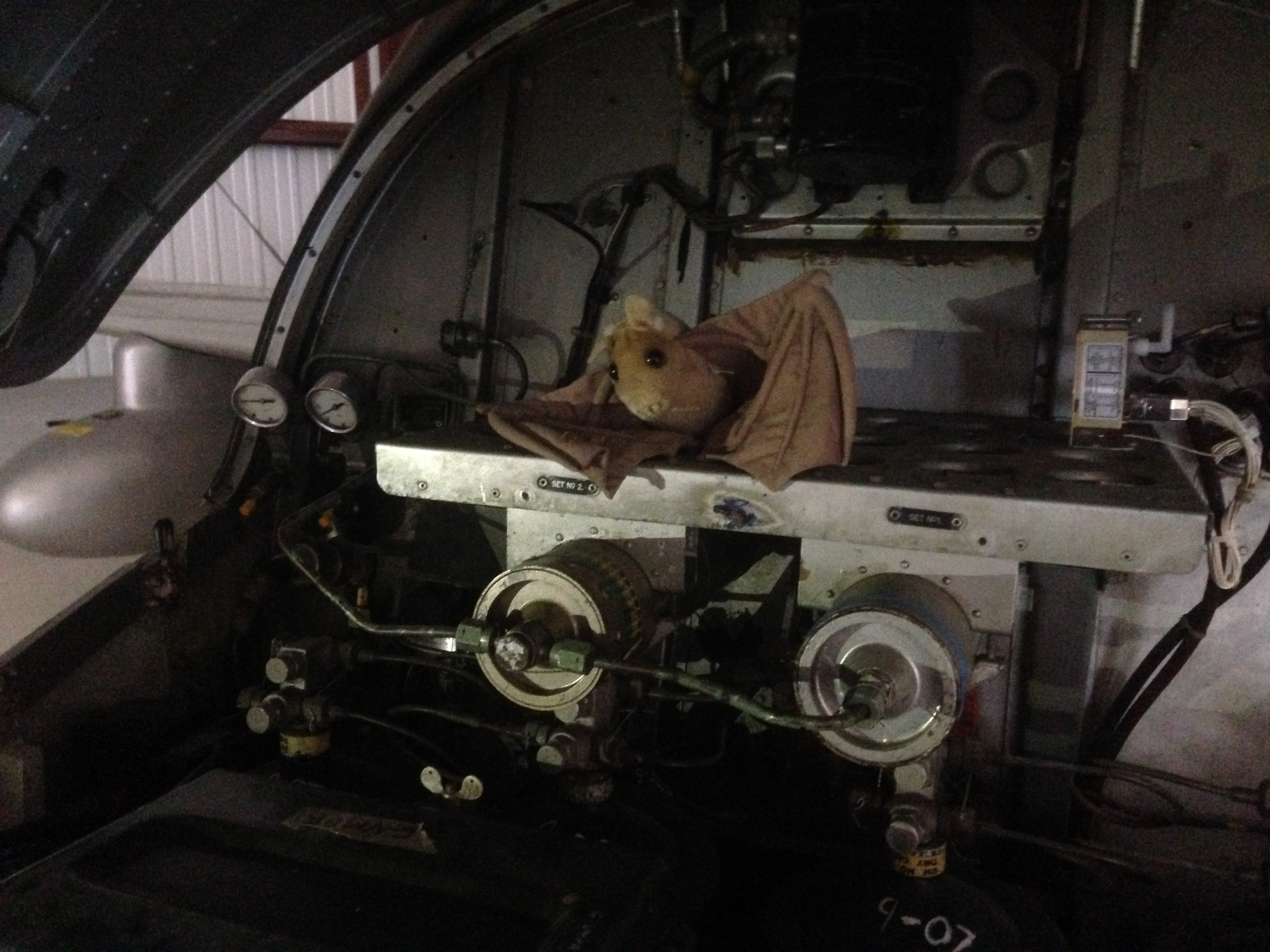

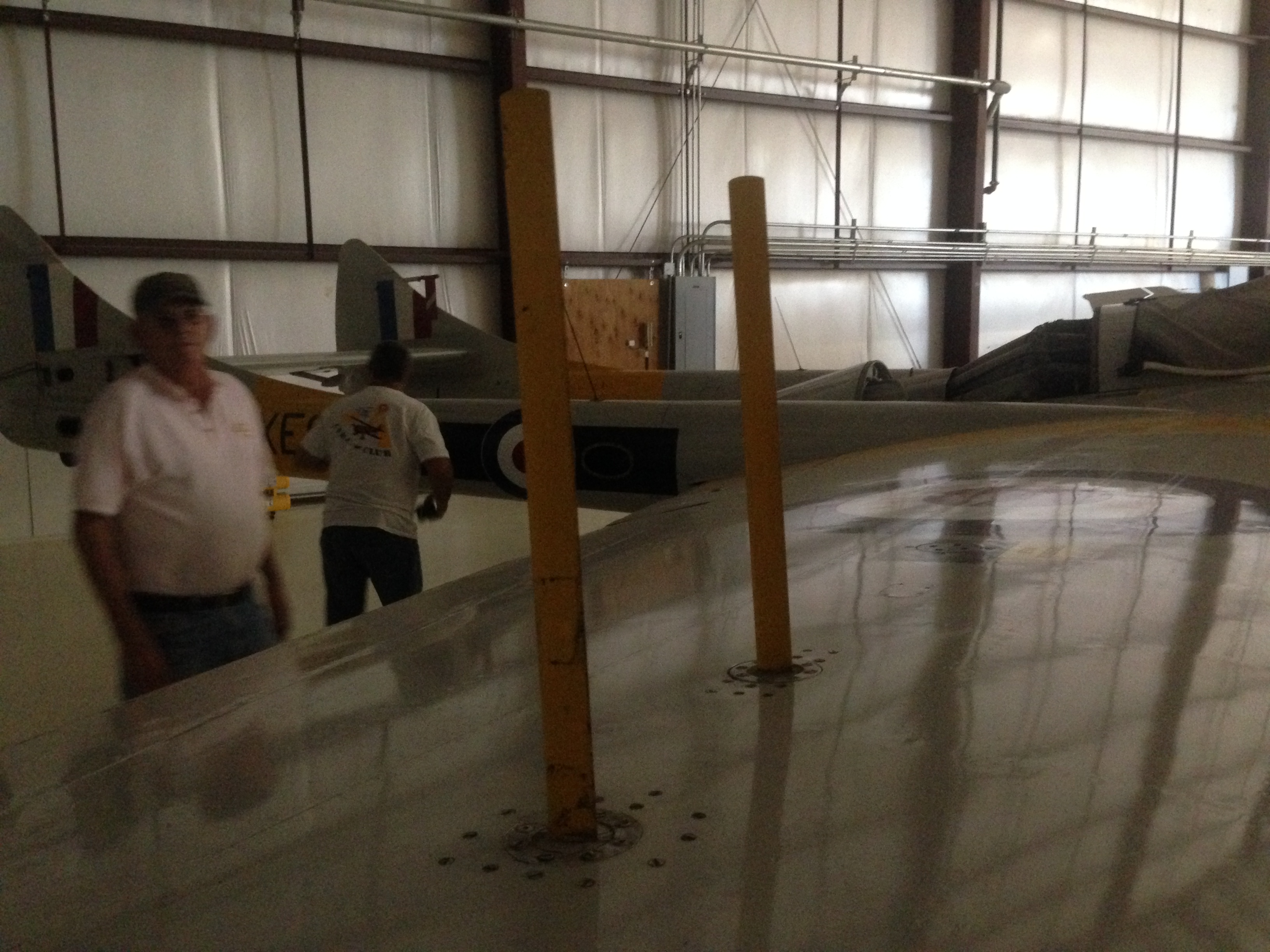

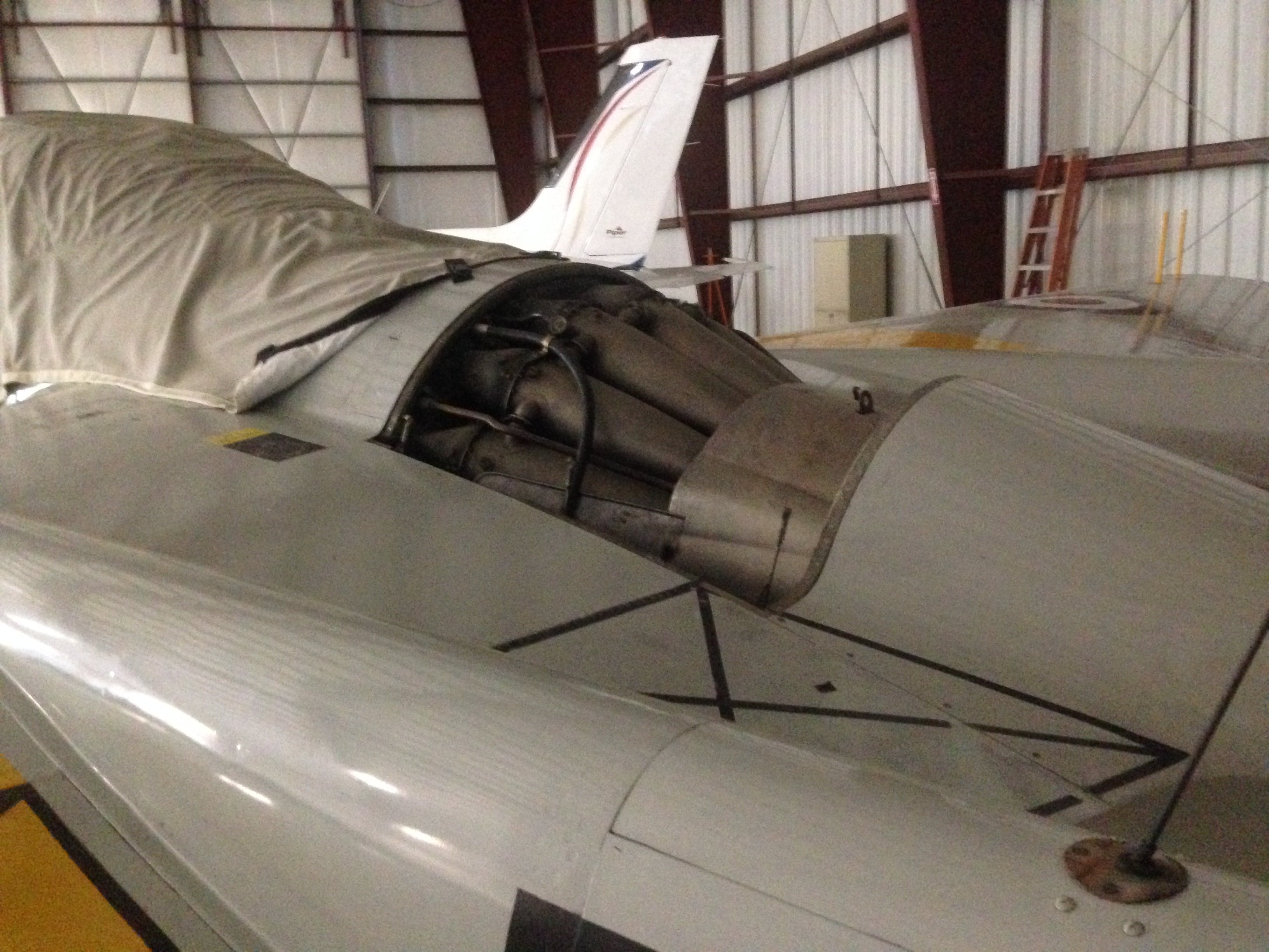

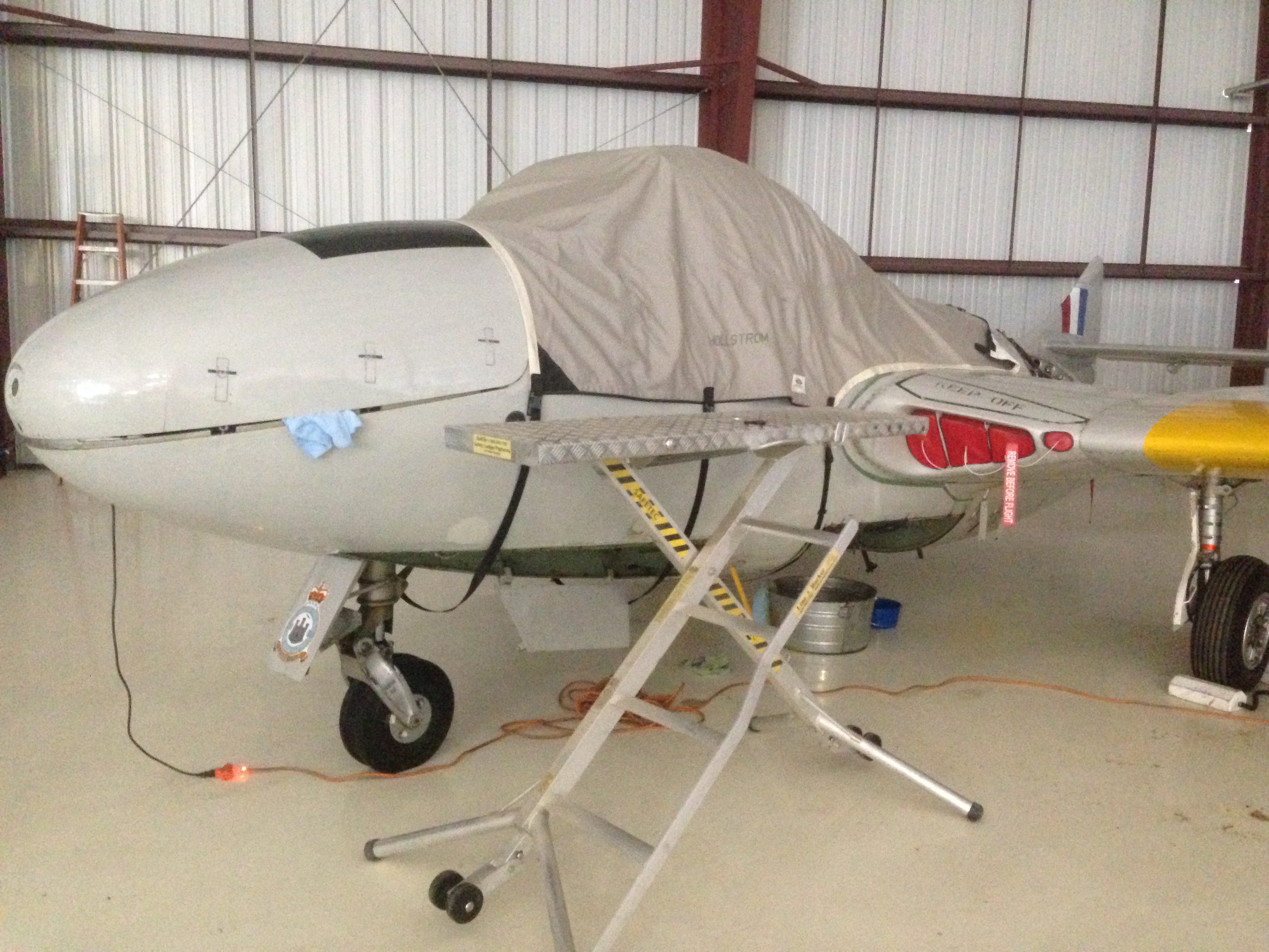

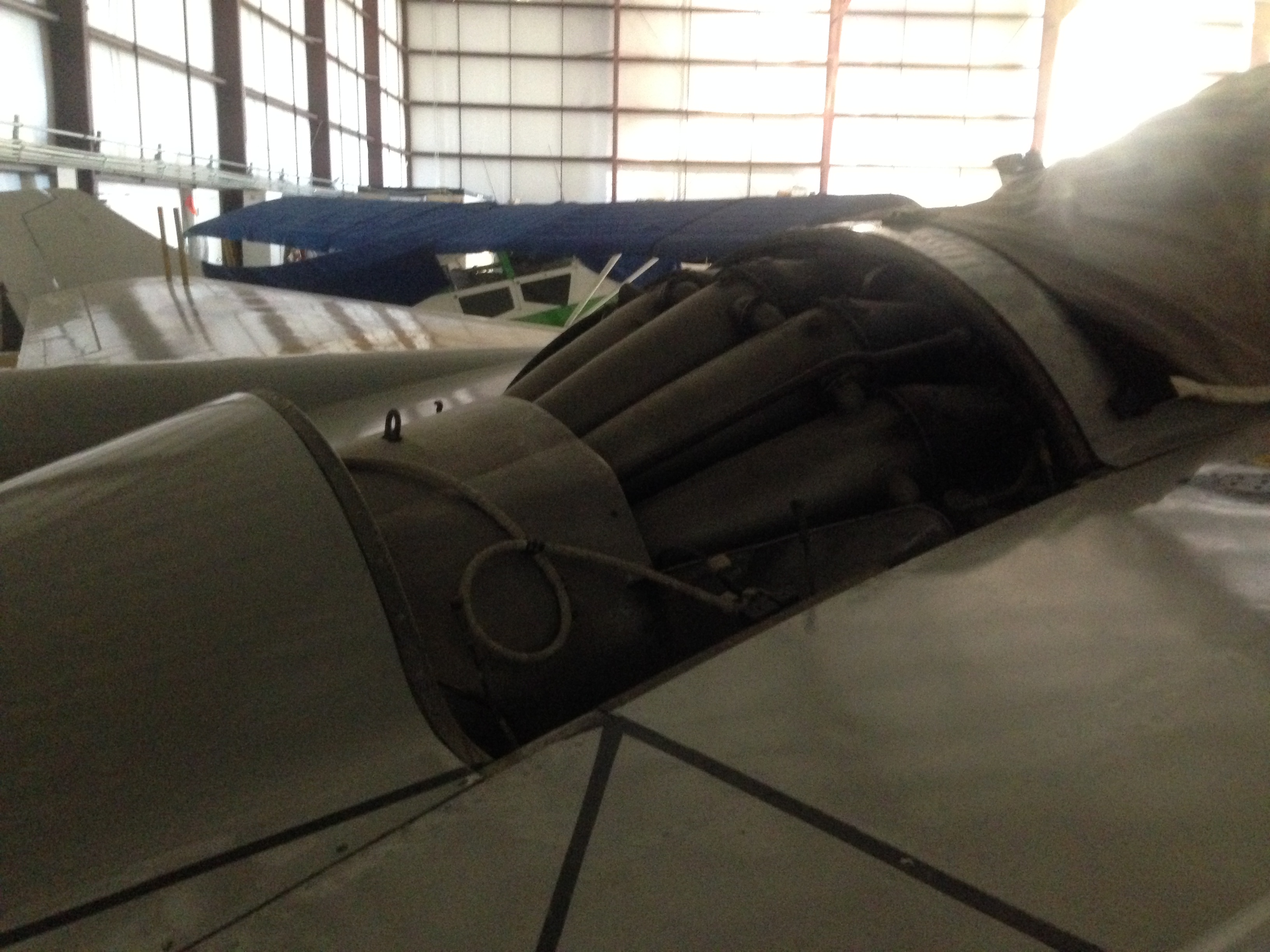

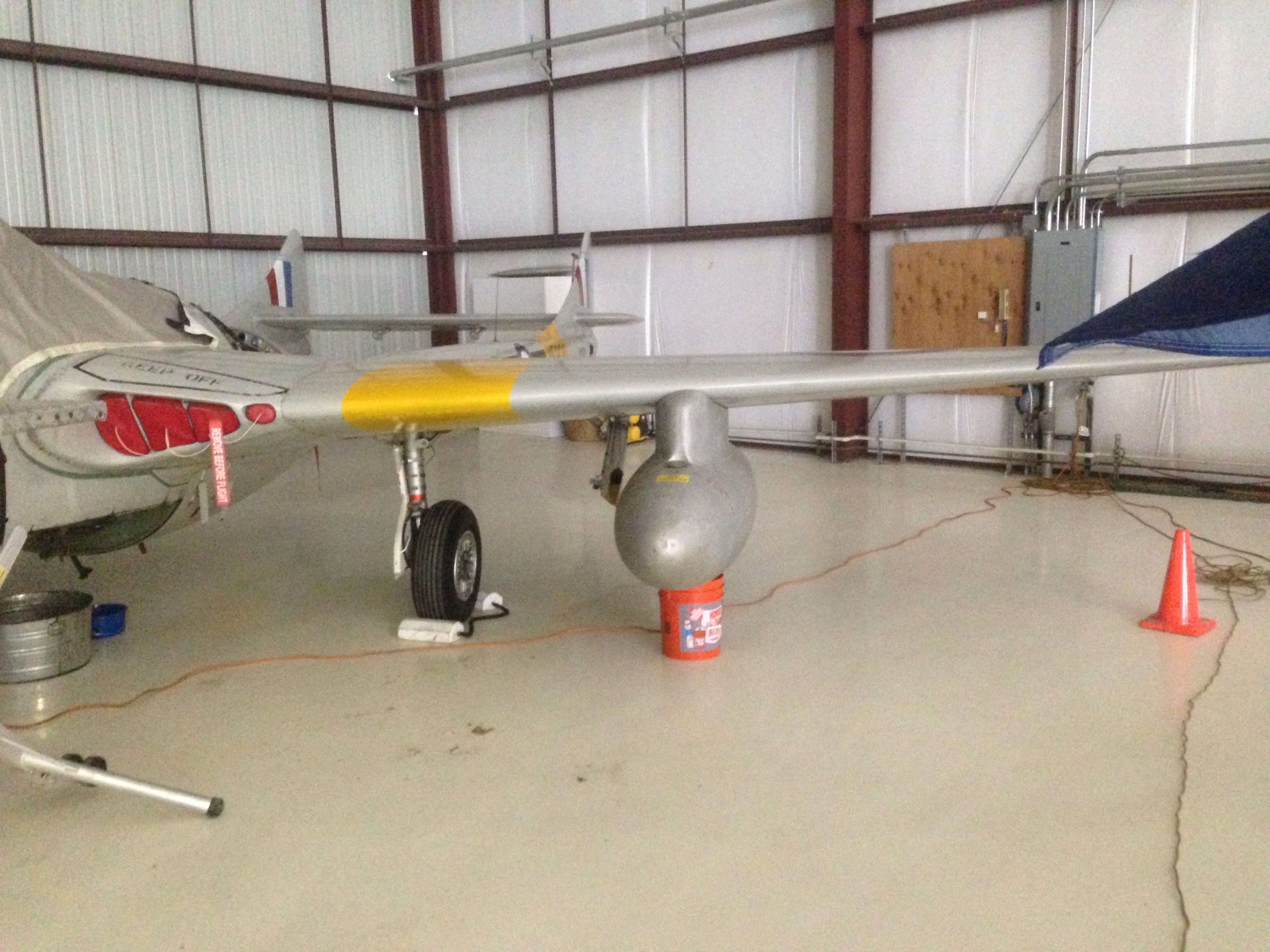

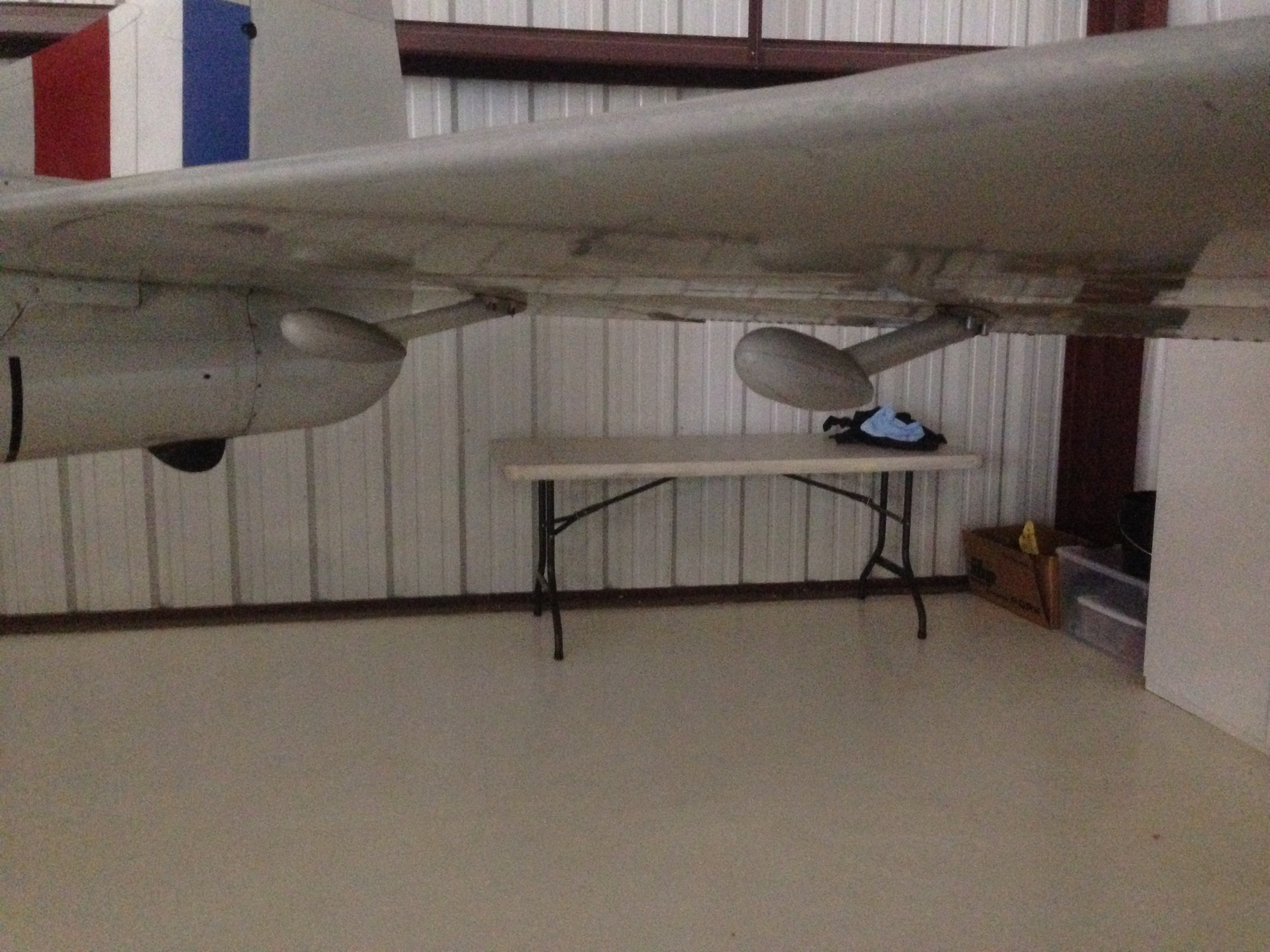

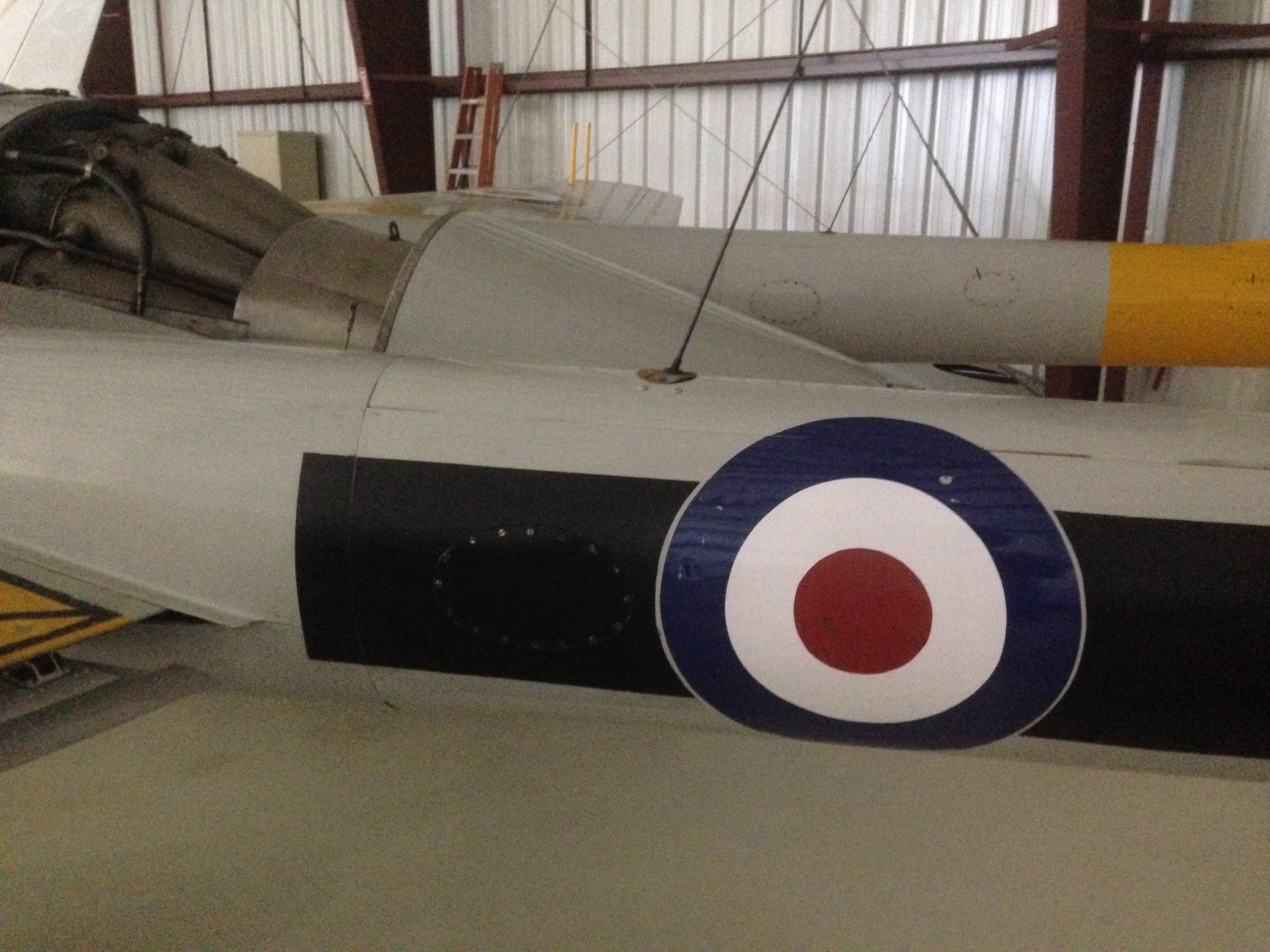

Hi Jim and Everyone, once again Jim thank you for your input, I will follow those suggestion to a tee.
We built the vampire in a Jackie Cochran Airport Hanger, on the other side of the air port is a hanger that houses a real Vampire. I had the good fortune to get into the hanger to take some pictures. I know they are not the best quality but you can see the Whittle Engine, and the Elevator lead weight balance etc.
One of the shots has a Vampire Bat doll in it, what a hoot. also in one picture, the fourth image, there are two yellow stakes that are diamond shaped they are on top of both wings, I am puzzled as to what they are used for? Any ideas? They could not be fuel dump sticks?

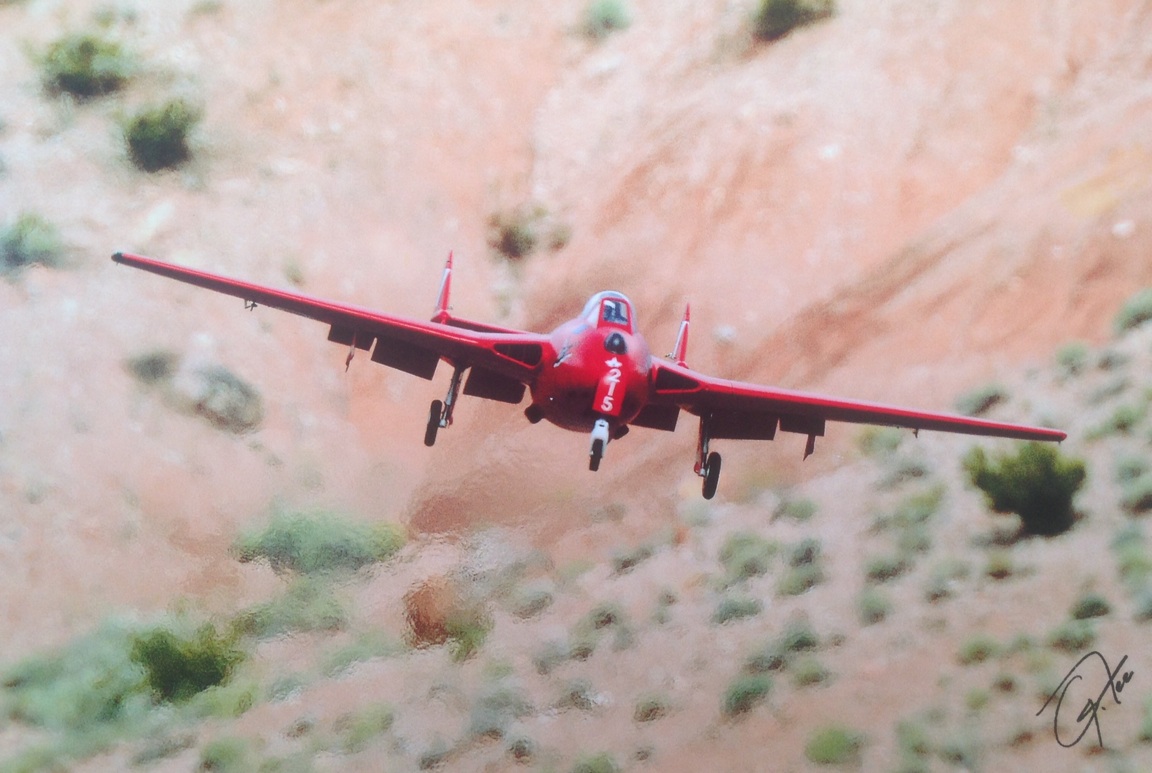

Hi Everyone

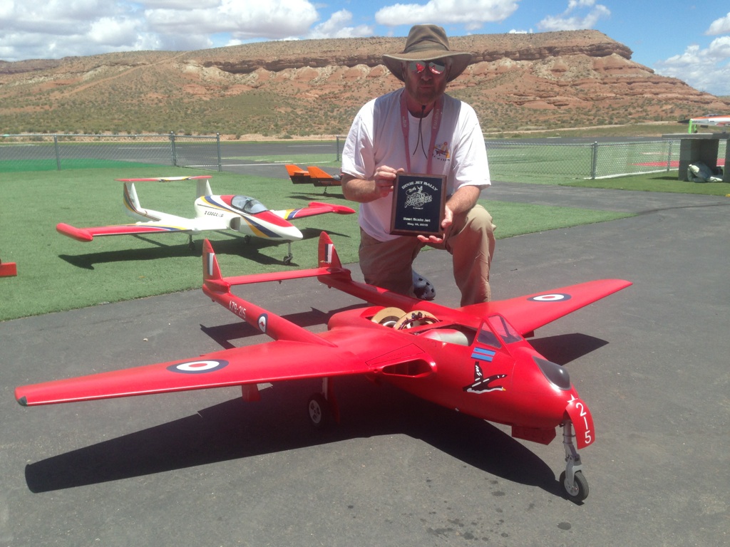

Just got back from The Dixie Jets event in St. George Utah.
I was honored to win the Best Scale Jet award with the Vampire.
I have attached some pictures to share with you all.
Yes I know one of the shots is of my Torus but it was so neat I just had to included it too.
I also must say that a lite dab of grease on the brakes solved my braking problem too. Excellent advice.
Thanks to everyone for being so helpful!

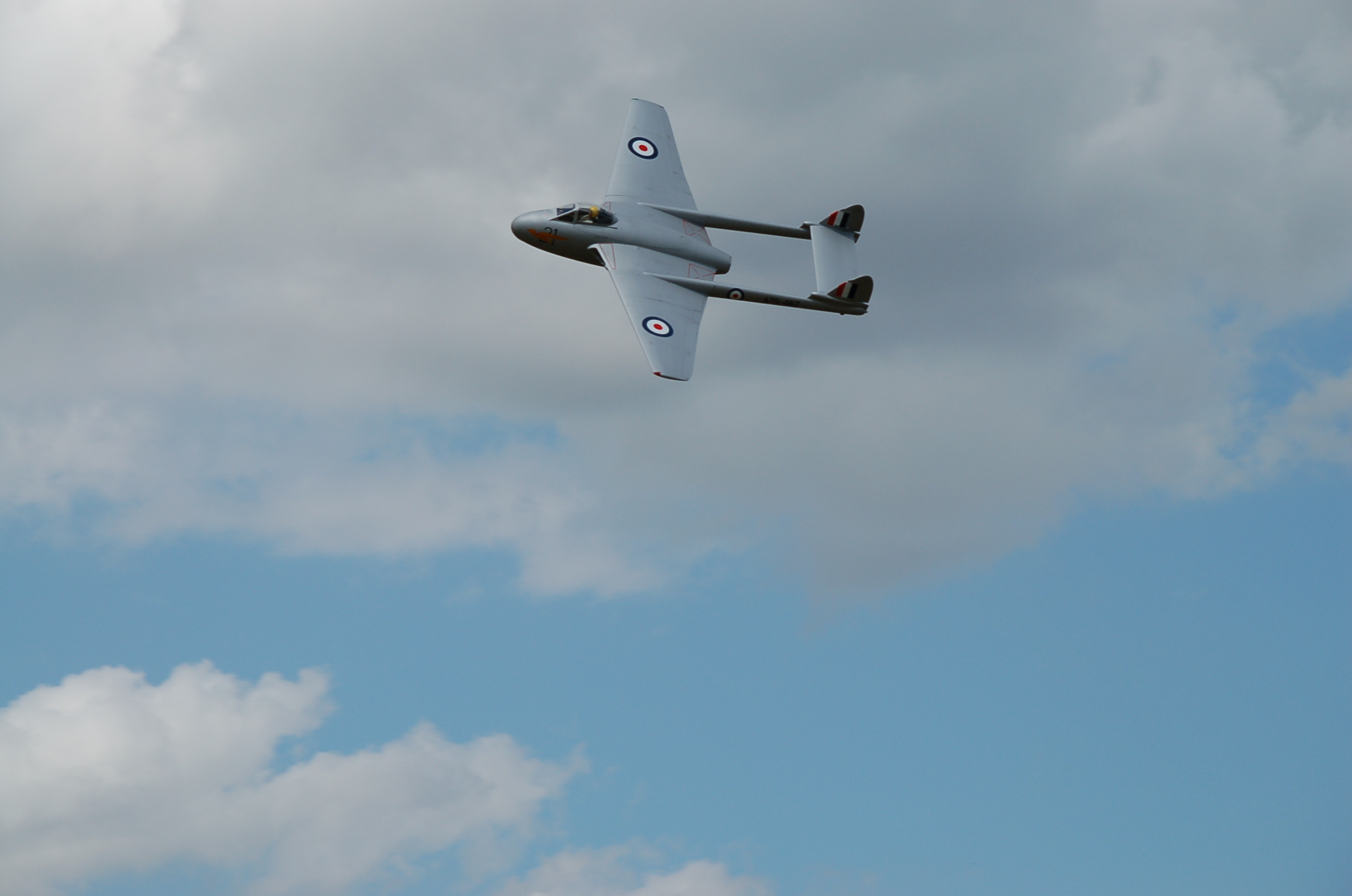

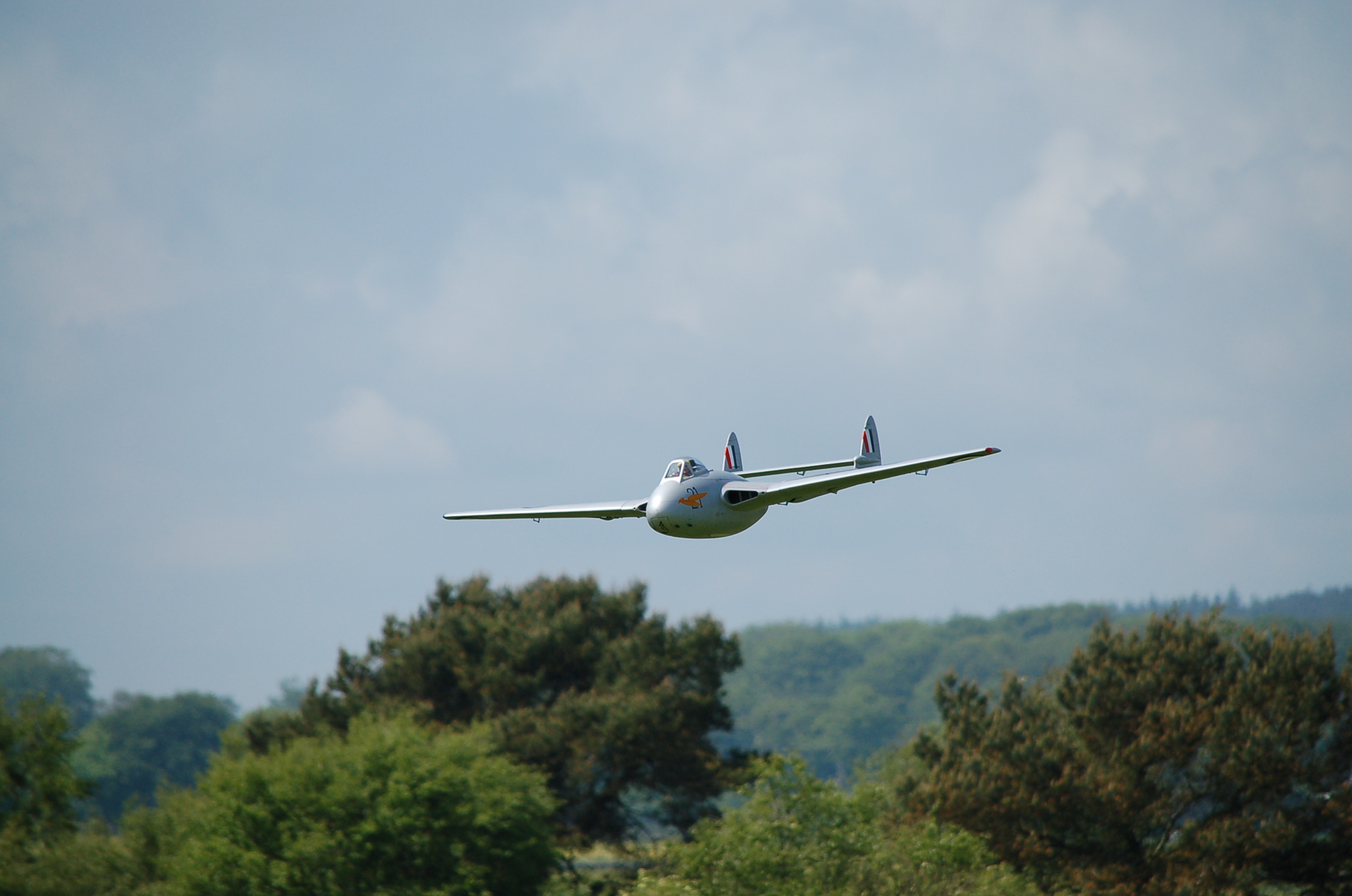

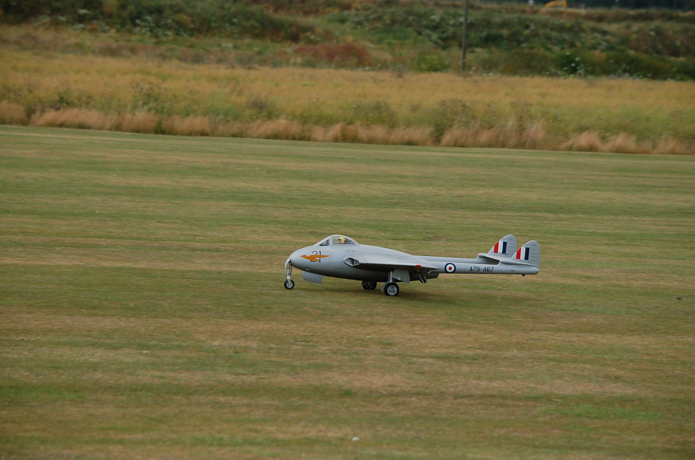

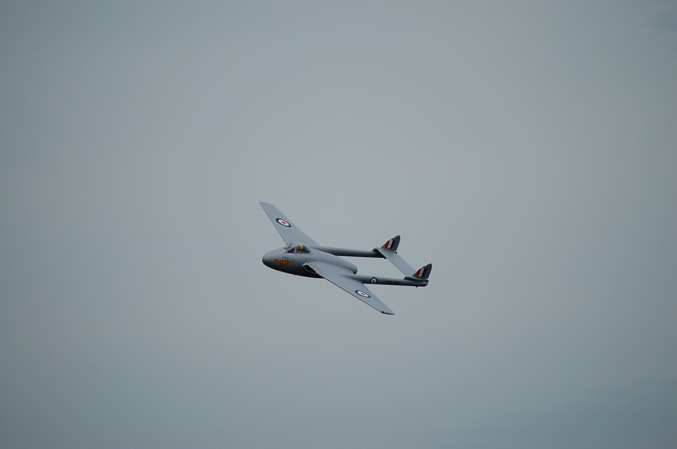

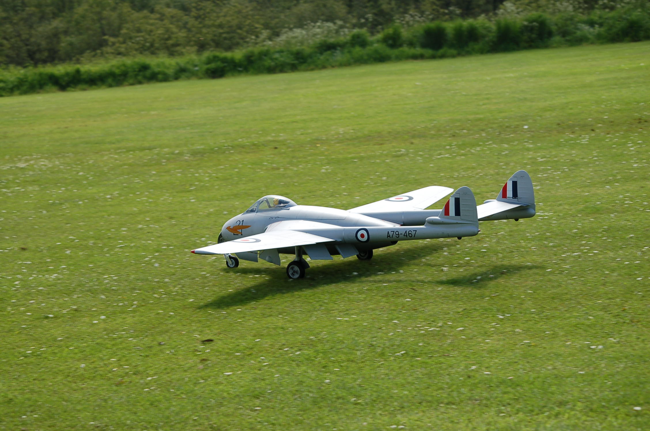

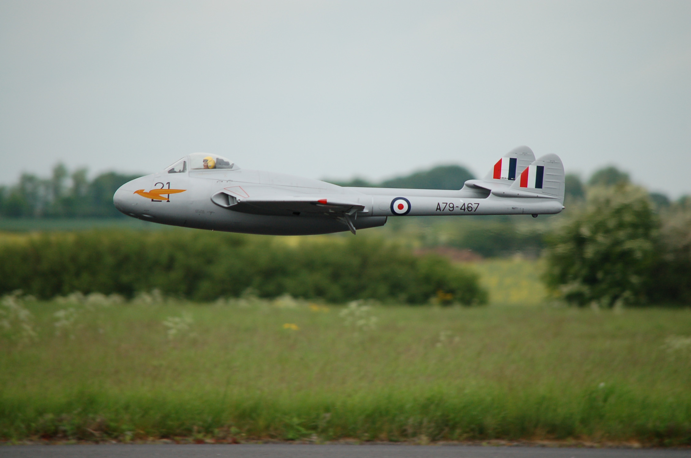

Thread starter out again today, great conditions made it a ball to fly, so much so, I allowed "little Stevie" his first complete flight with it-loved it!!
