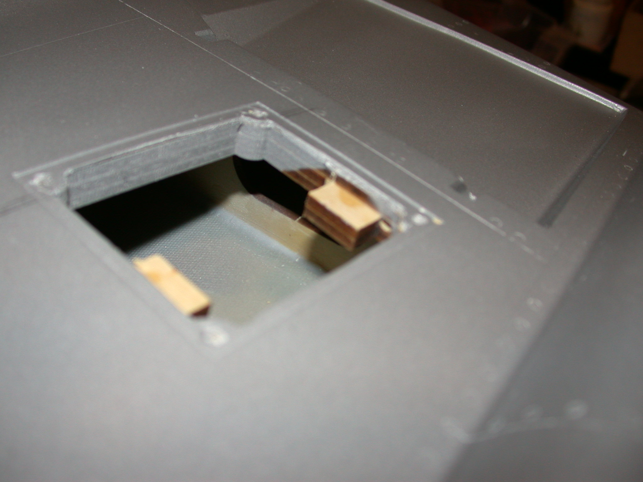

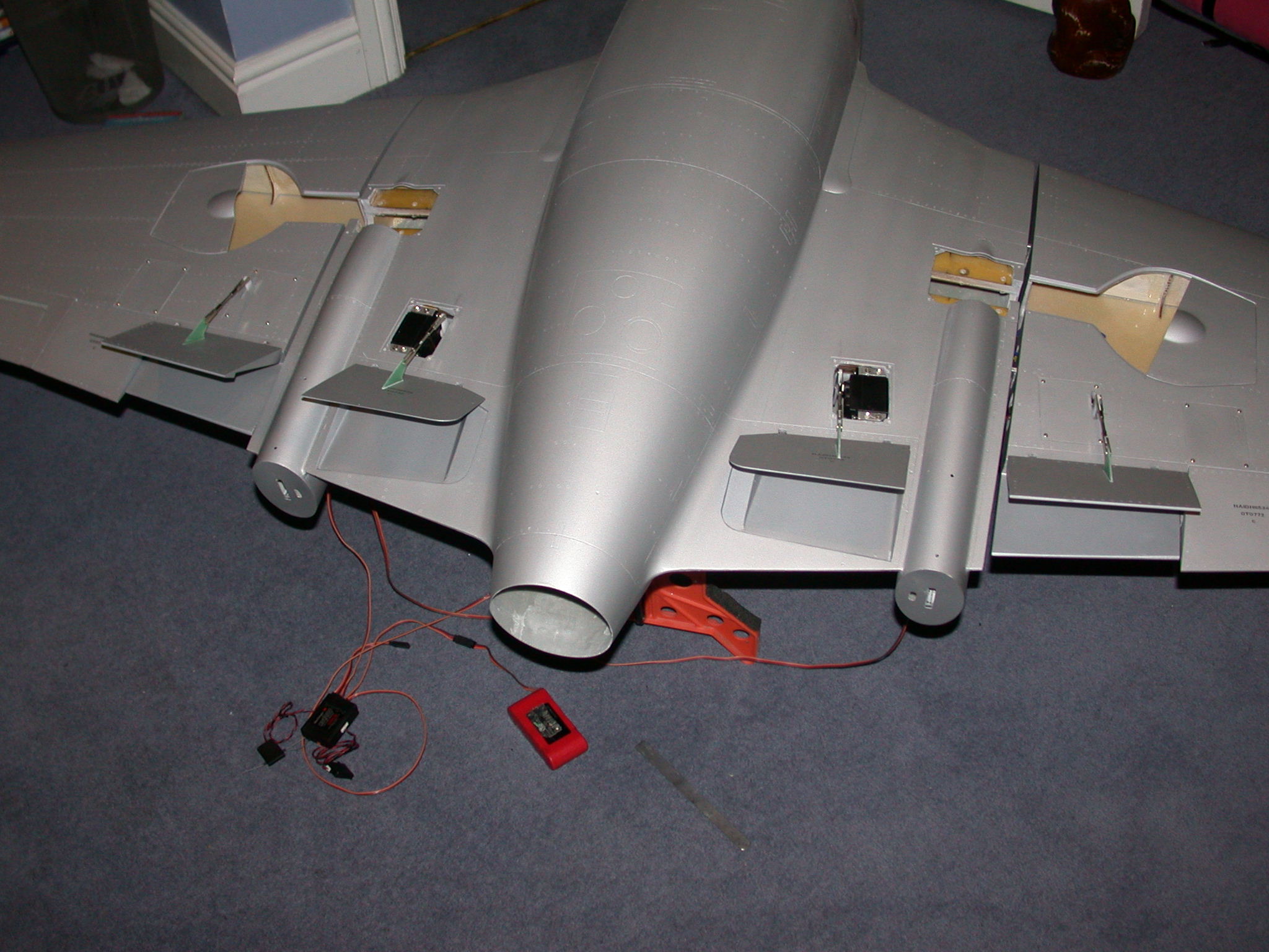

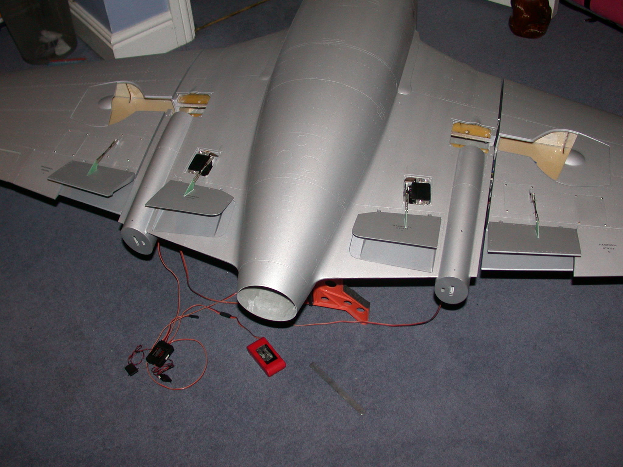

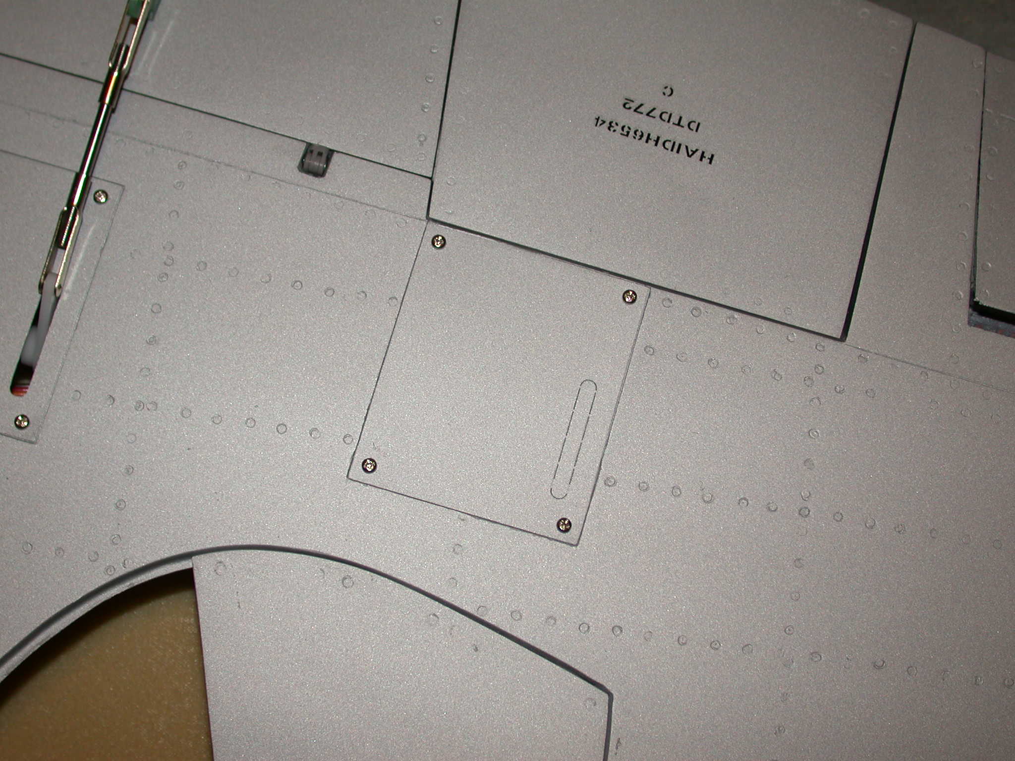

With the Habu 32 finished, I'm back on the Vampire.
Need to finish fitting the other wing out with its door ram, but while doing it, I decided to add some of the missing rivets on the servo covers. Brass tube with the end rough in a drill...
ID:	1570933   Click image for larger version

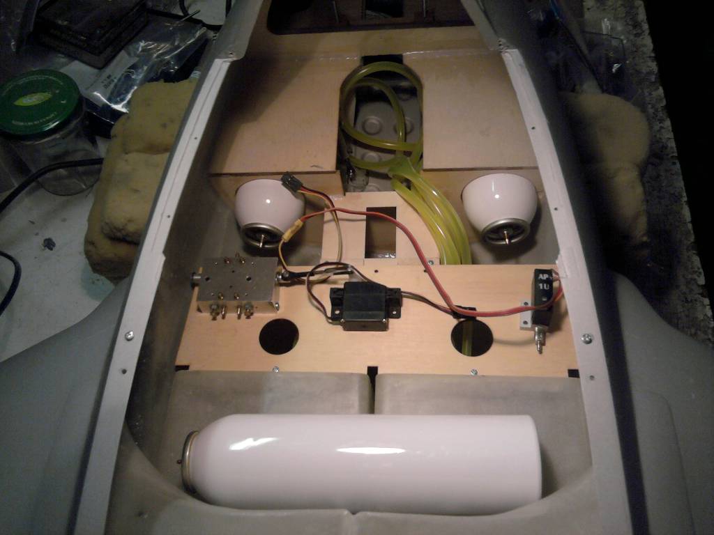

Old 03-01-2011 | 12:03 AM
  #84
Joined: Mar 2004
Posts: 1,567
From: ferrara, ITALY
Default RE: DerJet DH Vampire build thread-
ok Dave...send me your installation photo when done...
the emcotec or powerbox , rx ,must to be accessible to service but is not possible to fit
under the cockpit
i think that should be cut the nose to create a panel access like full size plane...or fitted between cockpit and inlet duct

Christian
No, I thought of flat area under cockpit, but there is only 12mm space. I think Rx on the fuselage side next to instruments, maybe PB mounted upside down about nose unit-I need to see what is possible...
Dave
Old 03-01-2011 | 12:38 AM
  #86
Joined: Mar 2004
Posts: 1,567
i think rx on the inlet duct or fuselage side (like your)
UP Valves and servo fuselage side
Pump near to servo steering mount...
boh...

maybe 2 layer (plate wood) under my emcotec position [sm=confused.gif]
in the nose the space will be used for ballast and rx / ecu lipo [sm=confused.gif][sm=confused.gif]
Old 03-01-2011 | 04:41 AM
  #89
Joined: Mar 2004
Posts: 1,567
just 5 min ago i checked the space available into the nose
i can fit the EMCOTEC with AR12000 (velkro fix) one above the other
to the side i can fix the batteries lipo with velkro
under the wood nose plate the ballast

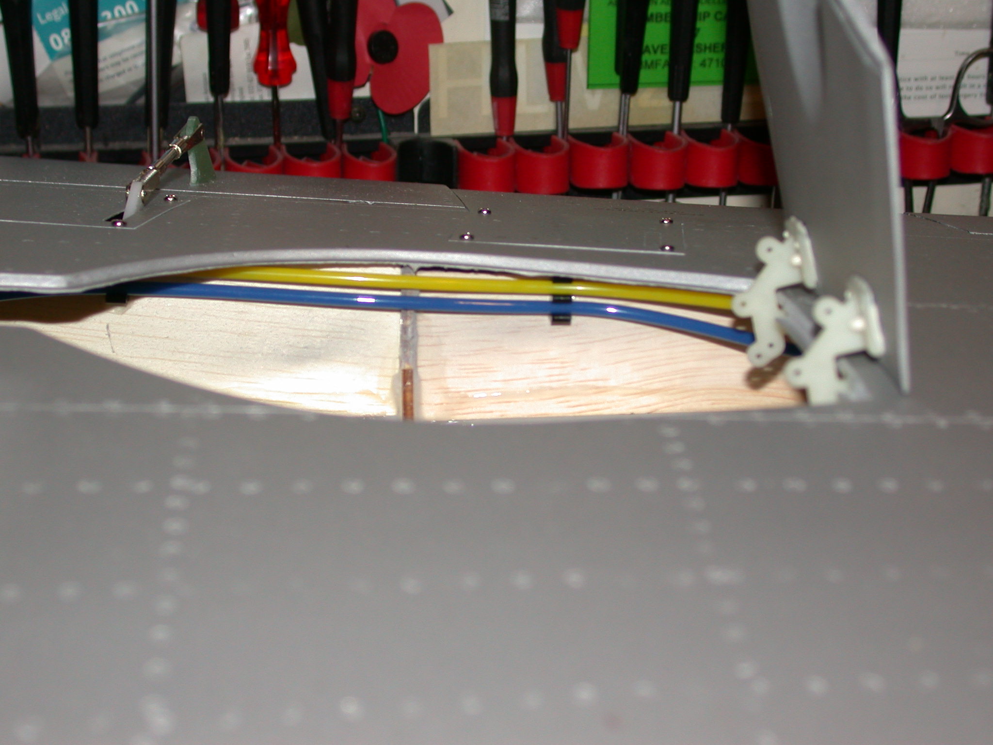

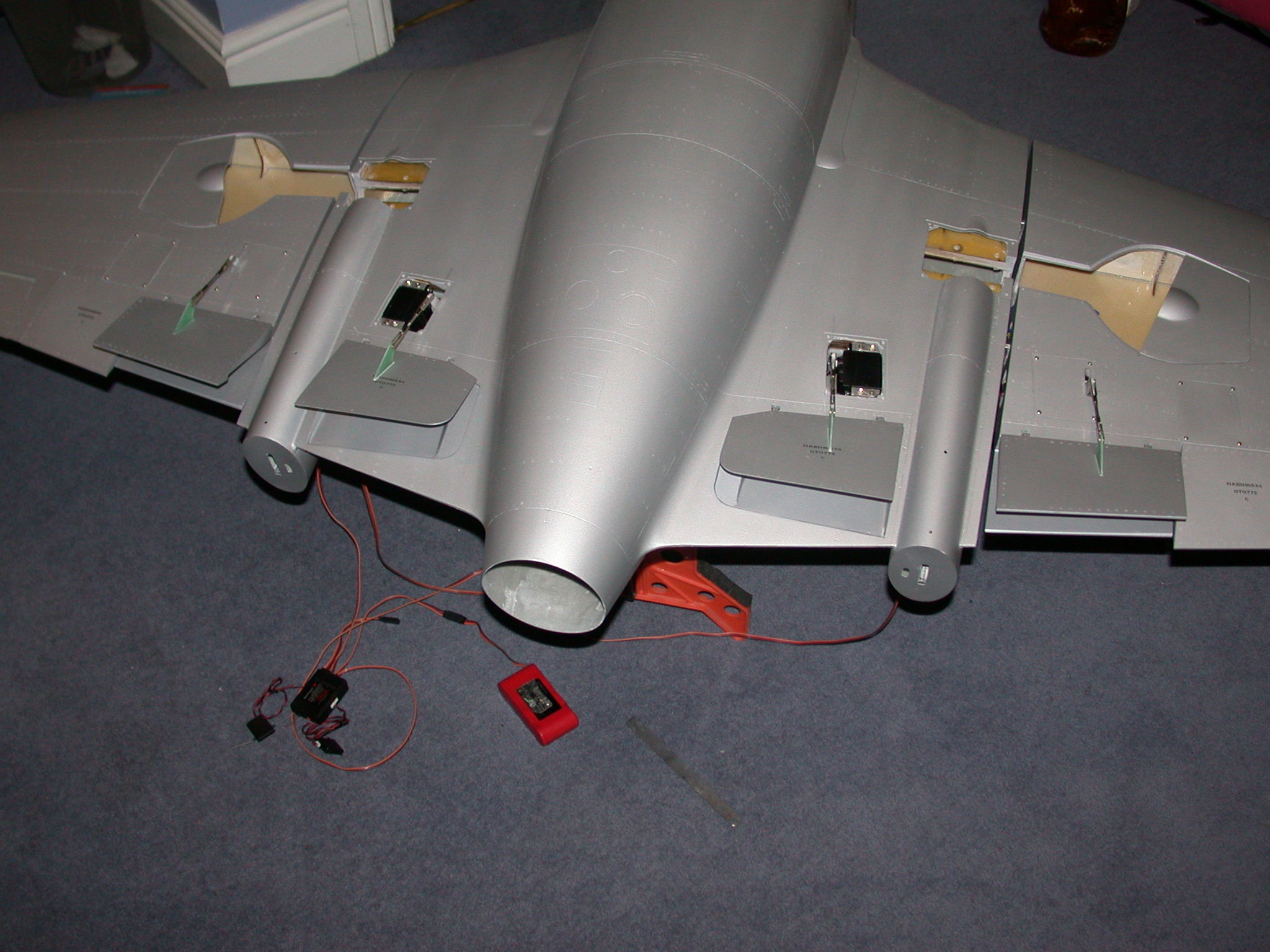

Wings now finished except painting control horns and making air connections.
Air lines clipped away with MAP airline clips. Blue line closes doors...blewup
Dw
ID:	1571825   Click image for larger version
ID:	1571826   Click image for larger version

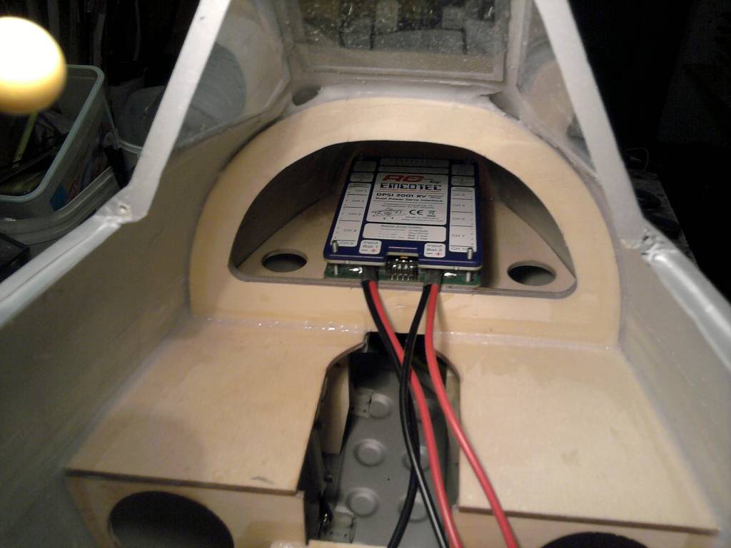

I Tried to install emcotec in the nose...
very nice installation ...but....
i must to elevate the position of EMCOTEC due to gear air cilinder nipple..very close ...then is impossible to extract EMCOTEC after
then i change the position to the rear of the cockpit [][][][]

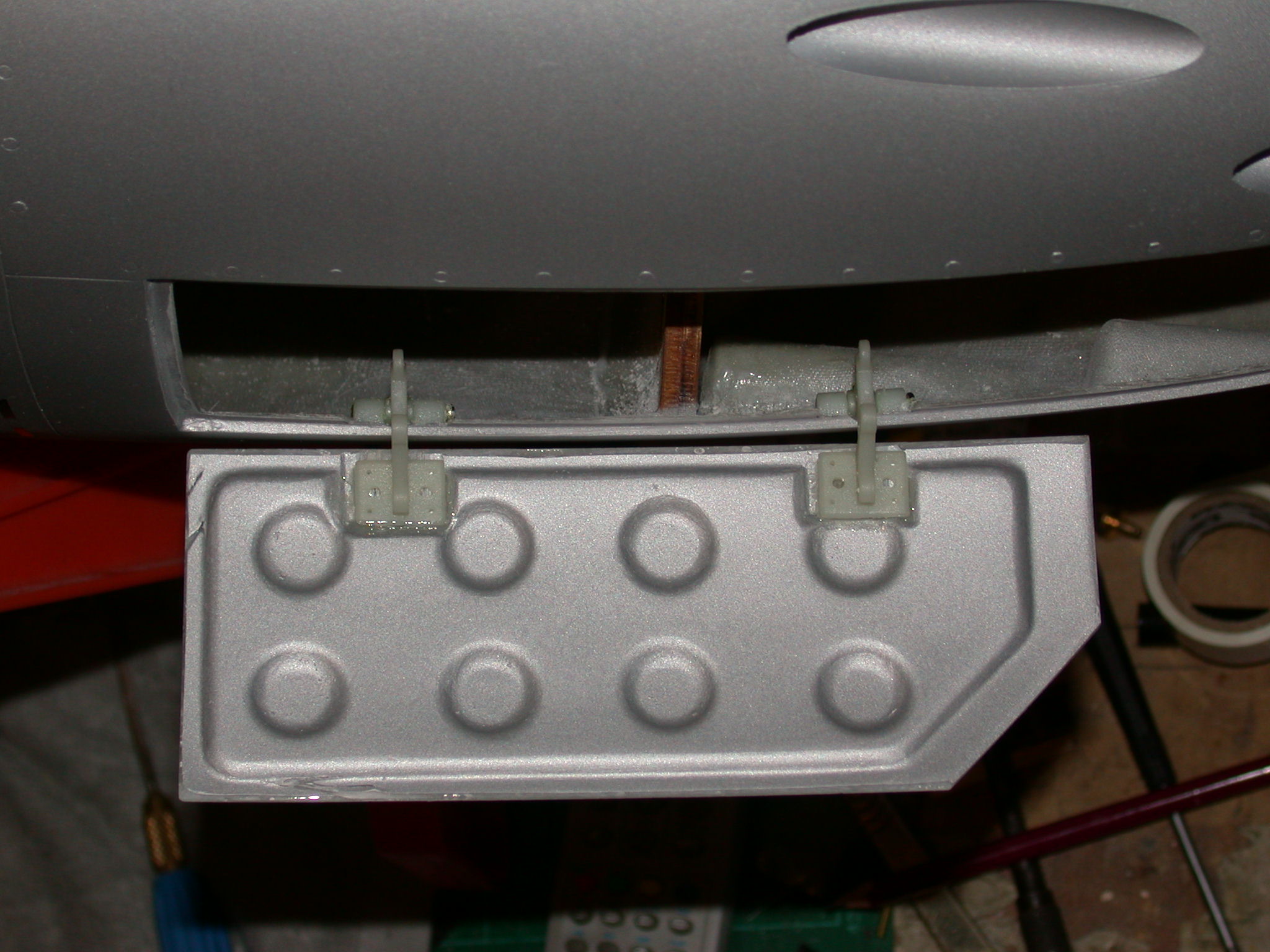

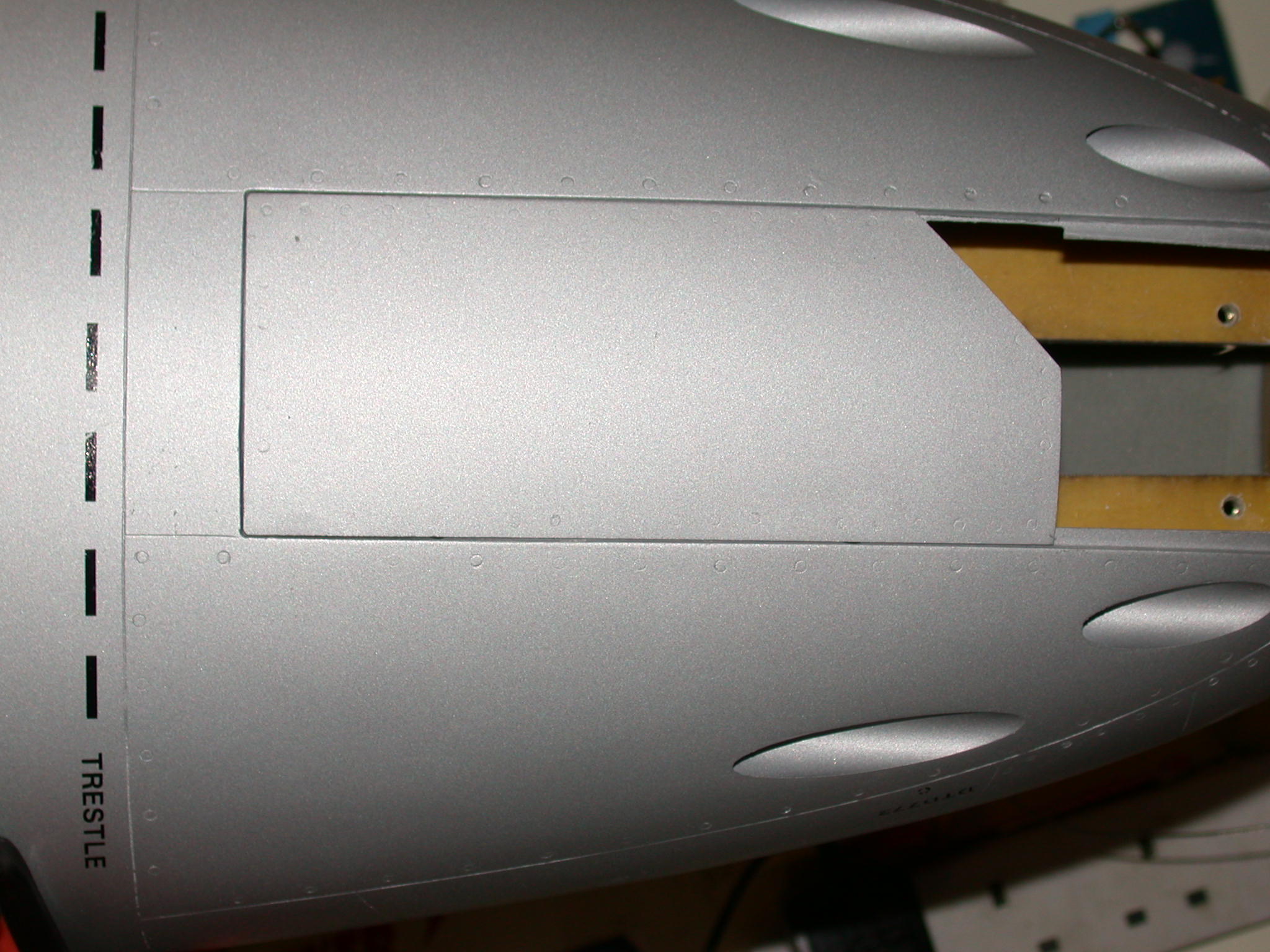

Finally got the fuselage in the workshop tonight. Quality is really very good, with nice joints, additional bracing and fit.
Fuselage flaps need to go in before anything else can be completed.
Dw
ID:	1572733   Click image for larger version
ID:	1572734   Click image for larger version
ID:	1572735   Click image for larger version
ID:	1572736   Click image for larger version

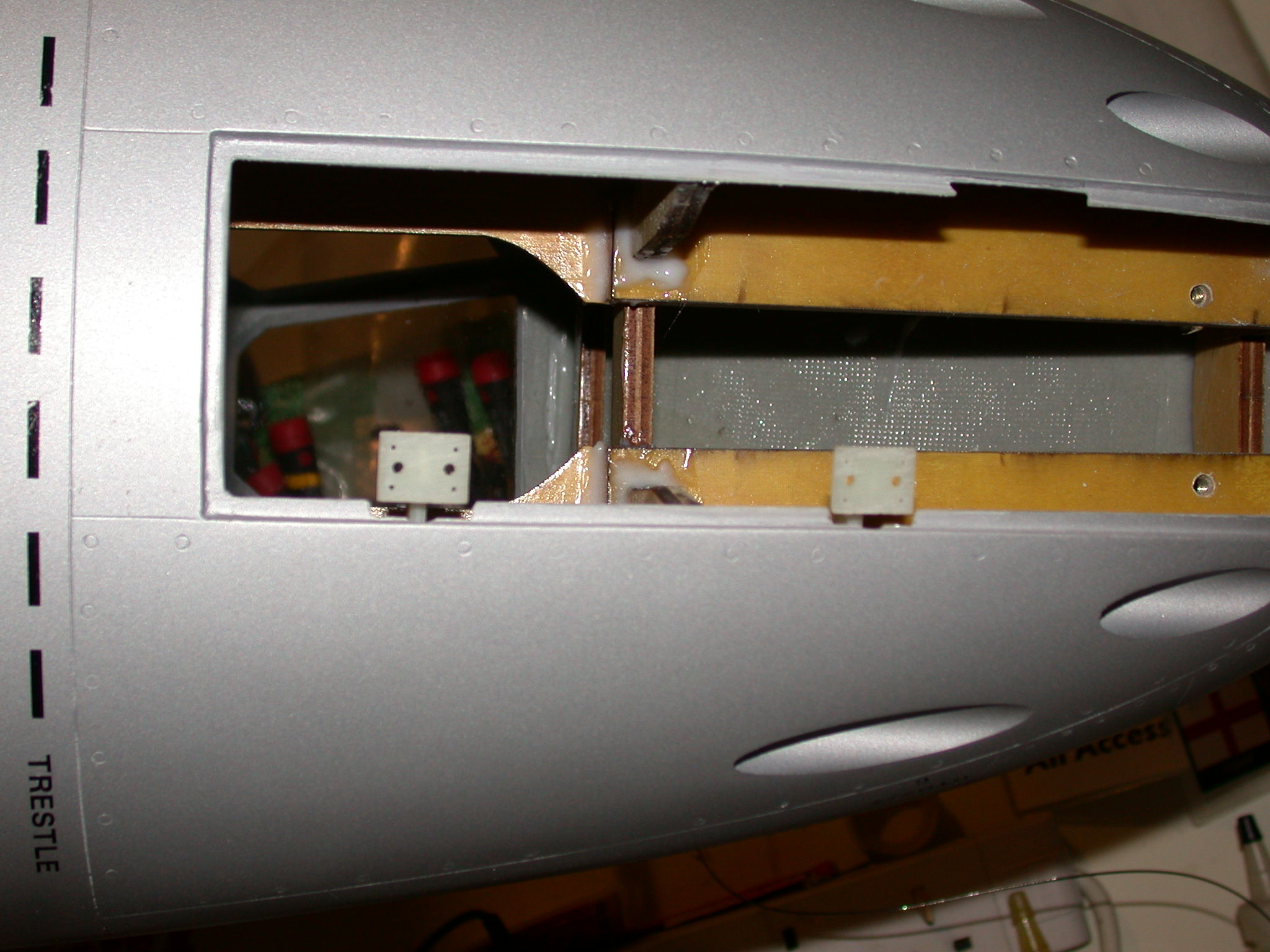

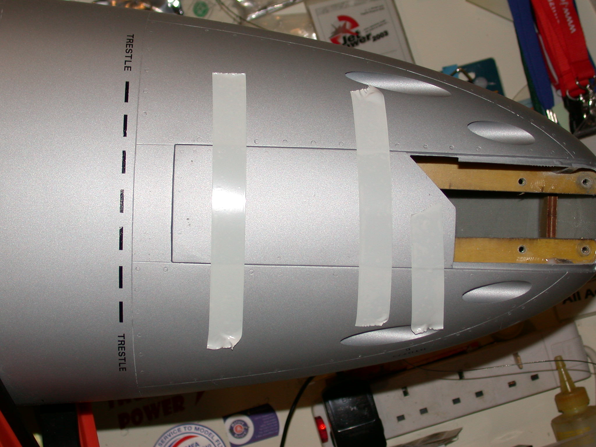

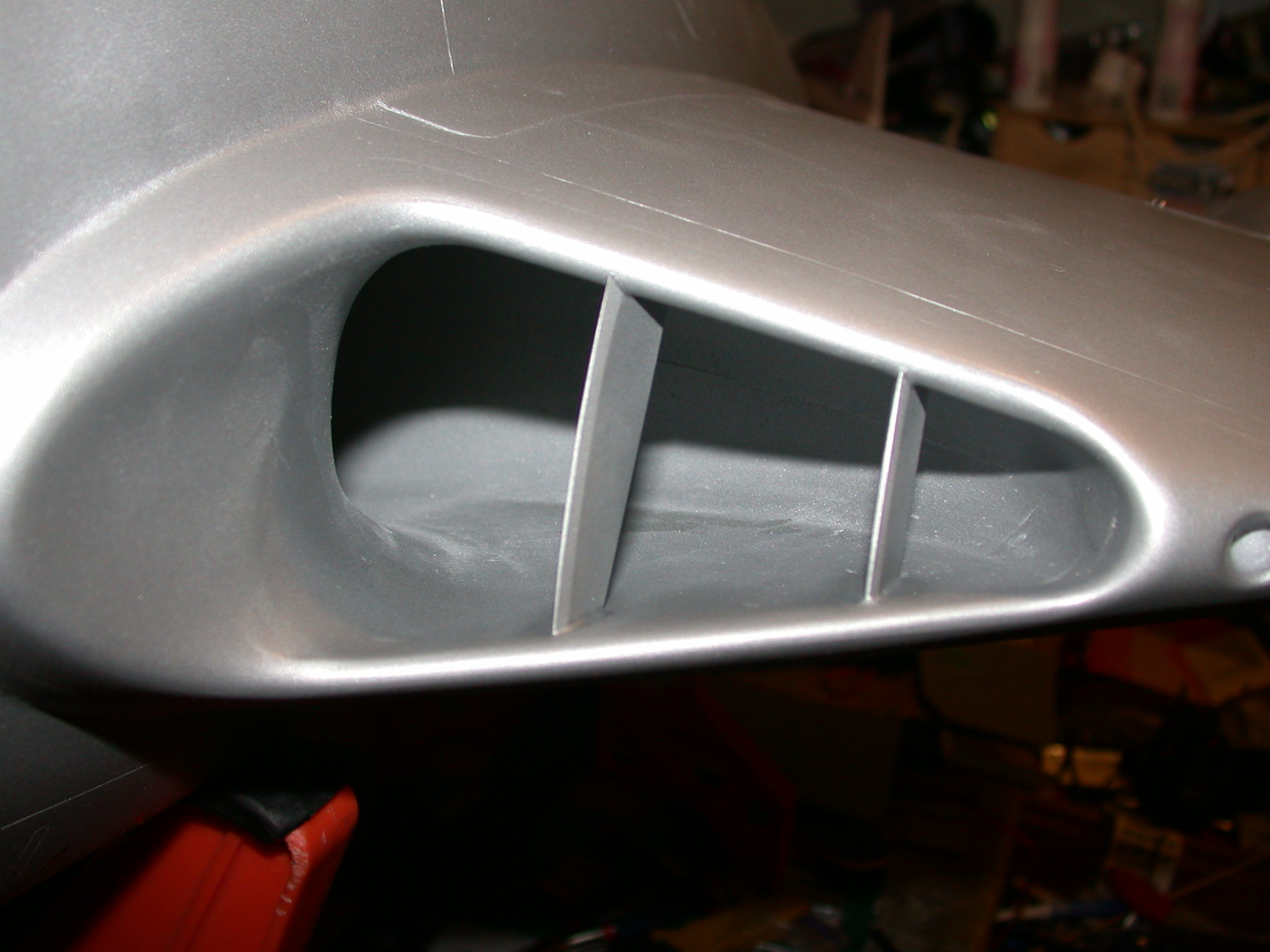

Been working on the Vampire between flying and family stuff. Tried posting pixs several times[:@]
So words first, then I'll try pixs
Openings for air and servo leads. The Fuselage flaps have no detail inside, so added some rivet detail (non scale positions)
Also finished setting up the radio-I always do the major programming during the build, then I know what servo will connect to which PB or Rx channel. I spend time matching servo centering, but did not expect to get away with 2 flap channels...as I have! I was going to use a matchbox, but I have near perfect set up, take-off and landing postions on all four flaps, using just two channels-2+2 servos.
Dw

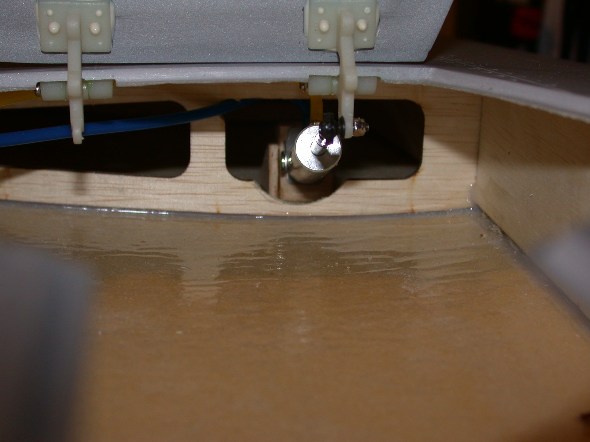

Nose gear door.
keep the hinges on the edge of the door, so that as it openings it moves clear of the curved fuselage.
I chamfered the door edge to give clearance over the reasonably deep recess.
Dw
