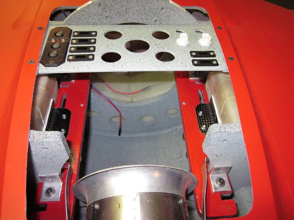

Turbine install. In a stupid moment I forgot to install the filter, hence the slightly odd position. Just the tank filler position to decide, batteries and ballast. I then need to mount leg doors and sort cockpit set up.
Then it's out with the pencil and crayons!!

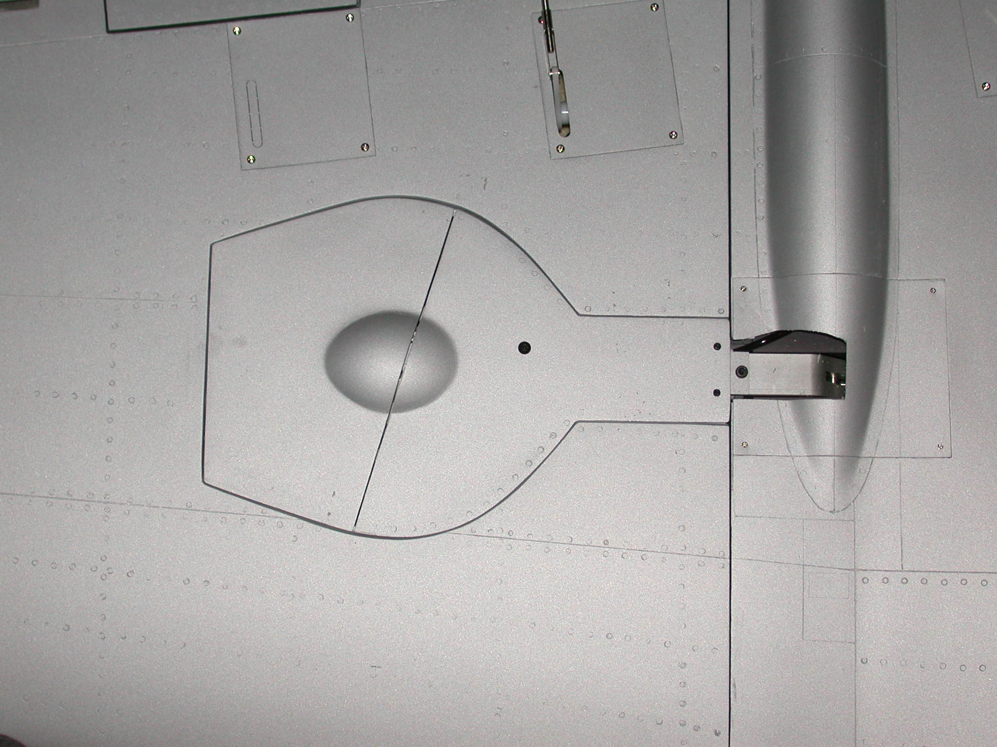

Maybe tomorrow, if I get the last jobs done. I fitted the leg doors 1.00am this morning, I need to balance, add something important I forgot! and start fully checking systems. I have several other jets to finish prep on before tomorrows Jet Meeting...and work!
Dave

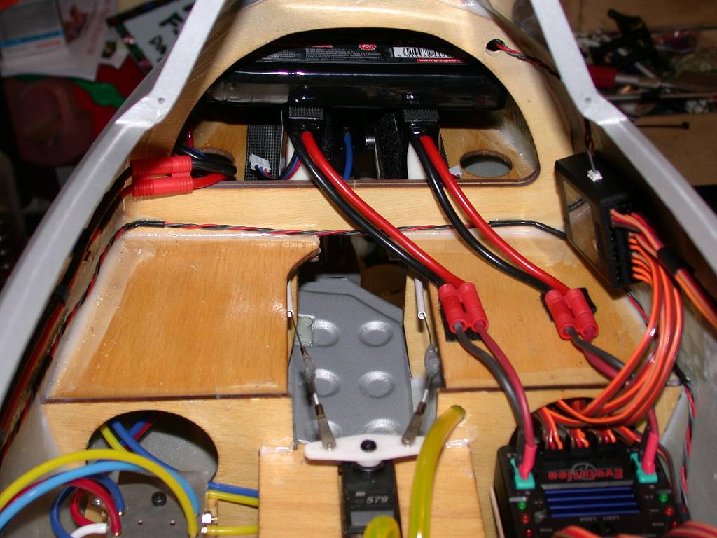

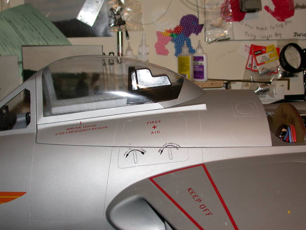

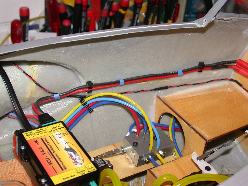

Nothing I like more than a late finish Thanks mainly to my friends
So, ran the turbine at the office yesterday, perfect as expected with a P-120SX.
Fuel levels shown after the run. Fitted the PB sensor switch unit in the engine bay.
Been working on the cockpit fit tonight, still not 100% happy, but a second set of hooks have improved it. Just gluing in 1020 grams of lead in the nose then bed!
DW

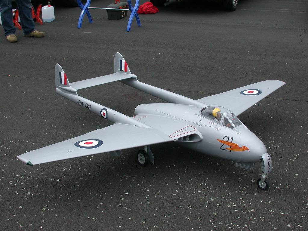

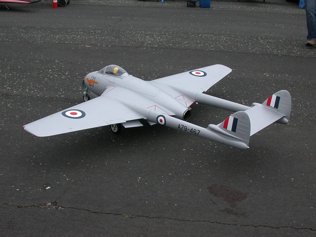

Like most new models, as I finished the install, there were a couple of things I would change next time! Thank you anyway.

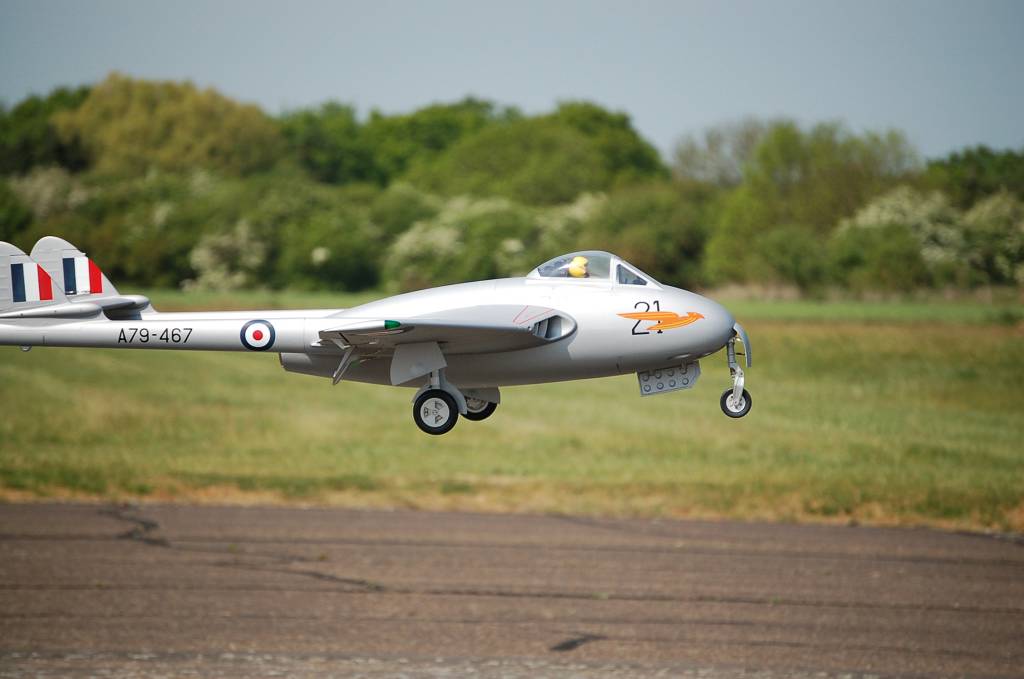

So, the Vampire has flown!
Last night...this morning! I found a small problem, all the testing I did on the gear, I was pumping to around 60-70PSI which functions the gear fine. I knew that for flight and with the doors more pressure would be needed. So last night I started using 95-110psi to fully pressure test things. At these pressures, occasionally one leg would stick up. The extra pressure meant the leg door was hard against the shut in the wing and like this the leg would not release. A light press "in" would allow the cylinder to release and the leg would come down. So..I added 0.4mm ply packers under the leg door mount and the operation seemed reliable...but I had a thing in the back of my mind.
Balance was achieved with 1120 grams lead in the nose. I balanced it on the wood former, UAT full, some fuel in the main tanks.
My movements and expo suited my flying needs perfect, so will assemble and measure/note in a while.
Take-off roll was 100m on tarmac without flap ( I will now use some flap as the ground speed was higher than I expected on rotation ) Rock solid feel, few peeps of aileron trim and it was perfect. Rolls are axial with my aileron set up ( will measure) and as expected power with the P-120SX meant most of the flight was with the throttle at 1/3-1/2 stick position. I did one full power loop which was 600' (200m) dia and you can throttle back at 3 oclock. We had a 8 knot cross wind today and again as expected the Vampire fish-tails slightly with the big pod and small boom/fins. Nothing nasty though. Flap test showed no pitch with no down elevator on TO flap, and 3% down on landing (I like a slight nose down sit on full flap)
Flight time was set for 9 minutes, but I expect 11-12 with my power settings. So at 9 minutes I hit the gear switch, the sticky main leg had stuck again [:@] Great! Several fast rolls, and rebound rolls were tried to release the leg but nope []
So I cleaned up and made a grass landing. Obviously I touched the leg and it popped down [>:] Luckily no damage and I have the vampire back in the workshop to re work the gear door (like I should have before I flew her! Lesson 1!!)
Hope to fly again on Sunday
Dave

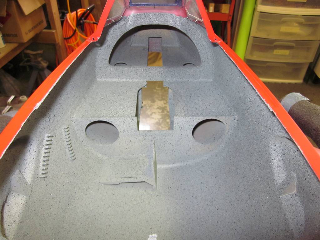

Congratulations Dave on your flight.

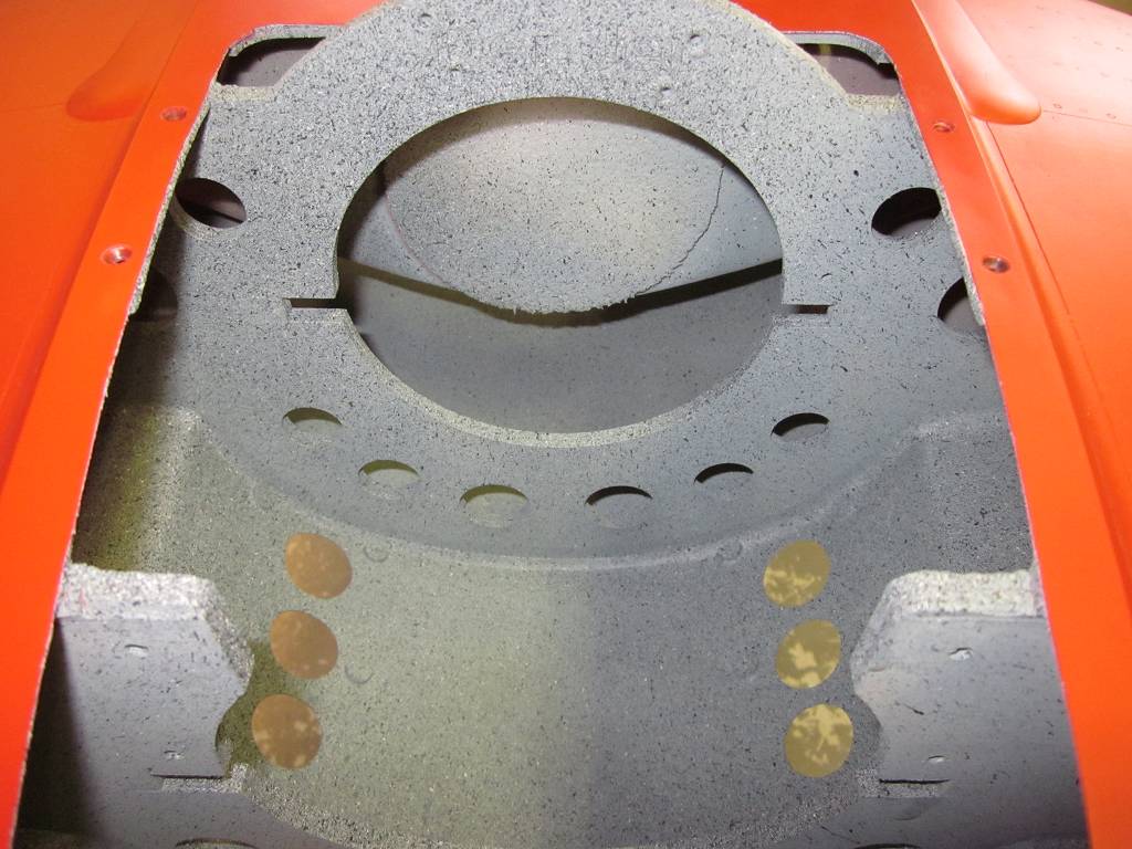

Work is still coming along on Eric's plane.
I got the inside painted today and started to figure out how we are going to run all the wiring and plumbing.
Below are a few Photos.

Had a great day flying the Vampire, really windy and gusty/thermal wind at that, but it copes well. My only thought after today is to add a gyro the the rudders, it needs it as I expected, with such a big pod and small booms/fins. I'll add a JR 420T soon.
Only made two flights as the conditions didn't make it "fun", though the two flights showed me what a good design DerJet have. Mine is complete with whistle, just like Goblin exhibits!
Gear is perfect now after packing the main unit 1/16". Everything on the model works perfectly, with the throttled back P-120SX I was flying 12 minutes with LOADS of fuel left!! It is over powered, 20-25lb would be perfect. Airbrakes just add drag, I used take-off flap on both flights today and it floats off perfectly, at TO flap still no elevator compensation and landing flap 3% down. It retains energy well, loads going down hill, I used the airbrakes on the back side of BIG loops to control speed. Really really like it!
My son William was cameraman today and I told him to take lots of shots...he took hundreds! These are some
