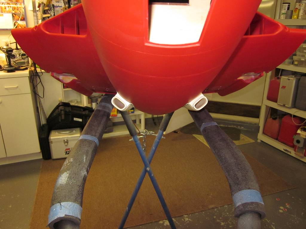

Question for you guys that are familar with Vampires, where is the landing light(s) on a Vampire? Putting lights in mine and can''t find a picture of a full scale showing a landing light.
Note, the tip lenses are not colored, just painted from the inside, removed paint with rubbing alcohol so I have clear lenses.

Old 03-25-2011 | 03:12 PM
  #127
Joined: Jun 2002
Posts: 13,258
Received 788 Likes on 571 Posts
From: Watford, UNITED KINGDOM
Default RE: DerJet DH Vampire build thread-
Jim
Didn't think it had one!
Dave
Old 03-25-2011 | 03:17 PM
  #128
Posts: 289
From: Mount Washington, KY OH
Well that just stinks, guess Vampires don't fly at night.

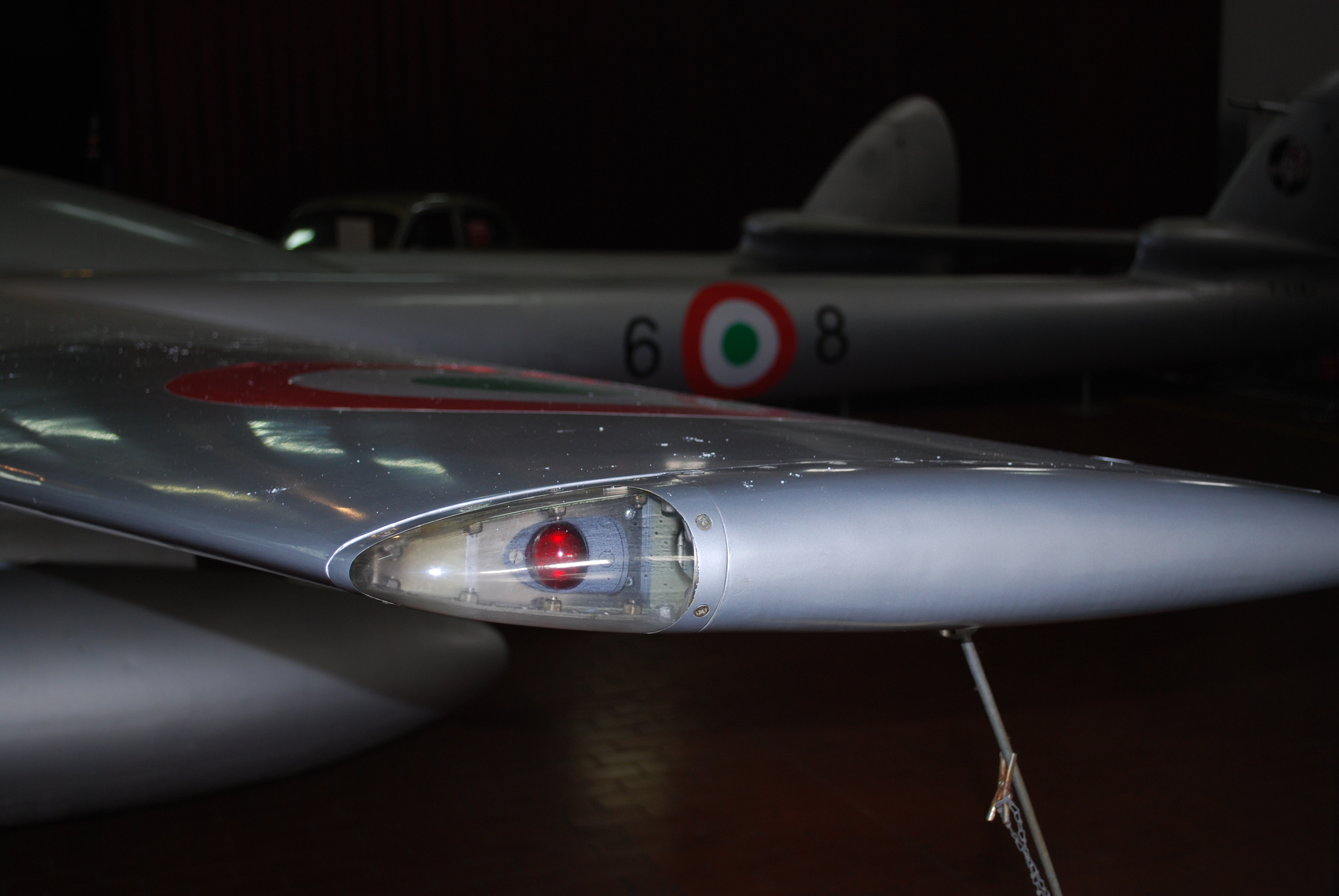

Hi Jim
The Landing light on my Vampire T11 is on the underside of the port wing and sits flush with the underside and then rotates down into the airflow when needed...I assume the single seater was the same but am not 100% on that I'll check my reference material...hope this is of help
Regards

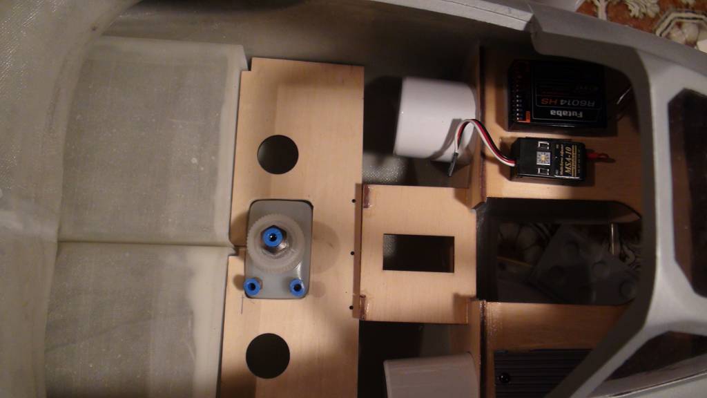

Old 03-29-2011 | 04:11 AM
  #133
Joined: Mar 2004
Posts: 1,567
From: ferrara, ITALY

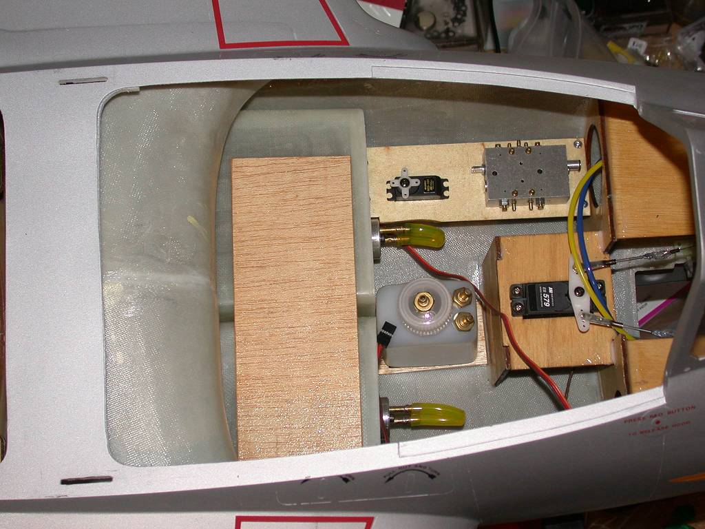

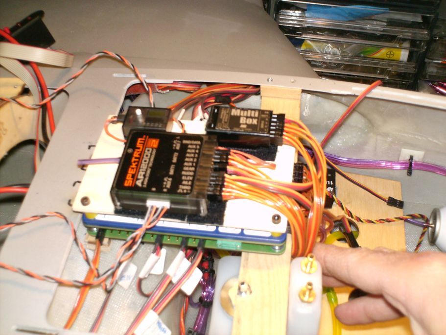

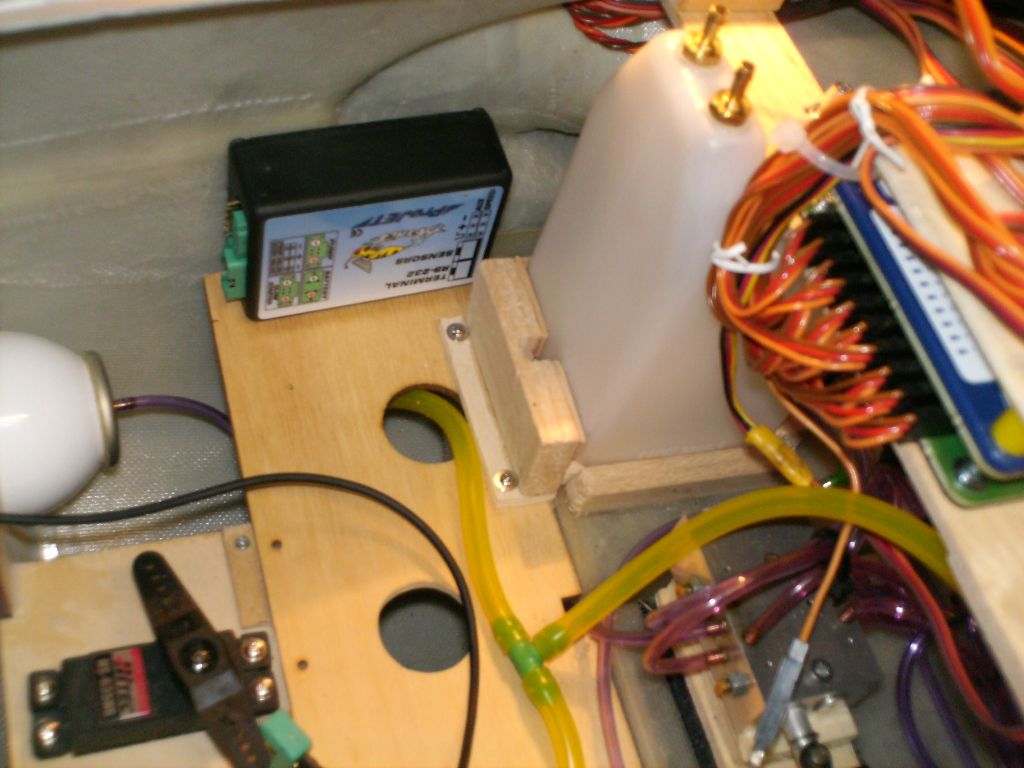

work progress
1- i changed the 2 original air valves due air lack with new Airpower double output valve
2- i changed the nose door cylinder with 19mm travel with a new one with 25mm travel due too close distance between wheel and panel during retraction
3- finally i fit the rx and accesories

ORIGINAL: Jetmodeler
Jim

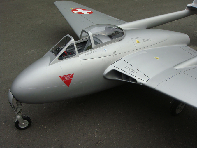

Sneek pictures of scheme No 3! Fabulous...
Dw

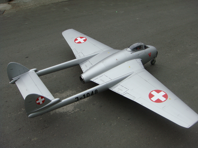

Joined: Jun 2003
Posts: 64
From: Uznach, SWITZERLAND
ORIGINAL: Dave Wilshere
Dw
As a Swiss I really like this scheme. However, I do not understand, why so many people have troubles to find the right size of the white cross in our national emblem...
Cf. http://www.flugzeugbilder.de/show.php?id=1011776

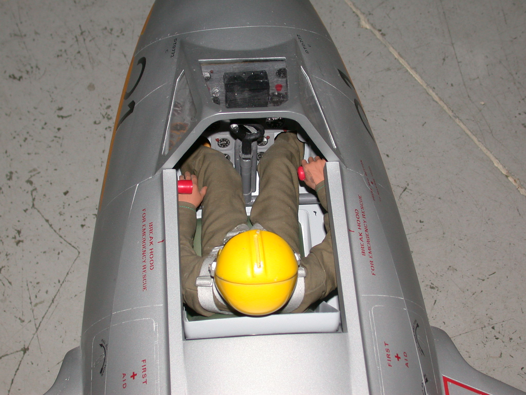

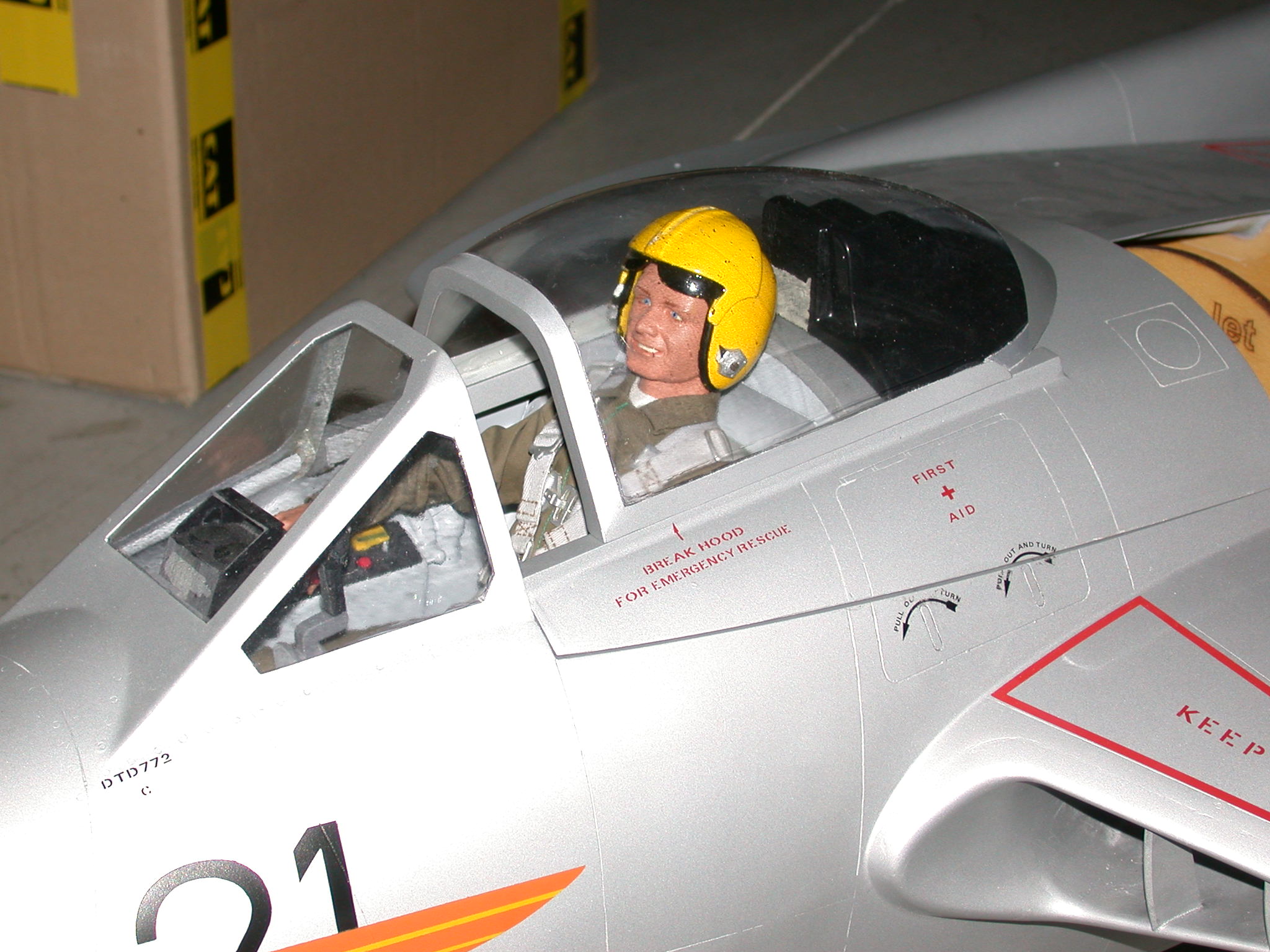

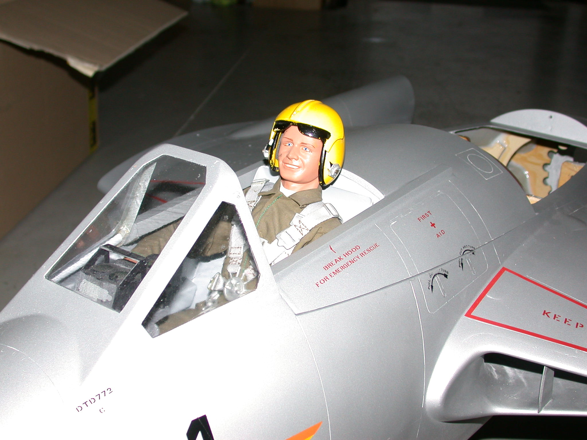

Can anyone advise which brand of pilot Jim has in his model please?
Looks spot-on
Gregg
Old 03-30-2011 | 08:30 PM
  #142
Posts: 289
Picked up my pilot off ebay, its an 1/6 Elite Force WWII RAF Flight Lieutenant Donald Moore, also known as Blue Box Toys. They also had a WWII RAF pilot in blue uniform that would look good in a Vampire. Only problem with my pilot is he has short pants so he's showing off his knobby knees. Found Elite Force pilots on both ebay and Amazon.com, just had to do some looking to find them as I don't believe either is still in production. Have some nice options in the box with these pilots to make them look right.
Jim

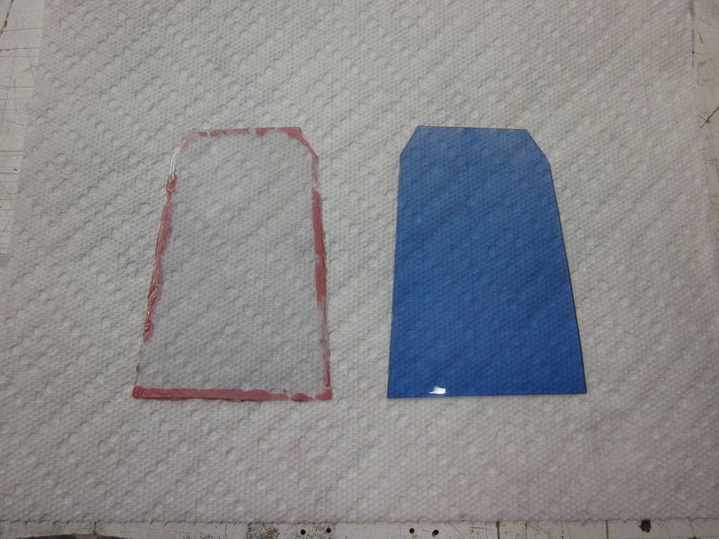

Finally got started on Eric Clapp's Vampire.
This is the all red one I posted photos of a while back.
This Vampire flew with the Royal Australian Air Force. This was a special scheme worn by Squadron Leader C.F. Favish's Vampire FB.31 of 25 Squadron in the late 1950s.
Australian Vampires were fitted with auxiliary "Elephant Ear" intakes on the lower fuselage. This is what we started on today. Also Eric did all teh little stuff on the gear to get them ready to install.
Below are a few photos of the days work. Also Eric says the front wind screen was blue tinted so I made him one blue tinted.

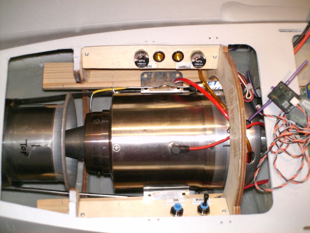

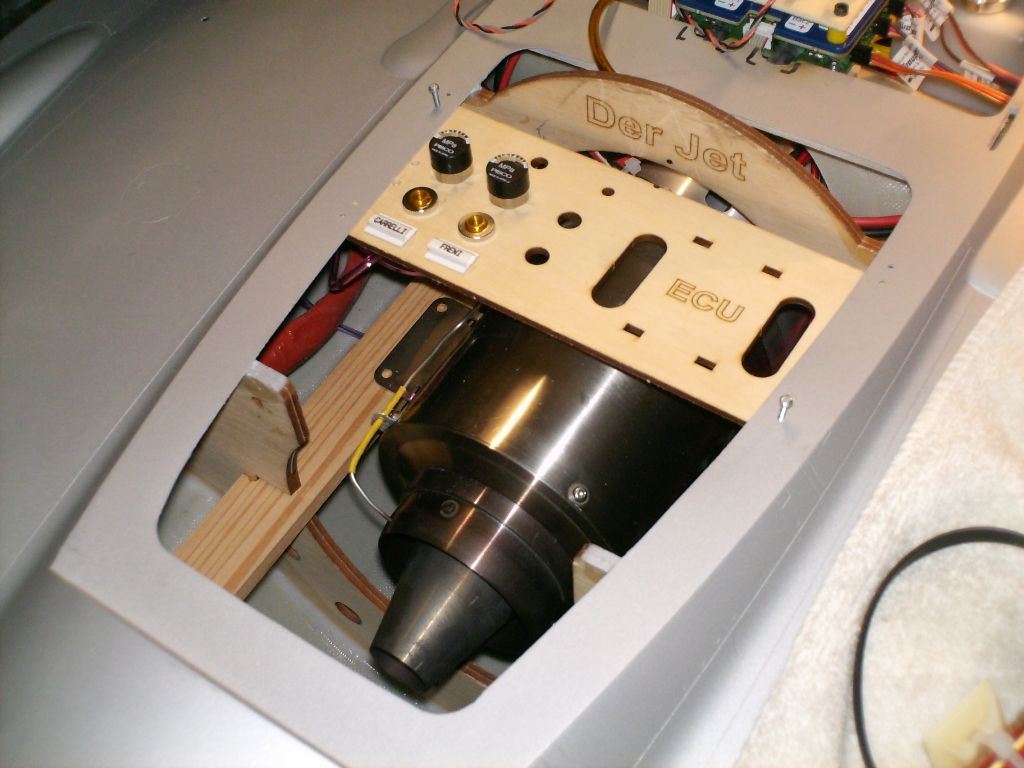

After re-balancing and testing engine (88N reached) i trying to locate turbine ecu, pump and
accessories

i changed the turbine bay layout to give best access to engine

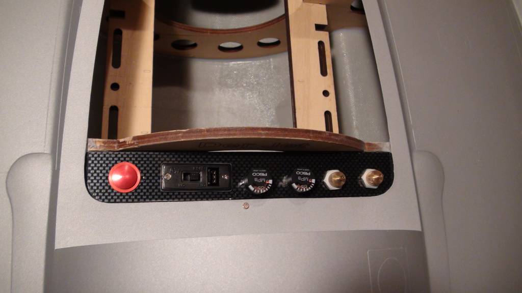

Hi All
Some pics of my Vampire install.
Chuck

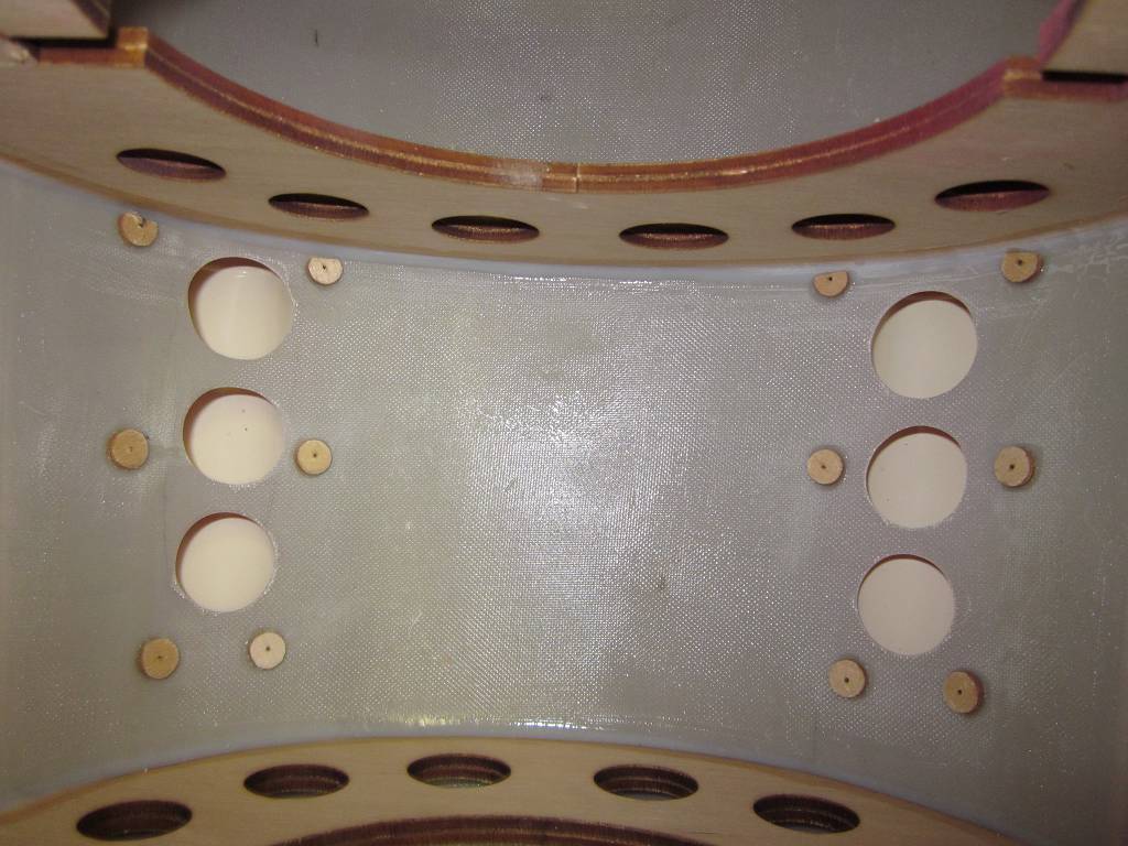

Slowly getting back to the Vampire after some family stuff.
Decided to put the main airtanks in the sub wing LE,, behind the inlets. (they are light so I want to space further forward for anything heavy) I'm using a UP3 valve and have an MAP hopper as shown. Wooden plate on top of tanks will take turbine valves, pump etc. Powerbox Evolution and Rx will be on the right hand side of this area
Dw
