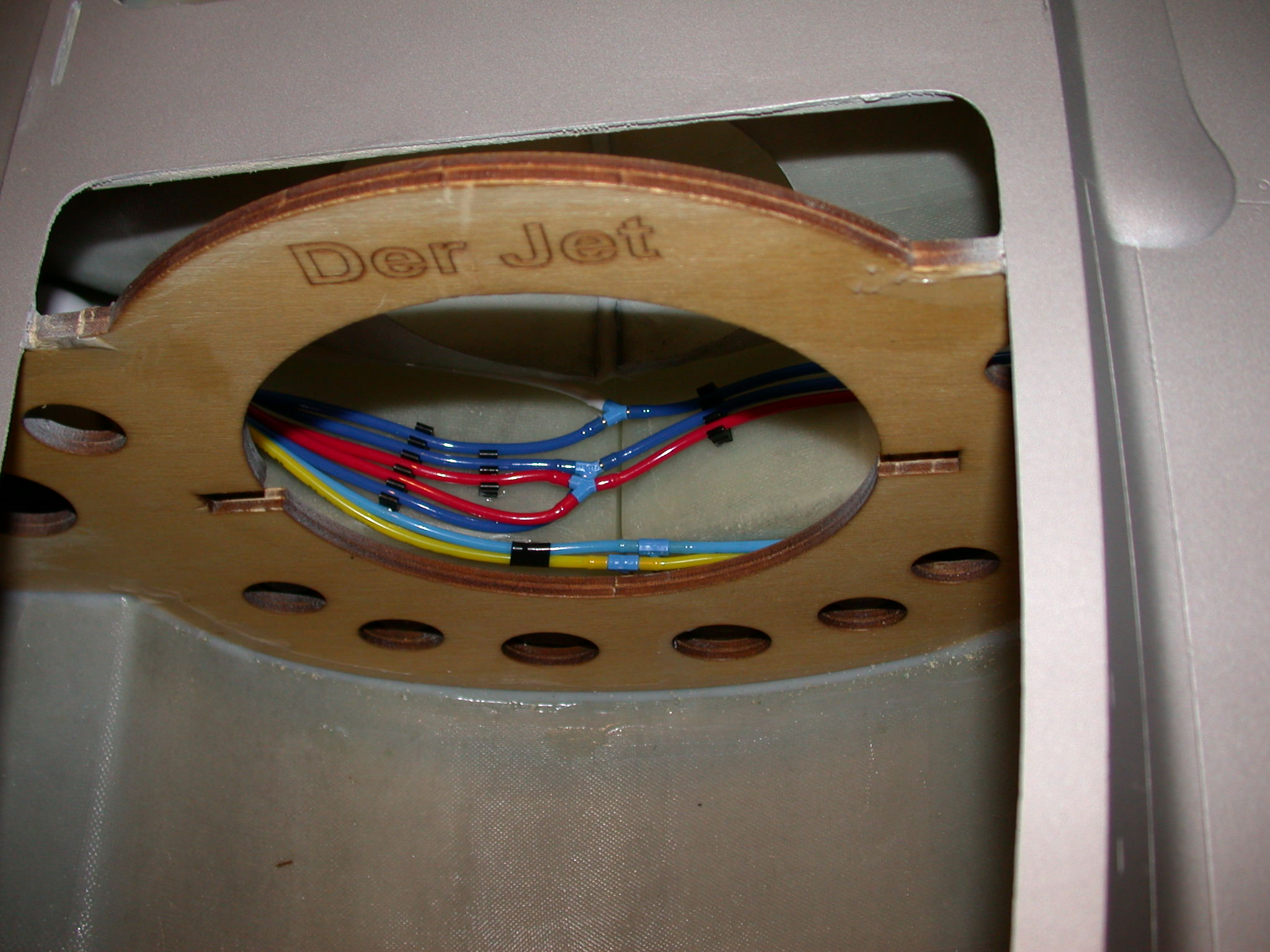

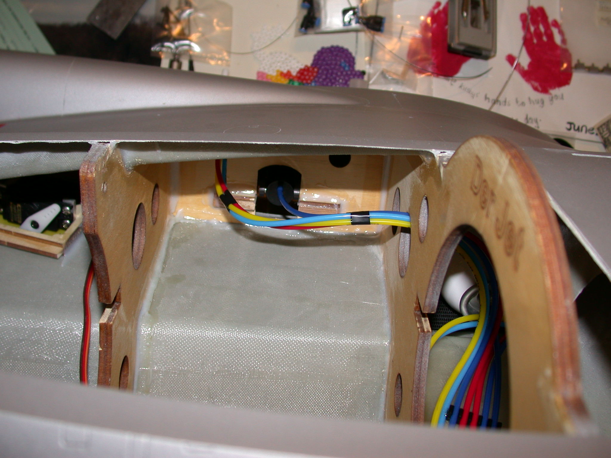

Cracking on. Need to sort out where the MAP filler tube will go and start working out airline routes.

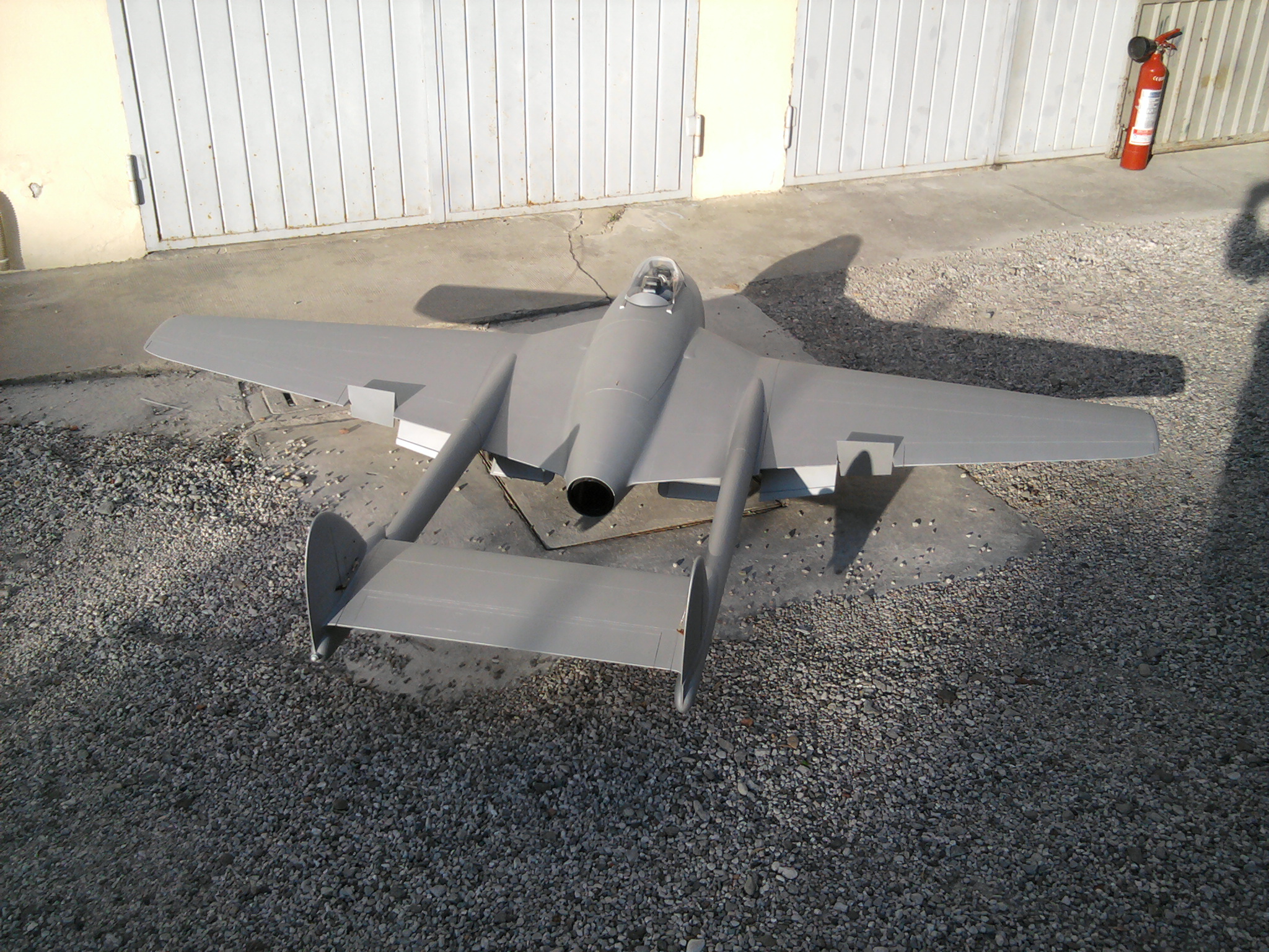

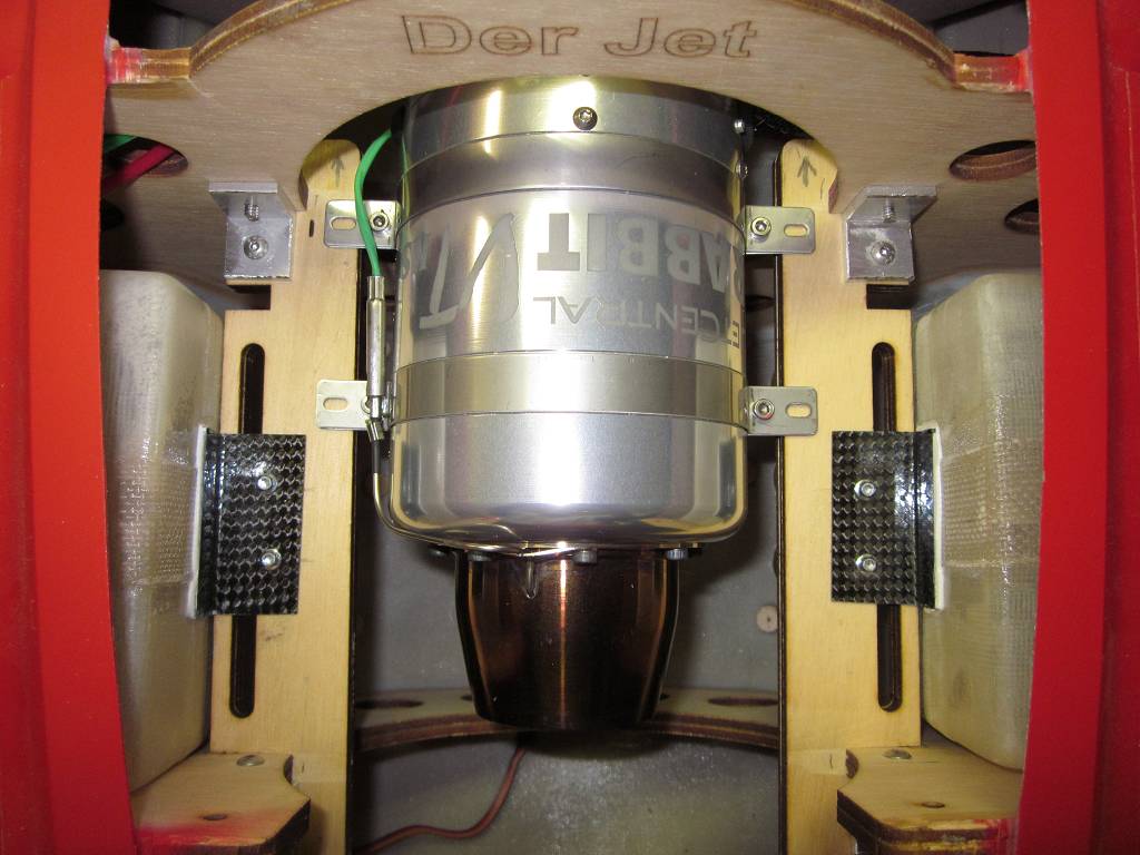

yesterday i worked on vampire...
turbine & accesories installed...
remain to fit the rx , ecu battery and nose ballast..

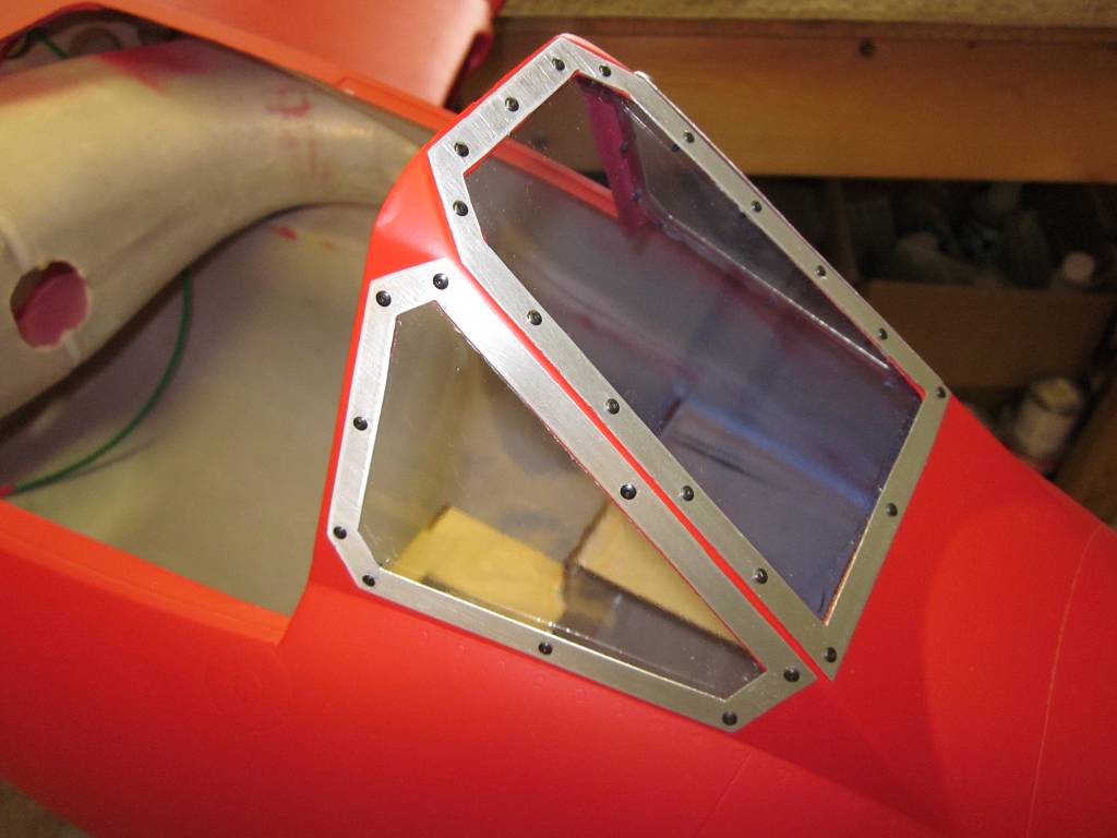

Here is something you won't see every day. Eric is working on a plane.
Please note he is still in his Bark-0-Lounger but he is working.
We have all the hinges done and servos installed now we are starting to add the extras.
As you can see Eric has installed the canopy frames and is drilling out for the Tail Light.
Below are a few photos from the last few days.

I finished my air install last night and have had the gear working for the first time. Wiring next!

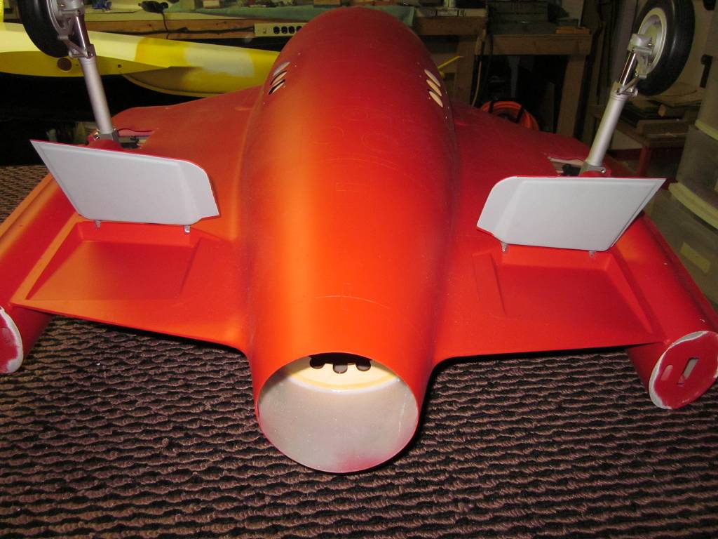

We got a little more done today.
Eric spent the day finishing the install of the running and landing lights.
I got he rudders installed and mounted the engine rails and mounts for the smoke tanks I made out of an old set of tanks I had around.
Here are a few photos.

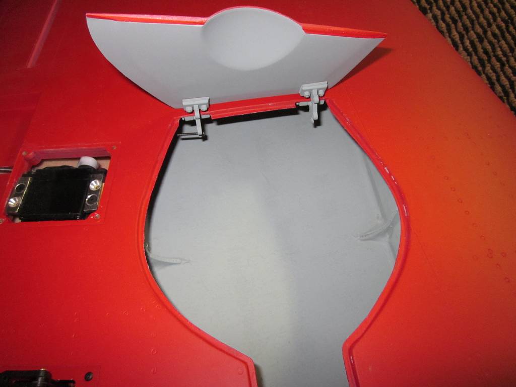

Old 04-18-2011 | 07:11 AM
  #158
Joined: Jun 2002
Posts: 13,258
Received 788 Likes on 571 Posts
From: Watford, UNITED KINGDOM
Default RE: DerJet DH Vampire build thread-

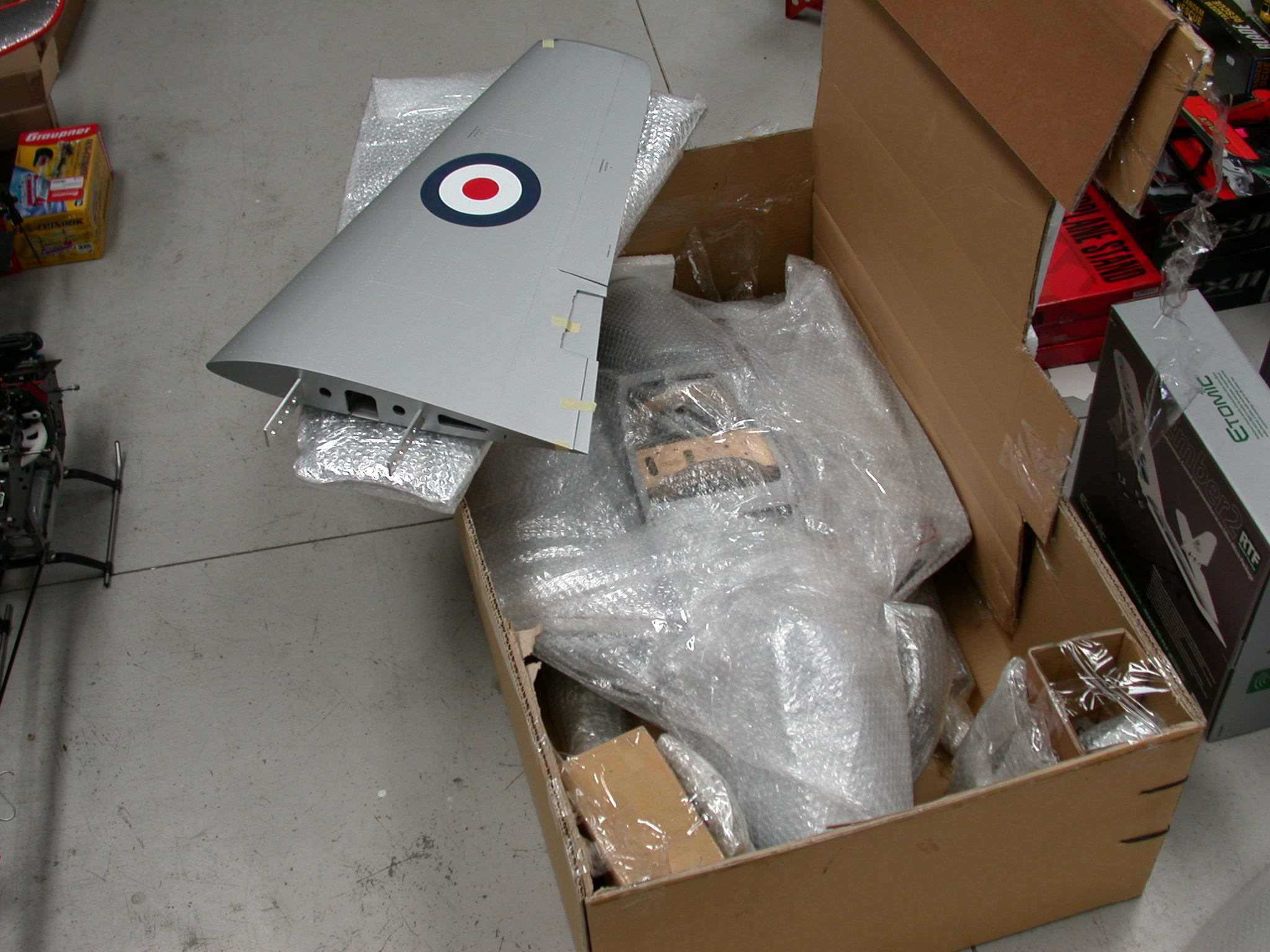

Another Vampire for a UK customer.
Dw
Old 04-18-2011 | 07:14 AM
  #159
Joined: Mar 2004
Posts: 1,567
From: ferrara, ITALY
saturday no maiden... due to turbine problem...
i must to change precharge bearing load... [:@][:@][:@]
then maiden flight next week..[][]

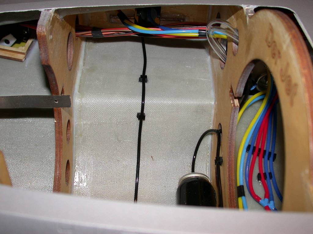

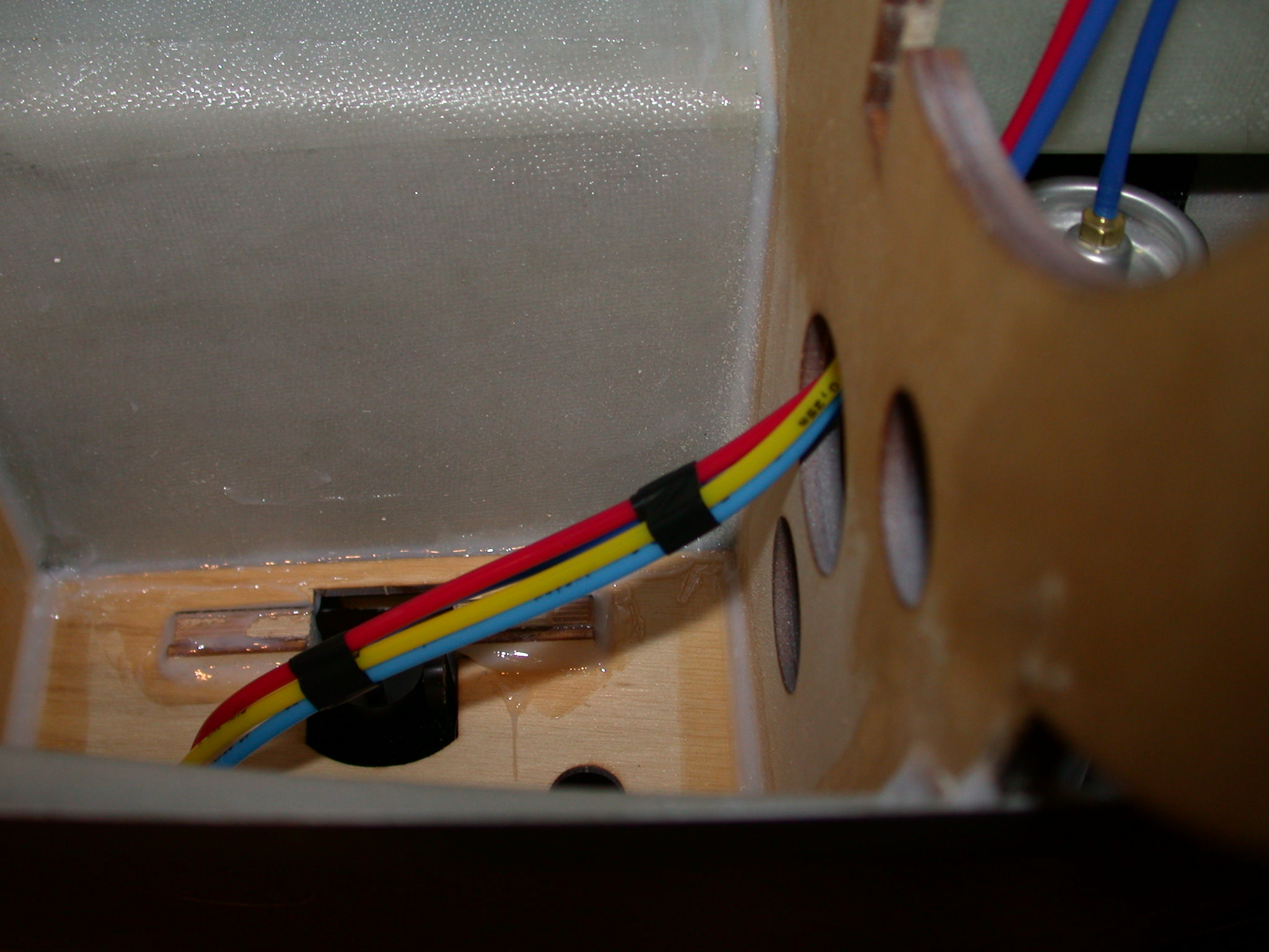

Down to the last part, radio is completely programmed, and fitted except Rx packs. Just need to install a turbine and fit the leg doors and we are ready.
Dw

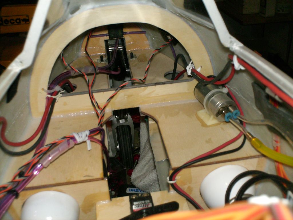

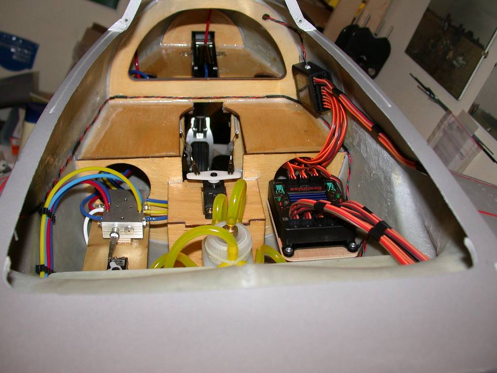

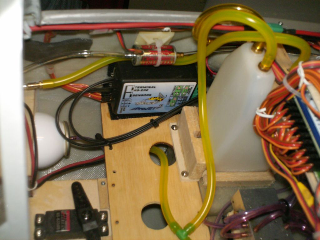

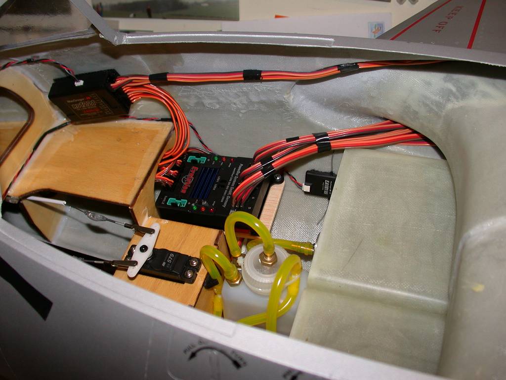

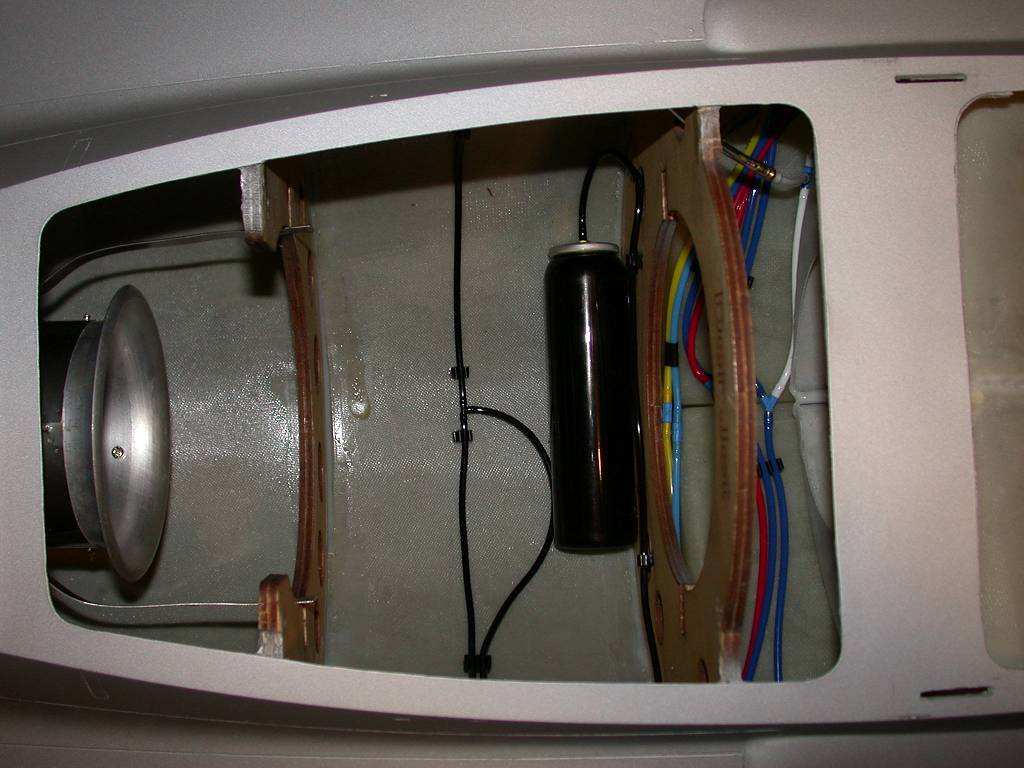

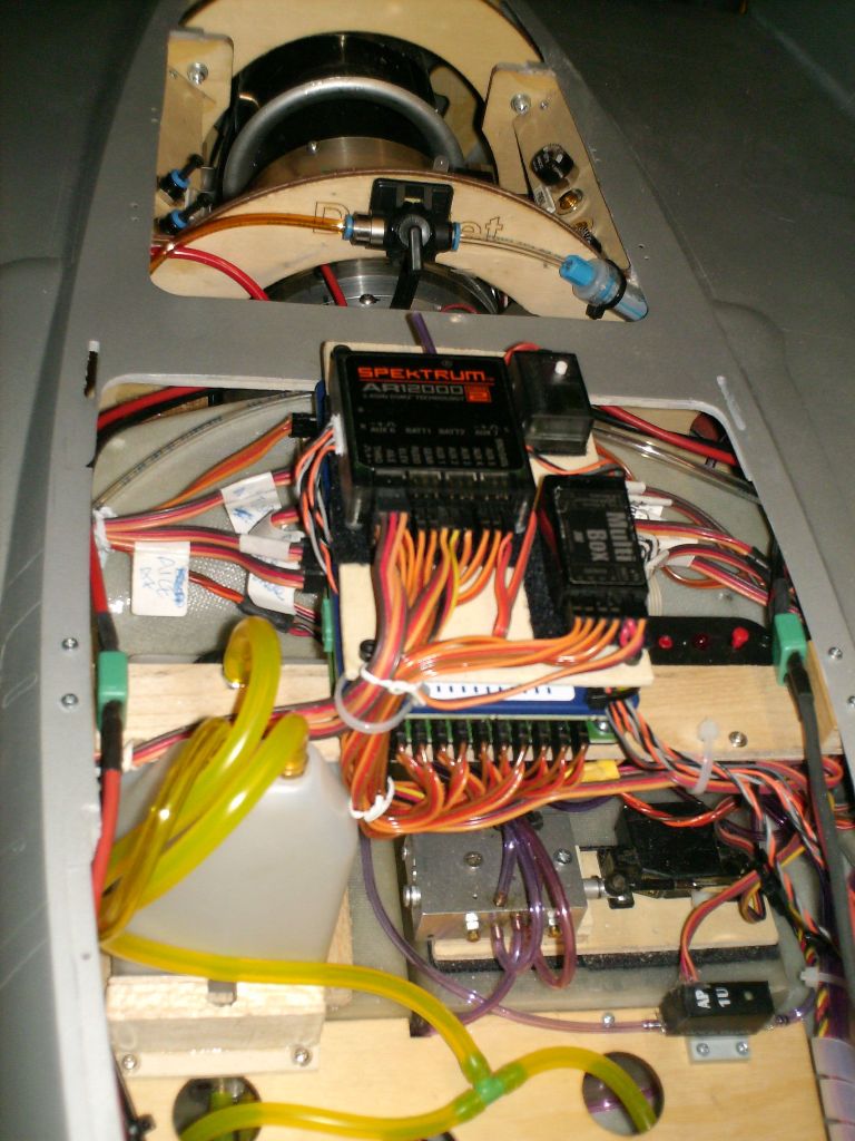

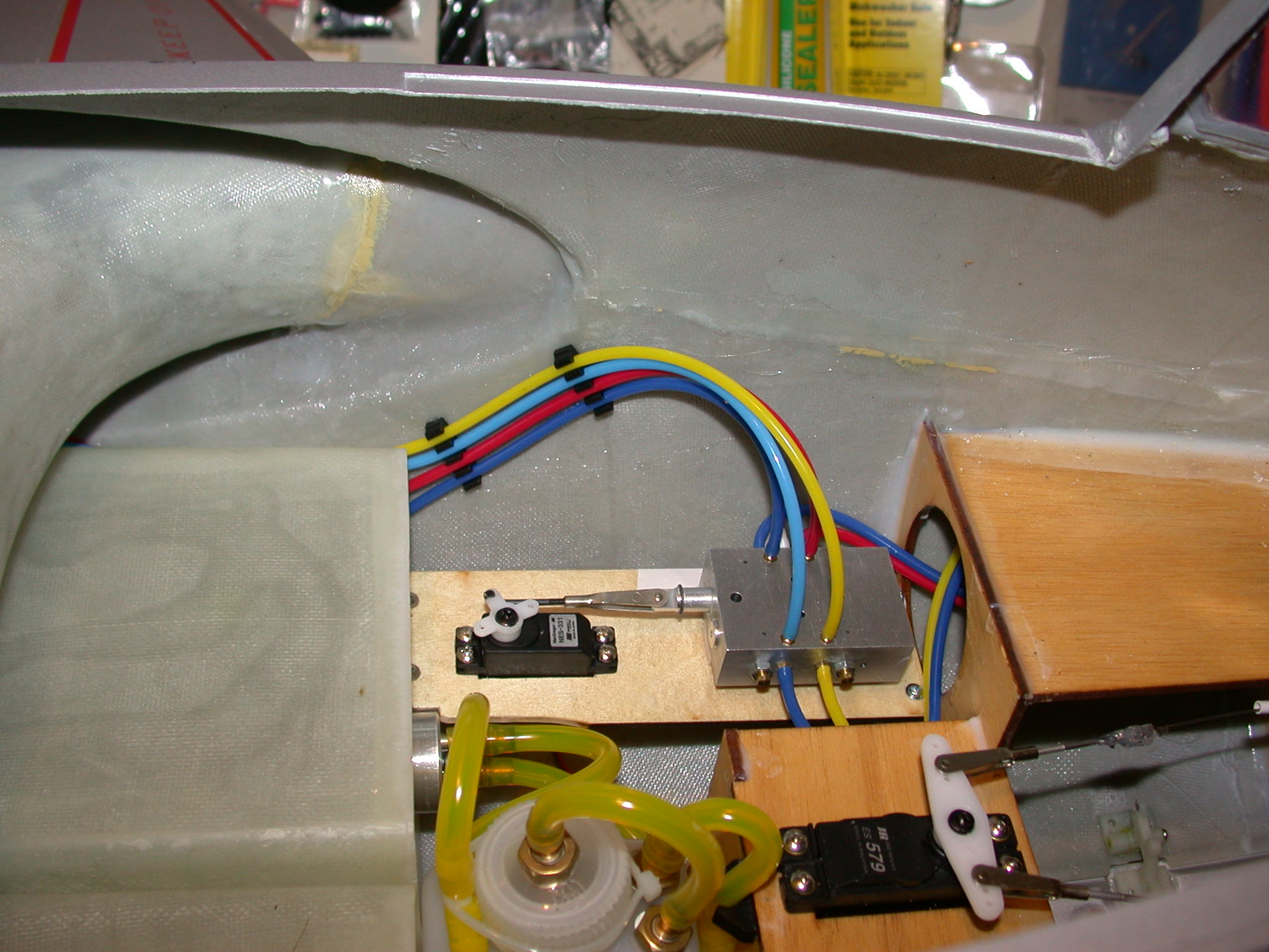

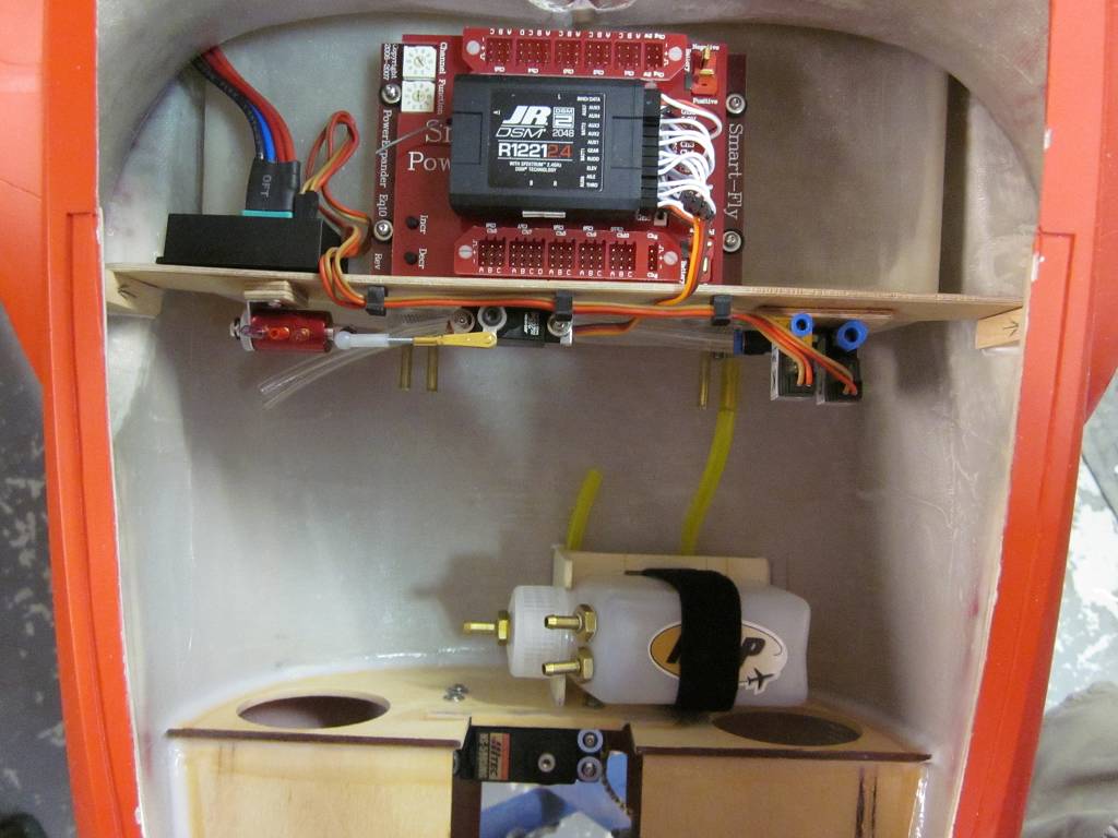

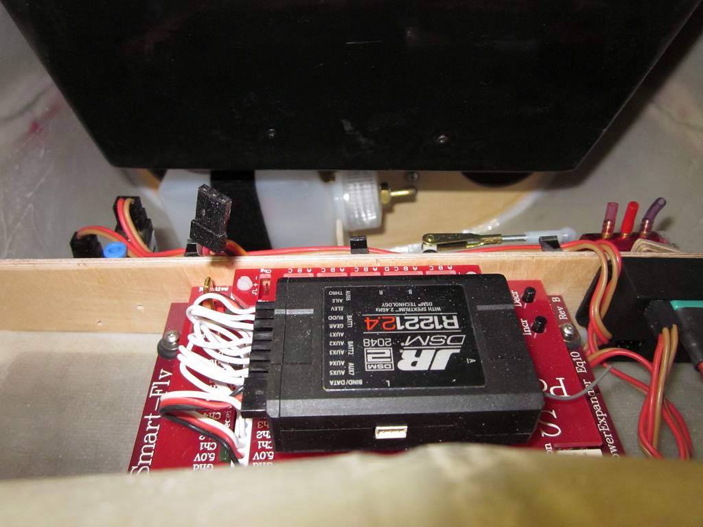

Work has continued on Eric's Plane. You can see in the photos below I removed the steering servo mount and moved the servo to the front side of the bulkhead.
This made for room to install the UAT up front and under the cockpit.
Since we will have a sliding Canopy I installed the air valve close so we can have short runs for air line to the canopy.
Also we are using a Smart Fly EQ10. I love these things. Its like having 10 matchboxes in your plane.
The wood the air valve and solenoids is mounted to serves as a stop for the tanks to keep them from sliding forward.
We have an EV5U mounted under the left side of the box under the cockpit and the Fuel pump and smoke pump will be mounted under the right.
I am trying to keep as much stuff in the nose of the plane as possible to reduce the nose weight we will need.
More to come soon.

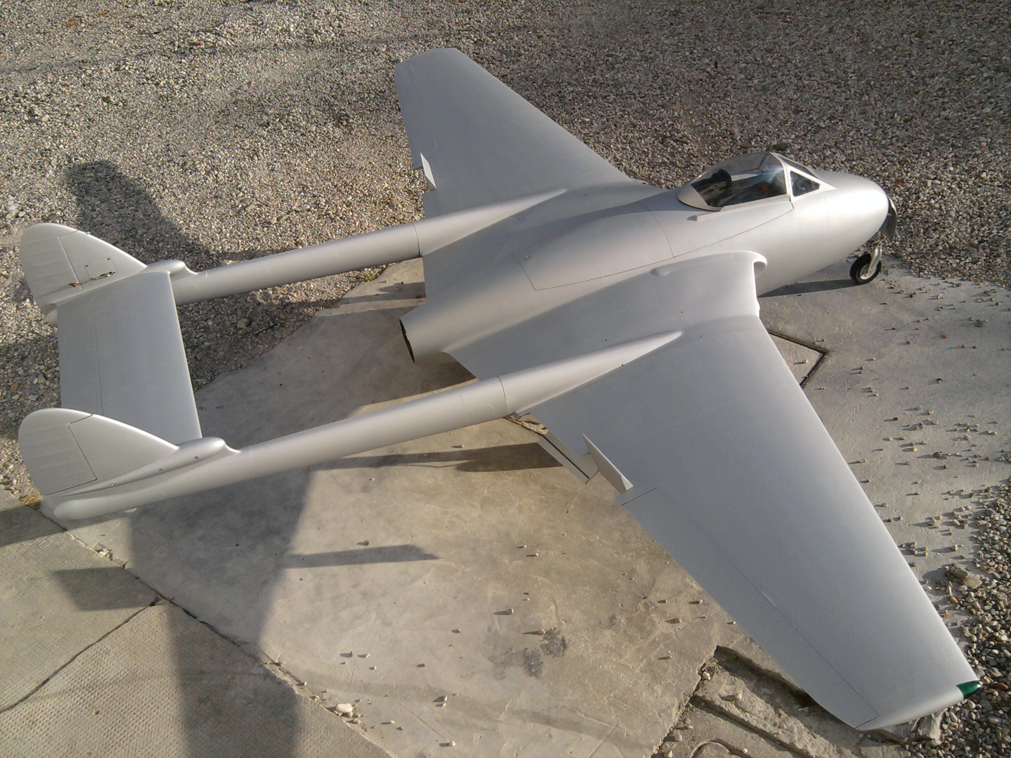

finally done!!!
add 200g ballast on nose ...total 1kg
[link]http://www.youtube.com/watch?v=yGXzXb51ZwQ[/link]

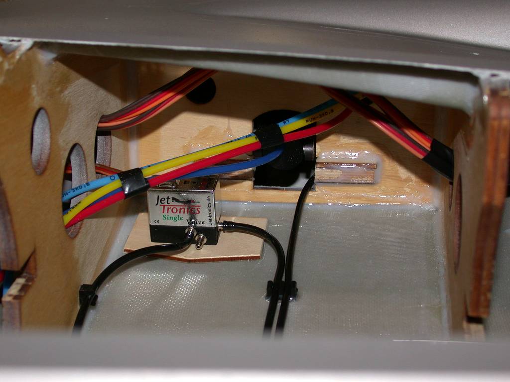

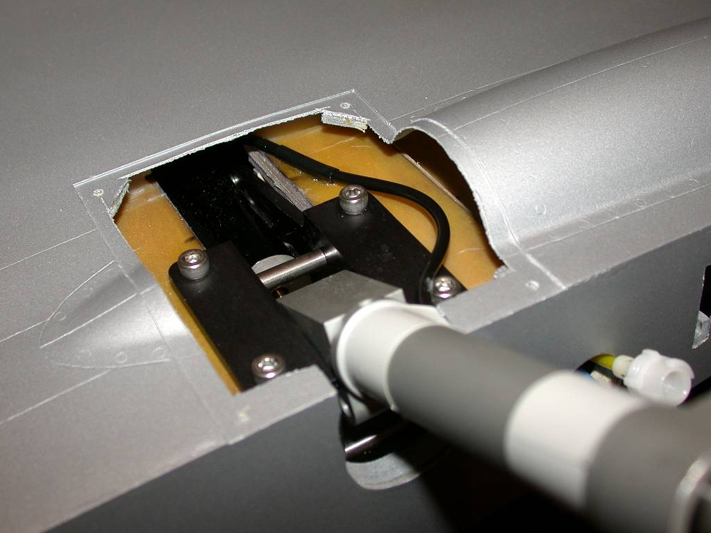

Missed a shot of the JetTronic brake valve position. Like Bill I'm trying to get as much forward as possible to help with the balance, for ref I have heavy duty velcro on the back of the tanks (which are flat) and on the bulkhead. This retains the tanks along with the UP3 valve plate and MAP mounting base. All three Li-Po pack go in the nose 2 x 4200 and 1x 5200 2s all from Graupner.
Dw

Chrigui,
What happened to the front leg ? Why did you not fly with retracts down ?
Nice flight...
Jean Philippe
Old 04-24-2011 | 10:51 AM
  #168
Joined: Mar 2004
Posts: 1,567

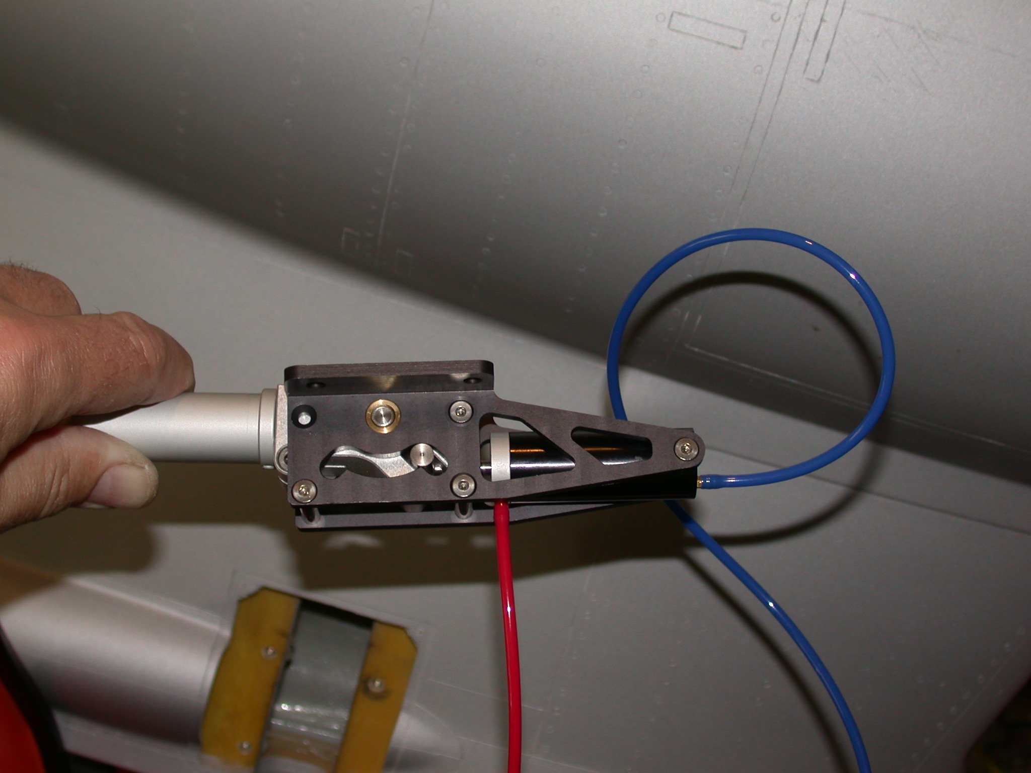

hello ....the first flight all gear up..
second flight noge gear fail only in flight (test after flight ok)
it need slighty modify rounding the sharp edge like previous photo
(i did the modify only main gear mechanism)
