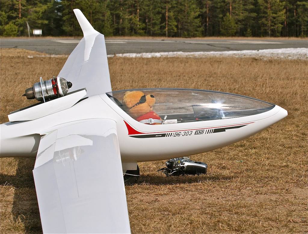

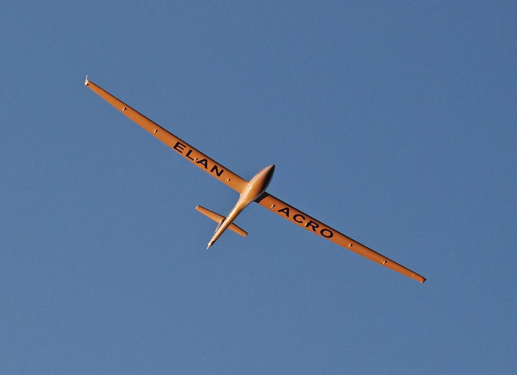

I'm all for Paritech - great to deal with andlots of options. Yes, a bit pricy but you really get what you pay for...
Below some pics of my Paritech Elan Acro 6.52m. Maiden on saturday and five more flights the following days. Great flying bird.Absolutely my favorite plane now
ORIGINAL: siclick33
Very nice.
Do you know the weight? What turbine are you using?
Very nice.

Janne,
That is a beautiful model! I am currently looking for an airframe that will come in just under 20kg with a P80SE. Got a few in mind but some of the guys want 6months to deliver a kit [&o]
I can see myself ending up a Paritech - how long did you have to wait for yours??

Ordered in Jetpower and received in december - about three months. And it was with all pre-build options.
<br type="_moz" />
Hello Janne,
I have the 5m DG 303 from Paritech and from your comments I understand that you are not very happy with the performance of the 6.5m with Hammer 90 and 23kg AUW .
Paritech recommends a Wren 44 Gold 10lbs thrust for the 5m and AUW is 12kgs .
Should I install a Wren Supersport instead (18lbs).
Only problem is that it will increase the overall weight by maybe 500gm and will call for an additional fuel tank atleast 500ml
Will it still be structurally sound ? I know the wing has a Carbon D Tube structure.
<br type="_moz" />
Hi Xantos!
Actually I'm very pleased with the performance - sorry if I wasn't clear. These low drag gliders go like missiles once you get the speed up. It's just the start you could use some more power - especially if you are flying from a short field. I try to get a video next time
5m Paritech DG-303 and Wren 44 Gold should be a perfect match. With a Supersport it would of course be ballistic...but I would put the 44 in it
