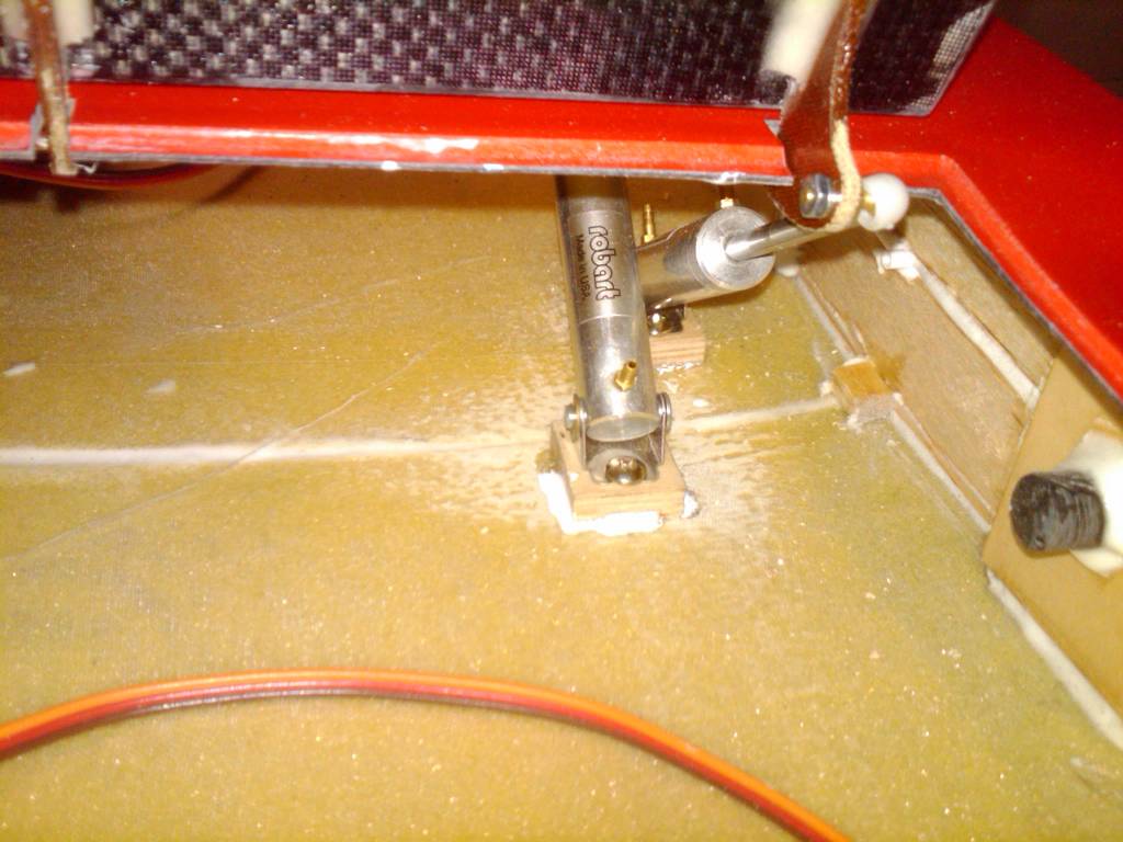

Ian
I presume the main gear cylinders you have are larger in dia than the nose unit one?
Glad you like it
Dave

Ian
Should be right, but just didn't want you getting to that stage and find they had slipped through.
I have 3mm tube on them and recommend you use that too. Depends what valve you use, on the JT valve, I think the larger volume tube allows the air to decelerate after leaving the valve and people struggle to get the gear away with the outward angled leg doors and fast forward flight. I've never had a problem on mine, or people using the UP2 valve.
I use a philips screw driver of around 1/8 dia and with a little "spit" force that in the tube end as far as I can, I leave it 1 minute, pull out the driver and work the tube on. Works for me on Festo and BVM tube.
Dave

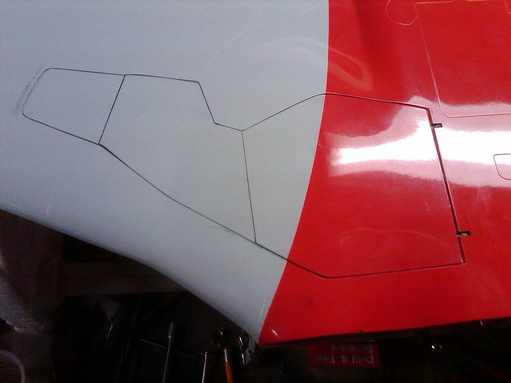

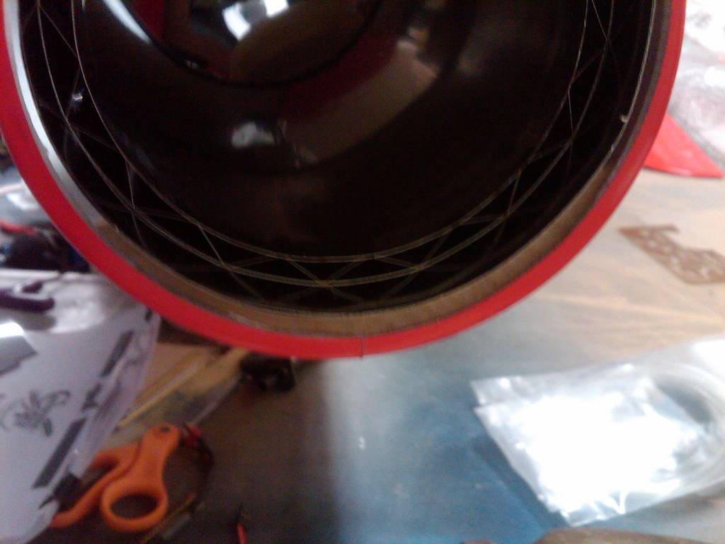

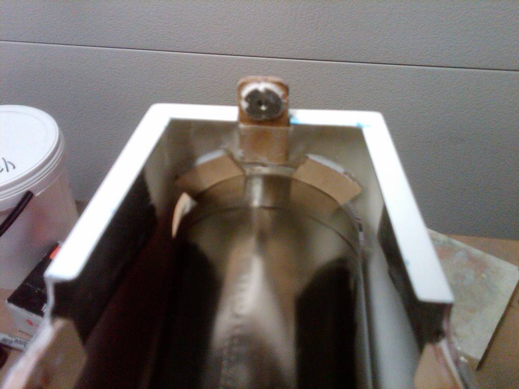

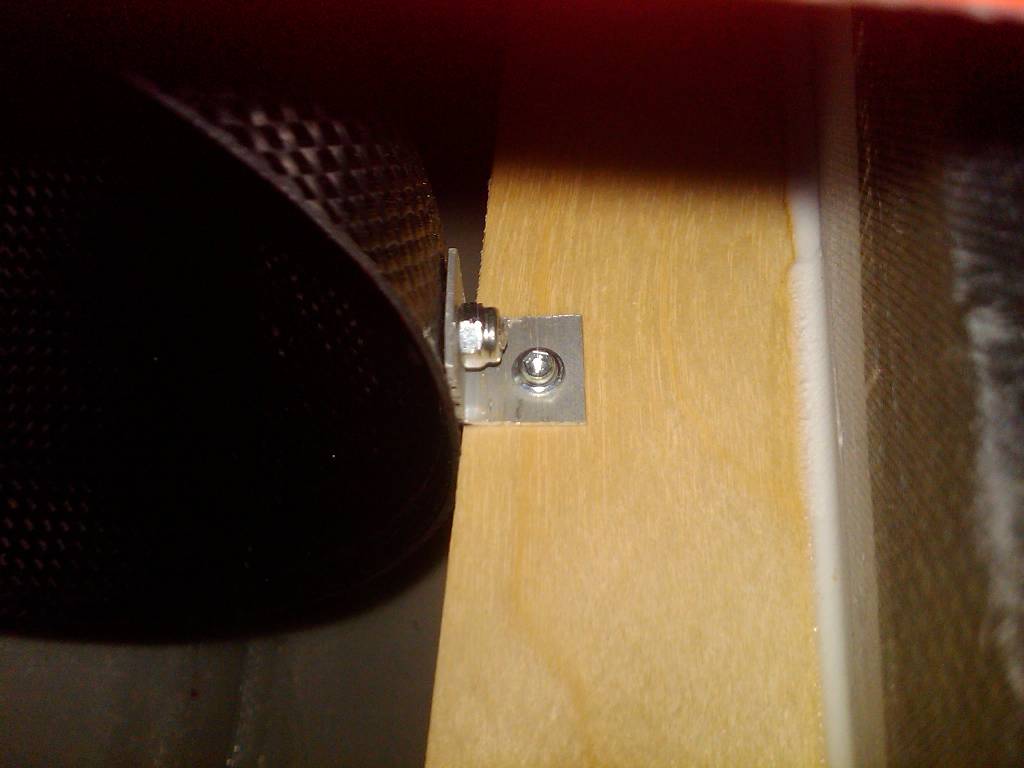

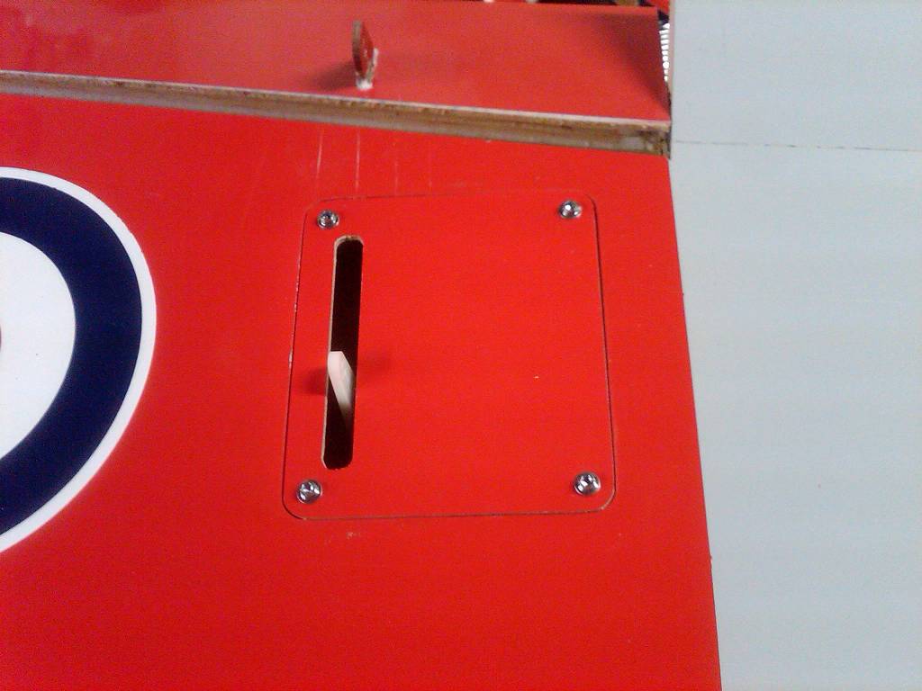

Ok, latest progress had the wing almost done. Dantley has opted for a Tam pipe so a few adjustments had to be made in the rear of the plane. The pipe is slightly smaller in diameter than the stock pipe so I used some plywood to brace the pipe both top and bottom and to center it in the fuse.
I got the main gear installed, fairly uneventful although the right main is ever so slightly touching the wheel well opening and I have already ground away the lip as much as I can so I will have to see how that goes. Gear door cylinders are installed and servo hatches have been attached as well. All that is left for the wing is to attach the strut doors and smaller outer doors (which I think will be fixed in place with a slot cut in them for the strut to clear as opposed to making them open and close, Dantley??) and then extensions and plumbing.
I also got the rudder hinge pin installed and rudder servo installed and just need to cut the hole for the servo arm and that should wrap up the rudder.

Nice progress! Do you know how other builders have set up the outer doors?
Old 05-25-2011 | 02:50 PM
  #34
ianober's Avatar
My Feedback: (12)
Joined: Aug 2002
Posts: 4,462
From: Scottsdale, AZ
Default RE: Comp ARF BAe Hawk Build Thread
2 options, hinge them like normal or do like the manual says and screw them down and then cut out clearance for the strut. My vote is for option #2 since this is a sport scale plane and you want to try and fly it this weekend. It will take time to hinge them and figure out linkage and actuation.
Old 05-25-2011 | 04:22 PM
  #35
dubd's Avatar
Joined: Aug 2007
Posts: 4,313
From: Bay Area, CA
Option 2!

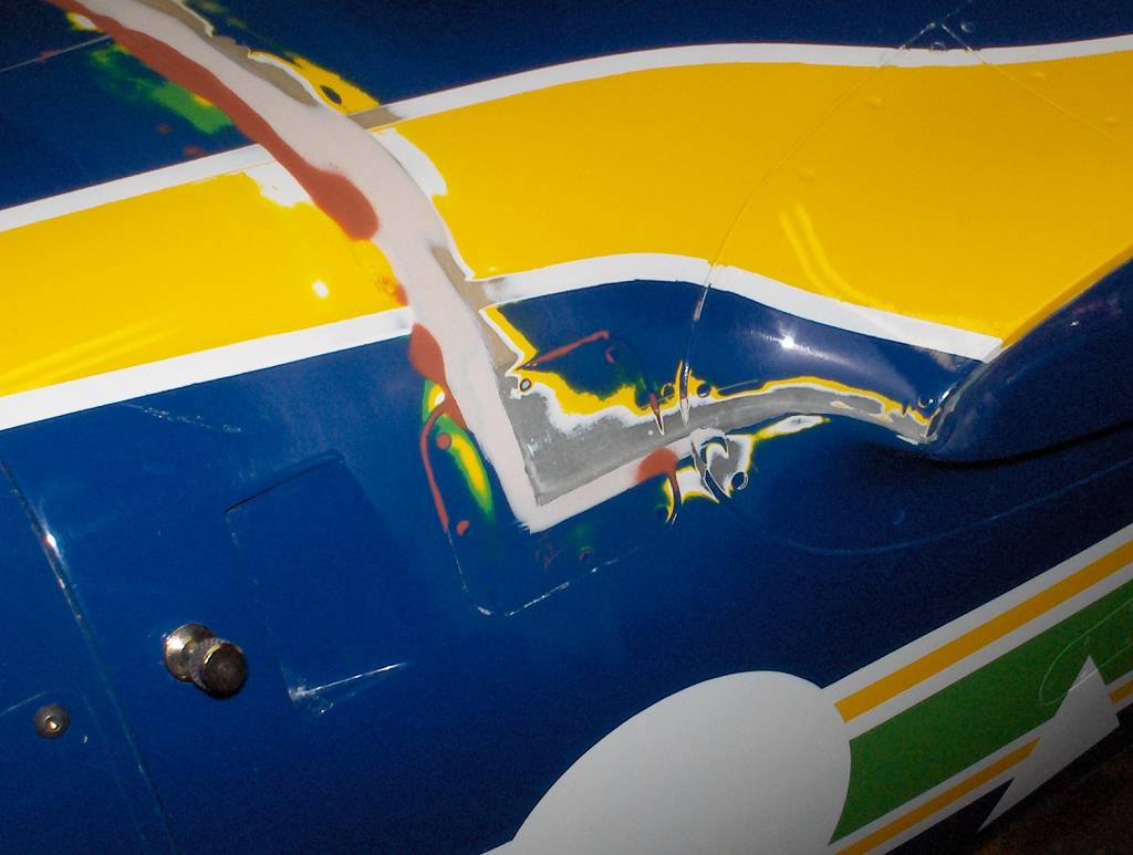

Ian, We use the Comp-ARF paint at a 4-1 mix. 4 parts hardner to 1 part paint. Just sprayed the nose on a Flash and it came out fine.
We got the mix ratio from Andy Kane who is Mr. Comp-ARF.

Ian, We just did the Flash yesterday. Below are a few photos of a Tucano I did. The color's match good with very a little Rubbing Compound to match the shine on the finish.
Below you can see the blue. I did not take any photos of the finished project but you get the idea.

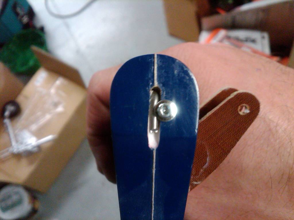

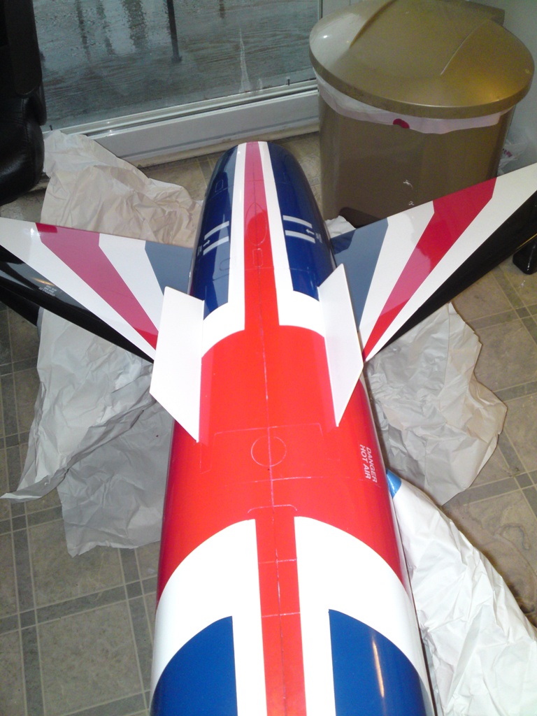

Dave, what is the prefferred method for securing the carbon fiber shaft for the stab? Do people drill and pin it through the ply that supports it? Also what about the rudder and its Carbon Fiber post? I know it has the bolt in front but you can still move it up and down in the rear a little. Do people secure the post somehow as well?

Ian,
I drilled a small hole vertical into the carbon tube and put a 2mm c/s bolt in. Totally hidden by tailplane but easy to remove! My fin is tight when front bolt is in so not adding anything else. How do you fit the scale cockpit when the steering servo comes up into the space needed?? Pics would help.
Ian.

Ian
Nothing needed on the fin, never had mine lift in flight and I can get 1/8" gap by lifting the back. Like Ian I placed a pin out side the fuse either side, but I have seen 4 or 5 different methods.

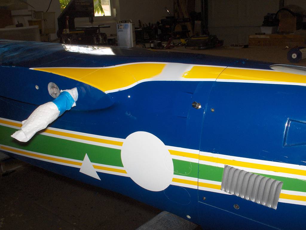

I did manage to do the outer doors on mine but it took a little time to get right. I just used a wire attached to the trunion to activate the door.
I also used touch up paint to paint the ventral fins and the match was great.

Mike, You are correct. It is 4 parts paint to 1 part hardener. But I am happy to report that it works the other way also.
Ian, We did sand with 2000 grit paper before we did the rubbing compound and it is perfect.
