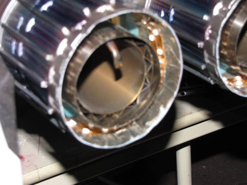

I run it between the walls of the exhuast, really thick and dense smoke:

it works . . .and works very, very well. Bill Hatcher and I (at my insistance) have installed this system on each and every jet that leaves his shop. To name a few, 2 large Futura Jets, 2 small Futura Jets, CARF Tutor, DJM Vampire, CARF Ultra Flash and so on.
Pre heating is not necessary as this is accomplished by running the stainless steel tubing down the pipe between the inner and outer pipe walls. We use the 10 o'clock and 2 O'clock positions or the 9 - 3 positions. The ends of the nozzles are compressed almost flat as they would be in standard smoke nozzles.
The smoke put out is equal to or greater than spray bars inside the jet just aft of the turbine nozzle. . .and the big benefit is SAFETY ! No more chance of smoke oil fires due to residual drip inside the bellmouth assembly. I have witnessed more than one jet flame out during a smoke on pass. The pilot forgets to turn off the smoke pump, maintaining his focus on landing the plane. Smoke oil ignites and is being fed by a full flow of oil. You know the rest.
Try this system. . .you will never go back to internal smoke systems again.
Regards,
Eric Clapp

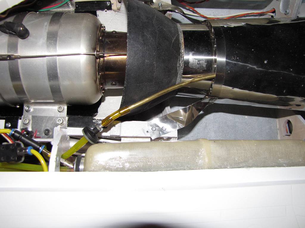

Default RE: Smoke system injector at tail???
Mark if you use a 3/16th inch tube between the walls the fit is tight enough to secure it. you can also use a piece of glow fuel blue fuel line around the outside of the tube and wedge it between the pipe at the back. it will stand up to the heat. I also use a one way check valve. I found that the pressure from the tail pipe will actually cause the smoke pump to lose its prim in flight. I also set up a header tank so I don't get the negative G on and off smoke through maneuvers.
Joe L.

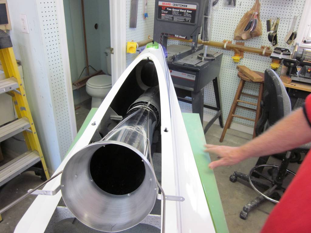

Mark, Here are a few shots of different planes.
1st photo Small Futura On this one I just safety wired the smoke tubes to the pipe mounts at the bell mouth.
2nd Photo Comp ARF Tutor. As you can see in this one The smoke injectors are not run between the walls of the pipe just down the Fuse sides and out the back, This also works well.
3rd and 4th photo Large Futura. We just used Safety Wire in 2 spots around the inside pipe.
When we run the 4mm stainless tubing between the walls of the pipe we cut a small notch in the inner pipe at the rear so the stainless smoke tubing has a lock to keep it in position, we then pull if forward into the notch.
Hope this helps.
