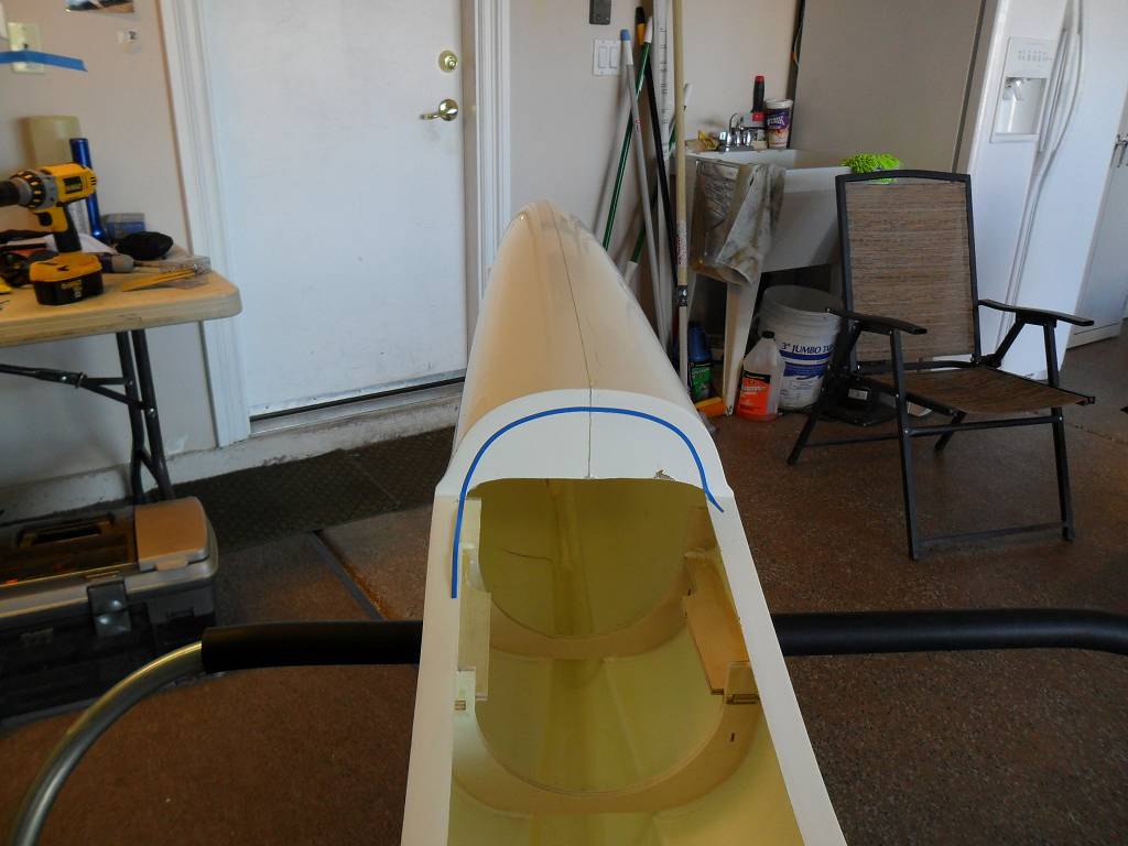

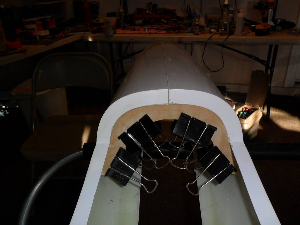

The very first thing I did was to clean up the glass work and removed excess material. Pic #1 shows me about to crop the aft wing opening area.

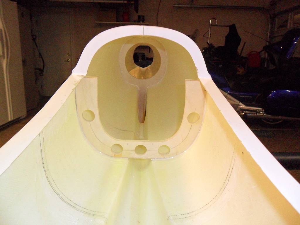

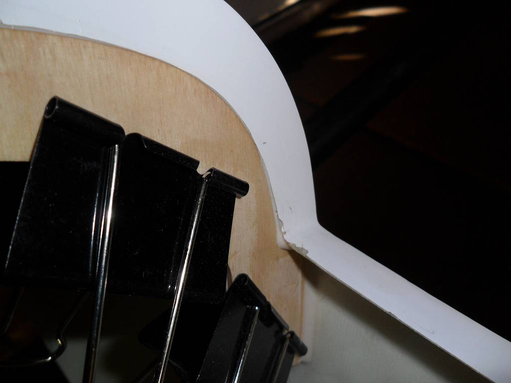

Pic #2 shows the front wing saddle bulkhead after I cleaned it up as well. Nice uniform radius of the glass looks much better.

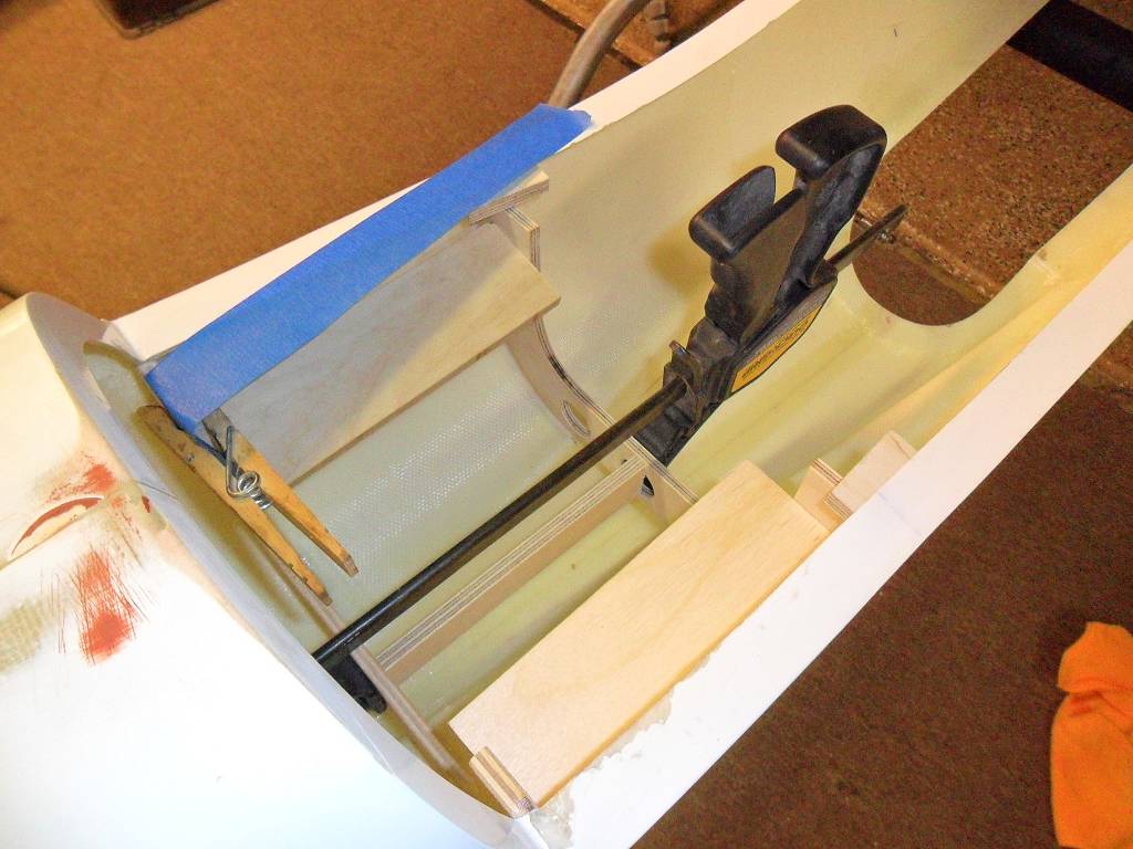

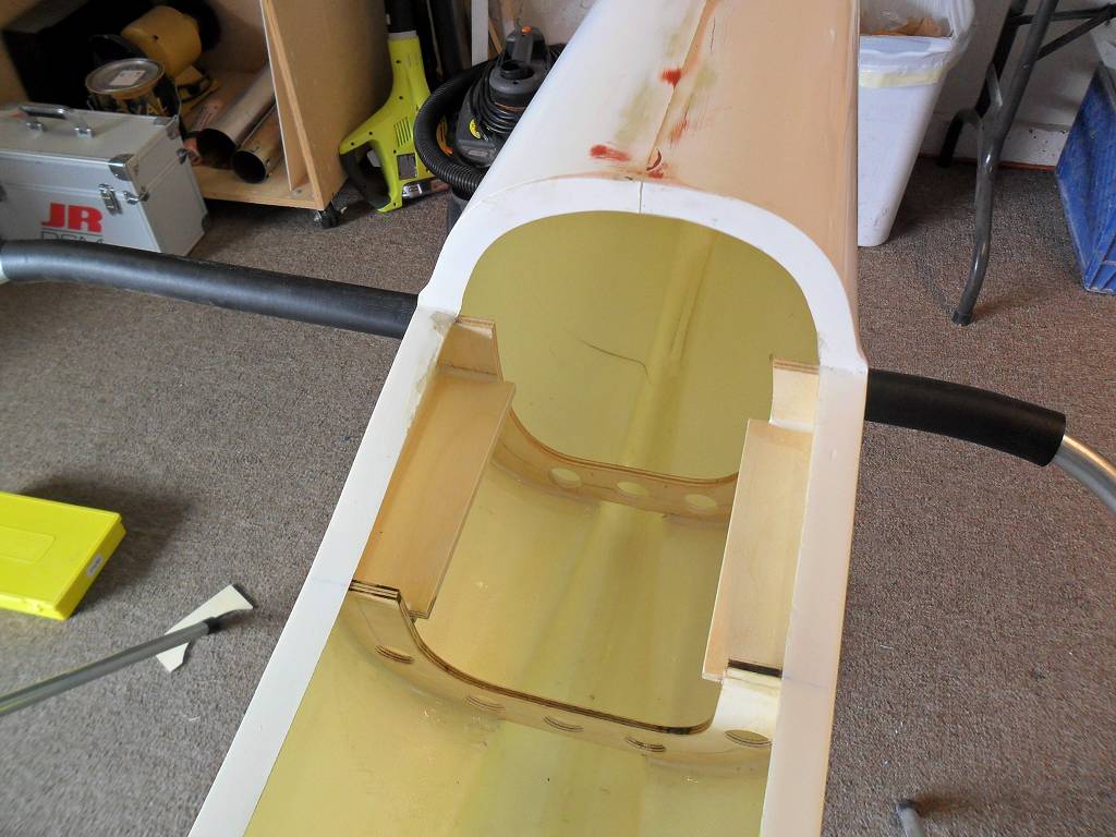

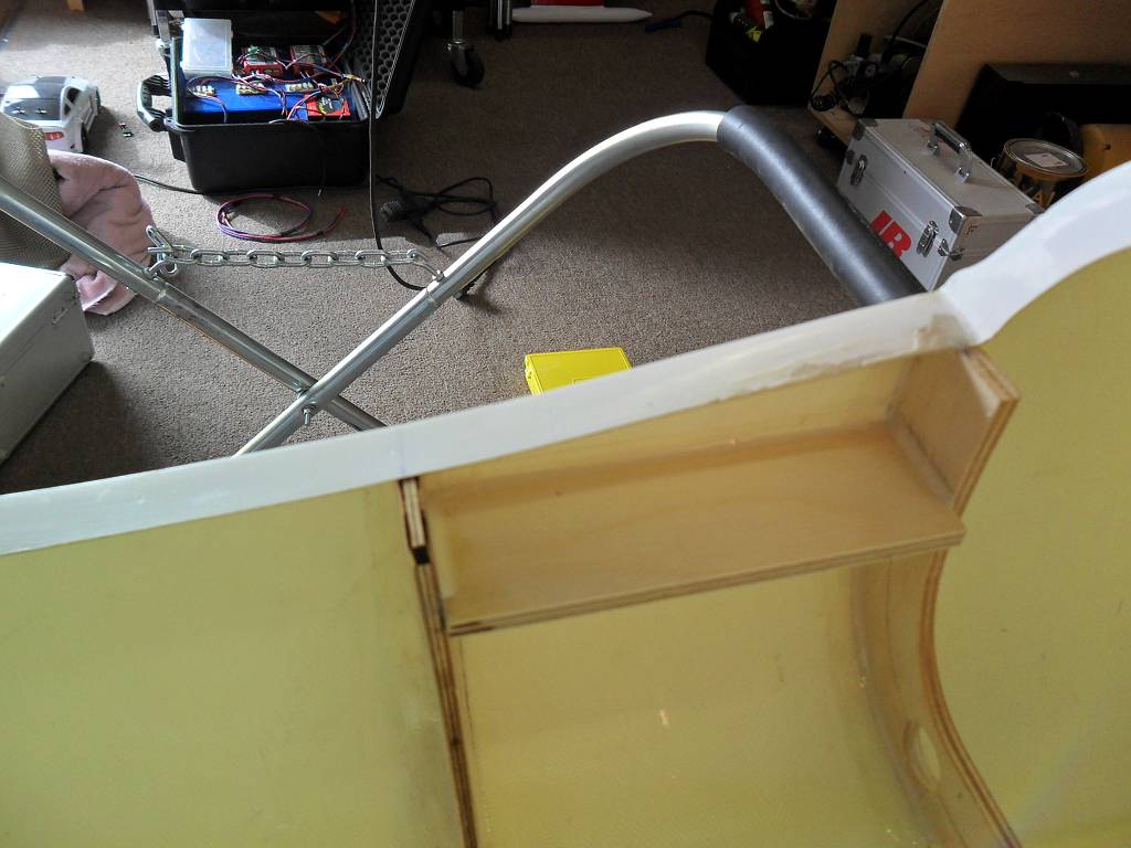

Pic #3 shows the 1/8 inch ply doubler I made to laminate to the factory installed bulkhead. I will also make a 1/4 ply doubler to laminate to the rear of the same bulkhead. This will make the bulkhead 5/8 in thick....no way this will fail in flight!
Stay tuned, more to follow....

Ok, Pic #1 shows the 1/8th ply doubler clamped in place.

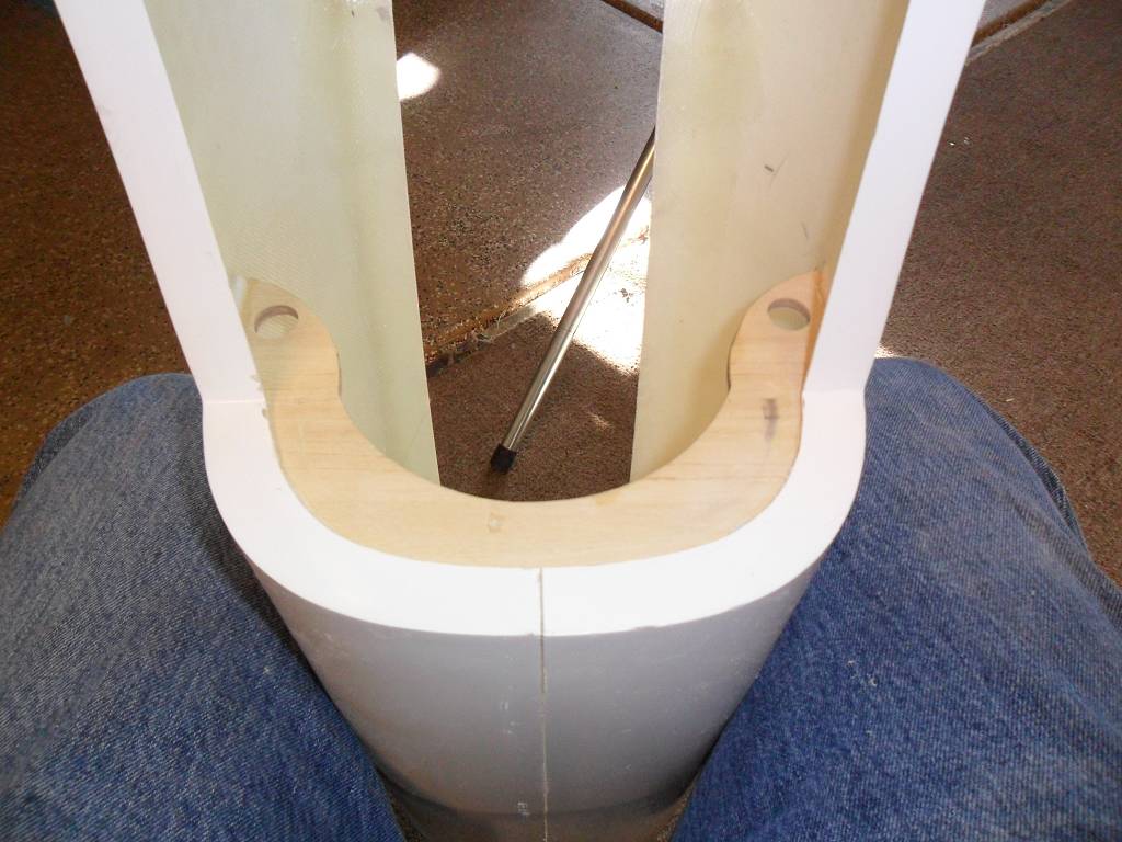

Pic #2 shows it after the hysol has cured. Notice that the ply is now flush with the face of the glass work. I worked some hysol down in between the original bulkhead and the glass work filling any gap in that area.
Pic #3 shows the 1/4 inch doubler in place. now we have a 5/8ths thick bulkhead that is not going to fail, period.

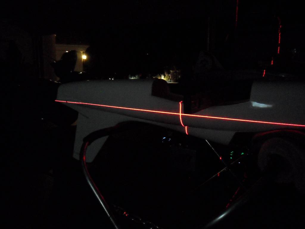

I used my laser system to zero out the air frame and get the bulkhead in at 90 degrees. Picture #2 shows me getting the fuse lined up at zero degrees incidence.

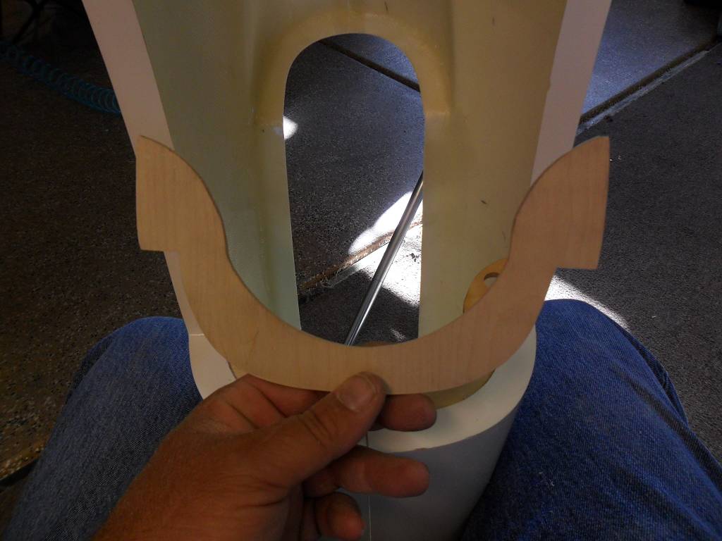

Picture #3 shows the front bulkhead before it is installed. Making these bulkheads is a sand and fit kinda deal. What I do is I make a cardboard or poster board pattern by trimming and fitting and trimming and fitting.....after about an hour I have a pattern I can transfer to the plywood. Then I cut the plywood out staying slightly outside the lines of the pattern so I can sand it for a perfect fit. It takes time to get it right but once its done and glued in it will not move or fail. Because it takes time is exactly why it is not done from the factory on these cheaper models.

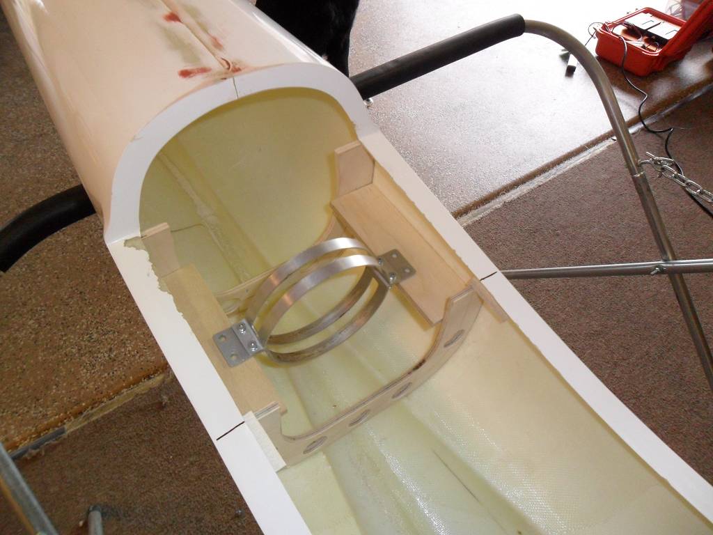

Continuing with the mount.
Picture #1 shows the front bulkhead in place with the two motor mounts and a third spacer to align the forward bulkhead. The actual motor mounts are not glued in place at this time. I will place them in position once the bulkheads have cured in place (over night).
Picture #2 shows this from a different view.
Picture #3 Shows the motor mounts in place. Again I used mu laser system to zero the air frame. I then shot a "line" from behind the jet up the tail pipe. Centering this line in the exhaust exit I was able to get the engine right on the thrust center line. Sweet!
Picture #4 is another view...if you look closely you will see nice clean hysol fillets....

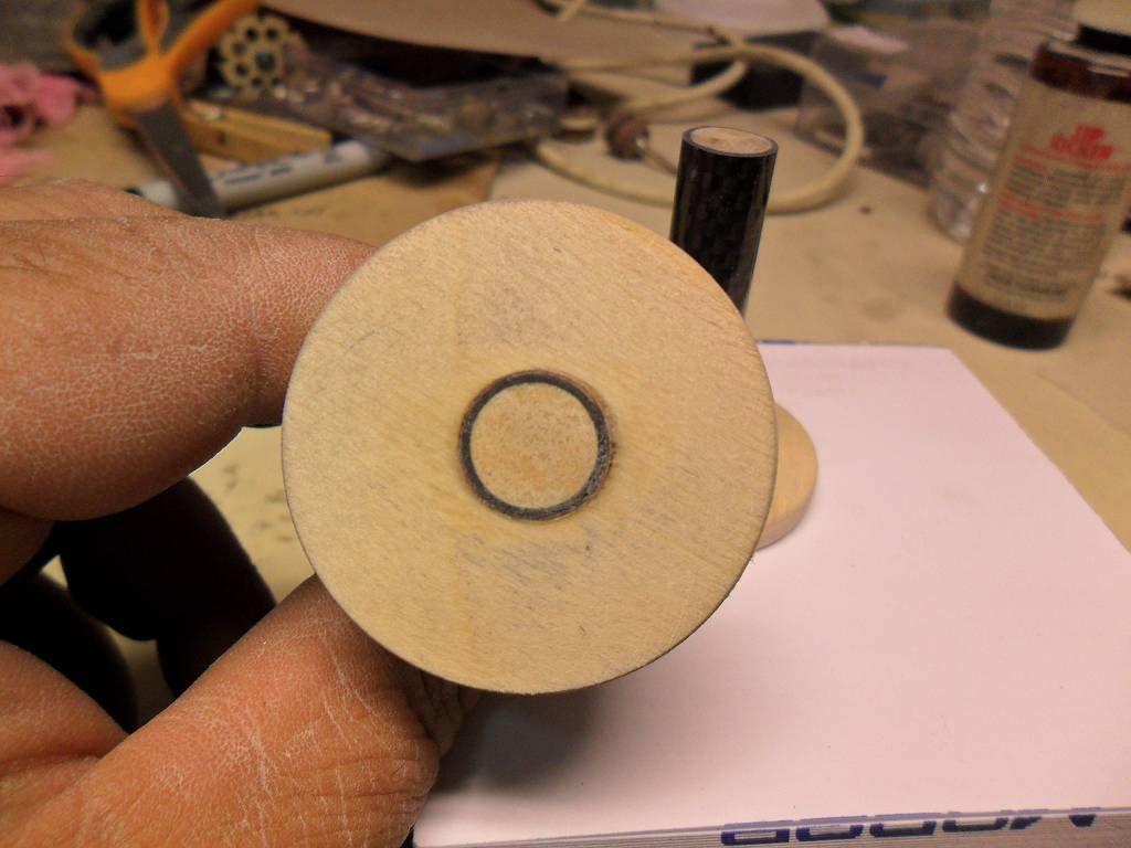

Next I made the wing hold down dowels. These are made from hollow carbon tubing with a center core of hardwood dowel. the outside diameter of the carbon dowel assembly is 1/2 inch and there will be two of them holding the wing in place. I seriously doubt that these will fail under any conditions.

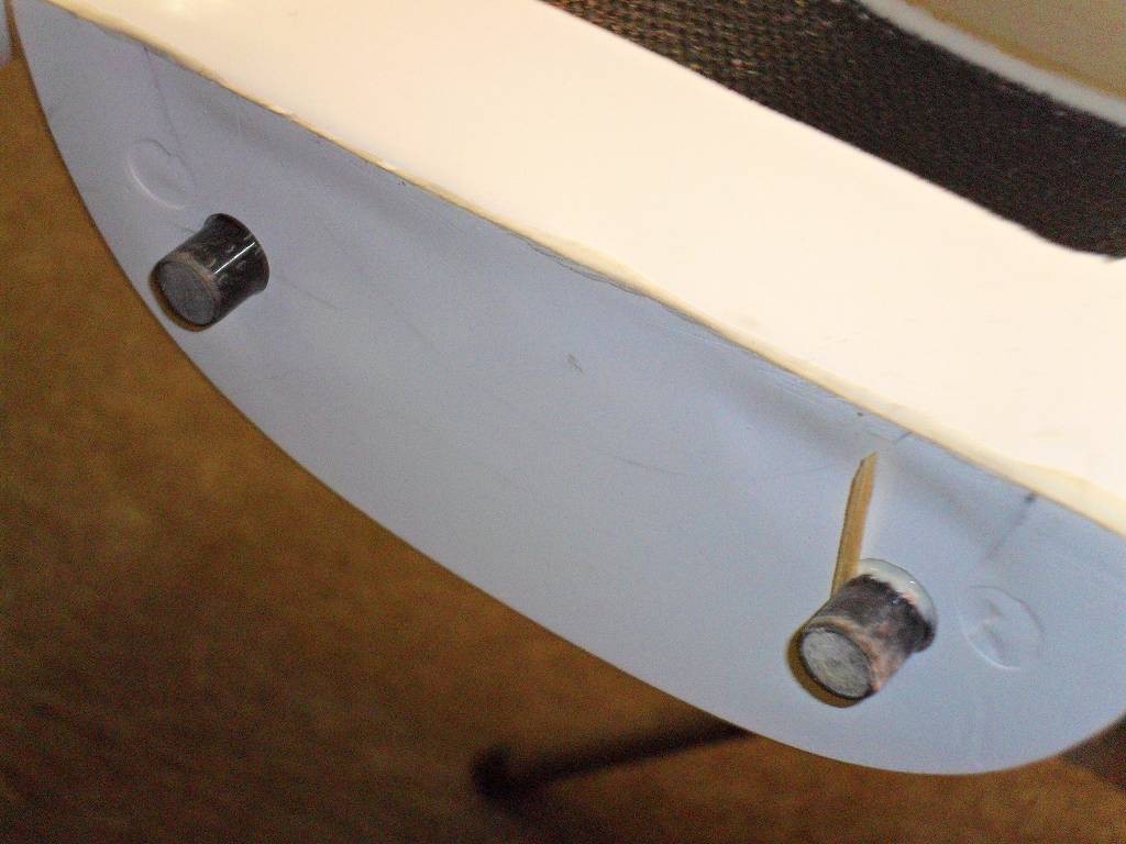

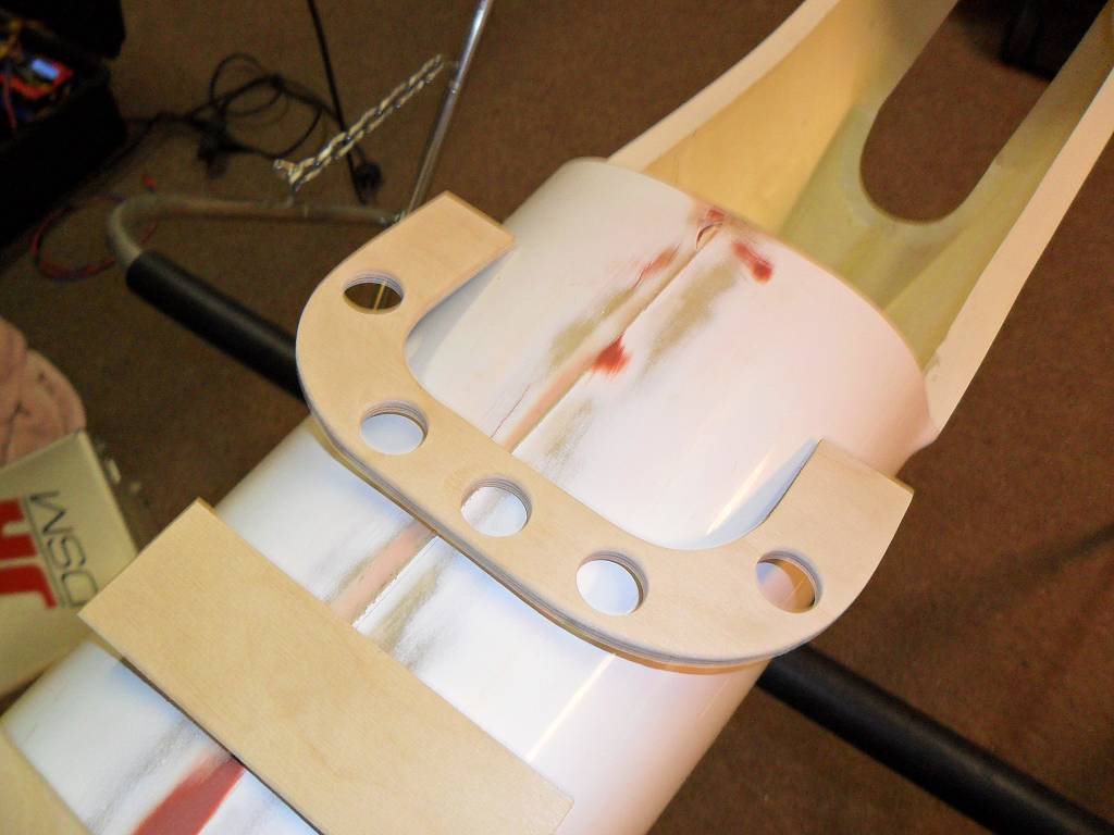

Ok, I decided that I want to use a pin and bolt system like I have on my CompARF Flash. So the first thing I needed to do was make some pins. I know some guys used wood dowels but I felt that they might not be strong enough so I built my own composite dowels using a carbon fiber tube and some hard wood dowel material. I then mated them up with a 1/4 ply circle that will back up the pins once they are installed.
Picture #1 & #2 Shows the pins
Picture #3 Shows the large holes in the forward bulkhead.
Pictures #4 & #5 show the hold down dowels installed in the wing.

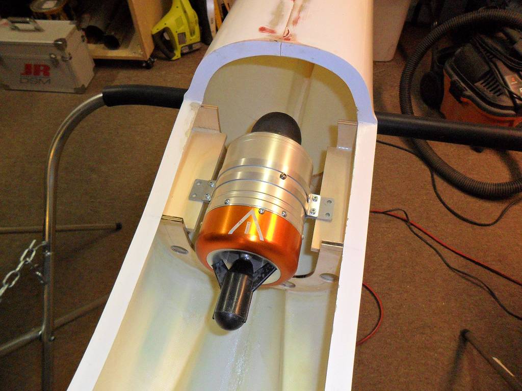

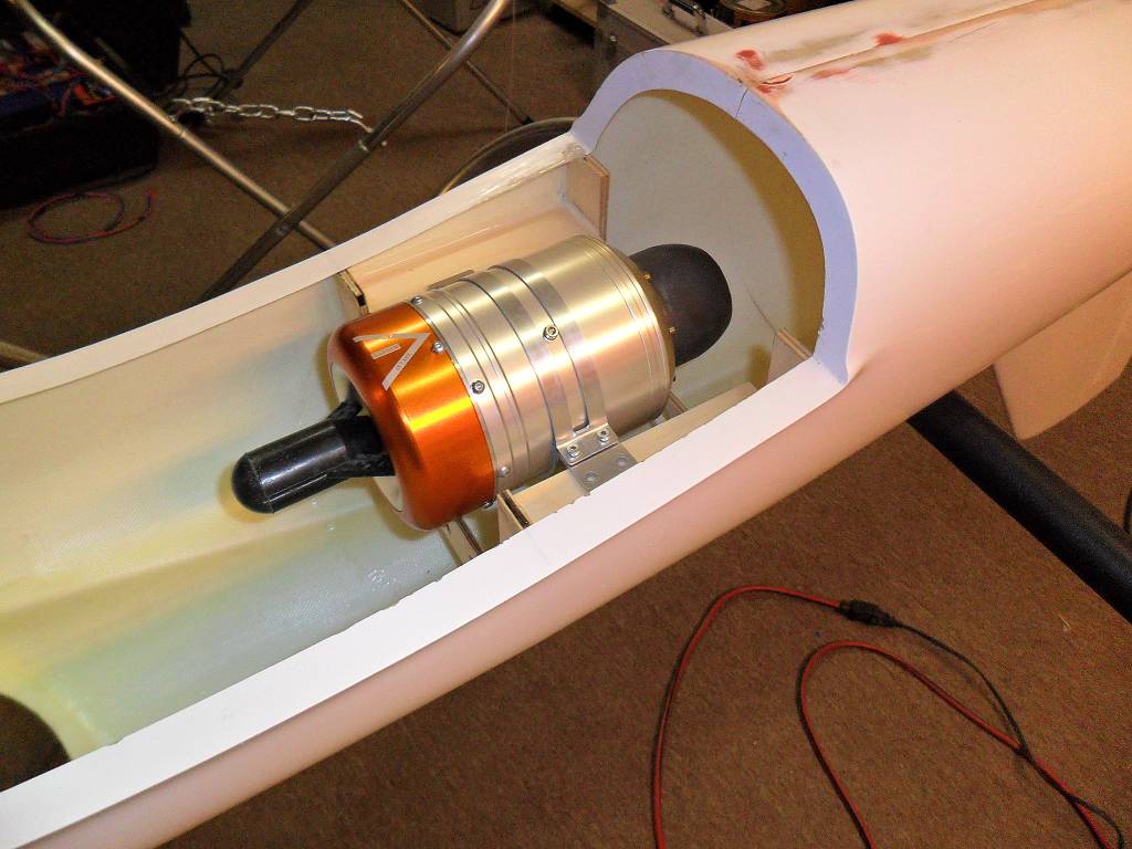

Now it is time to start working on the rear hold down system. Like I said I will be using 4mm bolts to secure the wing in the rear. I have not started yet on this so I dont have any pictures....
Here is a picture of the evoJet 90 sitting on the mount!
