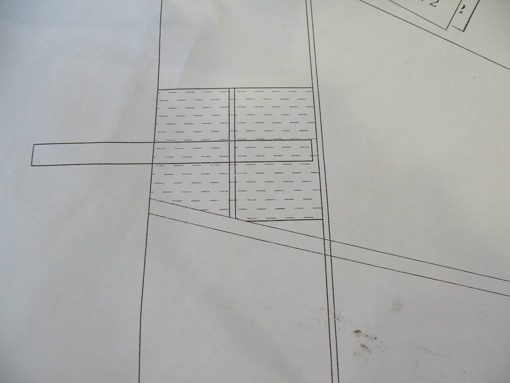

Jet Legend does provide a nice set of plans with the plane.
I used this to add a hatch to the top of my wing in the saddle area for access to do the gear doors. I can tell you that based off the plans the ribs were exactly where stated on the plans.
I also used the plans to find the hardwood in the flaps and ailerons to install the control horns and these again where dead on... the dashed wood on the plans is harwood. I found the hardwood in the flaps and alierons to be very hard and not soft at all.
Here is some pics of the structure from the plans on the stab
I'm not saying the plan doesn't have an issue, just that many are flying safe...and this may just be a few that had issues or linkange, servo issues

I have seen at least two JL Hawks go in due to elevator failure. In both cases the tail broke in some way in flight, one of them loosing the whole elevator. On the other the incidence pegs, as previously described, were into balsa! That said the original SM Hawk did exactly the same thing. I lost mine in exactly this way and another guy in the club did too. I then Bought a FB Hawk (basically the same model with more paint on it). I took the tailplane apart to prevent it doing the same thing. Junk building inside.
All the chinese brands have issues, and there is some rolling of the dice when you buy.
That said, there are a lot of JL models in my club, and other than the above mentioned Hawk, and the F20 discussed on this Forum last year, there have been no fatal failures.

ORIGINAL: JohnMac
I will definitely cut mine open and post photos when I do!
I dremelled out the tailplane root without damaging the skin. Then I wiggled the tailplane pivot until it broke free. After that I removed all the balsa bits inside. Then I used the JL mechanism and tailplane pivot rods as (provided the bolts are tightened up), this mechanism is much better than the crap SM/FB system. I drilled new holes for the anti rotation pins, horizontally not vertically. This meant I could make them much longer. I then laminated a new plywood root rib with the long anti rotaion pin buried inside. A small ply internal rib was added at the tip of the rod and then the tailplane was slid over it like a glove. Finally I made some card templates for the tailplane dihedral angle, centred and locked the servo with the rods clamped in, and hysoled the tailplane in place. That never failed.
Good luck with it. Well worth doing.

ORIGINAL: JohnMac
I assumed the 'anti-rotation' pins were horizontal from the get-go. I cannot believe a manufacturer would think a vertical orientation in a thin stab would allow for adequate length of the anti-rotation pins and sufficient support from the wood mount blocks for the pins (especially if the wood is balsa!) Good grief.

ORIGINAL: JohnMac
Hi Rich,

ORIGINAL: RCISFUN
Thank you JohnMac you have just confirmed my post #3 in this thread

ORIGINAL: Ron101
If you look at my plans from jet legend that I posted above they show a horizontal anti rotation pin
Also, the pin doesn't go through the full length rib (denoted by yellow circle). Because of this, the loads aren't transferred across the chord of the stab and the area around the balsa block is taking the full load which doesn't look strong enough to handle the load.
If it were me, Iwould get rid of the balsa block, build a plywood box around the rotation pin tieing it to the root rib, full length rib, andspar. Iwould make sure the root rib and full lengthwere ply or at least had plywood doublers, andmake sure the pin went through the full length rib.
Kirk

Here's a drawing of what I descibed above for how Iwould fix what the plans show,
The black denotes the plywood ribs and box around the rotation pin. The blue denotes a plywood plate on the top and bottom tieing the plywood box to the spar. The plates would encapsulate the rear section of the anti-rotation pin. Ileft the pin visible for clar ity.
