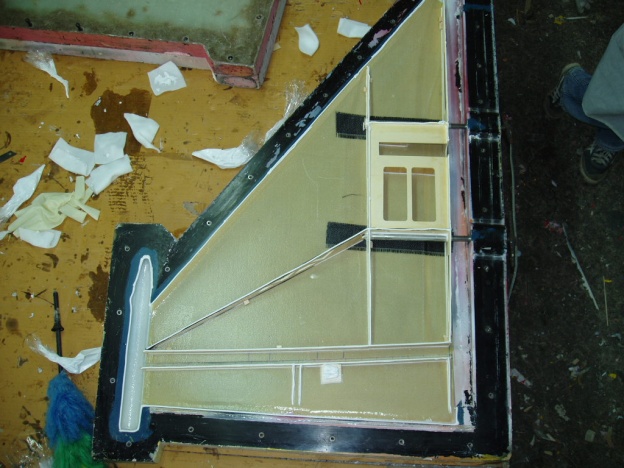

Sorry you loss your jet.May I suggest a bore scope for your inspections.I use them all the time at work and they are a great aid.You can drill a small hole into the root forward and aft of the pivot shaft and take a peek in side.Again sorry to hear about another crash caused like this.

I love my Eurosport and my Flash (when I had it) too. However, when I originally got my Euro (5 years or so ago), it had a design flaw in the gear plate mounting such that any non-perfect landing would knock the plates loose and drive them up through the top of the wing. Sure enough, it happened to mine. I applied the fix that Todd published on his web page and its been a super jet ever since.
Trust me though, I've been inside my Euro wing and you could not see the required reinforcement in the picture below, so nice as it is, it doesn't tell the story - and even good manufacturers like Comp-ARF and BVM are not immune...
Bob
Not saying CARF is perfect, no company (regardless of industry) is, but the perception is that they have much higher standards than other ARF companies. I don't think that is by accident.
