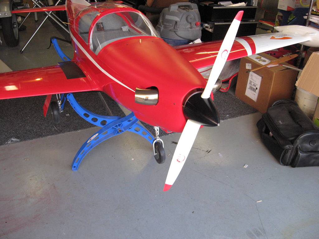

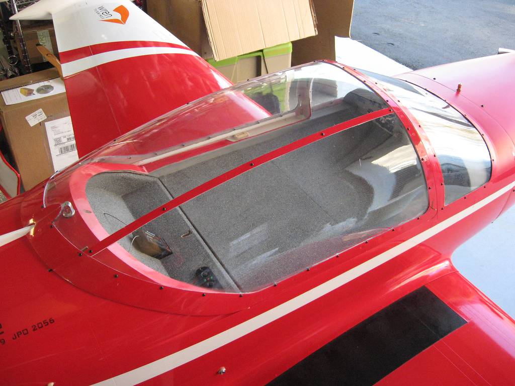

All ready to rumble...
The CG is set at 1/4" aft of the main spar LE!
Turbine all tested
Glider tow release installed under the canopy so here it will
not interfere with any of the nice lines of the turtledeck or the ftont of the fin!
Istill need to mill a wide slot in the lower aft of the canopy frame to
accomodate the tow line!
Now just need some good weather
standby for the maiden video!!!

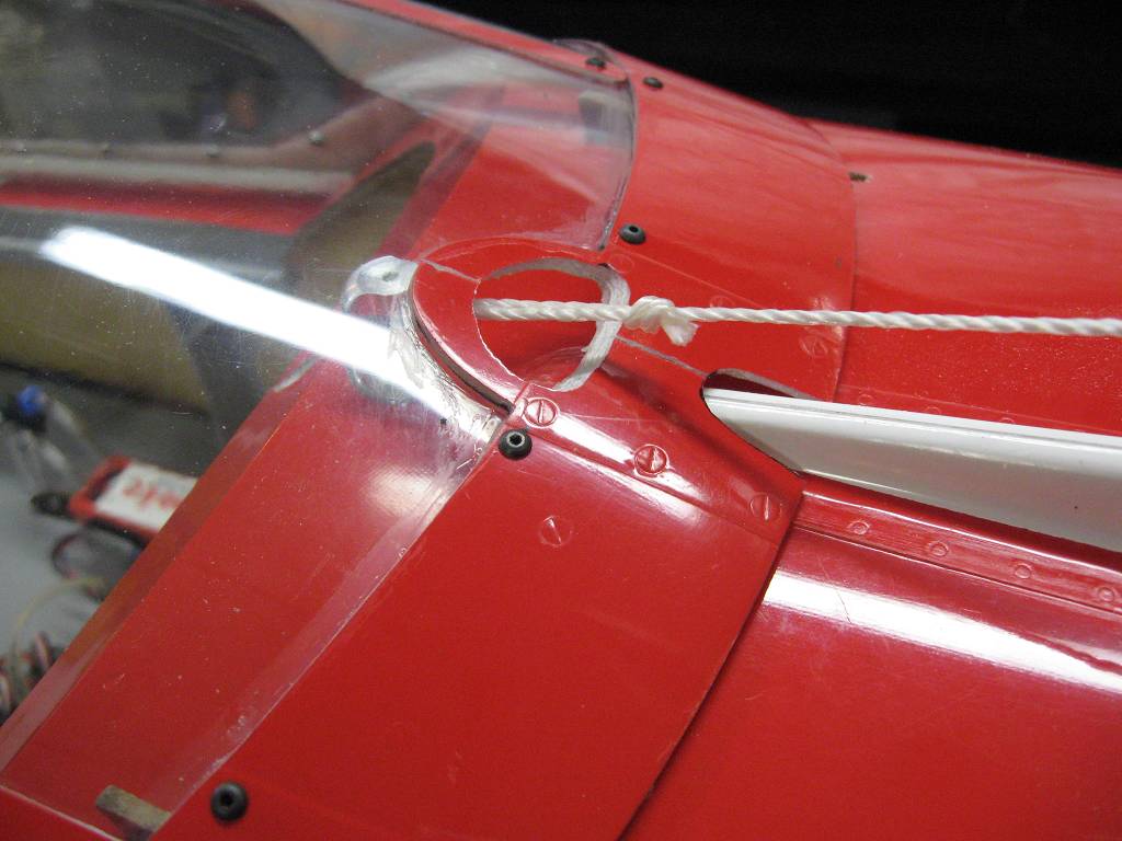

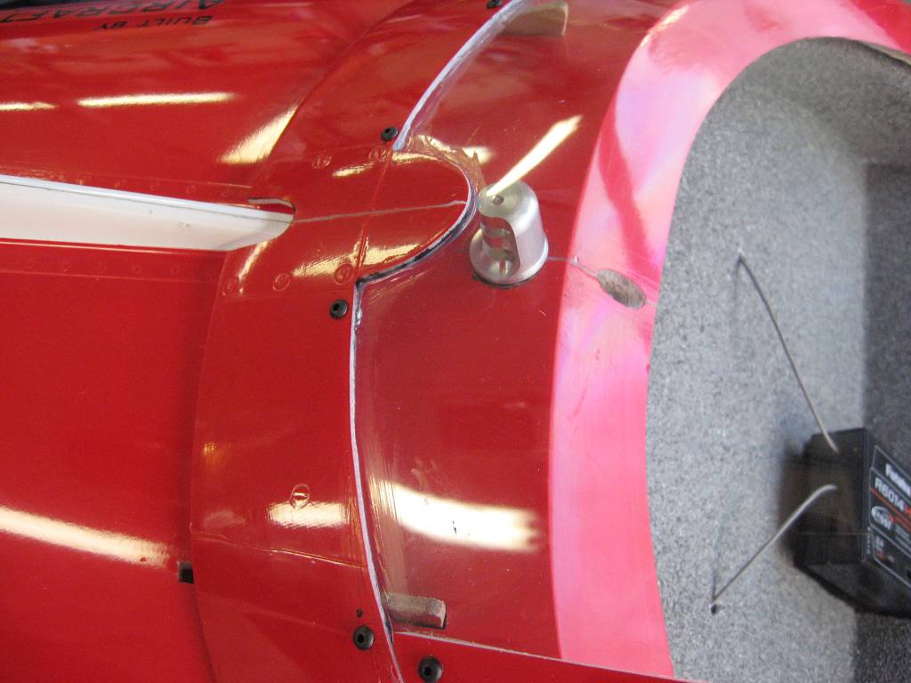

Ifinalized the glider tow system
it is simple withthealu release from"IFlyTailies"
and a122 in/oz servo. Imilled a port on the rear of the canopy deck
that will allow for a wide variety of towline angles.. should work fine
