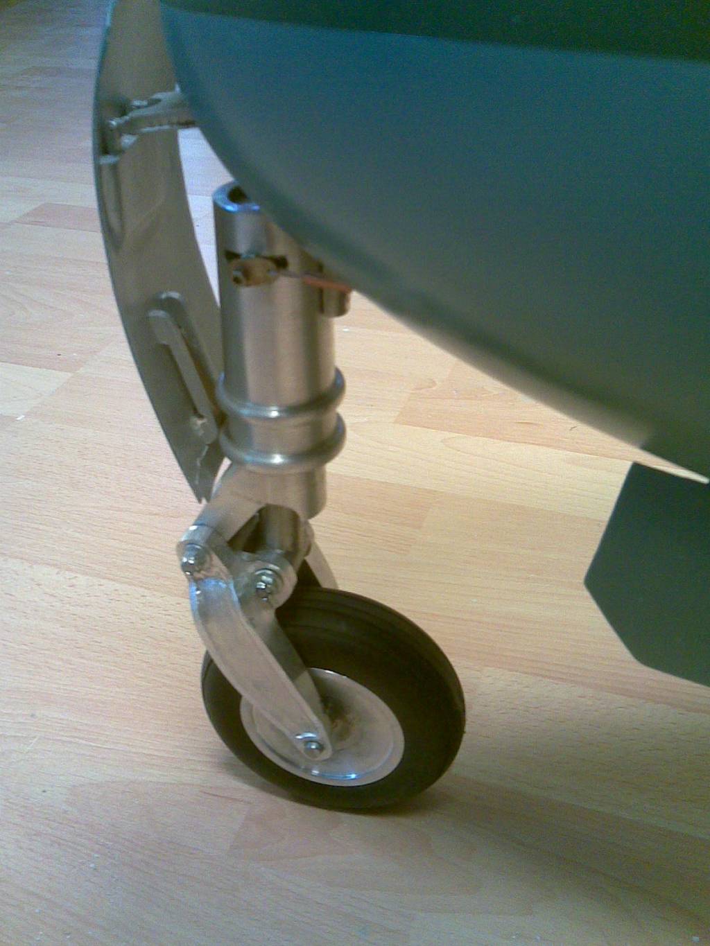

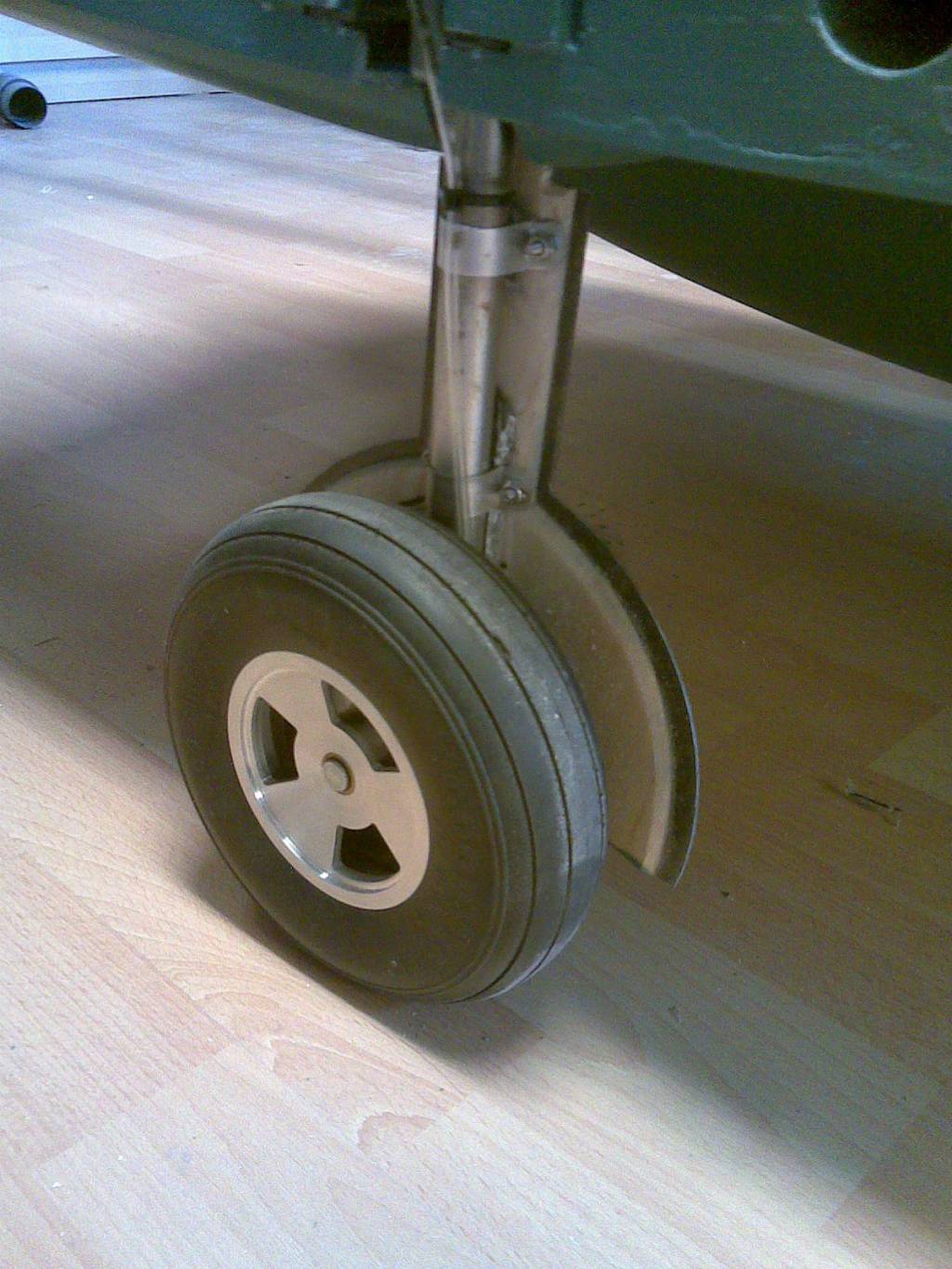

On my 1/4 scale Kerner Vampire the main wheels are 6 inch and heavy. The 5/8 in Robart leg and wheel weighs 580 grams(22oz)!
This has given me trouble with consistent gear retraction. The Robart 635 would sometimes be unable to lift the assembly, worked in the shop but could fail when flying.

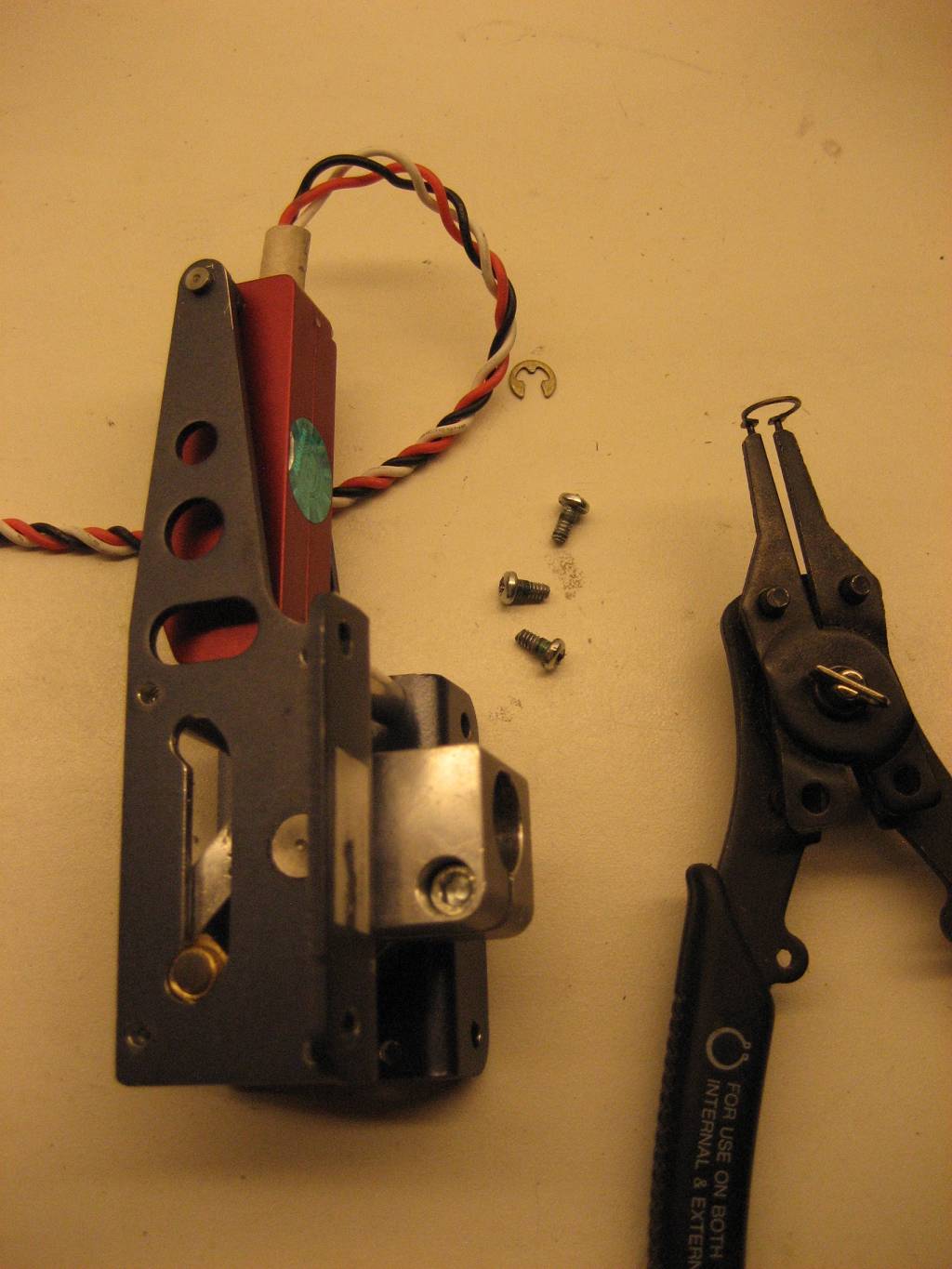

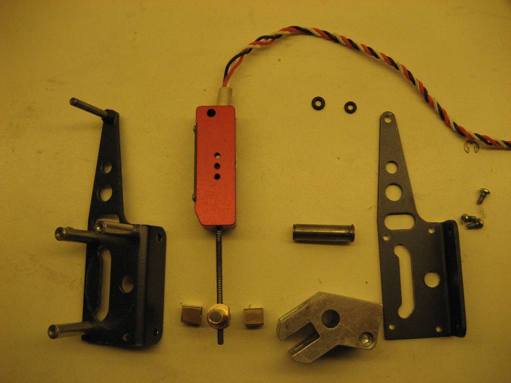

Changing the actuator on the Robart unit is rather straightforward. Three screws, a C-clip and a locking ring and the unit comes apart.
I removed the T-bar from the pneumatic ram, drilled and tapped for the 6-32 thread on the electric actuator, and assembled the unit with the electric "cylinder"

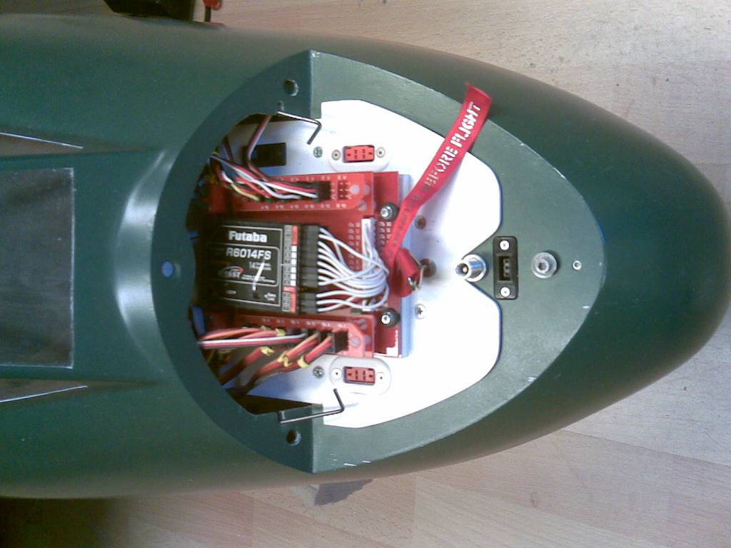

Mounting electric retracts in the plane is easy, only one "servo" wire going from the unit to the receiver. Removing the old air(hydralic) hoses took longer.
Doors remain pneumatic for the time being as the speedbrakes and wheelbrakes also are air driven, I saw no need to change this. But I needed more delay on the doors as the electrics are slower than the previous setup. No sweat, just hit the "+" on the Jettronic Door-Sequencer. But no, I could not get the required 12 second delay no matter how many resets and +pushings I did. This fiddling took the gear through approx 40 cycles and the left leg started to act up. It would stop half way every time.

Problem 1: Whats up with the sequencer? Why will it not give me more than 9 sec delay? The instructions says "adjustable from 4-13 sec"
A mail to Horst Lenerz cleared it up:
"You certainly have one of the newer transmitters with a higher pulse repetition time, which causes a much shorter maximum delay time.
At the time the sequencer was developed, 20 Milliseconds have been usual. Today they are 14mSec and shorter."
I also got a good offer on an update to fix the problem and extend the max delay to 40 seconds. Again excellent service.

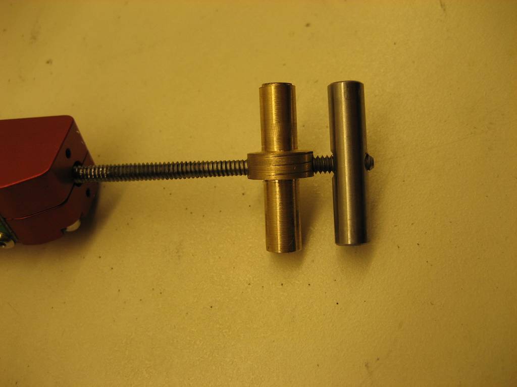

Removing an electric retract from the model is easy, and I soon noticed my problem: The threads on the screw were worn at the place of most resistance. More testing out of the model revealed more of the same I noticed with 4.8 V- the T-rod was pulled out of 90 degrees to the screw.
My answer to this: I need longer threads through the T-rod to prevent the pinching. So I found some 8mm steel rod and made a new T-rod on my mini-lathe. Finally useful!
Tests were promising, but I decided to go one step further and made another T-bar from 12mm brass rod.

I feel confident this last change will do the job. The brass can be exchanged for steel if flying (poor landings) should bend the T-rod
