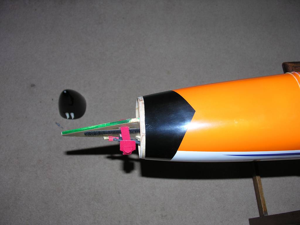

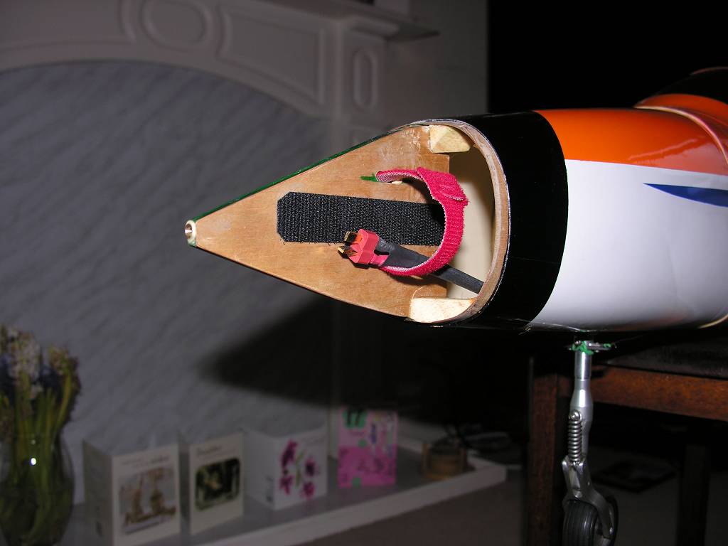

I made the nose removable after a nose gear failure! [&o]
I used it for mounting the turbine battery, it worked well on mine to get the c of g right.
It's attached via a screw thread right at the nose tip!
I'm not sure that this will work for you, but if you like I can upload some pics to show how it was done.
John.

No problem, I will dig it out and take some shots of the conversion.
You know this is a great plane! It looks the part, and is a good all rounder.
Boomer's are very good, but I like jet to look as though it's doing over 200 mph when it's sitting on the groud!
It's worth the extra time to put it together at the field!

Here we go!
You can see that the lip is made up from 1/64 Plywood sections layered up (over lapping), bonded with C1 Cyno! The centre section is actually soft Balsa laminated with 1/64 ply (light and very strong)! The brass insert I turned up myself, the thread size is M3. To get the threaded tip in the right place, I drilled the hole in the nose cone first! Holding the nose in place by hand, I used a scribing block pointing to the centre of the hole. Without moving anything else, I removed the nose and placed the centre section in position and tack glued it in, then checked for alignment! When happy, it was glued into place with balsa reinforcement!
All you need to finish then is a 4 inch brush and a pot of black paint! (only joking).
Regards
John

John,,, that was one great mod,,, thanks for detail pictures...
i had not figured out way to make a good lip and pics really help.
lots of neat mods all in one !!
