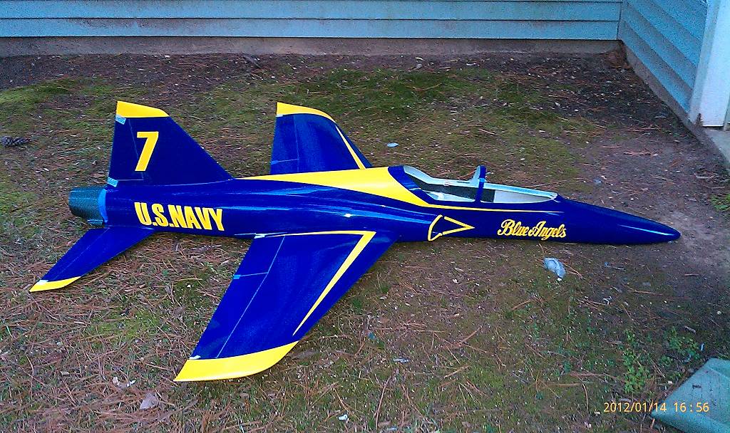

Old 01-26-2012 | 05:32 AM
Posts: 2,580
From: Mia, FL
Default RE: Ultra Flash Question
ORIGINAL: oliveDrab
OMG! Nice crash! Your plane broke into 3 undamaged pieces!
Now its rebuilt
ID:	1719263   Click image for larger version
