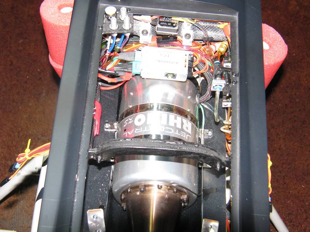

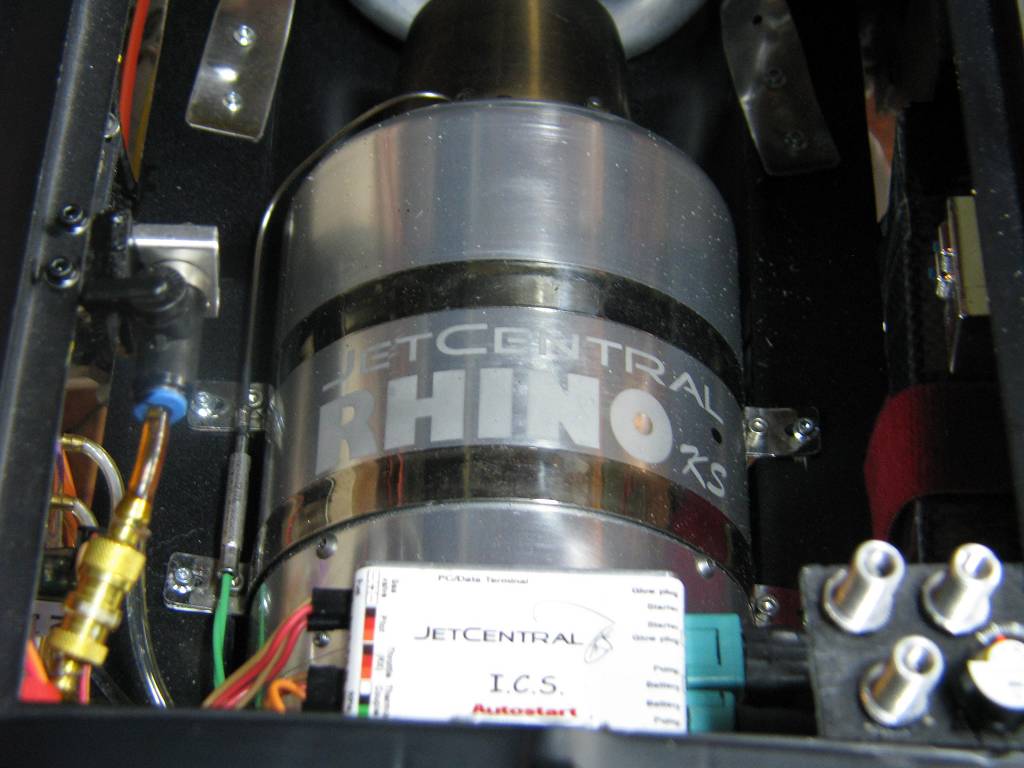

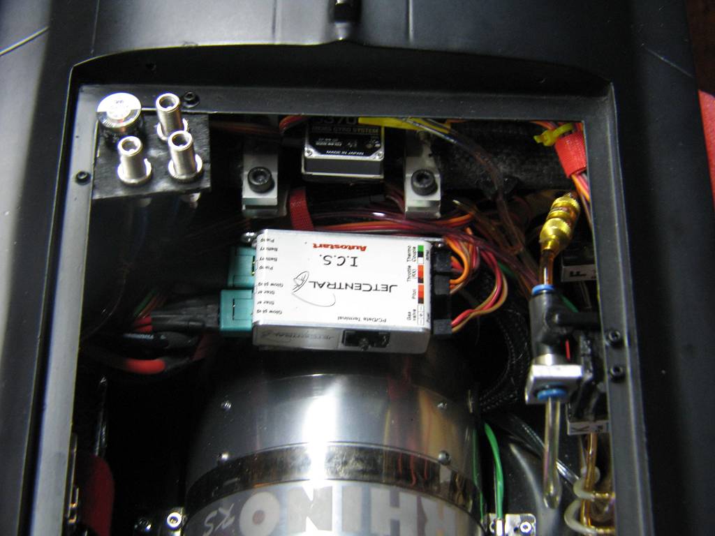

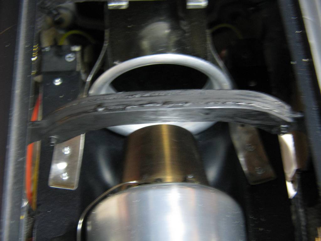

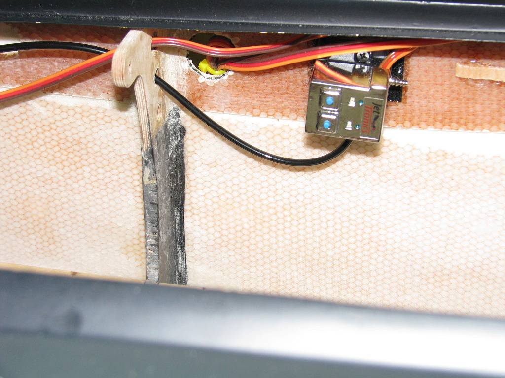

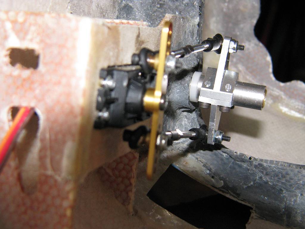

Installed the8711 JR servos. Both will be sheilded with BVM ceramic blanket. Probably won't need it, but want to make sure. Also used hangar 9 turnbuckles and Dubro 4-40 links. This application has proved to be very reliable in all of my planes. Make verythereisn't any binding. Notice the links are installed as far away from the pipe as possible (backside). </p>

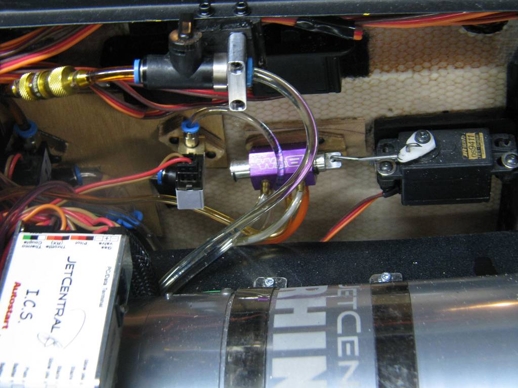

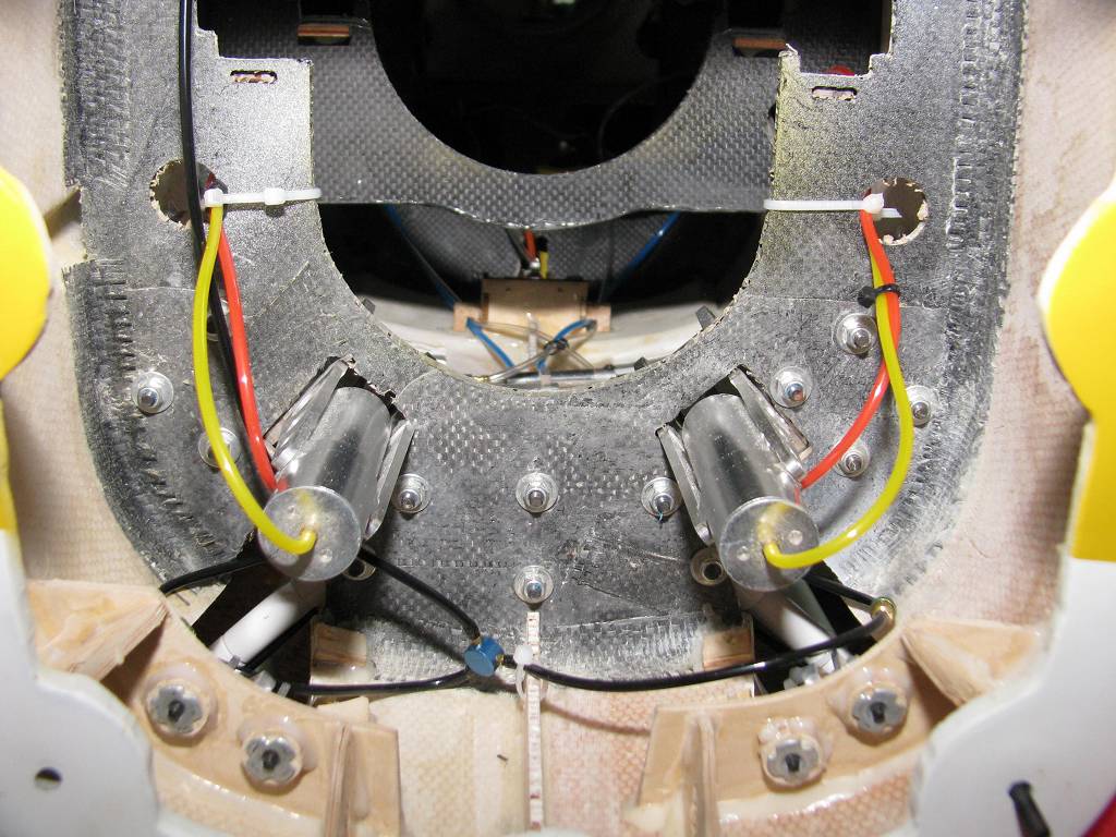

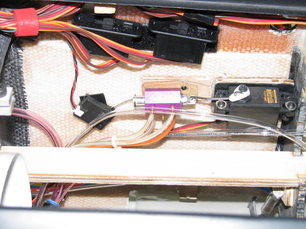

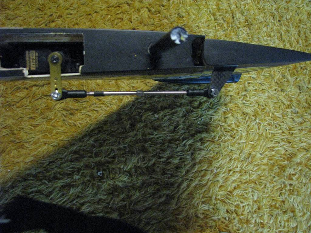

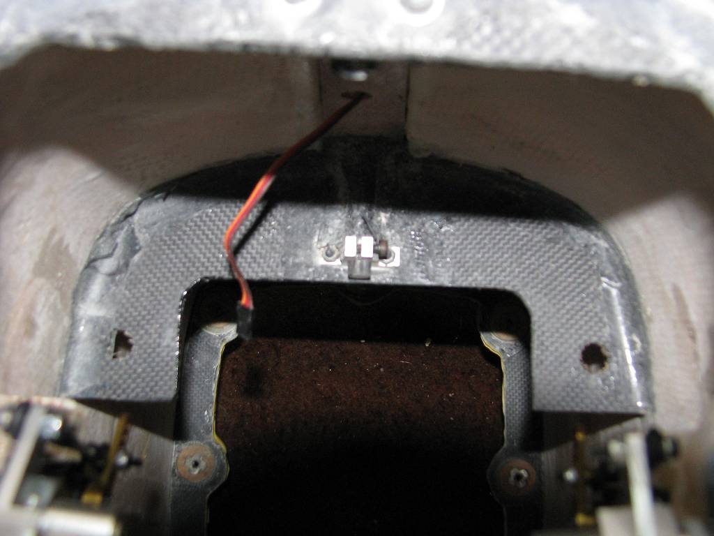

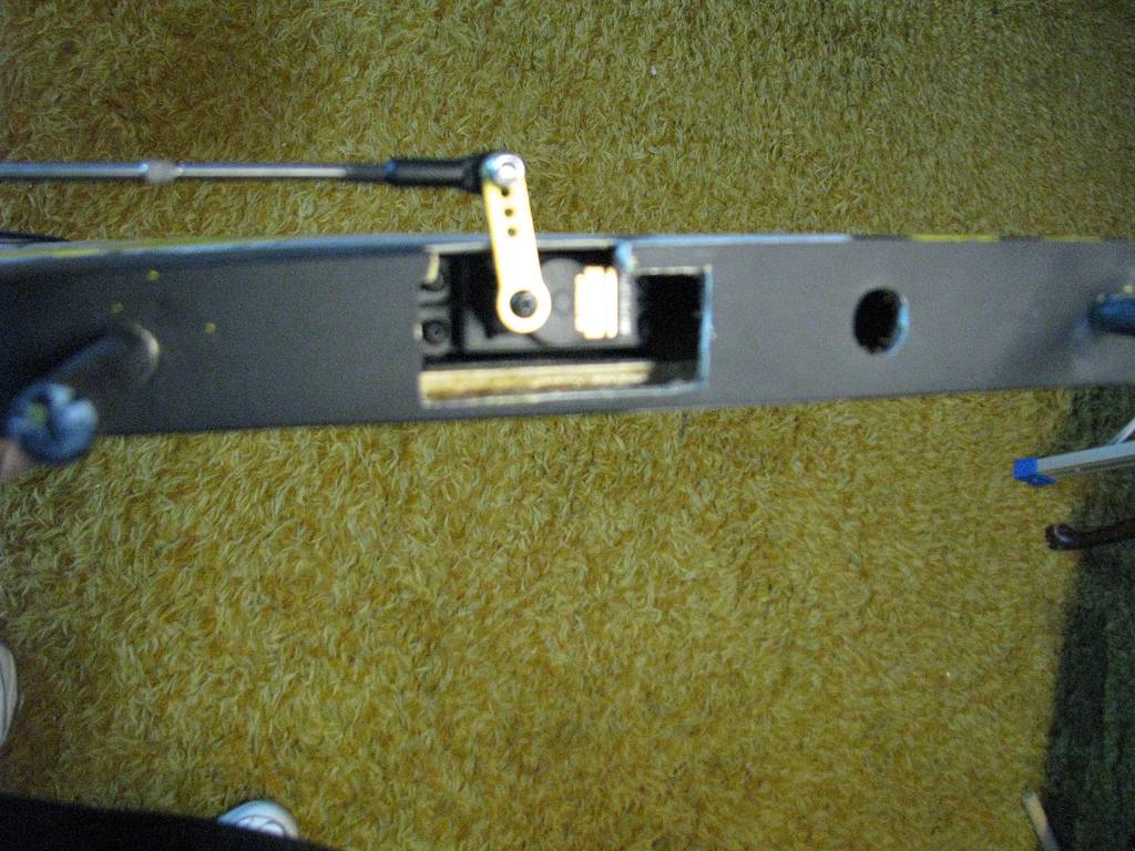

The 8411 Jr servo was very easy to install. I used 1/4 light ply as a base (picture 3), then attached a Tam Jets SSMO4A servo mount to the base. This will inhibit any flexibility in the sides of the fin.

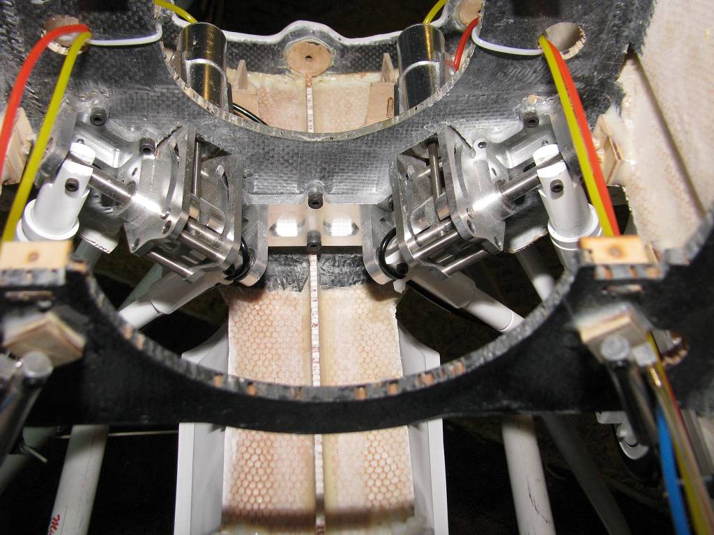

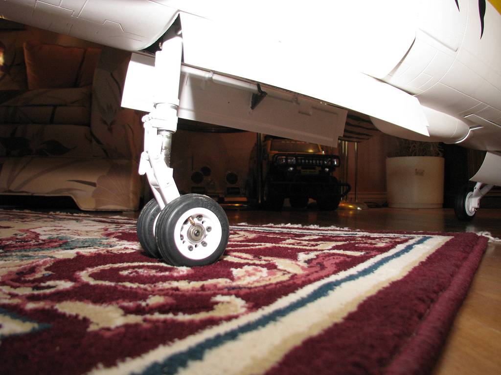

Photo one showing one of the mounting clamps for the fin. The fin is very secure once installed.

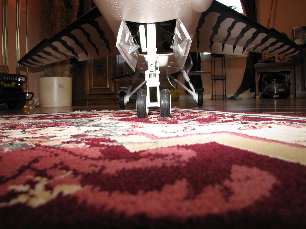

Photo two and threedisplaying the awesome landing gear. No leaks in any of the cylinders (including doors). The gear is well constructed and very sturdy. This entire area will recieve BVM ceramic blanket for protection.

Why use plastic ball links when metal ones are avalable,just a heads up,best be safe than sorry,it Will get quite warm down there regards Keith

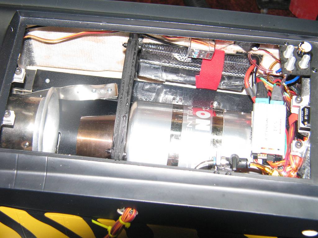

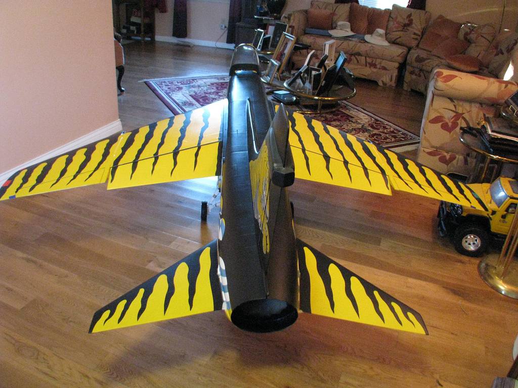

Just finished the A-7 today. Really turned out great. Here are a few more pictures.
The build was a straight forward process. No modifications to this point. Will continue to go over everything, with a test flight planned for March 27th is the weather is ok.

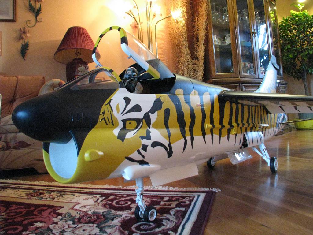

Neighbors came out to see it as I was taking pictures today. Everyone thought it was "Really neat".</p>

Looks good Lewis, the A-7 is one of my favs. BTW you have a 100oz servo on the retrac valve ?? now thats going top shelf
Vin...
Thanks for the concern; This application has worked very well for me over the years; I will however keep close watch on them.
