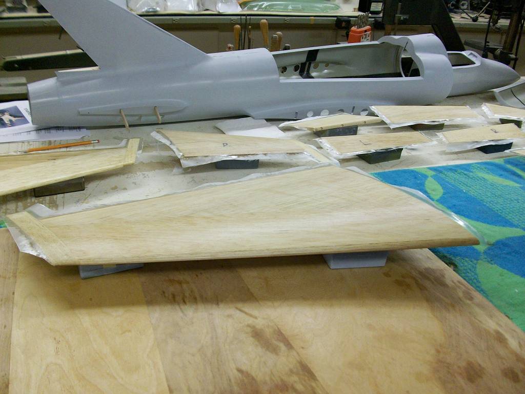

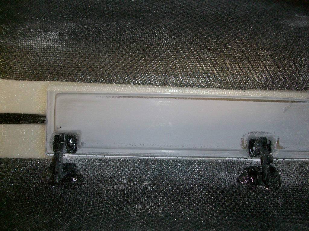

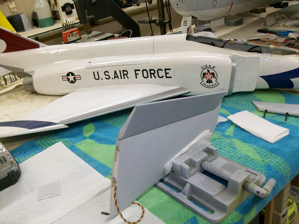

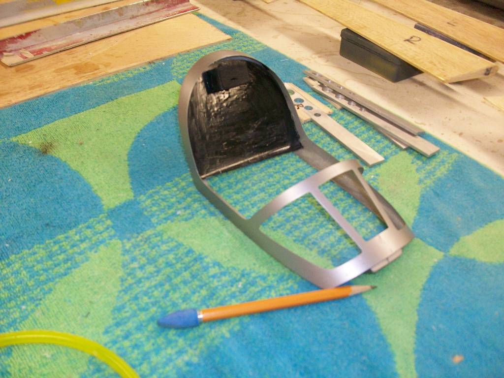

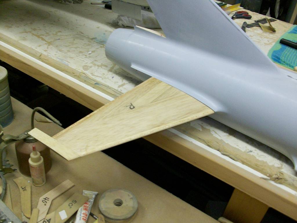

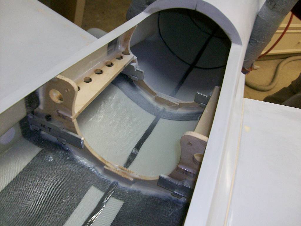

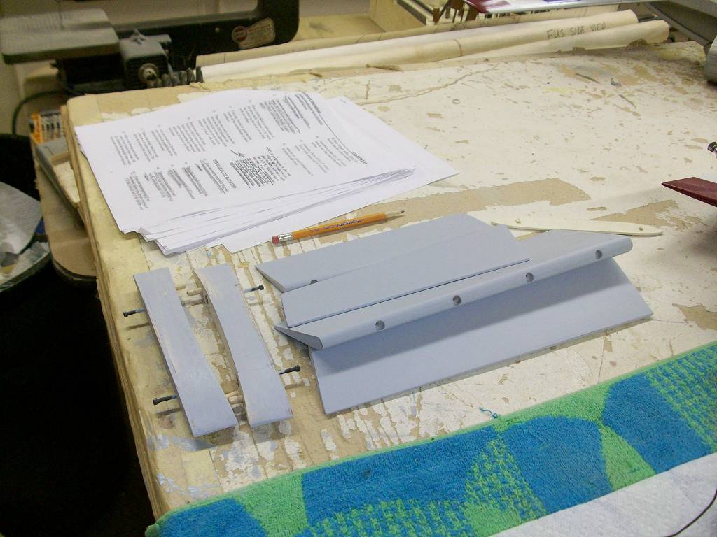

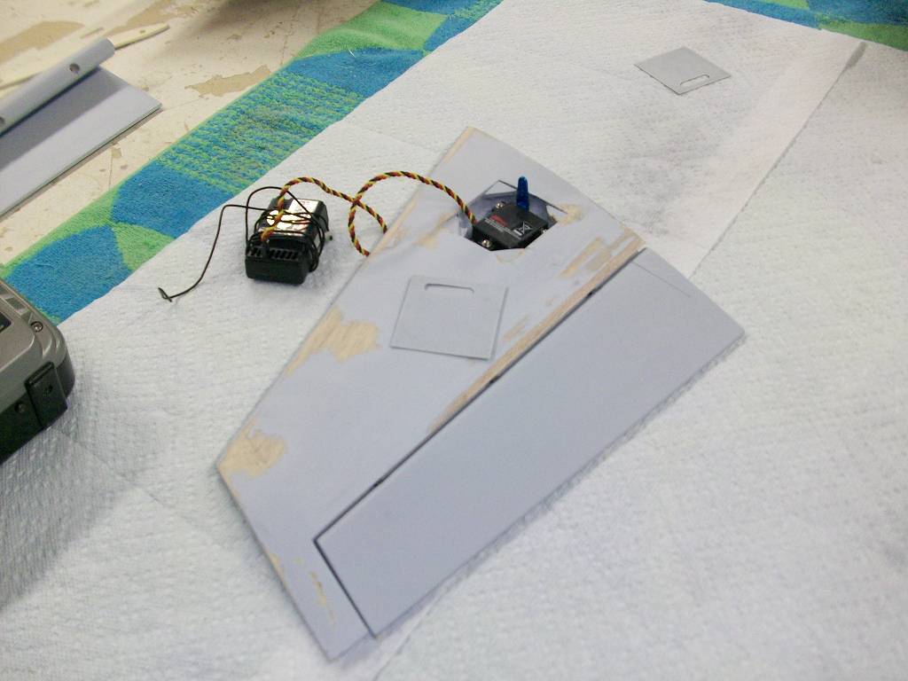

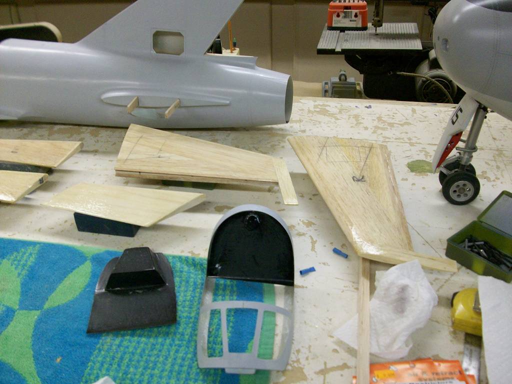

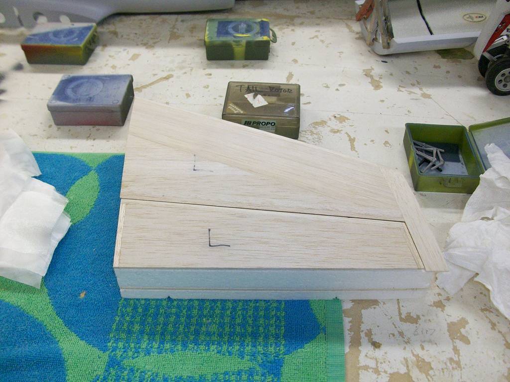

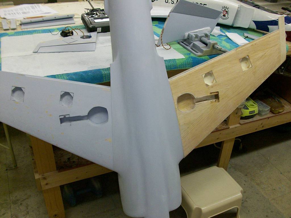

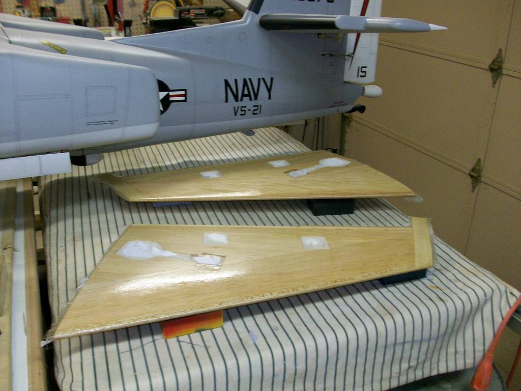

Well Don Yockey has has 2 days so far don't blink. Wings stabs and all controls fitted ans shaped. Cockpit fitted with pin release. Top of wings and controls glassed.

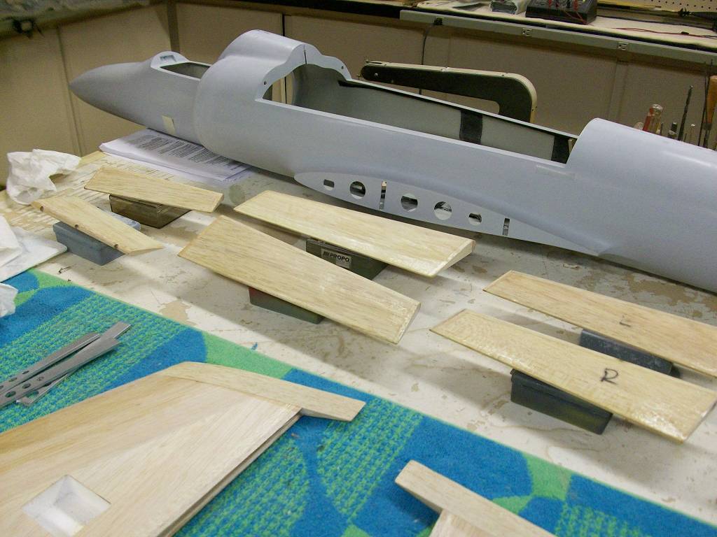

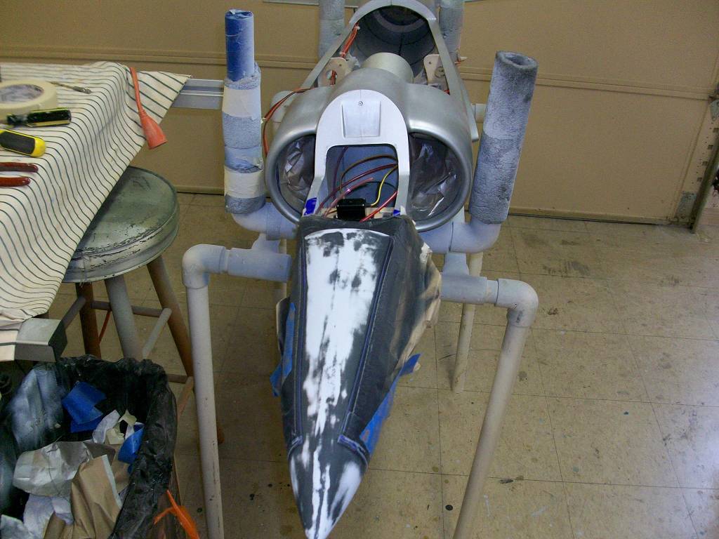

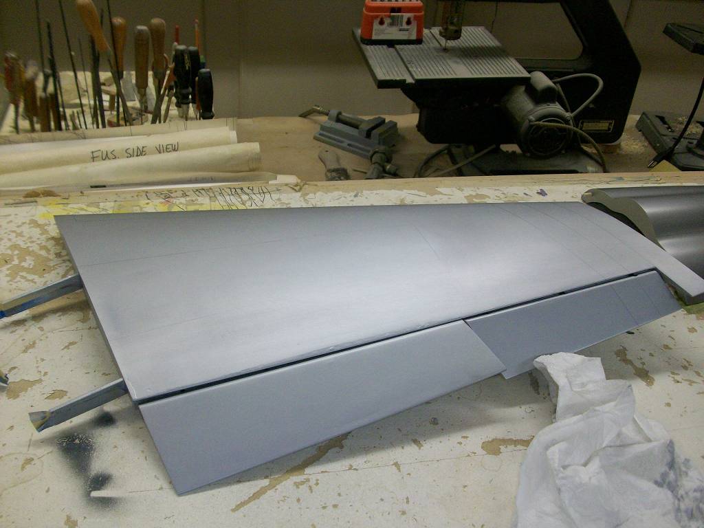

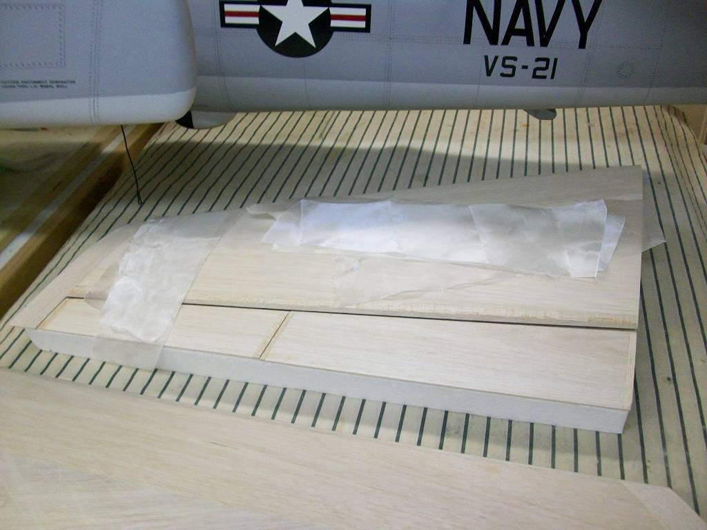

Here are the rest from day two of build.

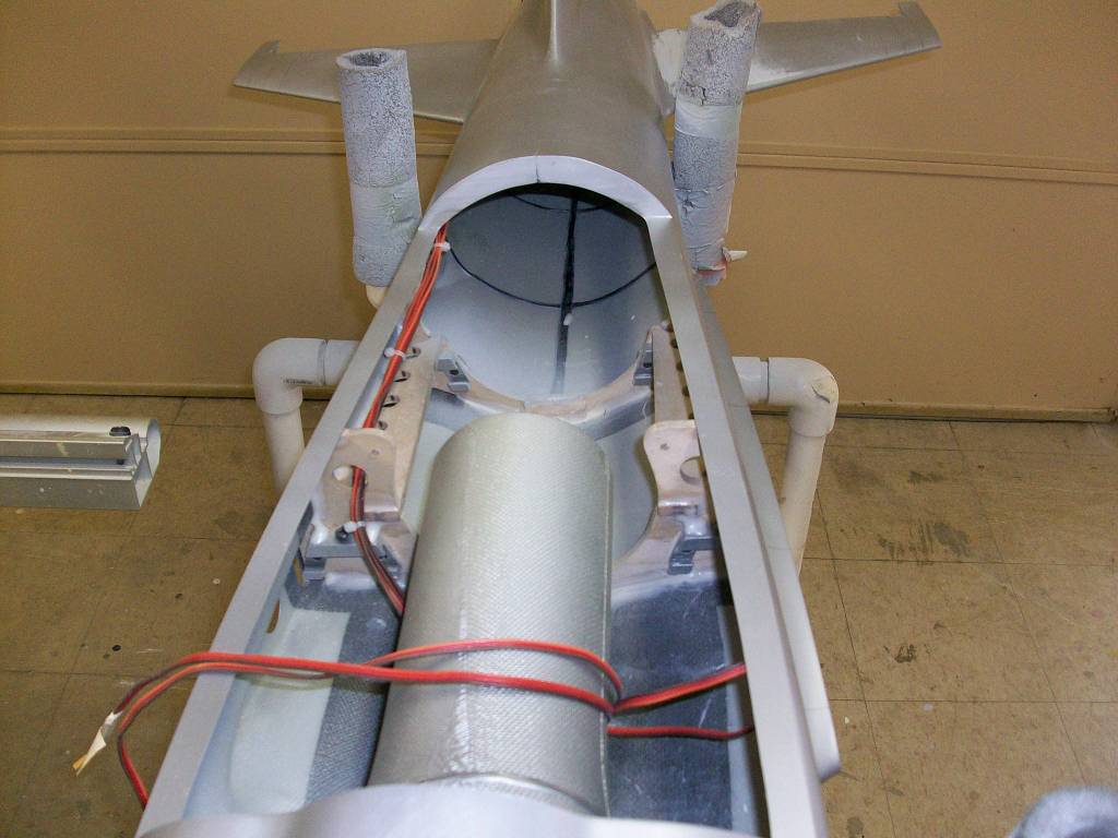

Default RE: Yellow Starfire Build

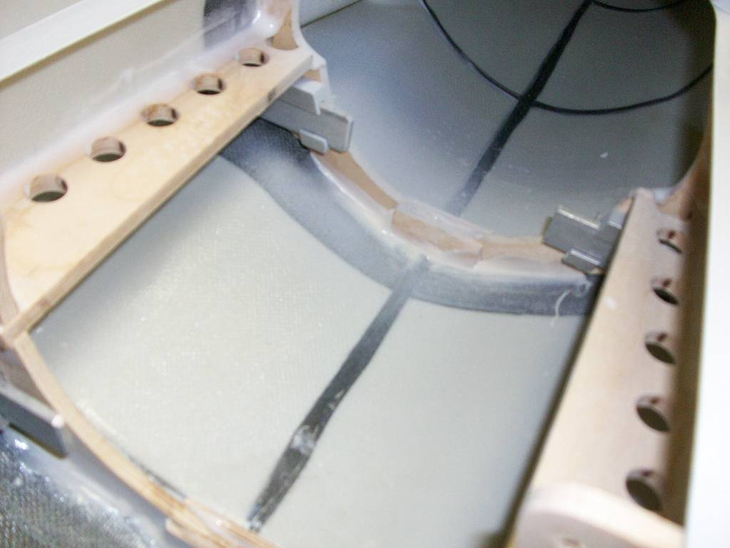

Man Kevin, you weren't kidding about starting one soon. Is Don going to do a new 1 piece motor mount for your 80? Me and Shaun will just have to disagree on intakes, although i'm right. Don't worry though, the 18 will have the stock intakes .

I guess I am not sure what a one piece mount is?

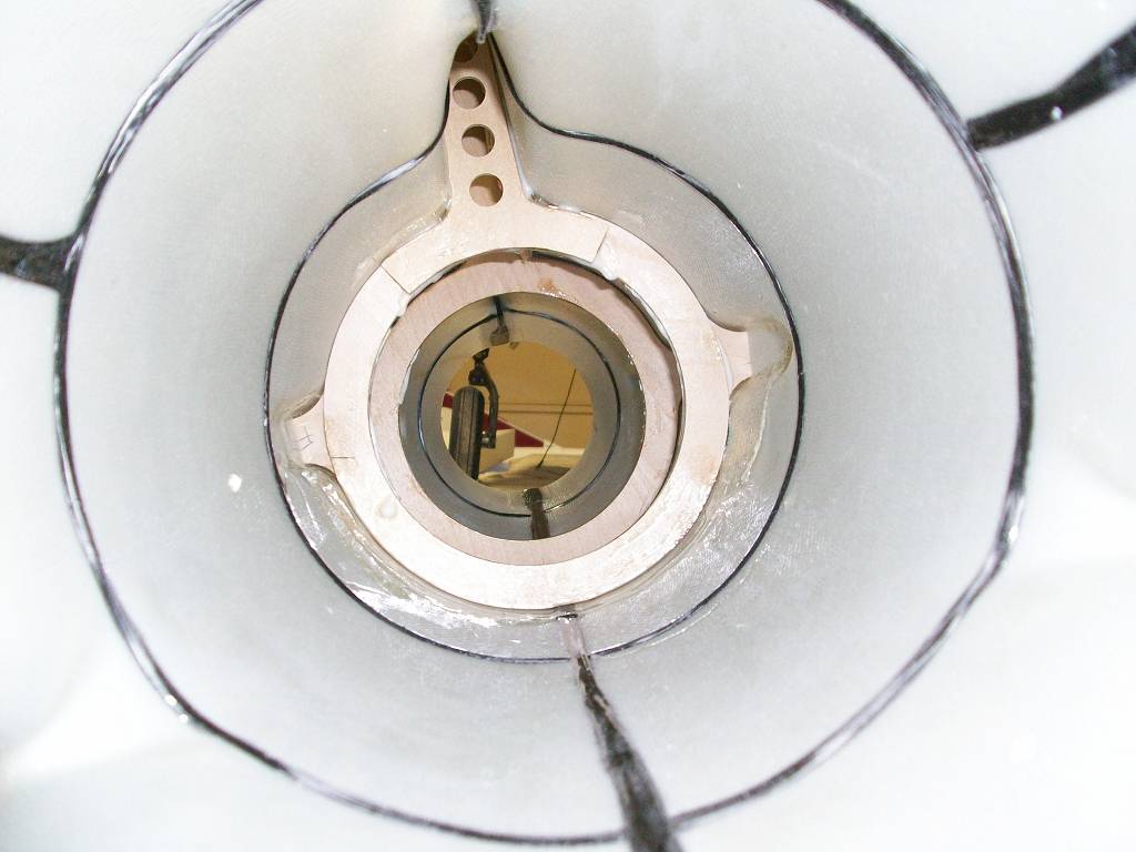

The 80 mounting holes are a smaller spread than the duct fan mounting rails that come with it. I didn't feel comfortable with the lack of "meat" arround the mounting bolts. I added rails to mine so the turbine would have something to mount to. I don't like having to add on rails, although they're structuraly sound, they add weight and i'd feel more comfortable with it one piece of wood.
Old 02-15-2012 | 08:22 AM
Posts: 1,765
Received 51 Likes on 47 Posts
From: Spring, TX
Will be designing rails that work from scratch. Already measured the engine and will make bulkheads when receive the plug in spars that were left out of original shipment.

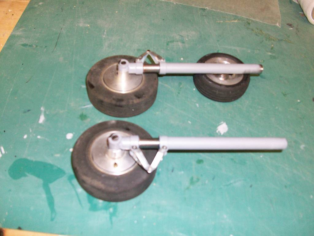

Using the robart 3/8 " struts with Glennis wheels and brakes.

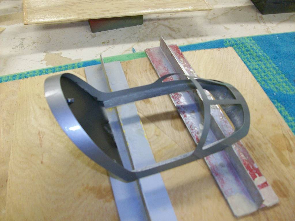

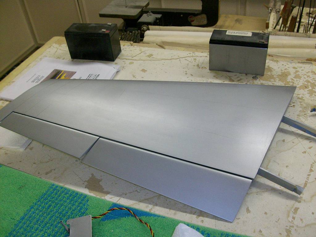

Well a few more pics. All glasswork is done. Tail bulkhaeds glued in. Wheels and brakes mounted to struts. Even a little paint on the canopy frame.

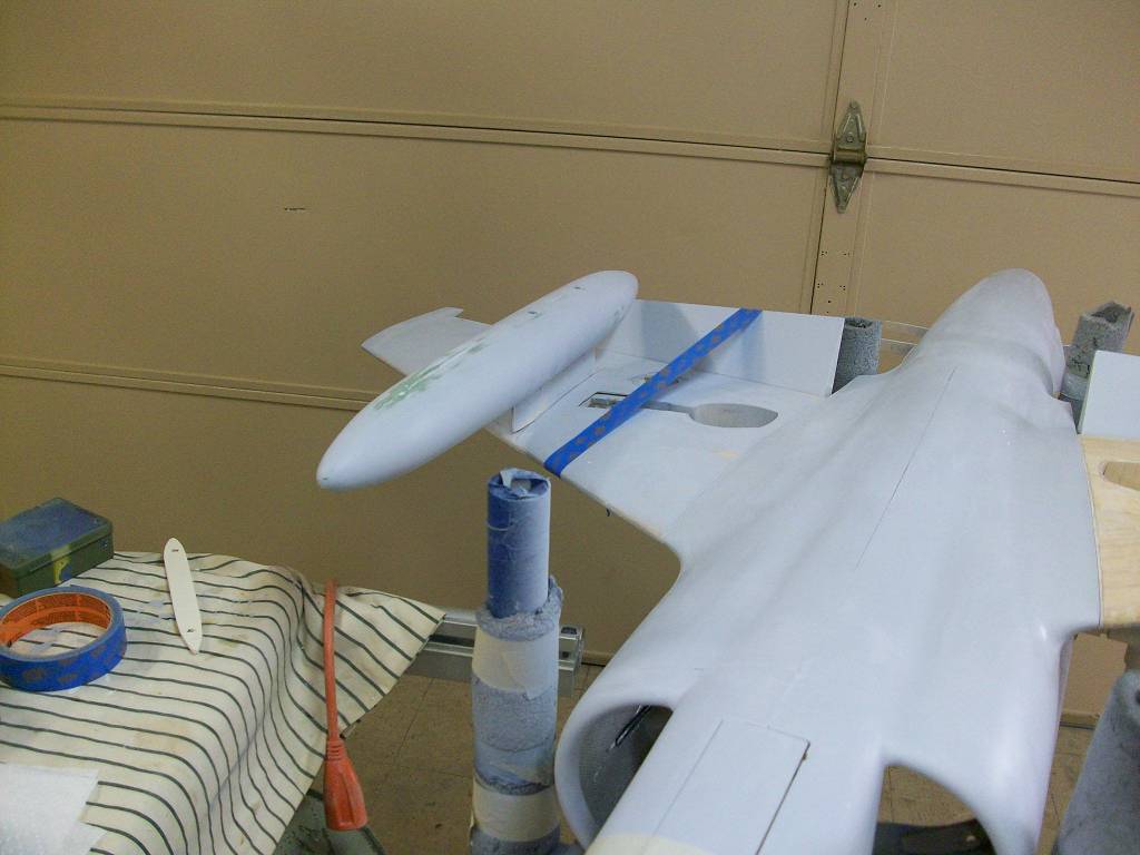

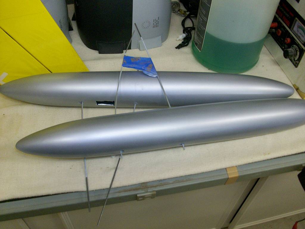

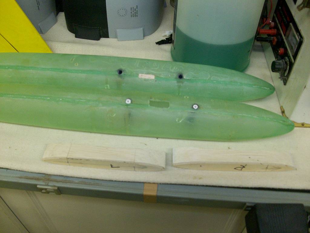

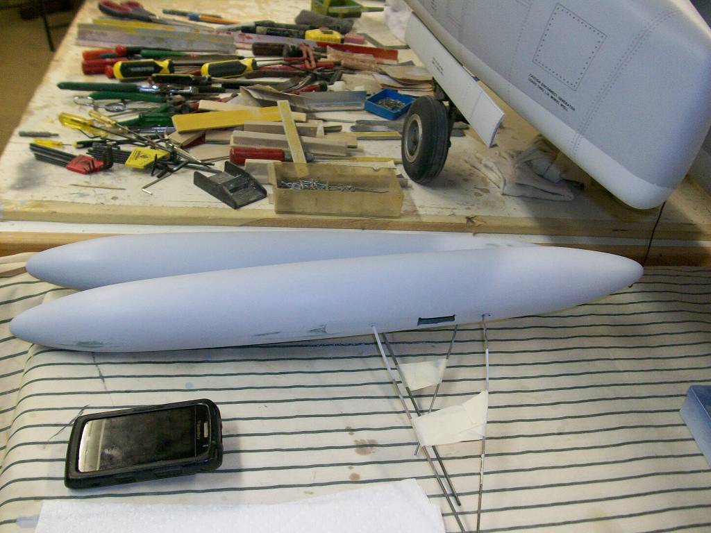

Here are the drop tanks

Using the Yellow retracts for struts with robart 3/8 inch struts and glennis wheels and brakes. Using yellow tanks with one more tank for between the inlet duct. Measuring for size.

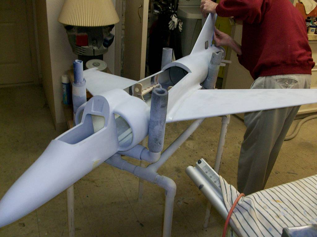

Just going to make up a Navy scheme with silvers and red and blue. I need to get up and take some pics all building is done and into primer now.

Here are some pics of headway

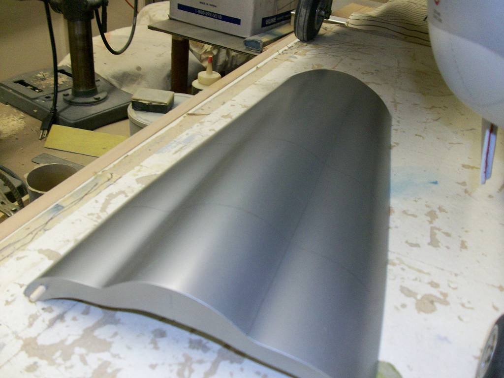

Don has begun the paint work.
