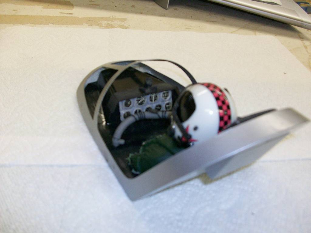

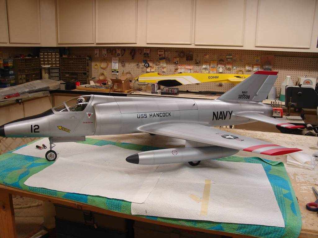

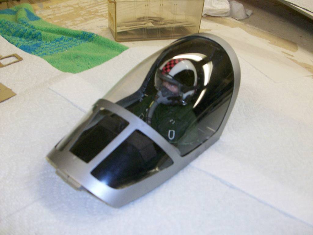

Don finished the cockpit as well. Looks good for such a small area to work with.

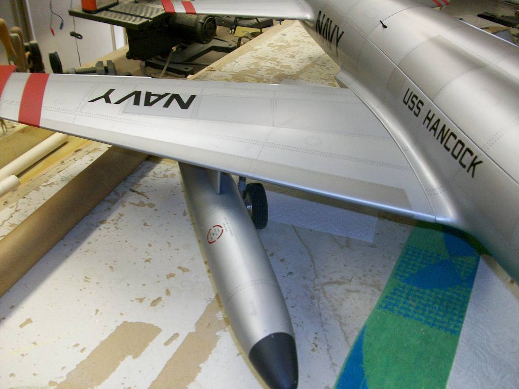

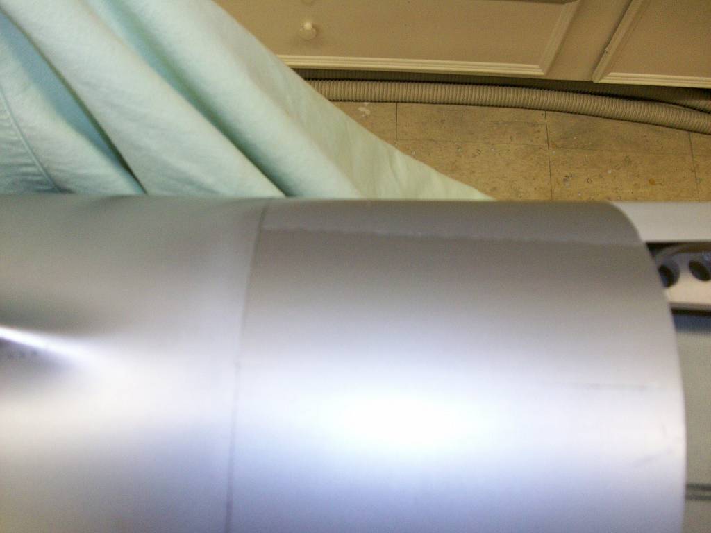

Don got the rivet work almost complete

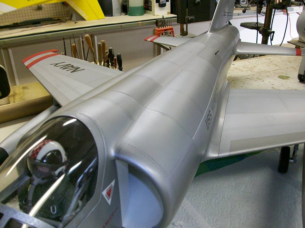

Kevin and Don, I really like how the paneling turned out. It looks very realistic with the different shade paneling and riveting.

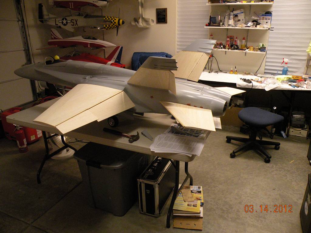

Sure do, hope Kevin doesn't mind. Here is a couple shots from last night. All the wood work is about done. I'm going to get the fuse ready for the paint shop.
They are going to spray it blue angels for me... and I'm covering all the wood in monokote. Mine is twin EDF so I have done every thing I can do to keep the weight down.
Looks like I will be 39 to 40 pounds ready to fly with twin 12s 7700 mah packs.... running two of Tams new 128mm full size dynamax conversion (all stock rotor and stators)
With a neu motor 1915 1y and a castle ice 160 HV 2 in the tail cones... with the right thrust tube size (100mm) they are giving off 17 lbs thrust per fan at 5800 watts. So I should be very close to 34 pounds thrust installed in the twin.
I'm on a push to get it to the paint shop in the next few weeks....

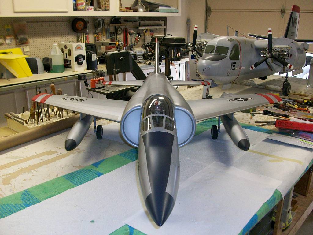

Went by to see the starfire in person. Here are a few shots. Don did a great job. Still waiting on pipe to be able to fly.

Ron, I use a PPG paint (base coat) called silver poly (3661) for the entire A/C then I put on panel lines with a plain #2 pencil. then I mask off random panels and add a little black to the silver and paint the panels. You can also add white to lighten some panels.
