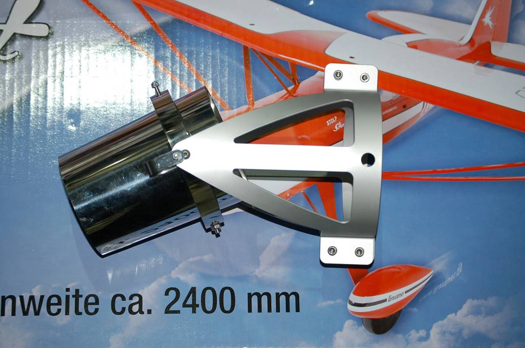

Hi Guys,
I may be scratch building a Rookie/Kangaroo type jet, and if I do... I want to add in Vector thrust. So, my question is... how much defection do you need for "3D" performance???
I know on my Jet skis... I only get about 20 degrees of movement each way... and that will make is spin.
Thanks in advance.

Around 30 degrees would be a guess, you are limited by the tube diameter 3 1/2" is a good starting point. Turbine Tail pipe diameter will stop the deflection.
I had a Zimmermann set up in my Rookie and Harpoon 11 and it worked well.
Dw

Like this
Try again!!

Tony. 30 Deg. is what I'm seeing on my Rookie II but just keep in mind that you want to mix in a switch to cut that vectoring off at high speeds.

30 degrees is about what I can get on my Eurosport. I don't think you can have too much.
You definately want to be able to switch it on and off!

Tony, I'v seen jets almost turn on themselves with 30 Deg. of movement so don't worry about needing anymore.

After using it for a little while and getting boared I put as much movement as I could get on my Rookie and took notice of the instruction manual and put revearse expo on it, i.e. more movement on first movement of the stick, having the pitch vector on makes for very short take offs, Oh by the way I have both movements gyro'd and the canard goes too 85degs for landing with the pitch vector still active.
