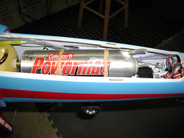

Here are the complete pressurelized smoke system.

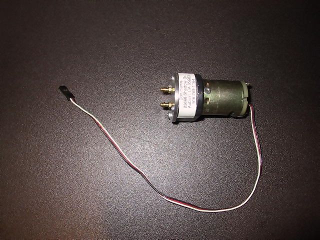

Has anyone tried the built-in smoke system in the JetCat system software??--I plan on using it on my soon-to-fly Planes Plus F-15. I didn't want to screw around with jamming in a smoke tank in my HotSpot.
Looks like a simple sytem using Compressor pressure, picked up off the propane port (close to 40 PSI for a P-120) and either a homemade or one of BV's smoker pipes. ECU software controls the whole thing, using a standard JetCat solenoid for the on/off switch, with a couple of T's and one-way valves.
AMT Europe-- http://www.amtjets.com (go to Download Page) has one available for their engines. Same deal, but you do need an extra channel, since it is not built into the AUX channel on their software, like on the JetCat.
I have one of Don Harris's old style pumps off one of my Big Birds. These things caused more than one plane to bite the dust, suddenly giving off bursts of RFI. Guess his new ones are better in that regard. Maybe had something to do with ignition engines. Don't really know. Most of us switched to TME after 2 guys in our club lost their birds.
FYI, I am sending along, on the following post, a picture of what my old pump looks like.
Tom
Tom

Here the photo of my roo using my pressurelized smoke system.
I set up for dual smoke injecter. I pressure the air tank with 100 psi.
This how it coming out at full power.

#40
Yo, you guys that are using Powermax cans for smoke tanks: what mods are you doing to the can tops to use for this? Are you installing Festos or simply sodering brass tubes in (a dicey proposition with some residual fuel inside)? What is the capacity of one can and how long can you run the smoke? Thanks.
#41
Posts: 72
From: Mahomet,
IL
I first cut one apart to see how it was put together, but basically, I punctured the valve with a drill. I then aeropoxied a brass nipple in place. Same thing for the overflow.
If I remember correctly, it works out to 23oz of smoke fuel. This runs for probably 2 minutes. The last 30 seconds or so are kind of spotty becasue the "clunk" is not heavy enough. The clunk is actually an aluminum pipe that is probably about 6 inches long. Im thinking about putting a real clunk on there and glueing the top of the can back together.
The only festo I have is a one way between the overflow and the engine.
Chris
