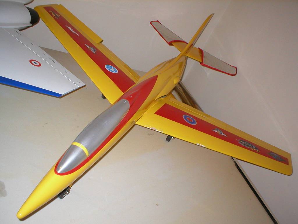

Old 03-22-2012 | 09:38 AM
limeybob's Avatar
Joined: May 2003
Posts: 1,009
From: Rockwall, Tx, TX
Default RE: STARJET Centre of Gravity???
some info here.
http://www.rcuniverse.com/forum/m_11..._1/key_/tm.htm
I had one, flew it and sold it, great plane to fly.
bob

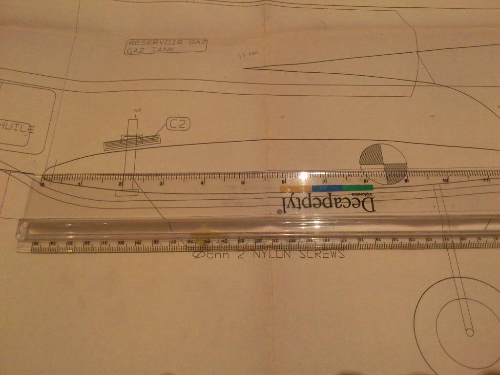

Old 03-22-2012 | 02:47 PM
cmjets's Avatar
Joined: Apr 2005
Posts: 1,773
Received 60 Likes on 39 Posts
From: Pontevedra, SPAIN
Ali:
Here you have a photo from a plans. 8,5 inches from the leding edge of center wing.
BR from Spain.
Carlos Márquez.
