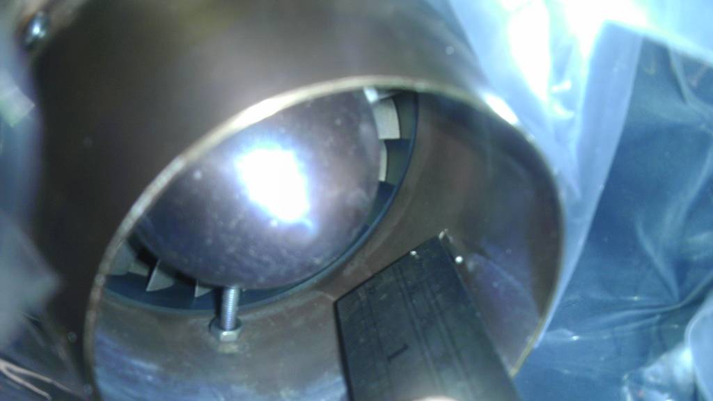

Just an observation regarding probe. But what data supports the claim of being cooler running engine? There are two Kingtechs listed in Performance Comparisons in Jet International and its not really supportive of that.
Im not critizing the brand, just a curious question. I honestly dont really pay too much attention to temps, or care for that matter, but i dont think i ever recall seeing a 780 before. But if its supposed to run at 720 and the fix is to pull out egt 1mm, then I guess its that easy! Ive never messed with my egt's except when I owned RAM back 12 years ago.
The probe depth is obviously a variable of temperature. Obviously not a standardized location or installment.
The pic below shows over one centimeter of egt inside tailcone, but it is bent and laying on tailcone and not probing into exhaust air. i dont know how the kingtech egt is installed. Maybe they are easily bumped and moved.
Just making an observation that: could it be possible that the MAX EGT numbers are just a reflection of EGT location or depth?
I dont really give a crap if it runs 730 or 780, but Im sure it plays a significant role on turbine life. A different brand might be running hotter, but could it be the probe is just further in?
It clearly states in Jet Internationl magazine in Performance Comparisons regarding MAX EGT that "Exhaust gas teperature is nominal as the actual EGT varies substantially depending on the exact position of the sensor"
So how can anyone claim a cooler engine when you just move the EGT?

I thought I already explain the high temp. Its easy to tell an engine running with high temp.. the tail cone glow orange at full power. this engine don't
That's my fault If you look carefully my temp probe was not screwed down and was too far inside the cone,

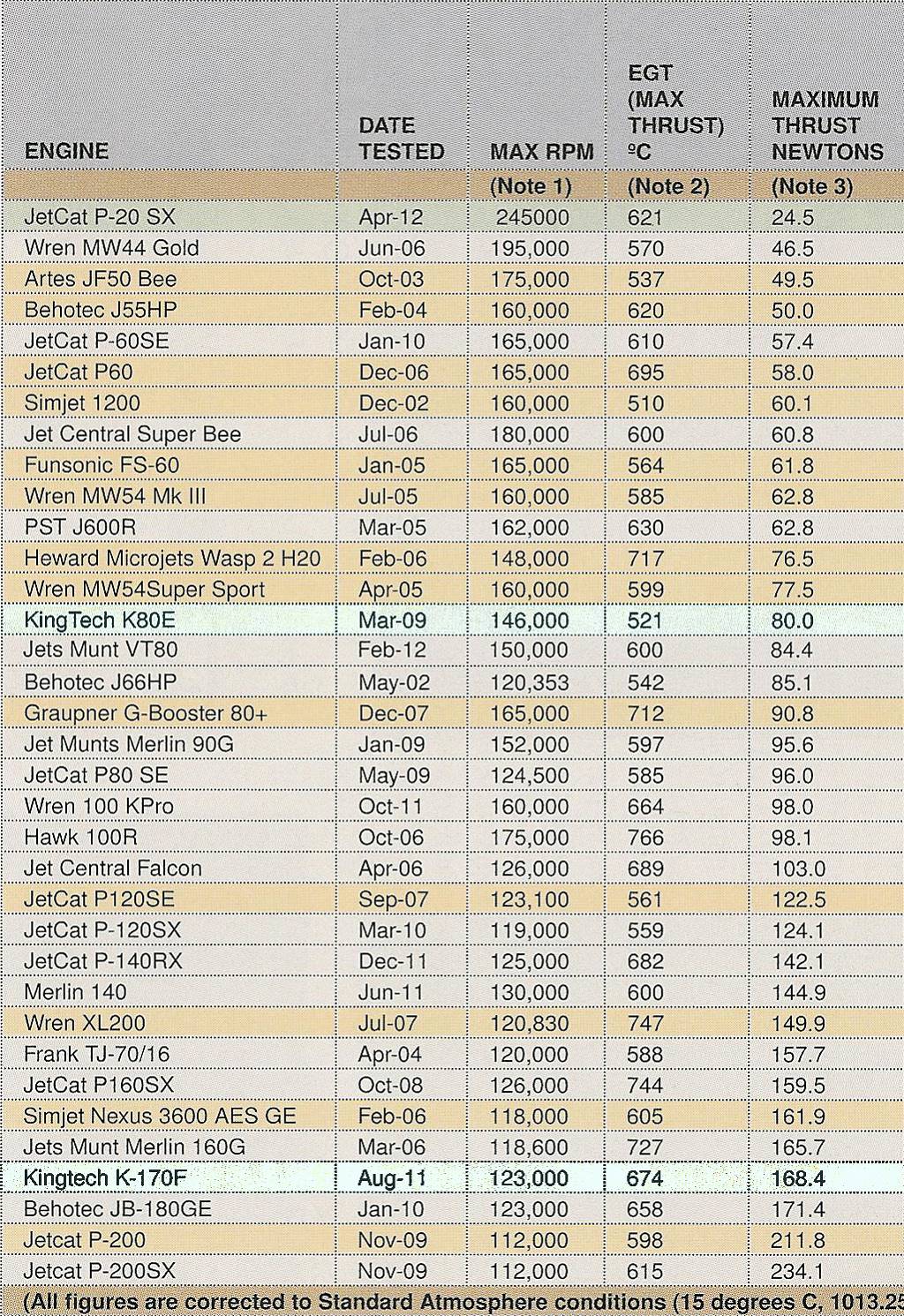

The data from Jet International reflects to our records and I think it does support...

Scott, KingTech isn't flawless by any means, as we had our share of growing pains, but thank goodness temperature hasn't been one of them.
I'm pretty sure if one sticks the probe in further than manufacturer suggested, will get a hotter reading, likewise, if you pull it out some, cooler it reads. Why there's such a difference in the depth of insertion between brands?? Perhaps types of probes are different? or perhaps ECU auto compensates for the final value based on set up? As far as with Gaspar Xicoy ECU, it requires 2mm to be inserted into the cone, and I remember Jet Central manual also concurs at 1/16" to 2mm, that's 1.6 to 2mm.
Here's something from Gaspar's manual that could be found on our site:
4.4 Thermocouple
The FADEC use a thermocouple of type " K ", apt until 1100ºC. The provided standard thermocouple consists of a wire of Inconel of
1.5mm of diameter finished in a connector who fits directly on the FADEC. The recommended installation consists of practising a drill of
1,5 mm in the exhaust nozzle of the engine and inserting the end of the thermocouple so that it be 2mm within the flow of exhaust
gases. Because the sensible zone to the temperature is the end of the thermocouple in any case DO NOT CUT it since it will be
destroyed. Also, do not bend it with pliers or other utensils that cause very acute angles of curvature. The installation is due by
hand and the curves must have the greater radius possible. In principle any type of thermocouple " k " can be installed, but it is
necessary to consider the thermal inertia of it, since the temperature of the engine can raise much quickly that the one of the
thermocouple and cause not controlled situations of overheating.
